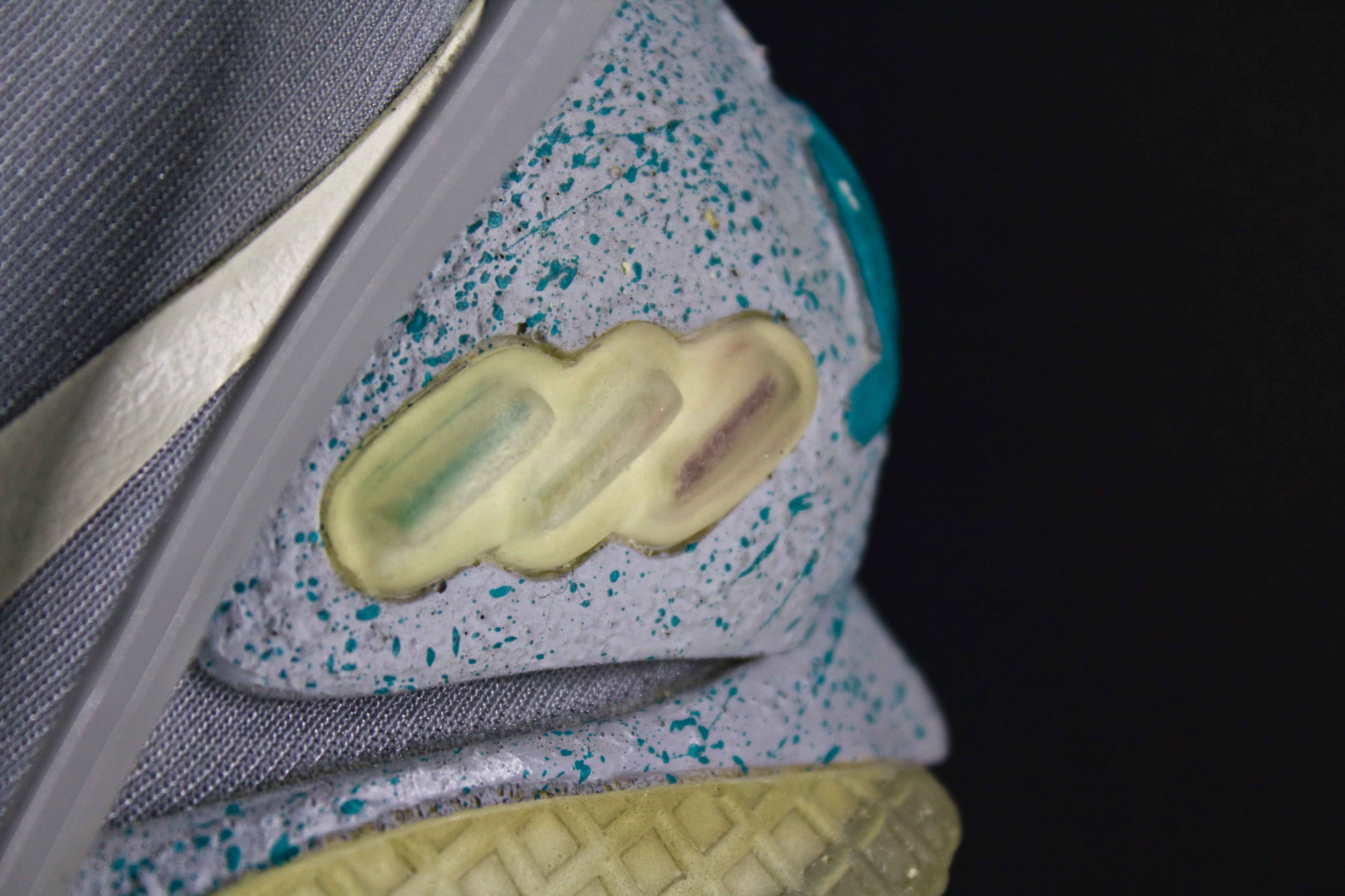

This is a screenshot of the stunt shoes, notice how frosted the led bubble is, I didnt realize it was so frosty! Which light source shouldn't be a problem with that much matte spray

Here is a little better shot of the real prop shoes bubble ';)
http://www.therpf.com/attachment.php?attachmentid=518361&stc=1
That almost looks like strips of colour inside? When I mold and cast the new bubbles to go with my new heel cups, the new bubbles will have the three slots in the back for the LEDs. I was thinking at one point just mixing and filling these slots with tinted rubber as I have red yellow and green transparent tints in my collection. A bit of a PITA and you would want to have several pairs on hand to go when mixing these up.
Not sure about LEDs DragonGalvy being transparent enough. They light up the way they do because they illuminated from inside. The EL would have to pass through from the back. Still worth a test.
Not sure about LEDs @DragonGalvy being transparent enough. They light up the way they do because they illuminated from inside. The EL would have to pass through from the back. Still worth a test.
