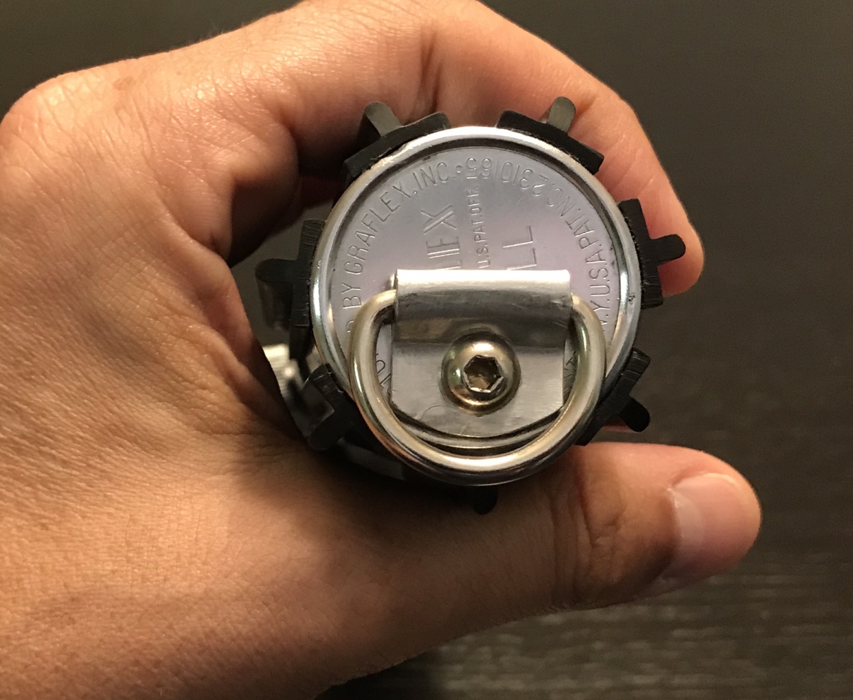

The way mine is attached (hex screw) had always given me issues with rotating.
Luckily i never wear my ANH saber. Its pretty much just on display.
For the record, my TGS is riveted, and I’ve had no issues at all with bracket rotation. It’s very solid.
No doubt. When you rivet it correctly it will hold like iron. If rivets were known to fail I’d never fly again lol
