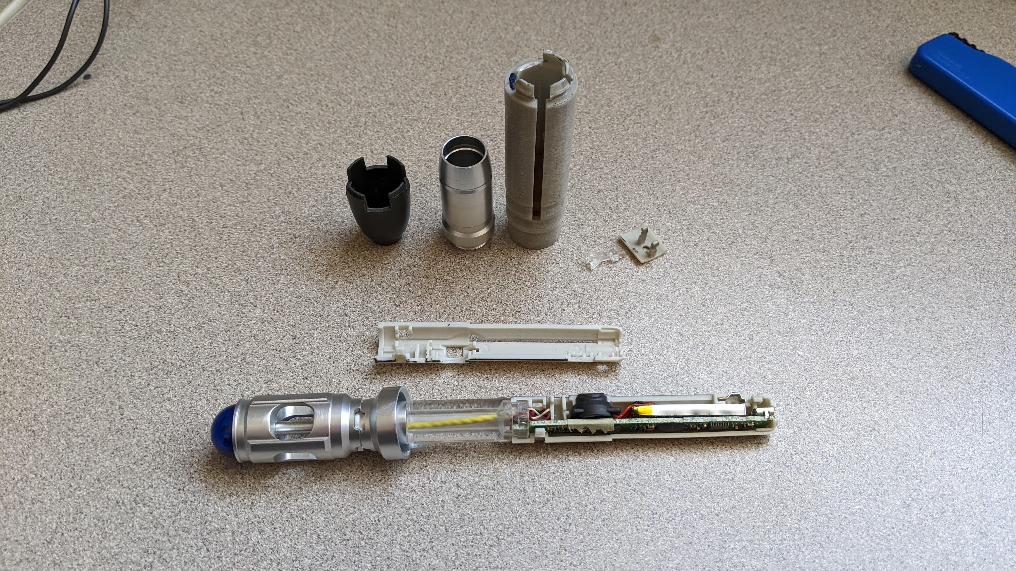

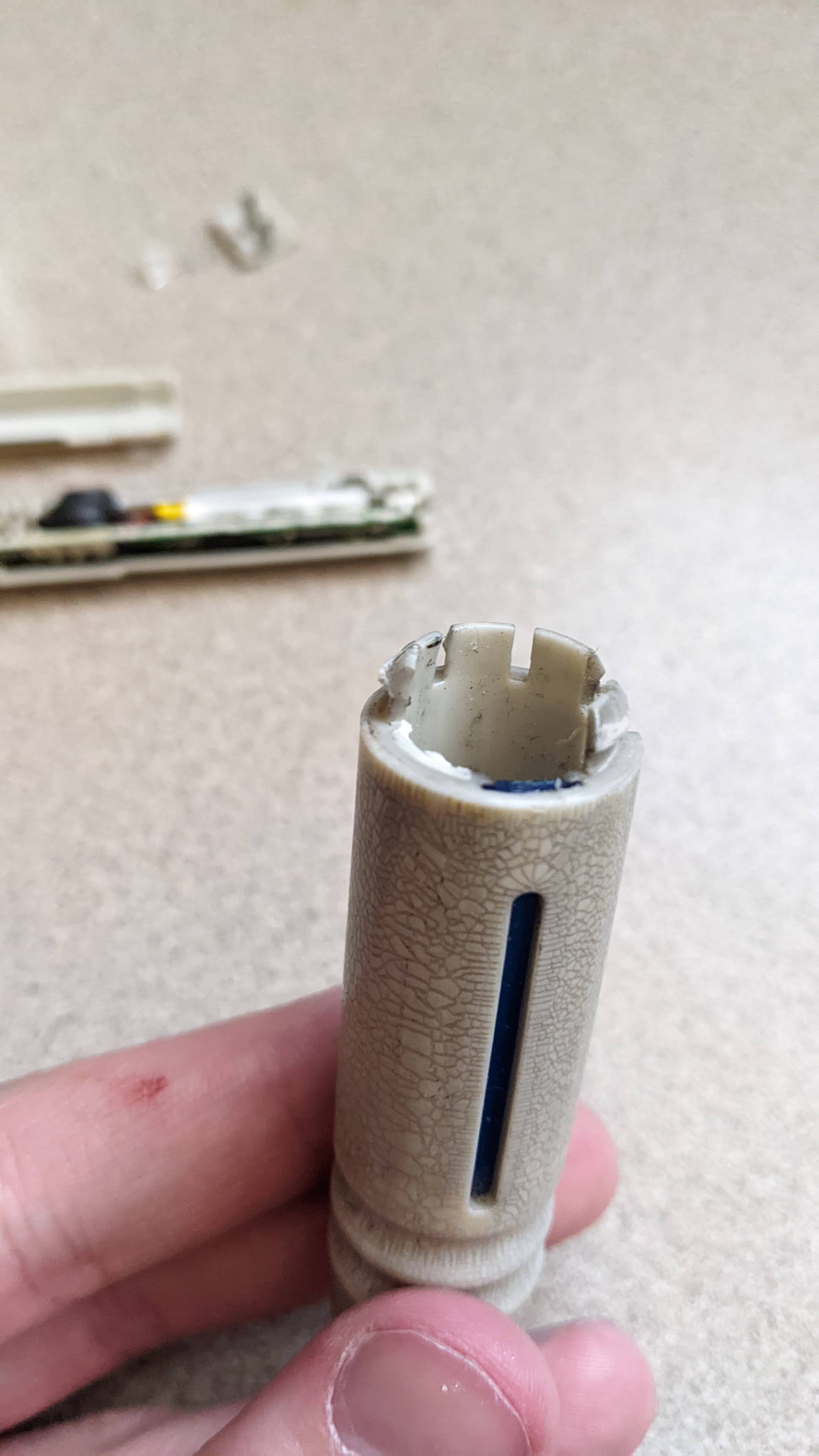

Welp, wish me luck gang! I've had this screwdriver since December 2013 and I recently found the battery was toast. I was able to get it open with the only damage being the loss of one of the clips on the main body. Just trying to find a good source for one LiPo battery is proving to be tough though...

Yes I did read the tutorial but my plastic did not separate nearly as far, so getting the battery out through that method would have been next to impossible. As for the battery, I stated that I was having a hard time tracking a good source for one (1) as all the listings I've come across have been lots for 10 or more.
