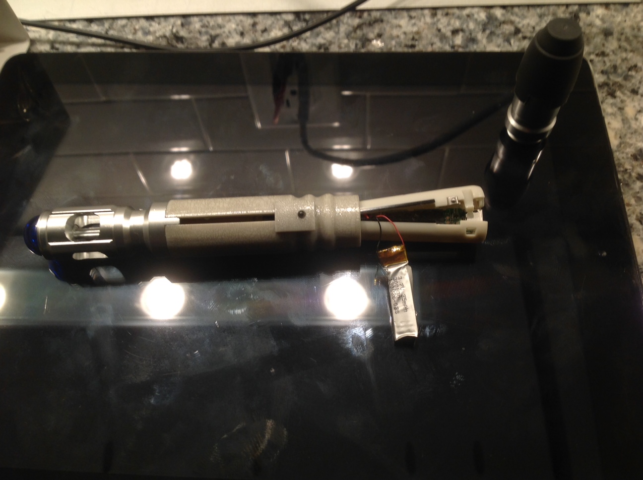

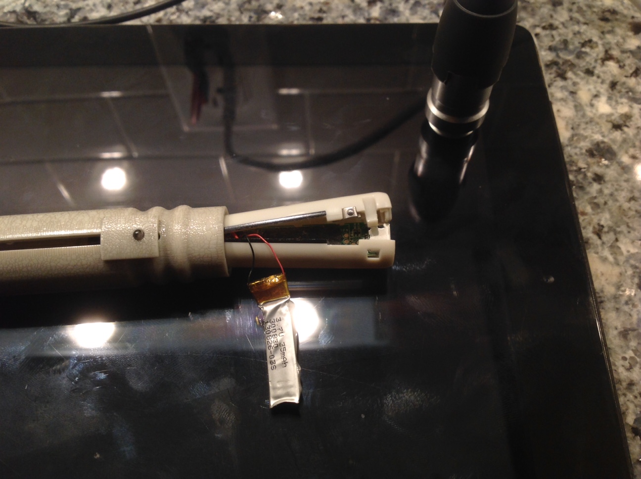

Just throwing this out there, there is really no need to pry the top handle assembly apart to change that battery. I just unscrewed the bottom spread the plastic piece apart with a fingernail and worked the battery out carefully. Un-solder, replace, push plastic housing back together and screw the bottom on,done. About 10min
View attachment 840685H
Hey how does your battery come out soo far?
Just unthread the bottom piece, remove it, and make sure the screwdriver is fully retracted. The charge port section will stick out that far...
The battery wires are long enough for the battery to come out that far. Just unsolder the wires AT THE BATTERY end.

It just slid out like that. Do have a pic of what you are working with?
How do you get the battery out of the casings as it is connected to the charging port
Just open the casing slightly, reach in and pull out the battery. It is stuck down on some foam tape, so you have to carefully detach it from the tape. But after that, the battery will be able to come out the gap you have made in the casing. Then just unsolder it at the battery end. Like phez said, post some photos.
