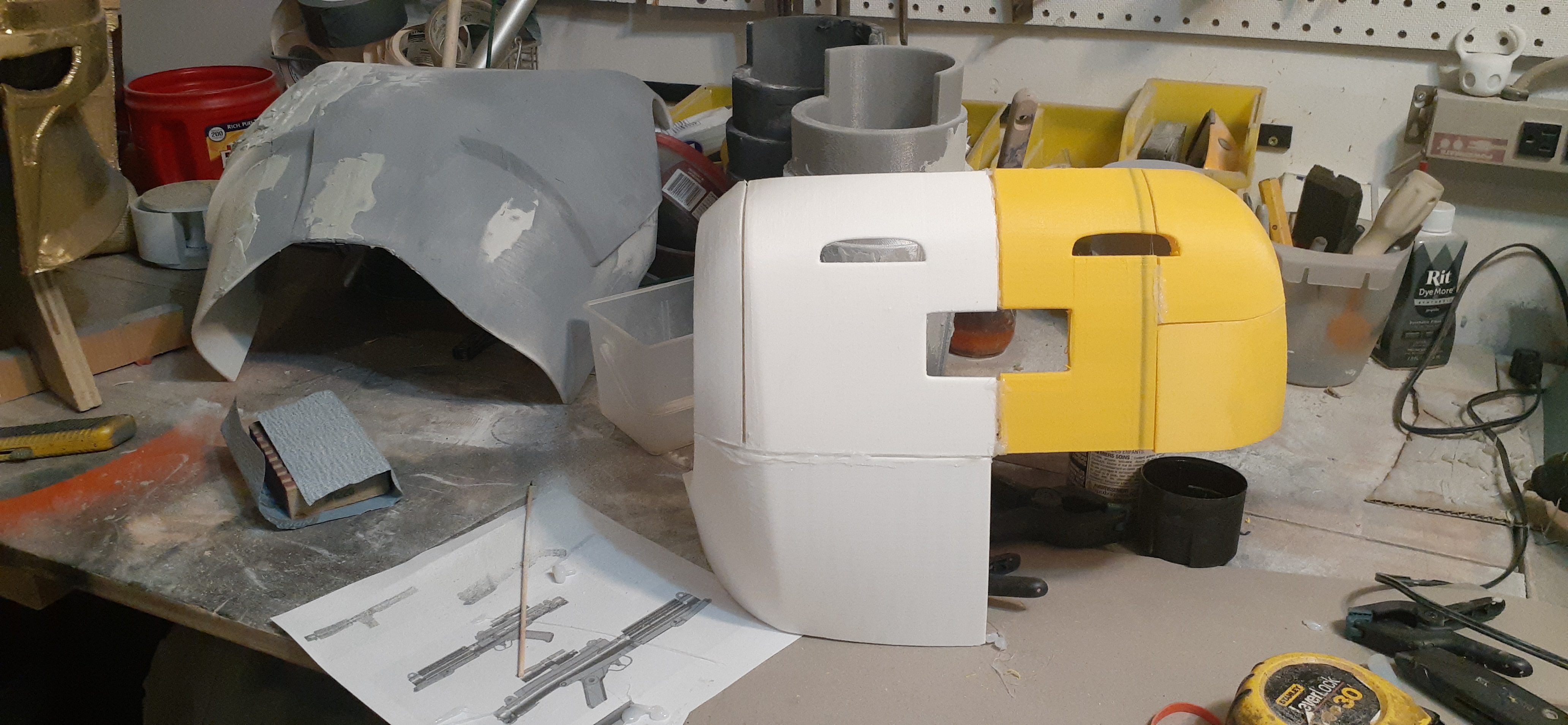

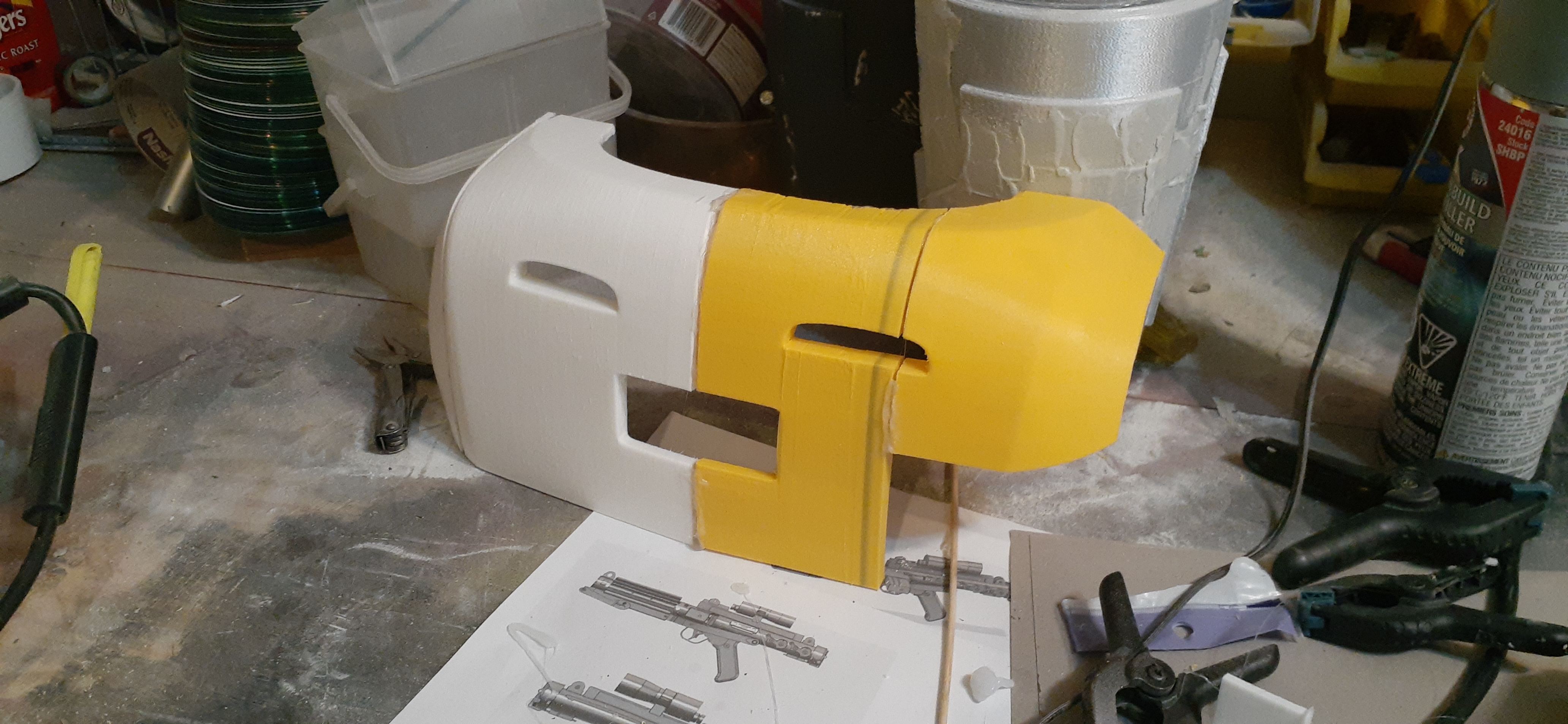

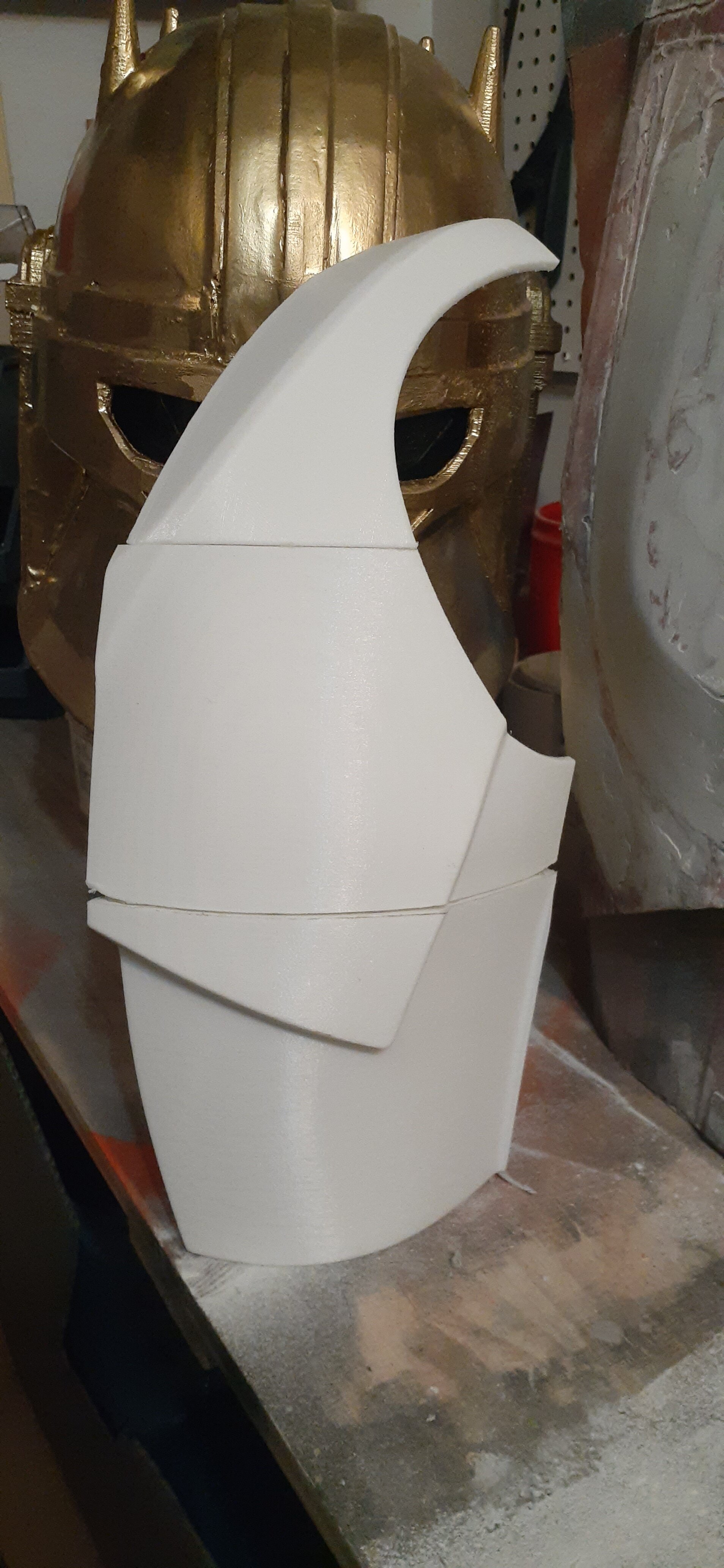

Got a new reel of PLA yesterday, as well as approval of the model I put together for the machine donor. Life is complicated by a sudden hospital admission for my wife (non-covid related, but scary as hell and, for the moment, without any easy answers or release date. It feels like making armour at this point is weird and disrespectful, but so is sitting around staring at the TV or the walls. My kids and I are working things out between us, so in the meantime, I'm keeping projects running to stop my brain from running.

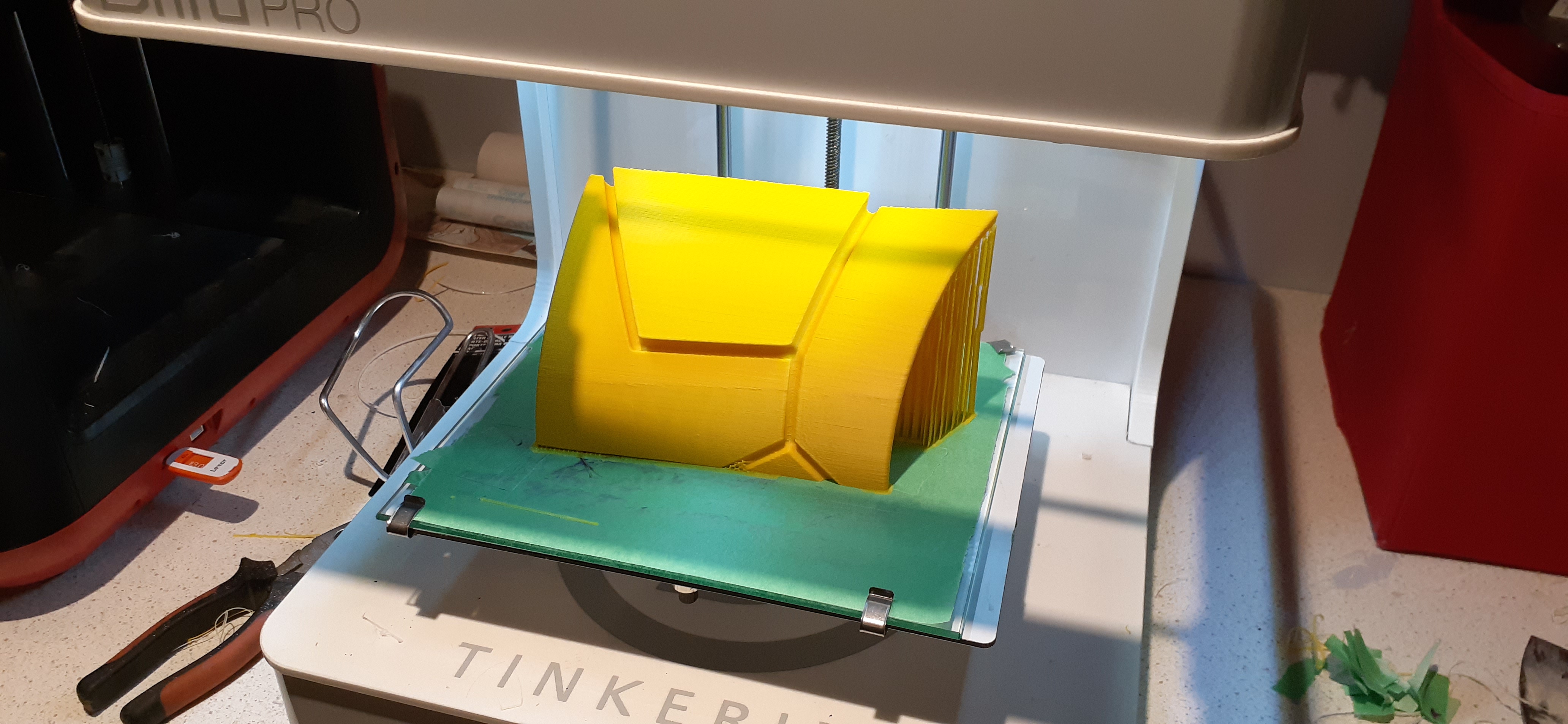

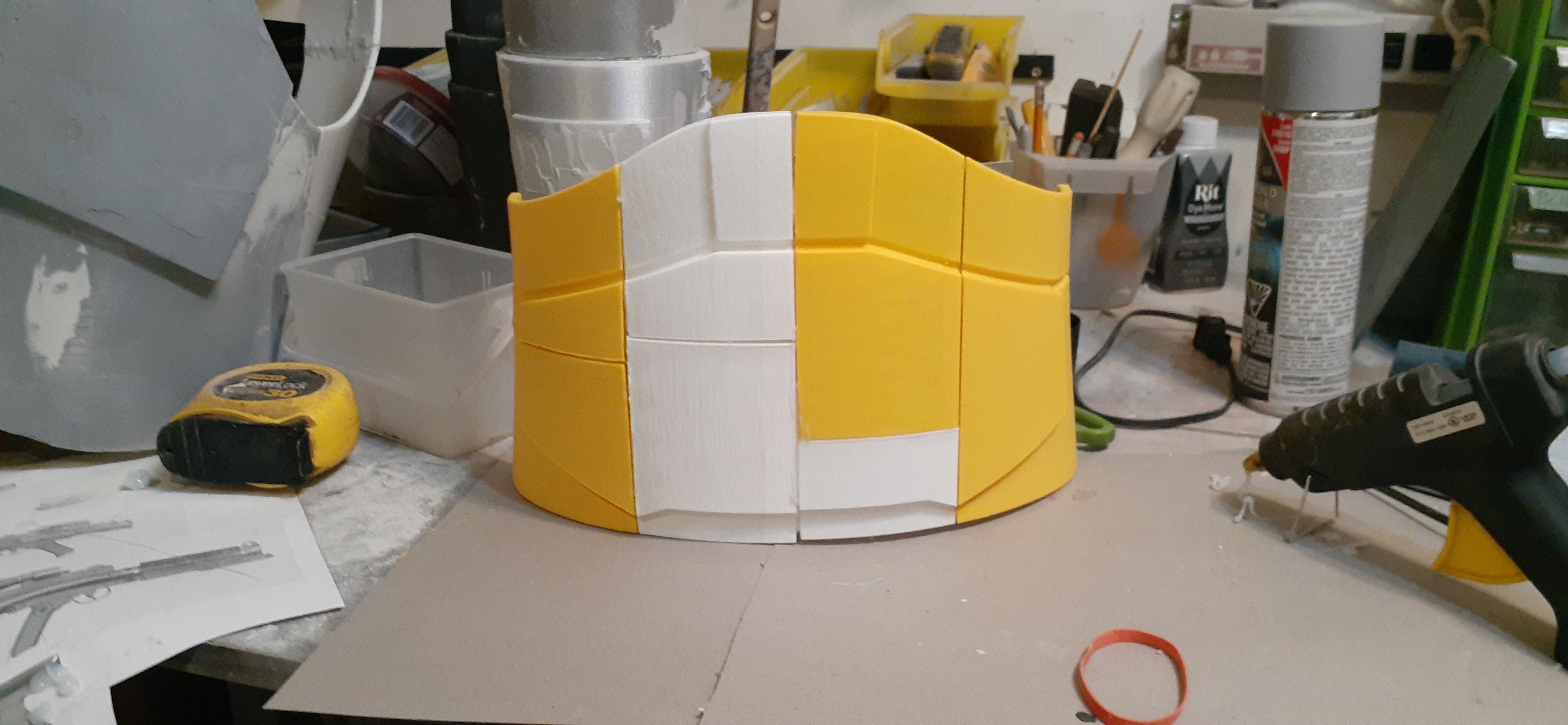

The larger bed size of the Tinker means I can cut down the number of parts I thought the chest would have to be split into - it's now 10 instead of twelve. The first three are together already:
Gratifyingly, it's about the same size as the foam armour I made, so that wasn't as much of a muck-up as I thought.
The fourth piece is printed off, and waiting for the fifth piece which is probably finished by now, but is at home while I'm at work.
When those two get attached, that'll be the left half of the front of the chest piece. Five more, and I'll have the whole front done. I'm more confident about printing the whole thing now, because the chest was the largest piece, and with a decent plan for how to slice it, I'm happy I can do the other large pieces too.
Dtrasler

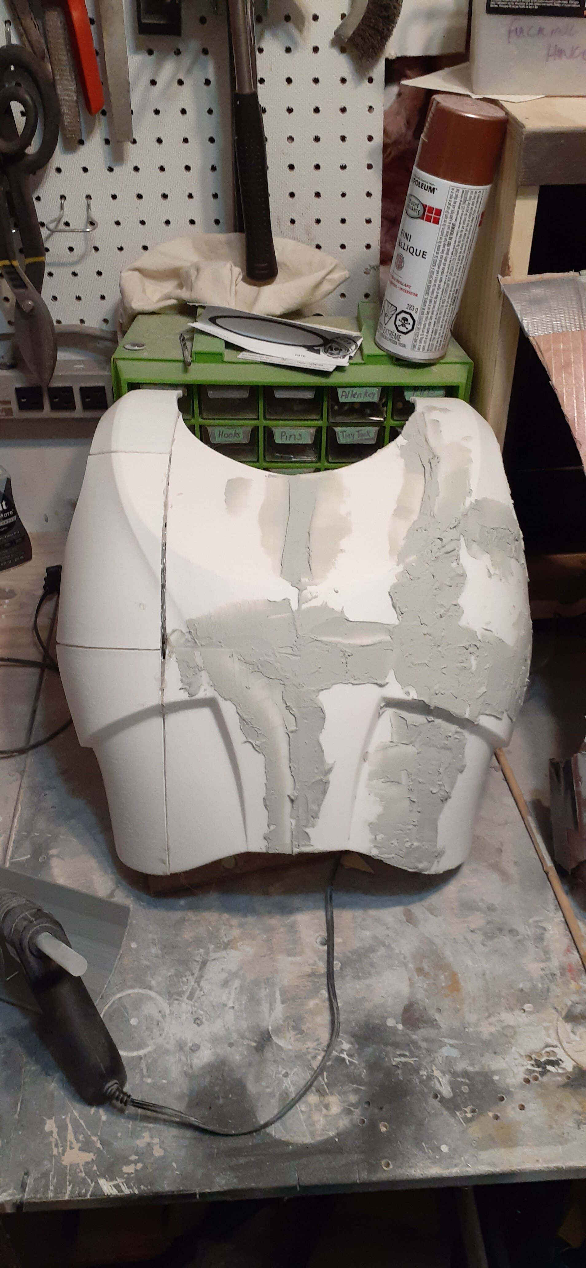

Got home and put the other two pieces together with the three I already had. There are still some ugly gaps - the printing isn't spot on, but it fits quite well, considering. Next I get to slice the other side!

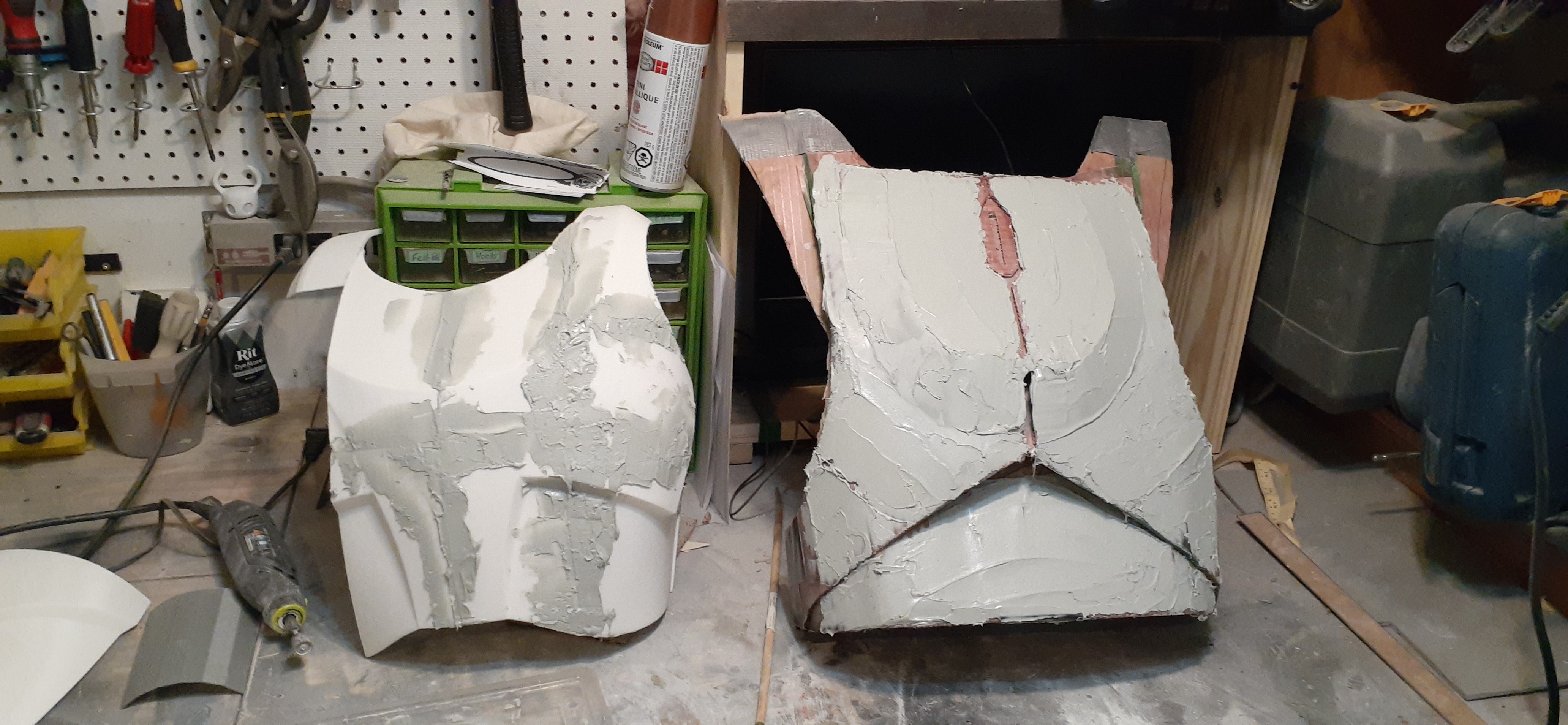

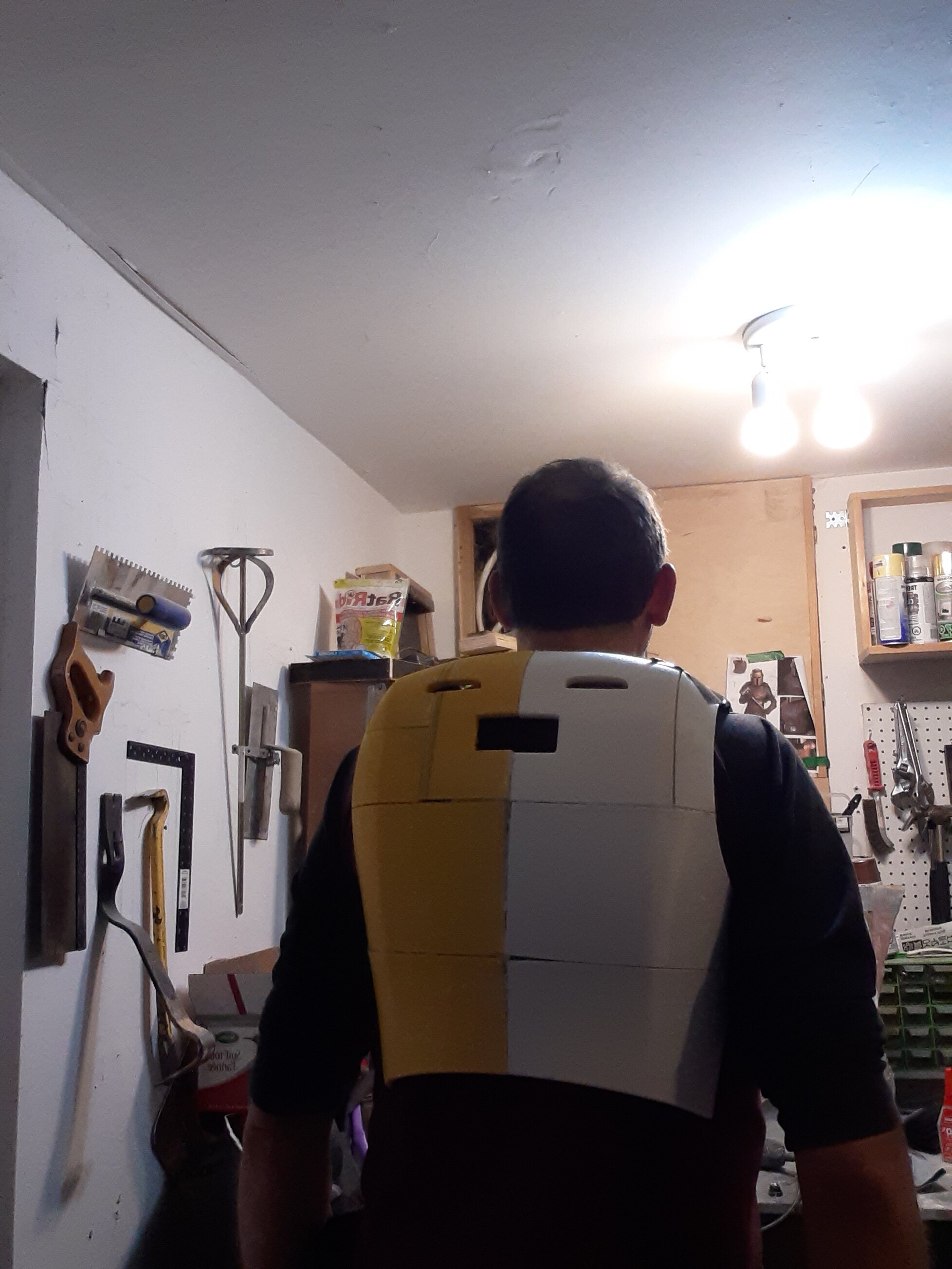

Ten parts, and I have a complete front chest piece. That brings the tally of 3d printed parts to:
1 front chest piece
2 shoulder bells
2 biceps
2 gauntlets
2 glove plates
I guess the next question is, while I sand and bondo and sand and bondo and sand and bondo and sand again, what should my printers be working on? The back half of the chest piece? These large pieces take ages to print and even longer to assemble and surface, but I should be being REASONABLY logical about this, right?

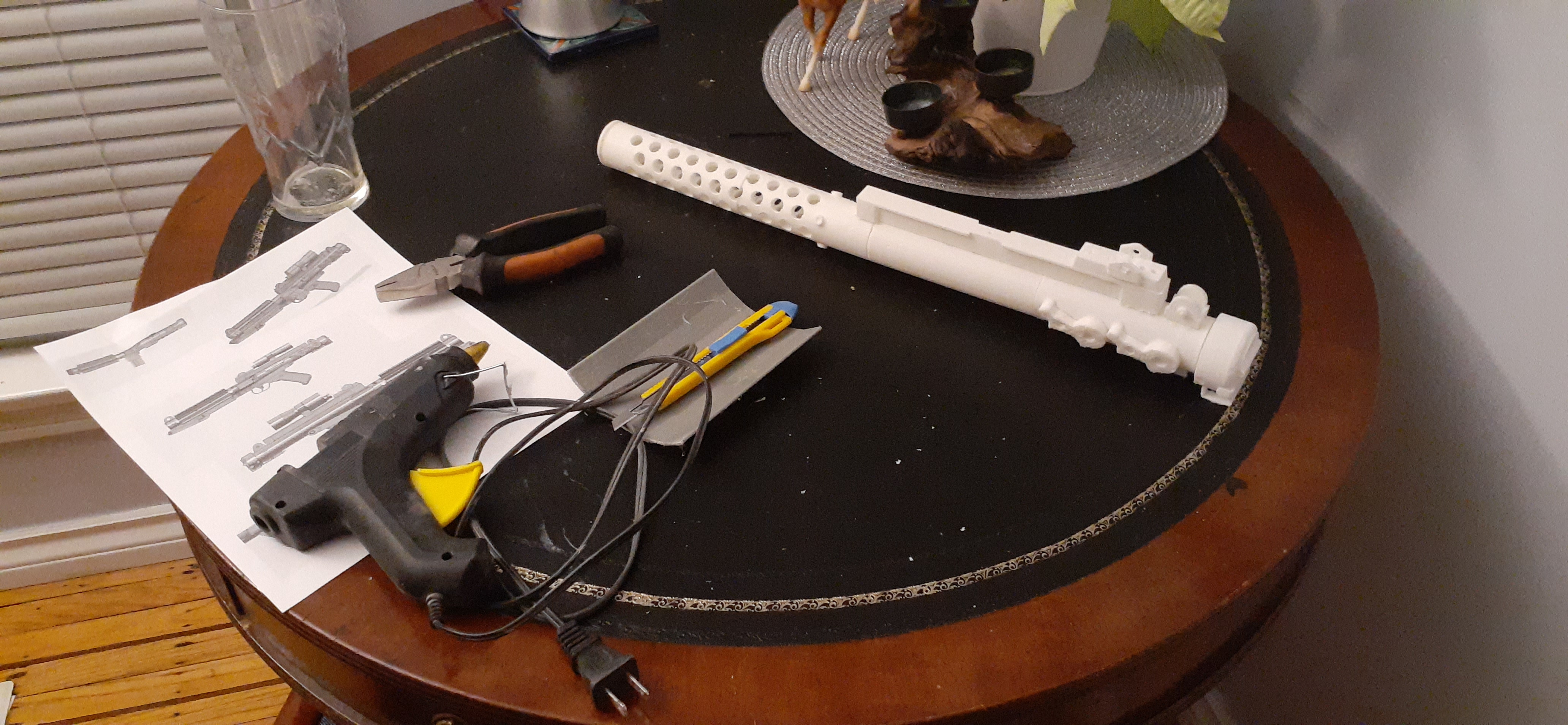

Lucky for me I ALSO decided to start work on that E-11 I don't need, have no instructions for, and can't store. Got the main pipe and the endcap printed. 19 pieces more to print, but at least one of those should be printed multiple times.

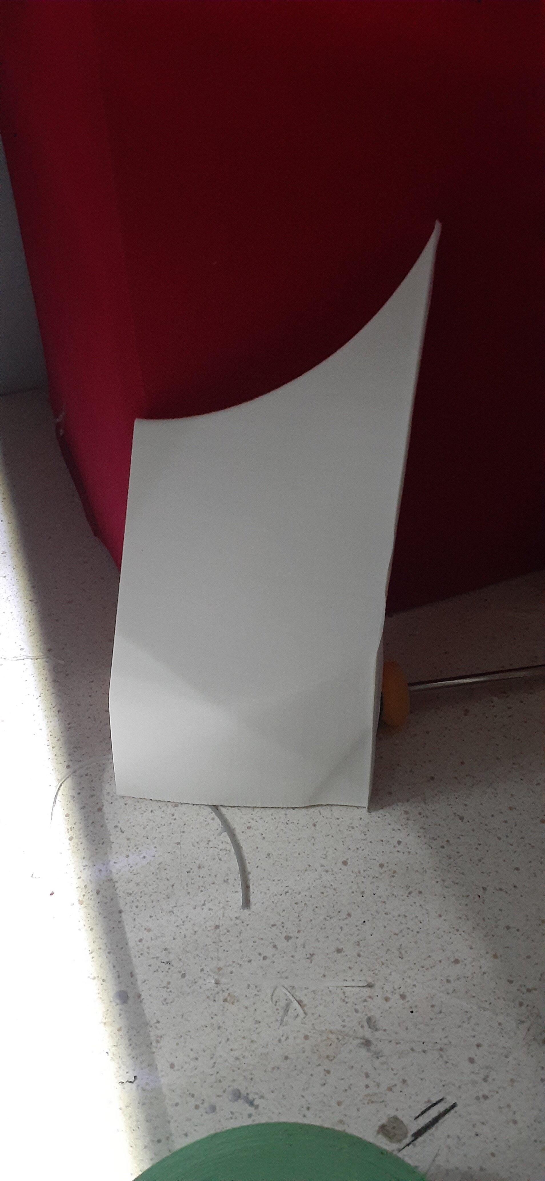

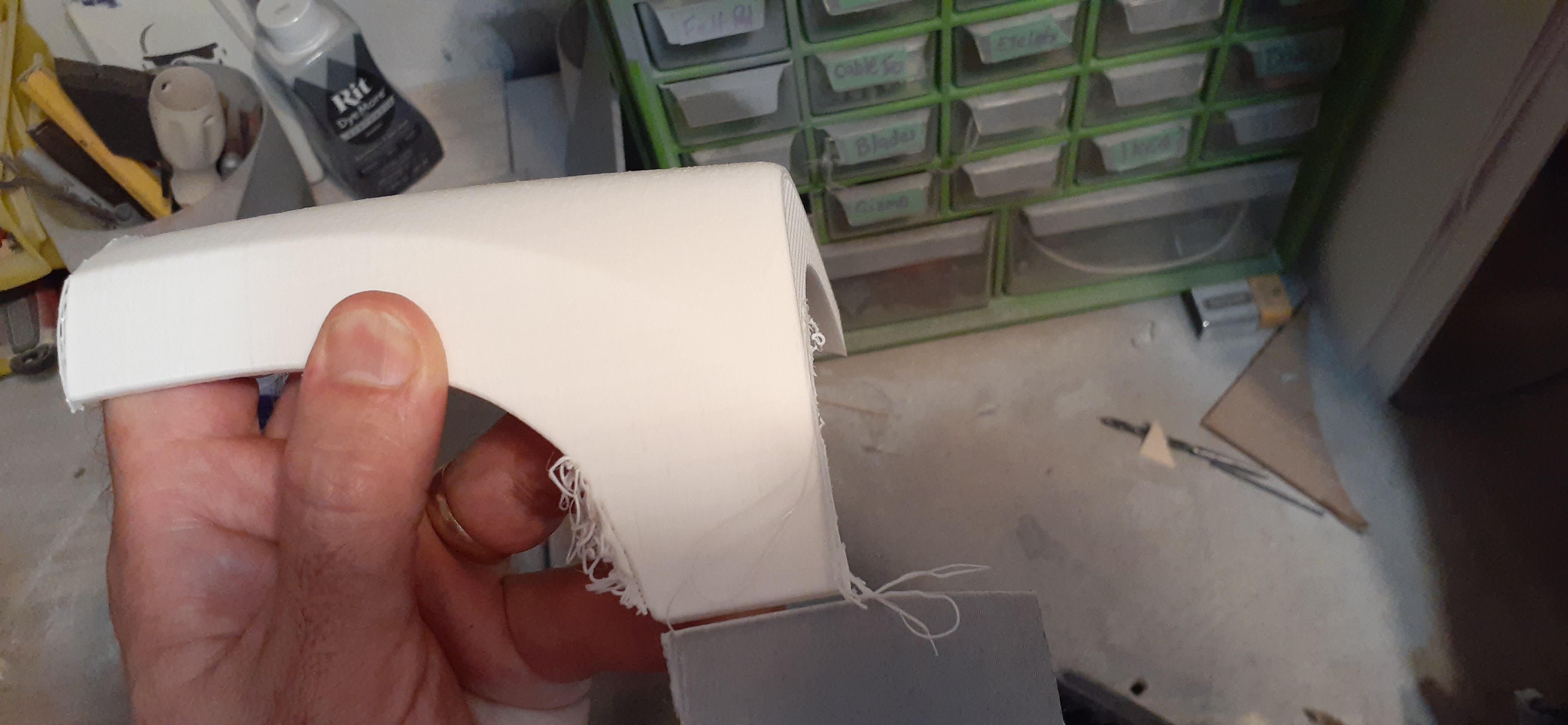

Here's a couple of pictures of the print fail. I think I might be able to re-slice that section and print the missing part. It won't be perfect, so it'll fit in well with the rest of the build...
Meanwhile, the E-11 that I don't need and shouldn't have started is doing well.

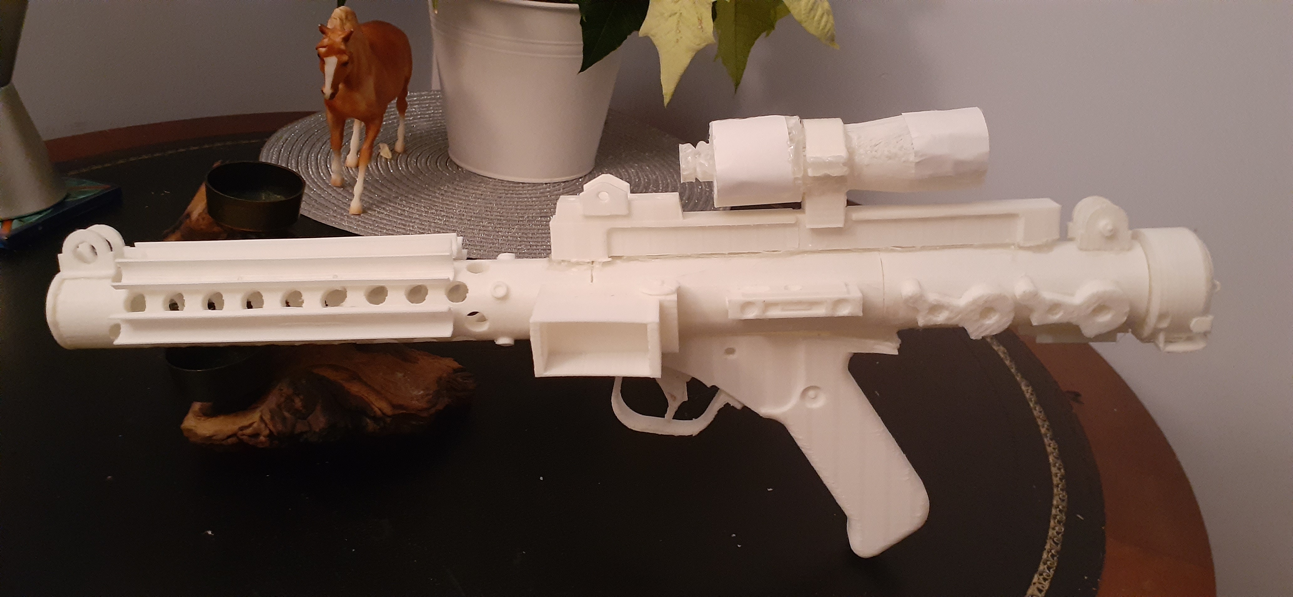

Ooops.
Messed up on the placement of the U-tracks, had another printer fail with the scope which I've patched for now. The whole thing looks like it's made out of plasticine...But I love it! Still have the magazine and the folding stock to print, then I get to paint it. However, tomorrow Middle Kid goes in for Wisdom teeth extraction, and we're still waiting to hear when my wife comes out of hospital. Might be a busy few days.

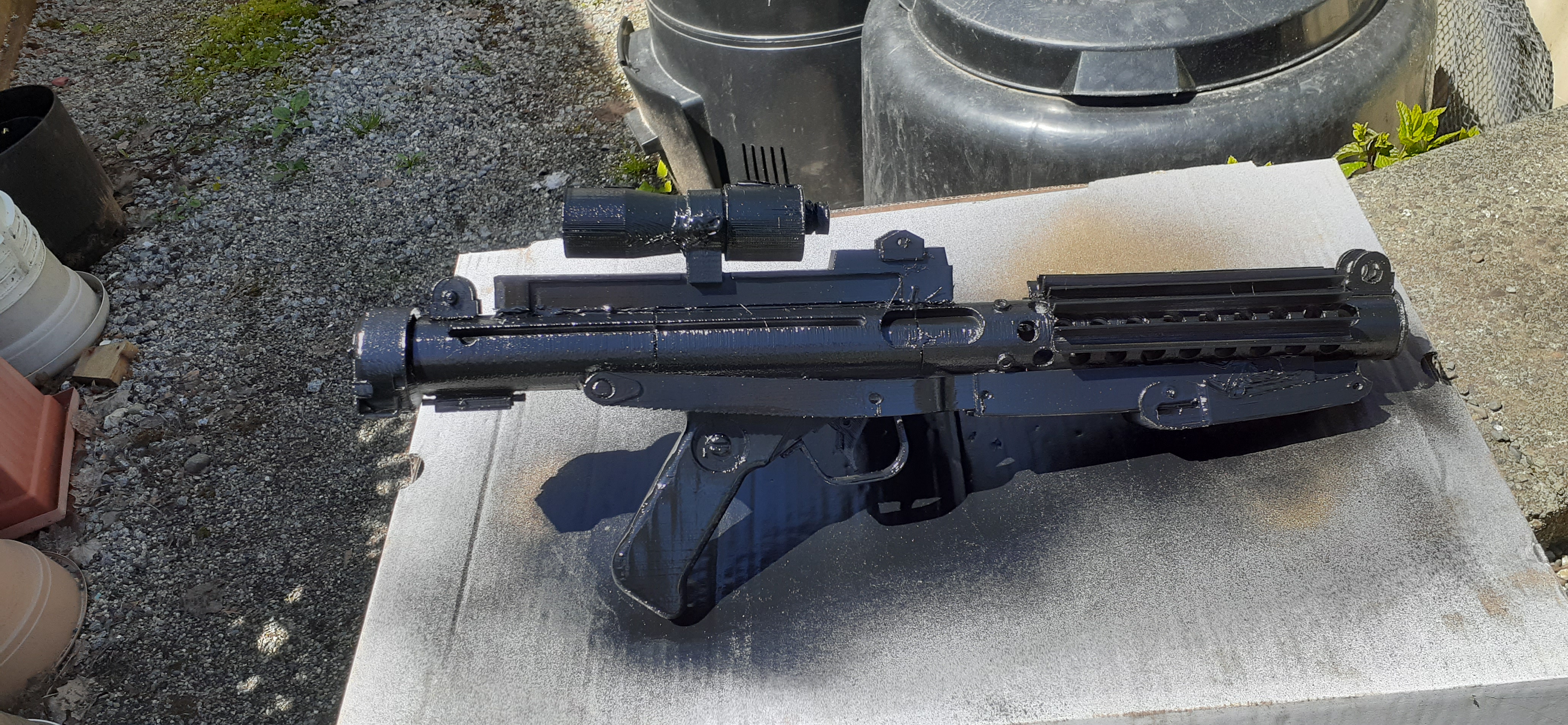

Yes, it's ugly and badly-constructed, but it's the right colour, and it's all mine!
Gonna get back to the armour soon, but I think I need a new reel...

So, me and the Tinkerine have some serious discussions ahead. I was counting on that bigger print bed to produce the sections of the back armour, so i could make it in six pieces, not twelve. I set up the first one, and luckily checked the print time before I set it running. 18 hours. Call me "Old Mr Impatient" if you will, but that seemed like a LOT. So I took the same piece, cut it into three and fed those numbers into the Finder. Each piece would take around 2hrs to print, and two of those were on the "less than" side of two hours. So why does ONE piece take three times as long to print?

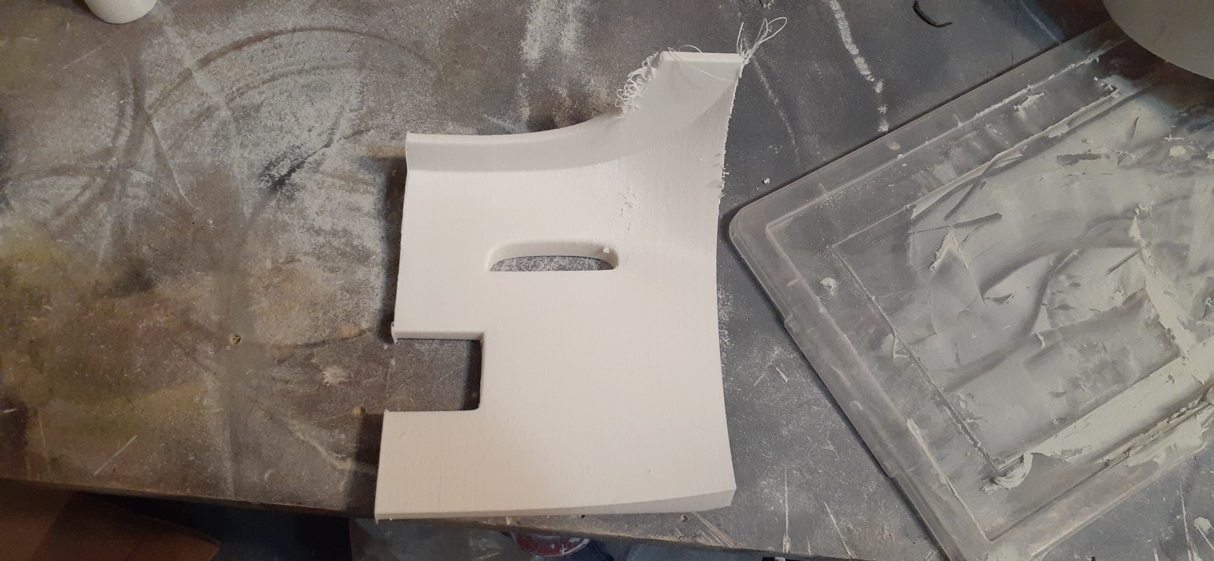

Finally I downloaded the user manual to check the Tink's density settings. I'd noticed it defaults to 18%, which doesn't seem like a lot, but I have been winding it down to 5%, which is what the Finder uses. The finder also gives you the option of lines or hexes. The Tink does not. Then I remembered the cross-section photo I got of the first piece of back armour from the fail print. That was supposed to be at 5% too, but it looks like this:
That seems like a pretty tight weave for 5%, right? I mean, if that's 5, what's 50? And besides, here's what I found in the User Manual...

The pieces from the Finder are working out ok (if somewhat yellow...), and I think Tink and I have come to an arrangement. The next piece is printing out now, with considerably less infill.

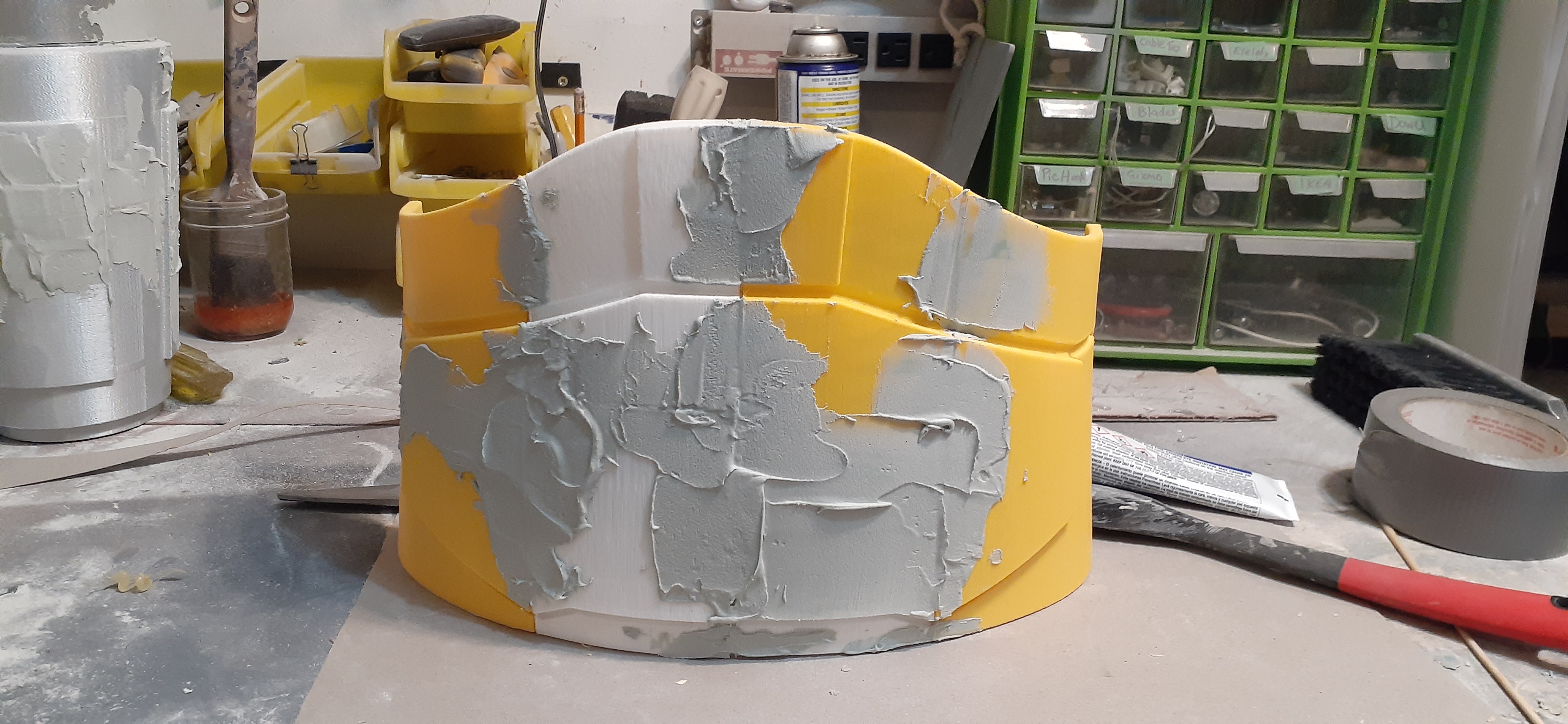

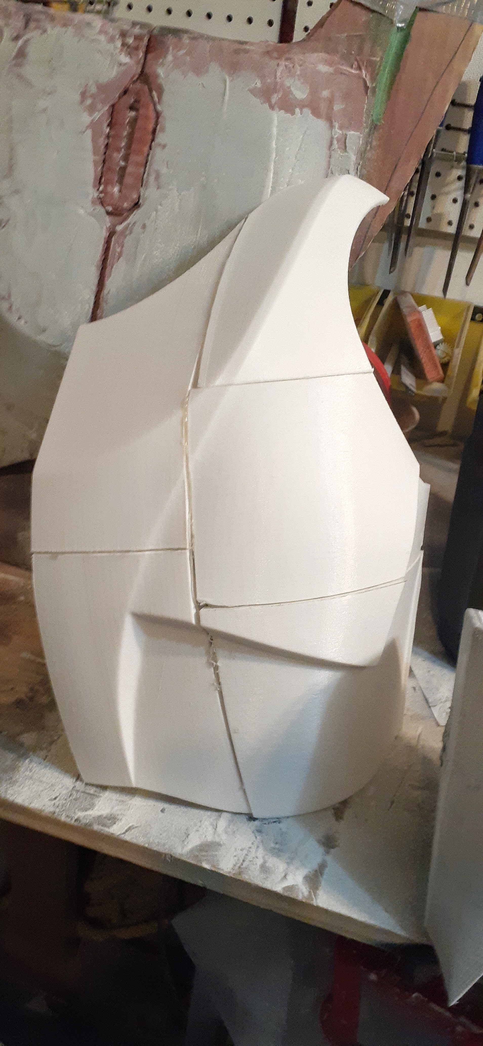

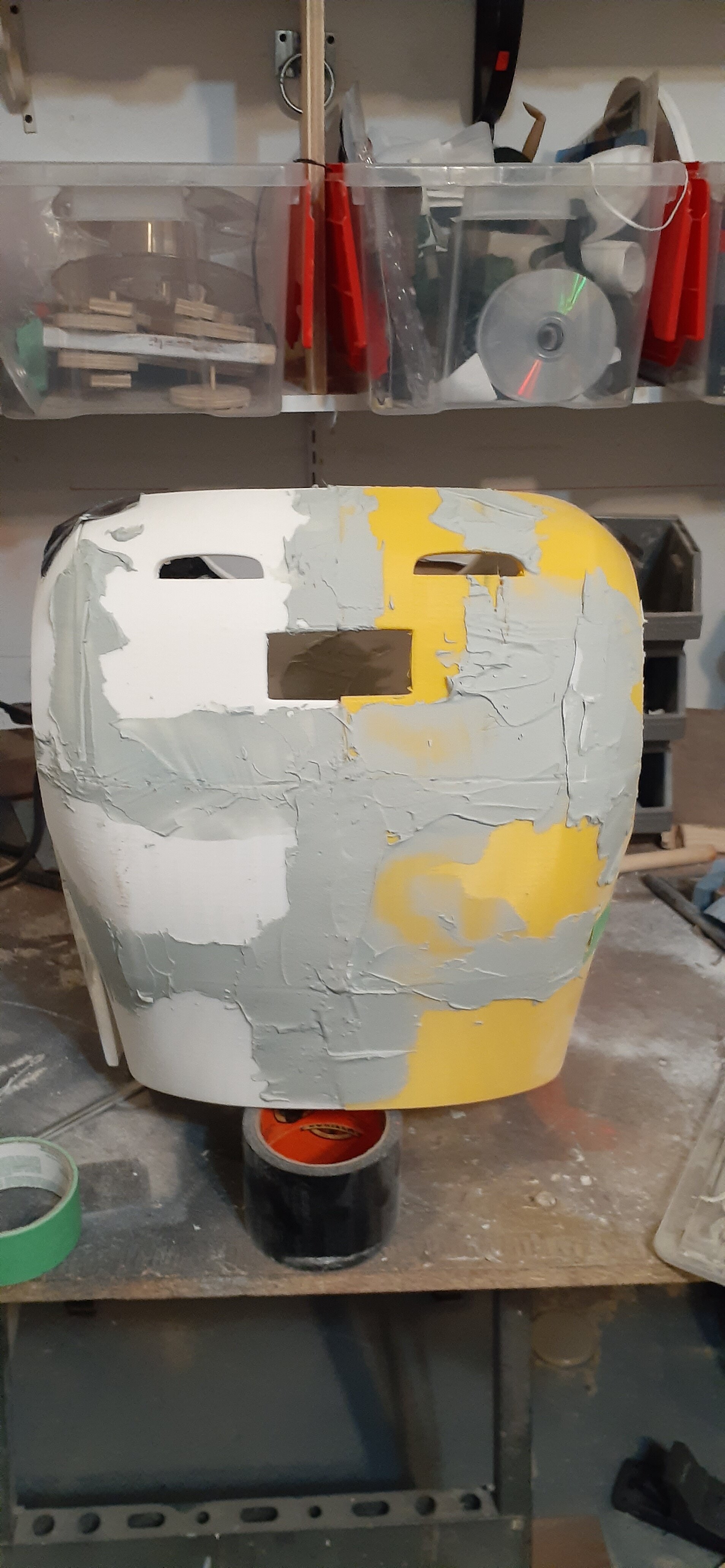

SOOOOOOO much surfacing work to do!
Oh yeah, and the abs, the lumbar, the cod, the butt, two knees, two thighs and two shins. Ten more complete pieces.
