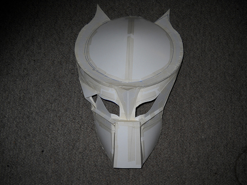

OK, I'm now attempting my first custom bio build, and since I've never worked with clay, ever, and doubt I have the artistry needed to sculpt/cast, I'll be using the cardboard (well, posterboard, actually) and paper mache method. Wish me luck.

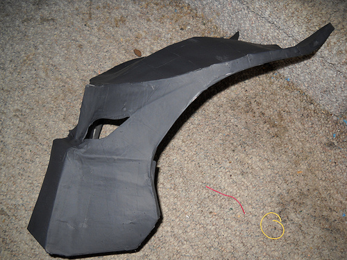

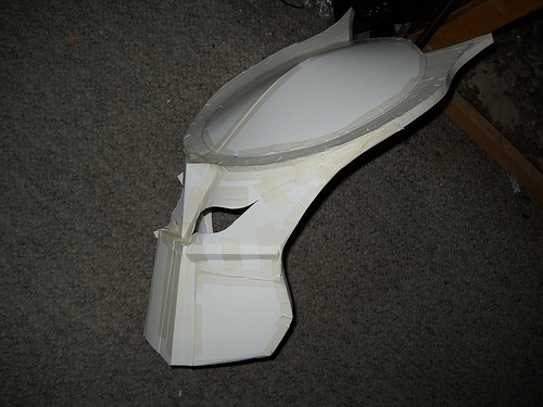

I spent the afternoon knocking together a mask. Nothing fancy--just something based on the P1 bio. I was searching yesterday for a printable template to download, and having put a mask together, I now understand why there aren't any--the whole thing requires lots of custom cutting and adjusting and fitting, and the only way to produce a template would be to make an entire mask and then cut it apart--and even then all the rounded shapes would make it hard to produce a flat template. So I ended up just doing the whole thing by eye until I got a shape I liked. Here is what I ended up with:
Next step is to start doing layers of paper mache. I'll update with new photos as I progress. And if I mess it up, I'll let everyone know how I messed it up, so everyone can avoid repeating any mistakes I make. This is all new to me, so I'm viewing it more or less as a low-cost experiment.

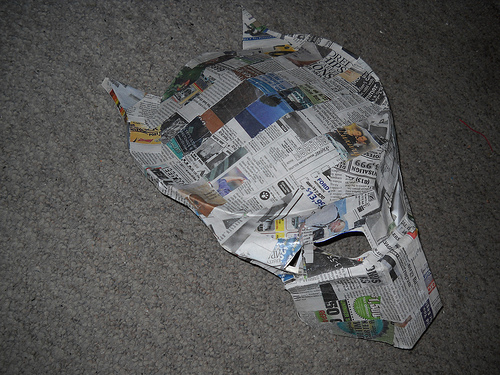

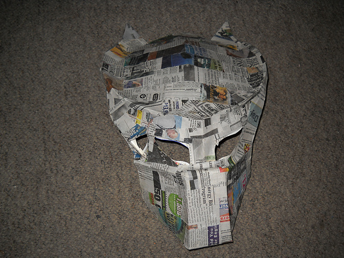

First coat of mache is drying (I'm using newspaper dipped in watered-down Elmer's glue).
I was thinking of finishing it off with a layer of Bondo fiberglass, but maybe I'll try the Cellu-Clay instead. Is it a brush-on or a smear-on?

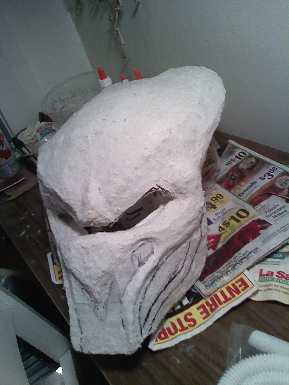

Kind of either, depending on how thick you make it. When I make mine, I do it with around 1/3 of an lb. of the mix and about 10oz of water, so it's pretty thick, and that way i can smear it on with a pallette knife and sculpt with my hands where needed, and if you use a pallette knife, you can make sharper edges pretty easily by scraping across. will still usually be rough-ish, but like i said and can be sanded!
I have not yet used fiberglass or Bondo, but I'm used to regular art supplies, so I'm fond of paper and glue based materials. Plus once it's done you can coat with more glue to strengthen it some more!
This is what i've done with it so far, sculpting on it not quite done however

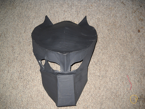

Three layers of paper mache added.
Next step is a final coating to harden/weatherproof it.

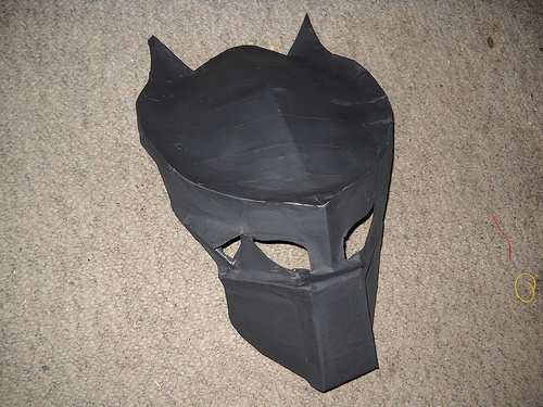

Mask has now been coated with two-part marine resin, and painted with primer. Wow, the primer makes every little seam, flaw and ding scream out.
Next step, joint compound to fill in all the little seams and dings.

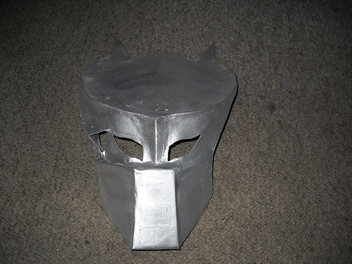

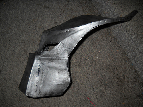

OK, the joint compound is dry, another coat of primer, and now the silver undercoat:
Next step, weathering with a wash of black paint, then adding the lasersight and some hoses.

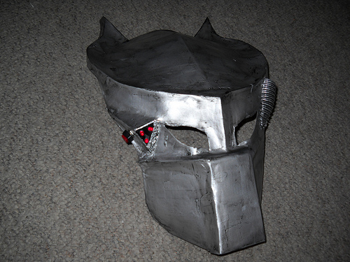

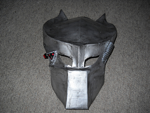

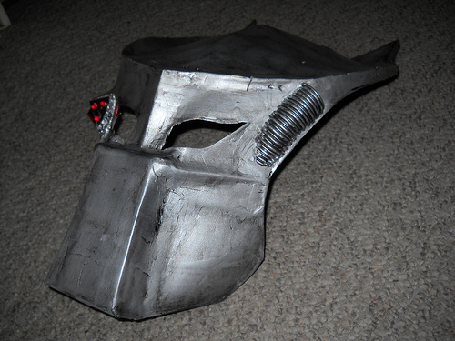

Added the lasersight and the air filter.
Next step is some dreads, but first I want to play around with a few different textures for the dome part and maybe the cheeks.
I'm likin' it so far, considering that it's basically made from posterboard and masking tape.
Lflank

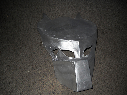

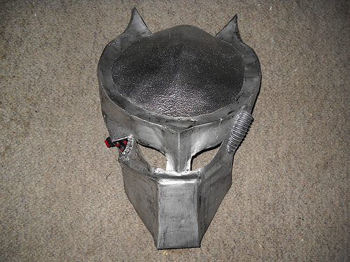

Sprayed the dome part with some pebble-texture paint, then coated that with silver and weathered it with a little black.
I like the texture contrast. I considered doing part of the cheek pieces the same way, but decided that the bio looks pretty good just the way it is, and I'm happy with it.

hey flank good job making your own. i have one suggestion. is that the toggle switch sticking out the side by your lasers?
i would paint it silver to match your helmet, it would blend in a little bit better. look less like a button
Lflank
Yeah. I've been trying to find a smaller switch, too--haven't found any so far.
