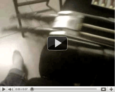

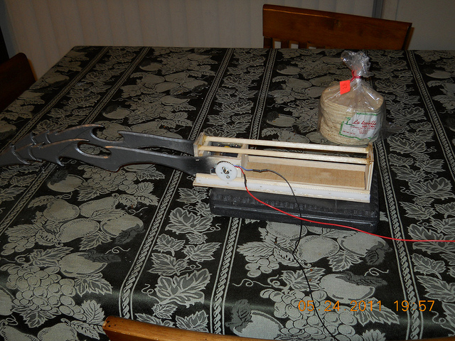

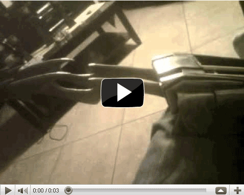

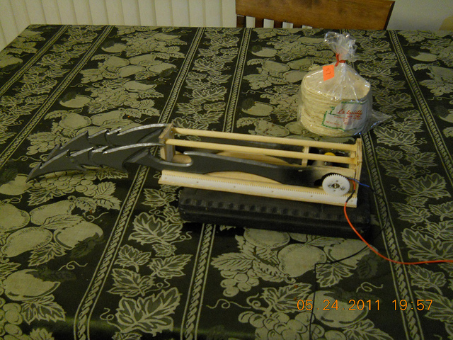

Here is an update of the Wrist Blade with it being automated.
With the help of Elkman (Todd) He gave me some pointers and shot me in the perfect direction of what I needed to do to get this working properly.
Thanks Elkman.
Video can be viewed here.
http://www.youtube.com/watch?v=9ROVtElfA1E
Retracted view of Wrist Blade
Extended view of Wrist Blade
-James
I like the stack of tortillas on the side. Nice touch. I'll have to try that the next time I build a wristblade mechanism.
Seriously, though, that's good work.
