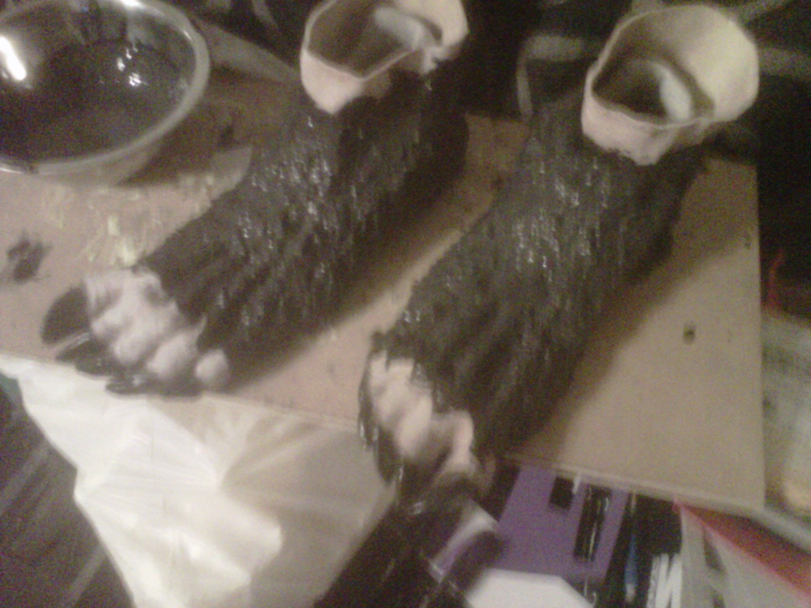

Okay so last night I was talking with Aaron1126 and telling him idea for the predator feet. I purchased these a while back once I started.
Monster Feet
So What I did was try the method of altering them like I have seen several Lair Members have with their shoes, name comes to mind is Vinmanmac, he used spray foam from Home Depot and then carved them into feet. The monster feet themselves are great but I thought they were entirely too skinny. So Sprayed them with the foam and tried to carve them to make them thicker.
Much to my dismay, it didn't work out so well, there were soooo many bubbles inside that carving became a nightmare. I removed as much foam as I could and was getting very upset as I thought wow. What a waste of time and money, the feet looked a mess. Well after pondering and telling Aaron what had happened. I decided well I have some latex lets apply some and see what happens.
The results after applying latex were simply amazing. the latex ended up smoothing out all the imperfections left by the foam and gave the feet a bumpy look that I always wanted on them and it thickened or widen the feet like I had originally planned. I will post some before and after pics tonight when I get home. ones my cell don't do it justice.'
But at least you get a sneak peak.
I will upload better pics.
-James
