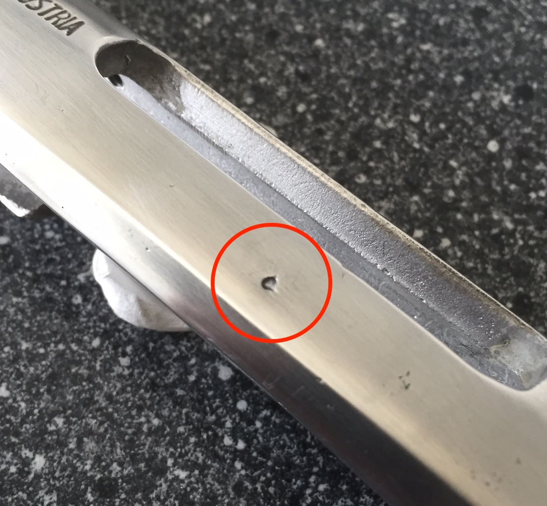

There's a tiny little hole on the receiver of the kit I'm building.... what's the best way to fill it up?
I can't get the damn solder to stick in the hole... any tricks?
I suspect my solder iron doesn't get hot enough, it's only 15W...
Any ideas?
I've been using a standard, cheap solder containing flux...

Hi guys! Thanks for chiming in...
Yes, I got in touch with Mr Coyle and discussed how to fix the hole.. pretty simple really, just never heard of the technique before... basically you melt a tiny bit of pewter down in the hole using a flux and a mini torch... sounded a bit scary at first because you have to heat the receiver itself to get the metal to melt together.. but I tried it a few times on some pewter scraps so I'm optimistic! Rich is sending me some of the exact metal type so the fix won't be visible. He is as mentioned a good and helpful guy!

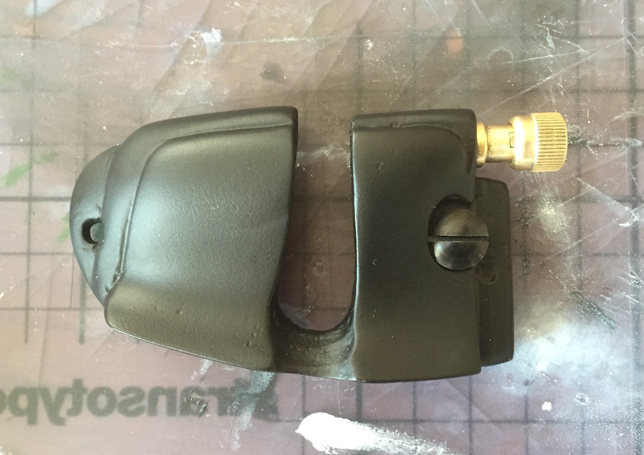

A picture of today's work... test fitting the slotted screw and binding post!
Re: My Blade Runner collection (Solder advice needed!)
Getting there Anders and yes, I love that slotted screw: more screen accurate!
No doubt in my mind that I had to go with the slotted screw on this one! The screw is from a Tomenosuke and the biding post is real vintage... I'm pretty happy with the look!

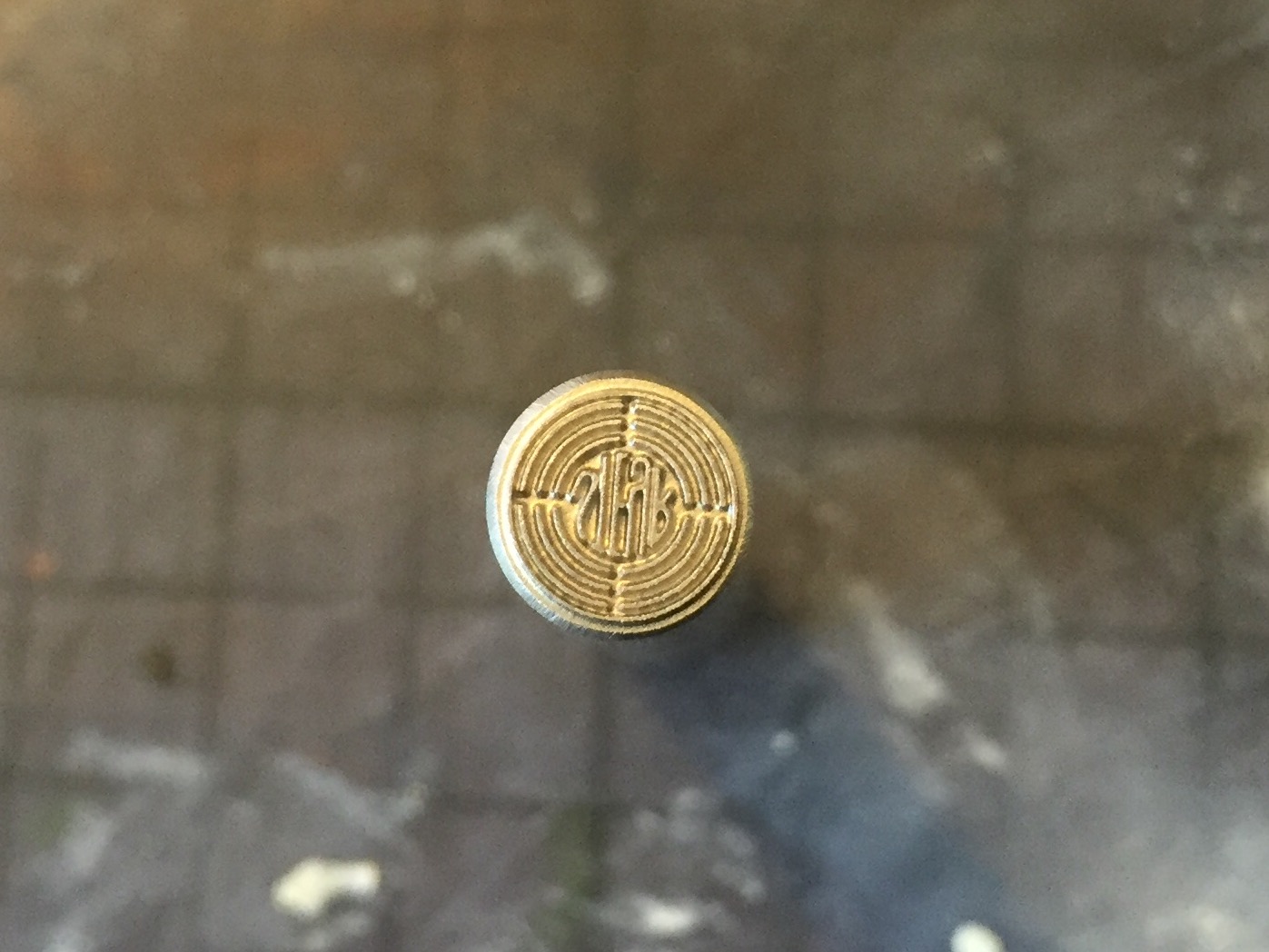

One of the things I have to tackle next are the markings on the receiver... especially the MOD SL part and the Steyr logo are unclear and almost disappeared during sanding... So I bought new letter punches and had a Steyr logo punch costum made to freshen up the markings :D I'll start by filling the remains of the old markings with new pewter....
I need to do some filling on mine as well so will be good to hear exactly how you did it.
I'll post some pictures when I get to it!
You'll need the same kind of metal and a flux to keep it clean and bind properly when you melt it in place...
