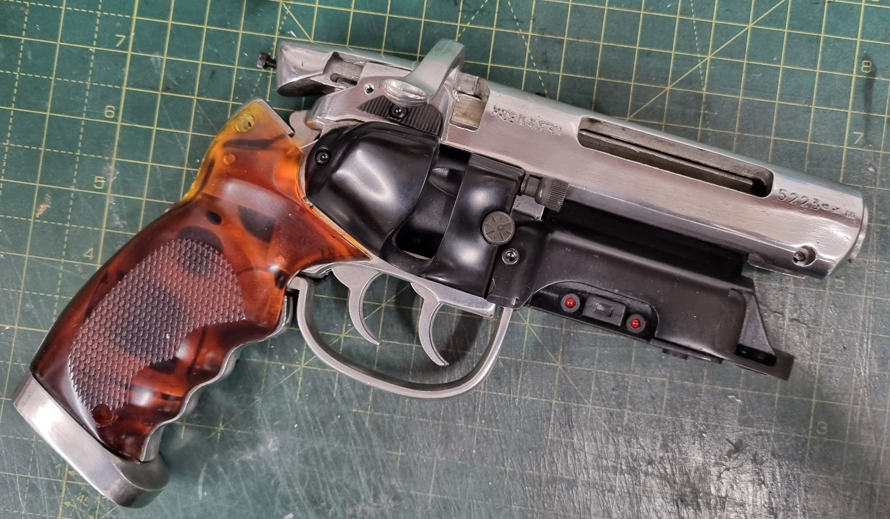

What kind of printer did you print your masters on? I didn't model the grip checkering into my snub blaster because I didn't think my printer at the time could do it without the lines being super obvious in the "valleys" but your grip prints and subsequent casts look amazing!
Are they just 100% Siraya Tech Fast resin? Or do you use another brand/mixture?
My Printer is a Anycubic Photon Mono X and I use Anycubic Grey resin, I did sand them a lot to get the master so shiny but I didn't do anything special to the "valleys". I do use a buffing wheel so I think that helps a little

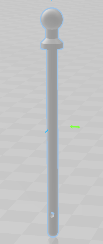

He has made a new hammer pin and has reworked his build guide to better reflect this kit.

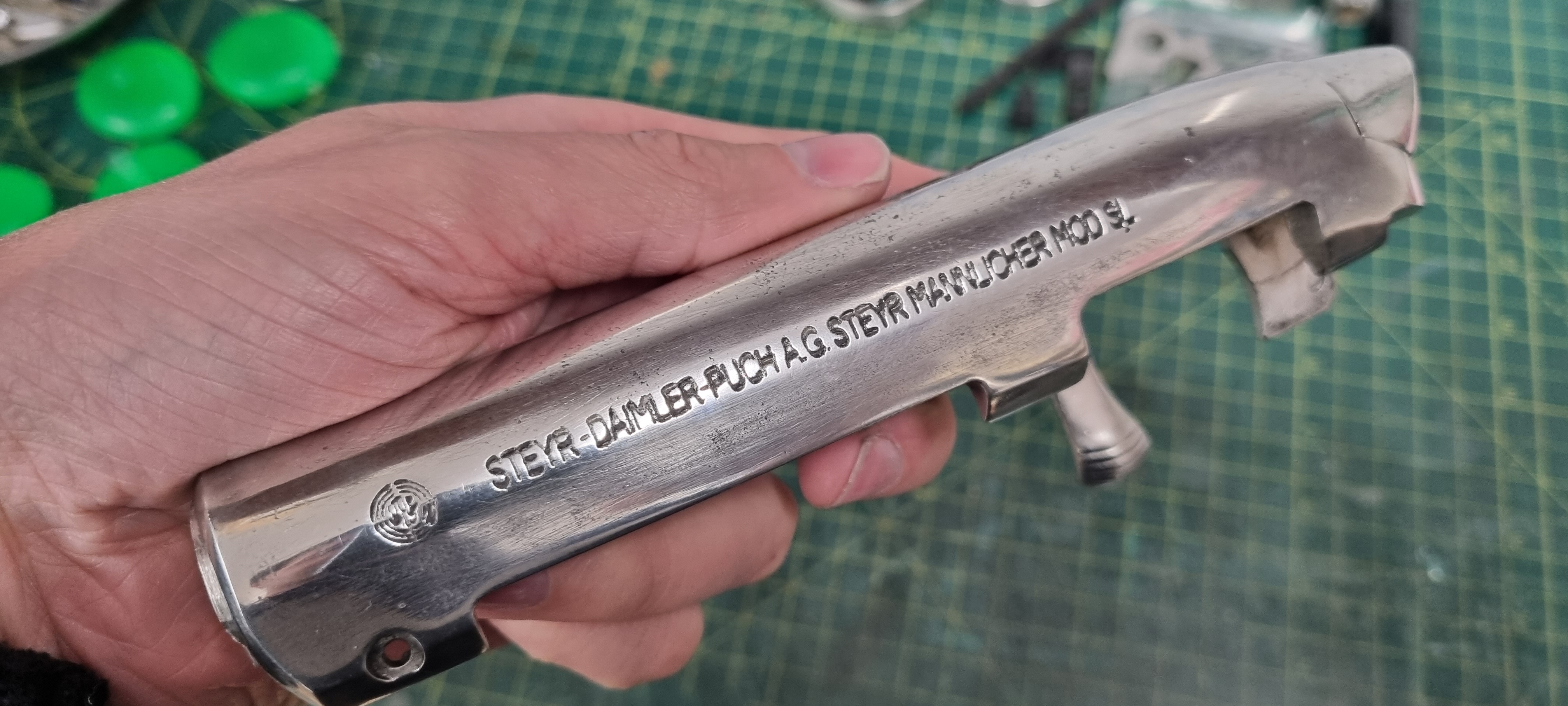

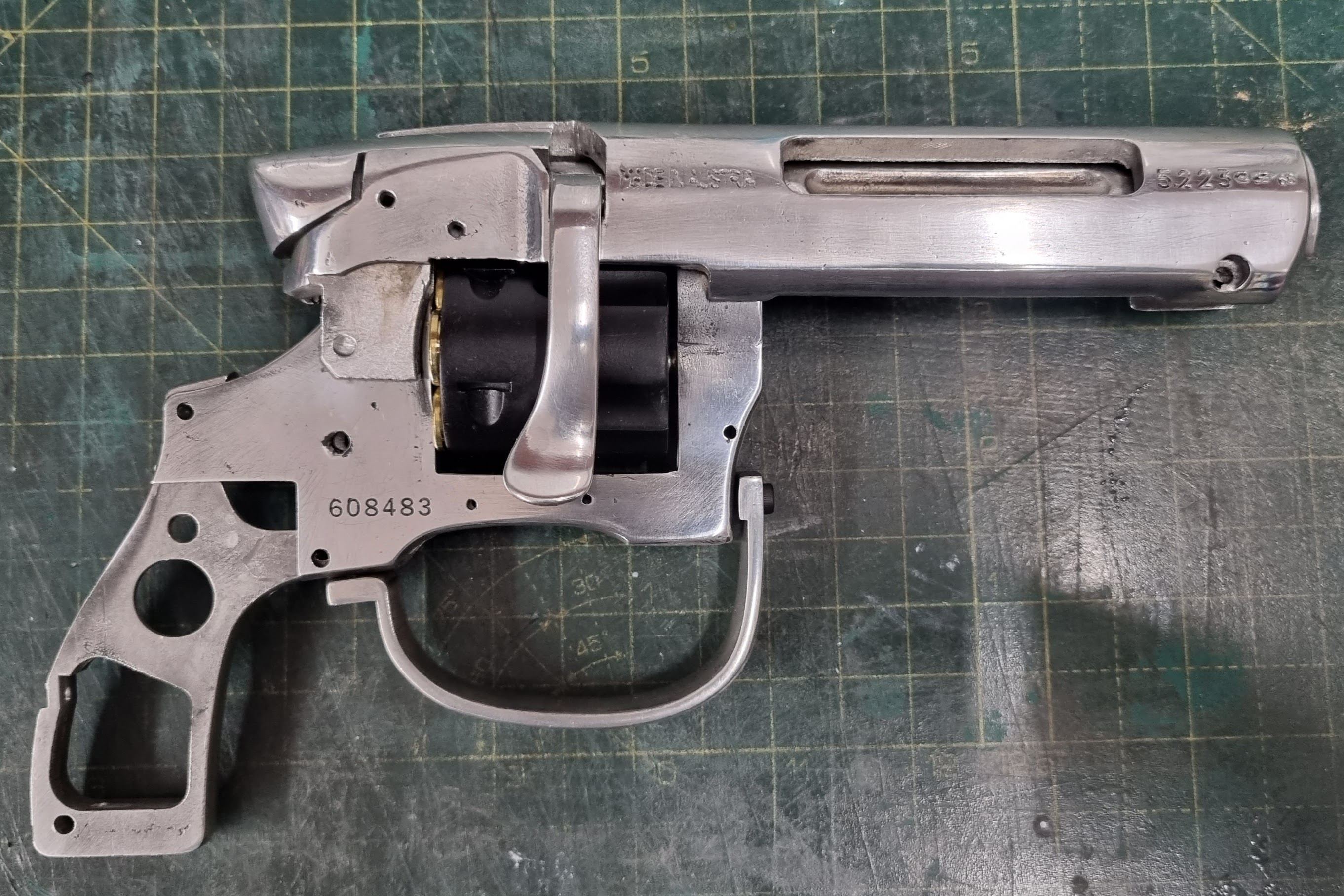

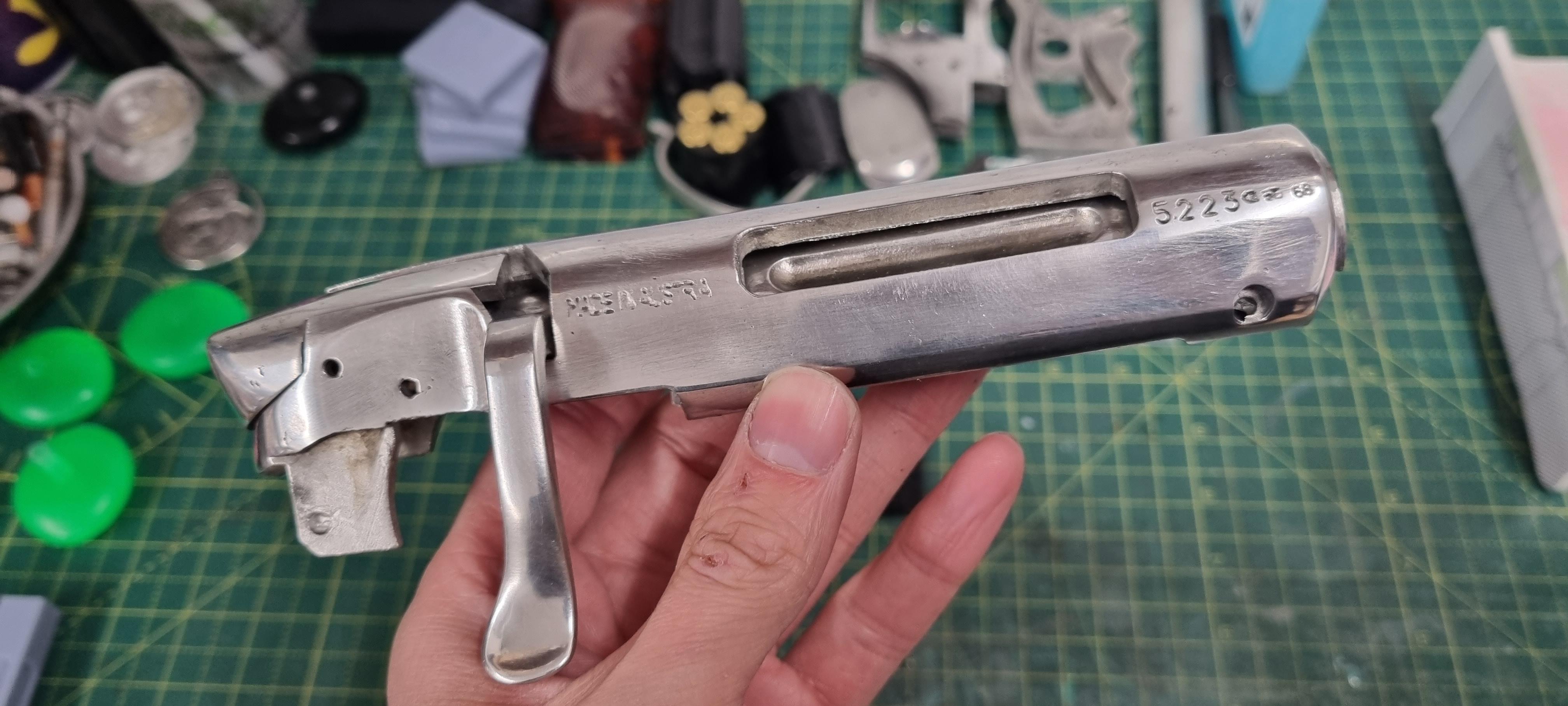

Wanted to show you all why I decided the Styer mould is a bust.
It may look nice and shiny but the text and detailing isnt very sharp :(

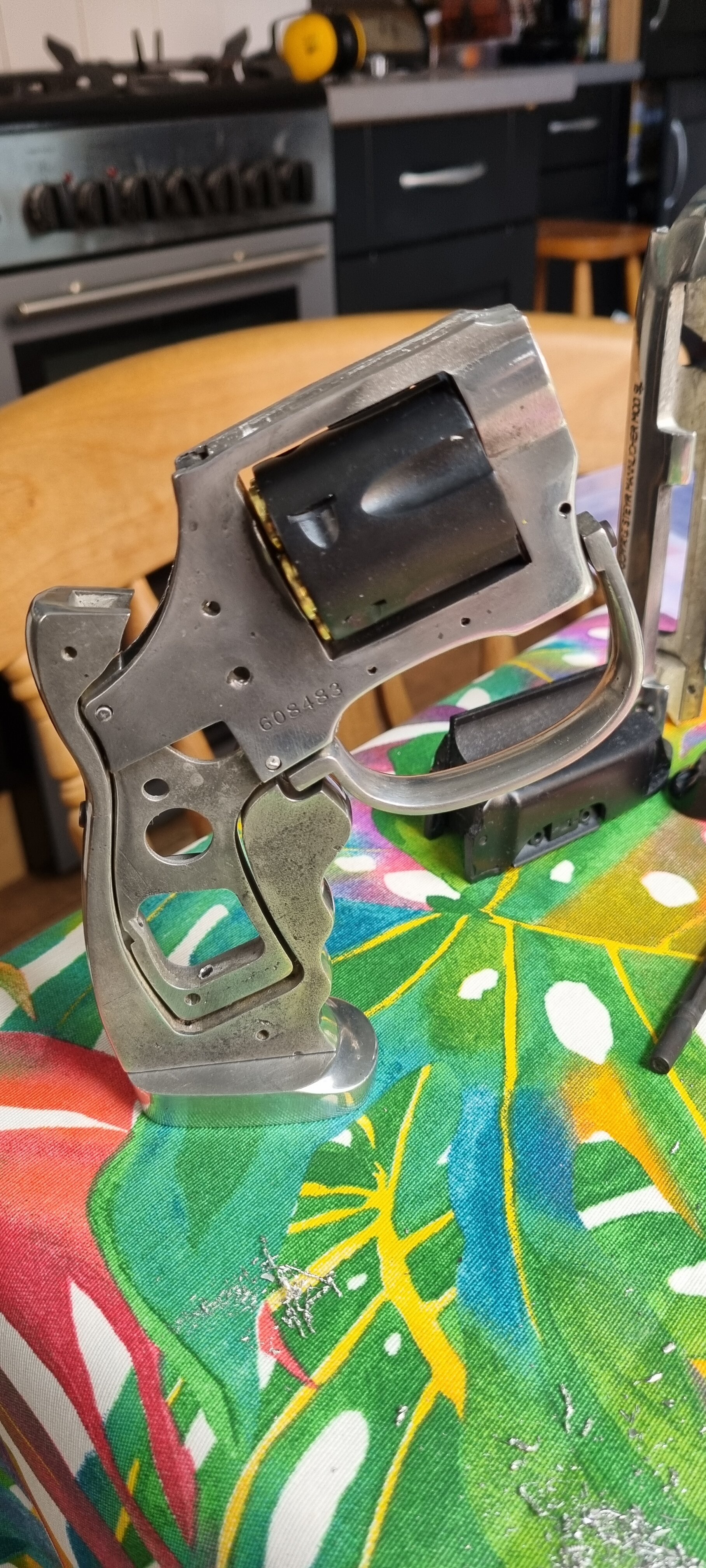

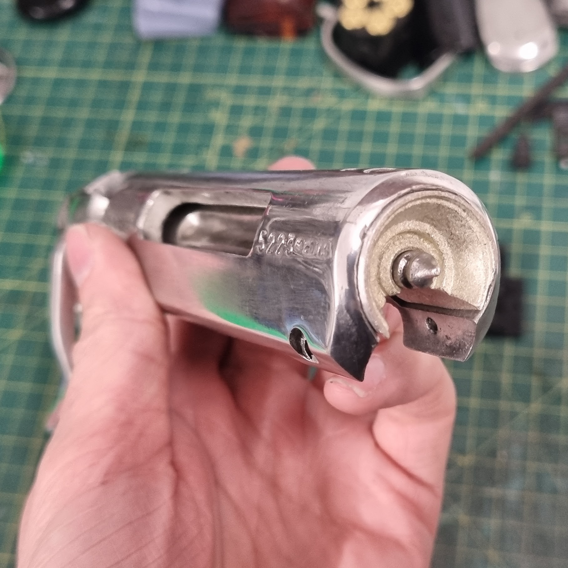

As this is my prototype I decided to build it up anyway as I needed to make sure the fitment is all good

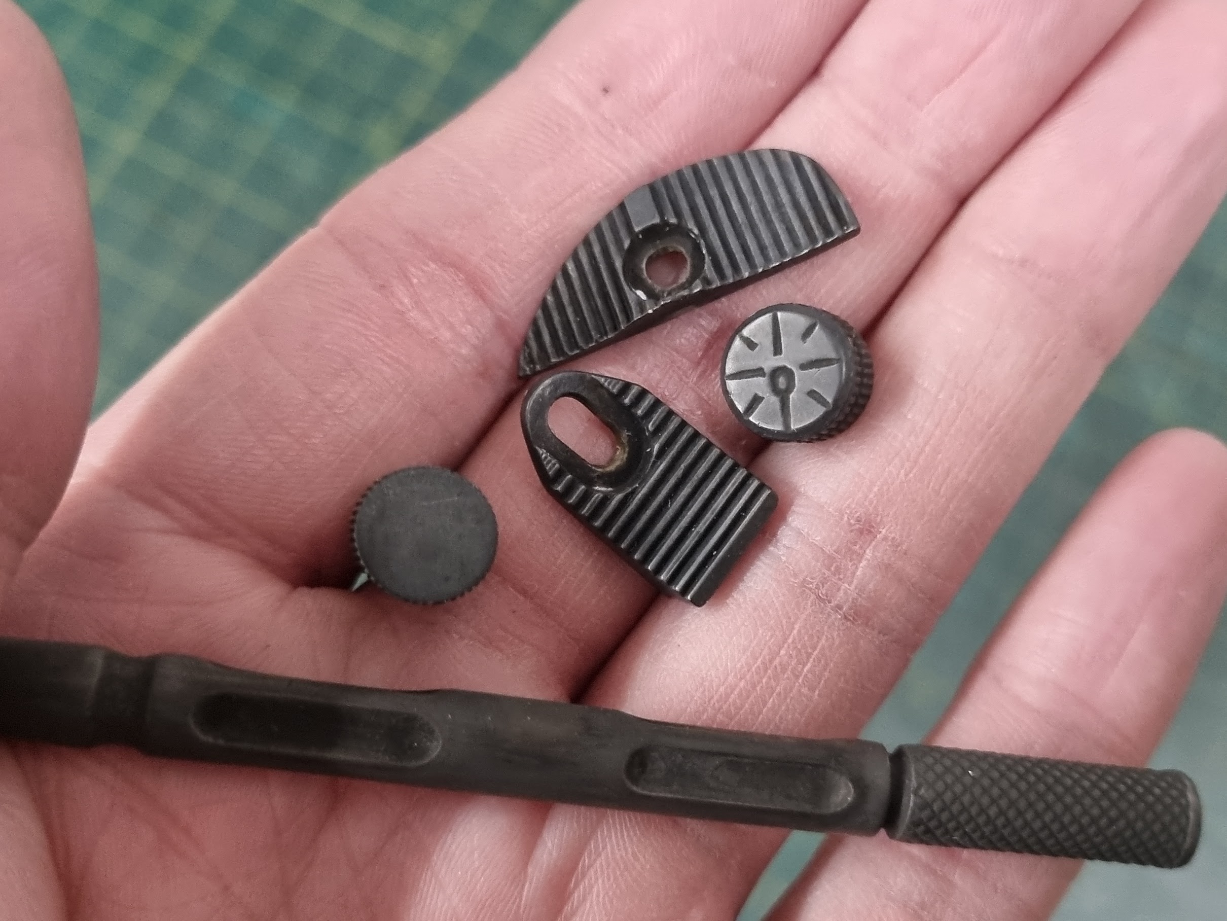

I used Pewter Black as a test on the small parts, Looks nice!

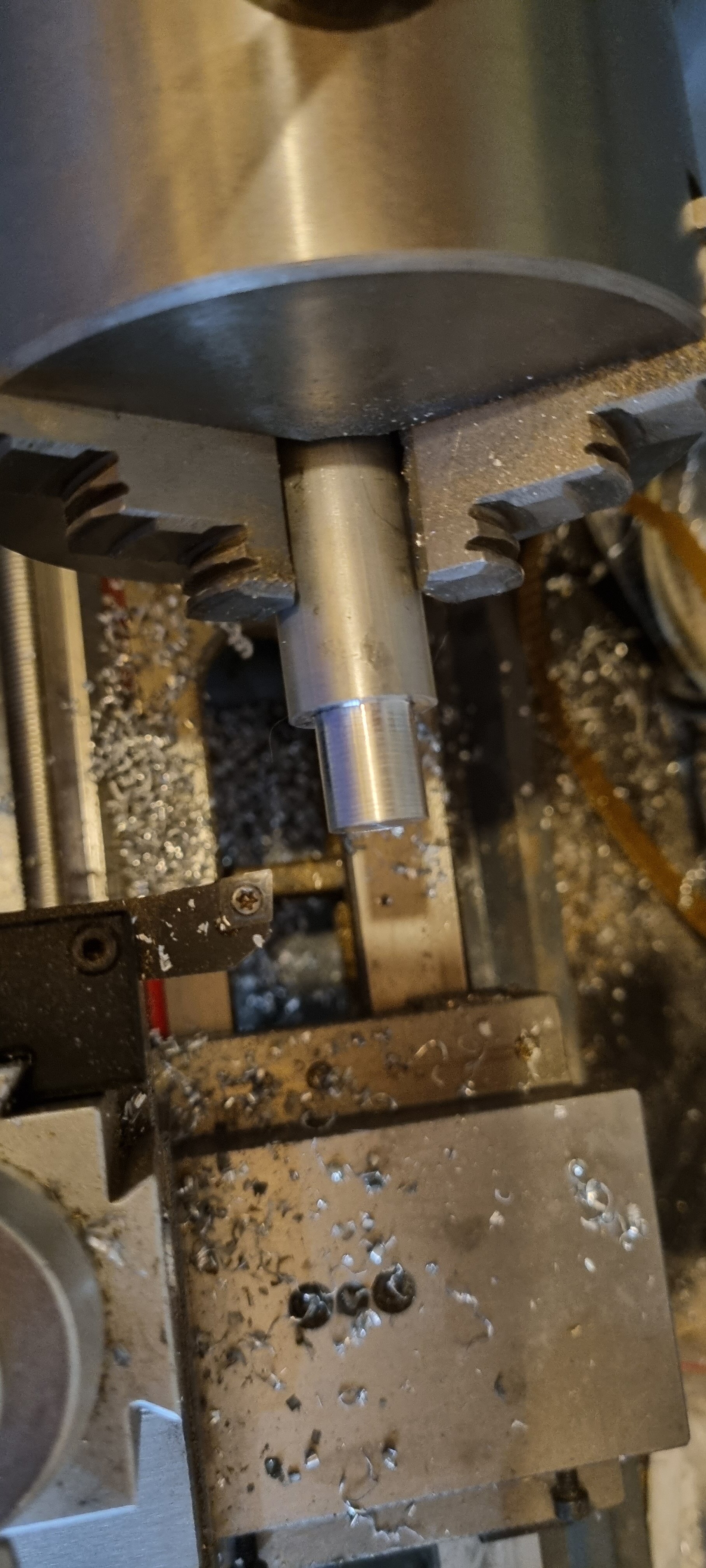

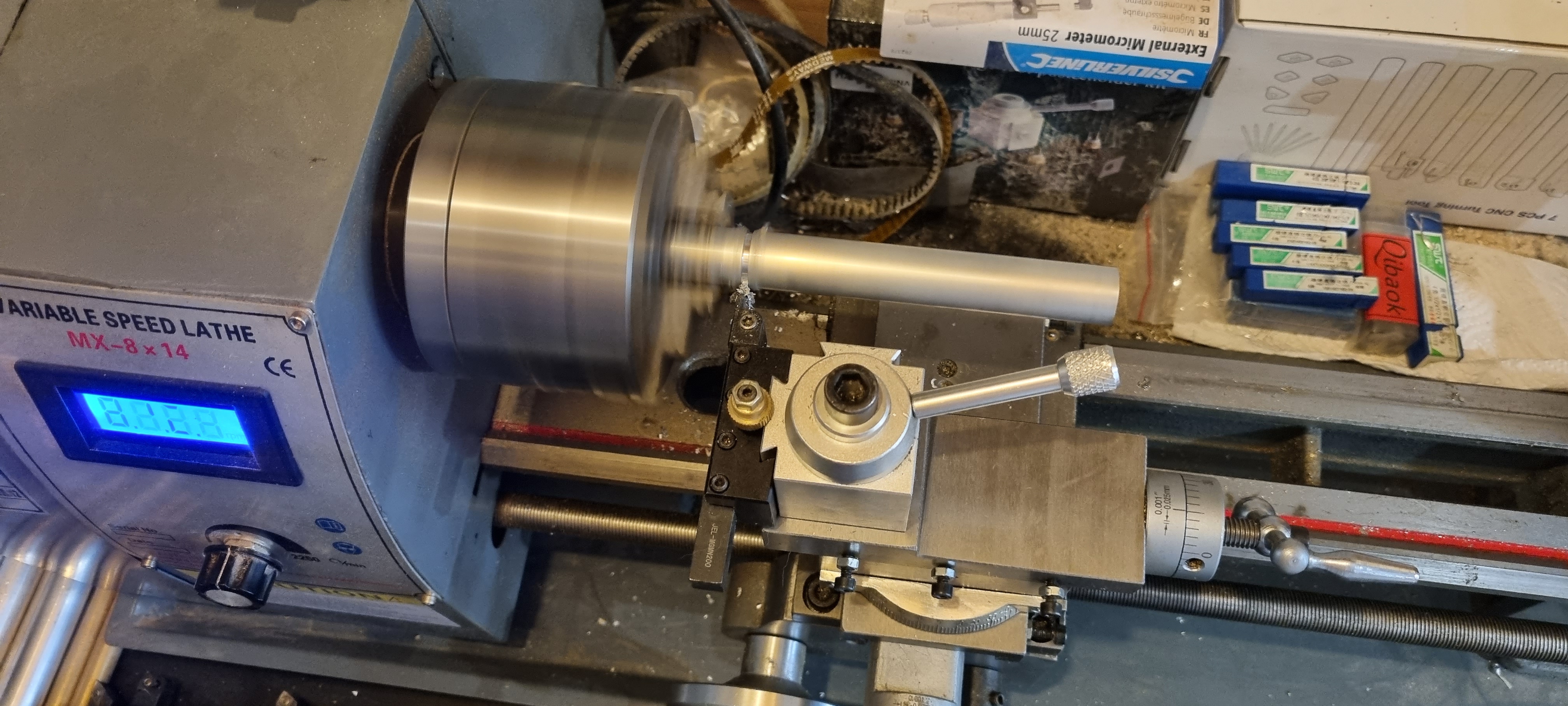

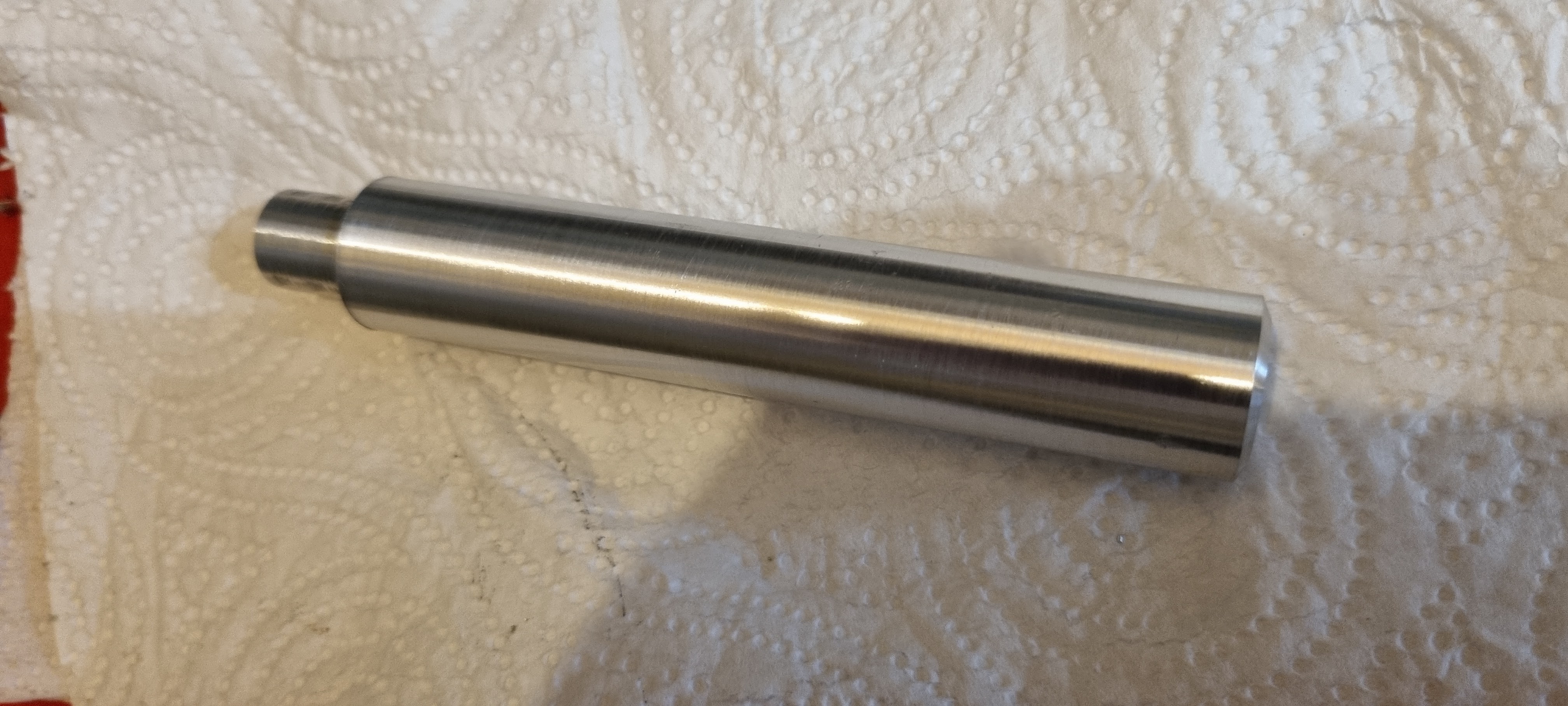

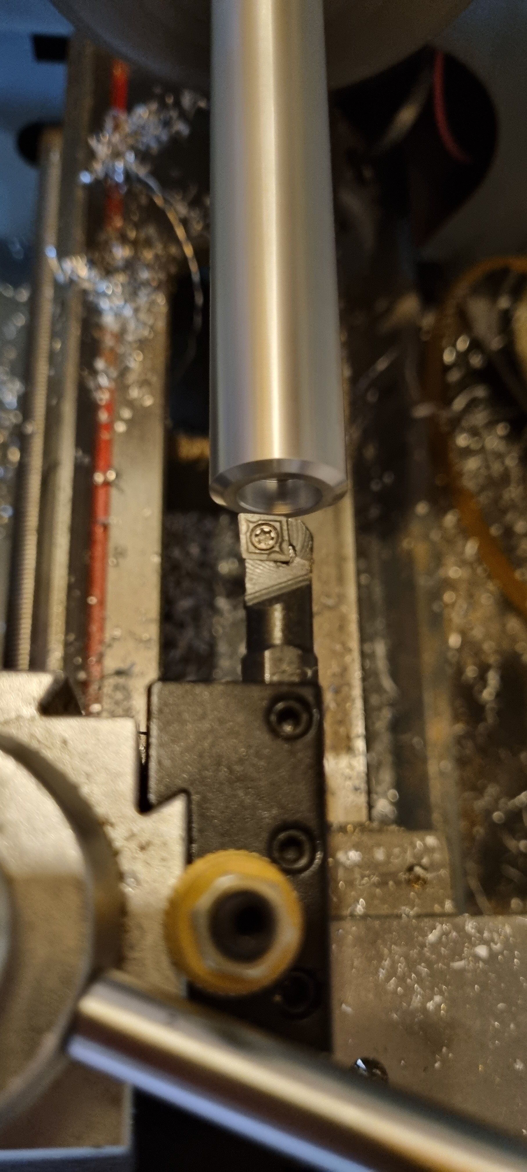

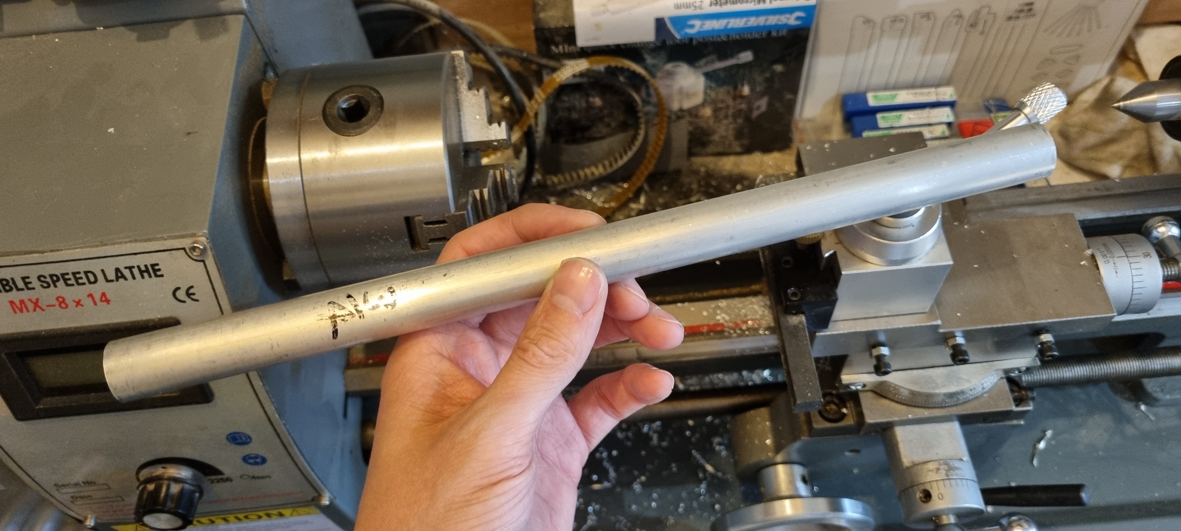

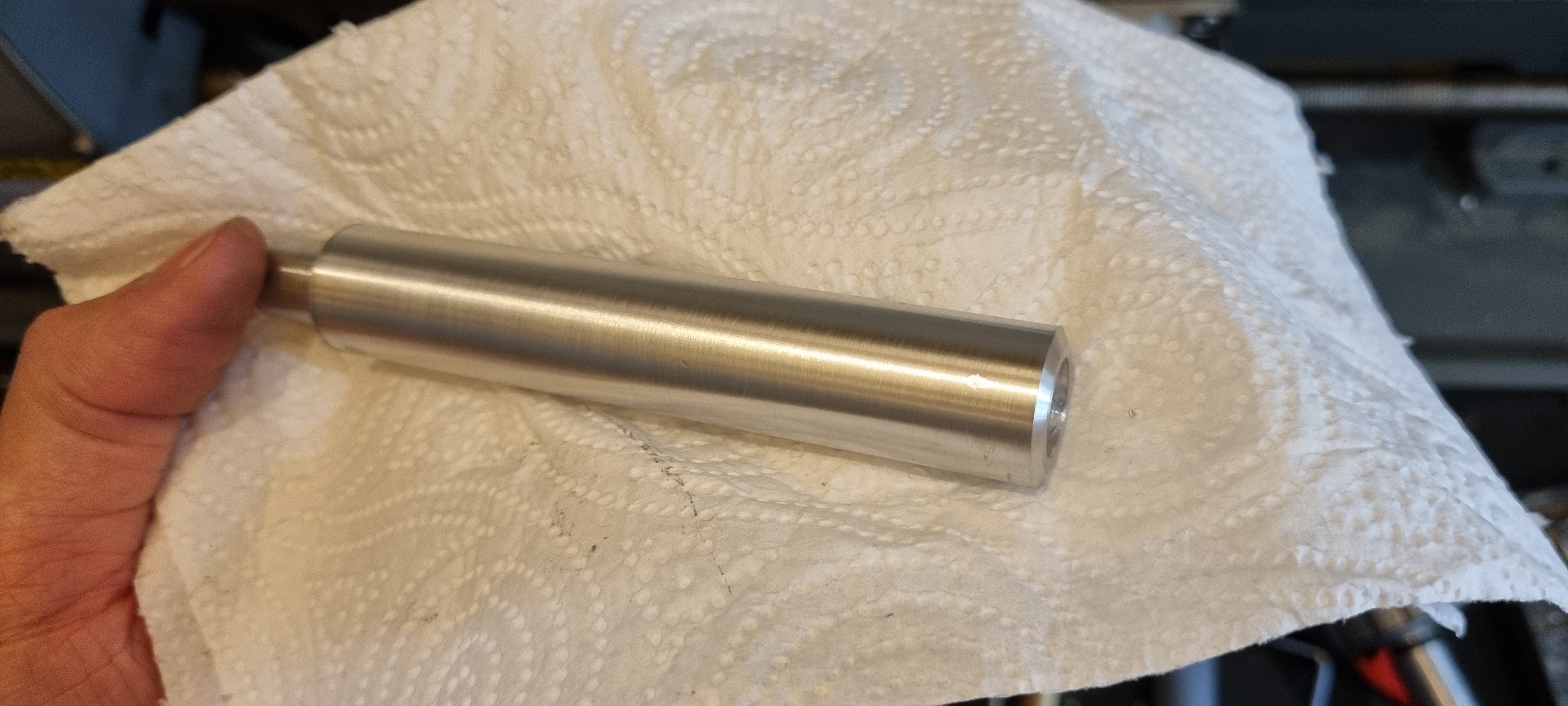

Next up was to make the Barrel, I have chosen Aluminium.

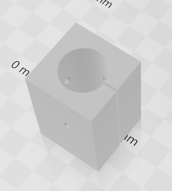

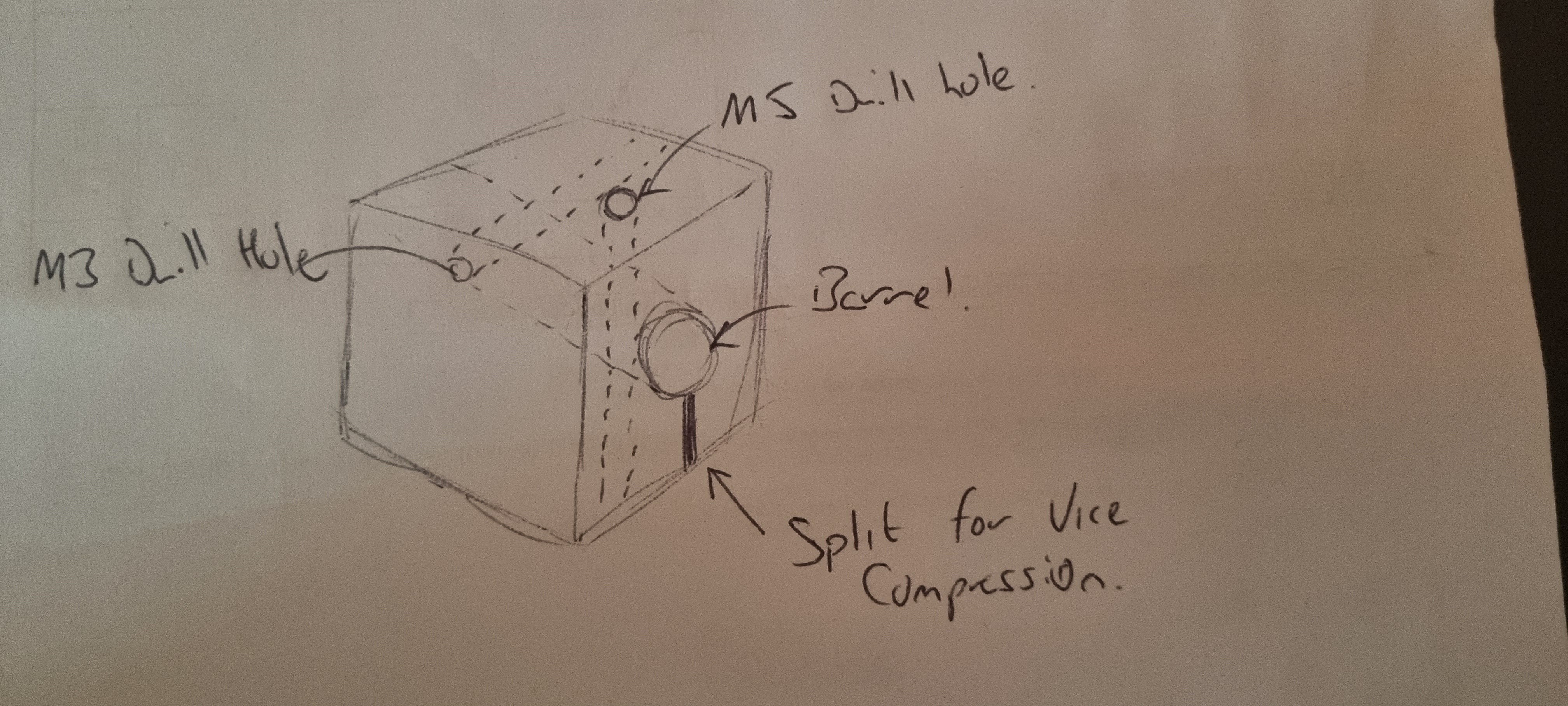

I dont have a mill (I really want one!) so I asked Anders to 3D build a Jig for drilling the holes in the barrel, here is my sketch for that. Its currently printing.

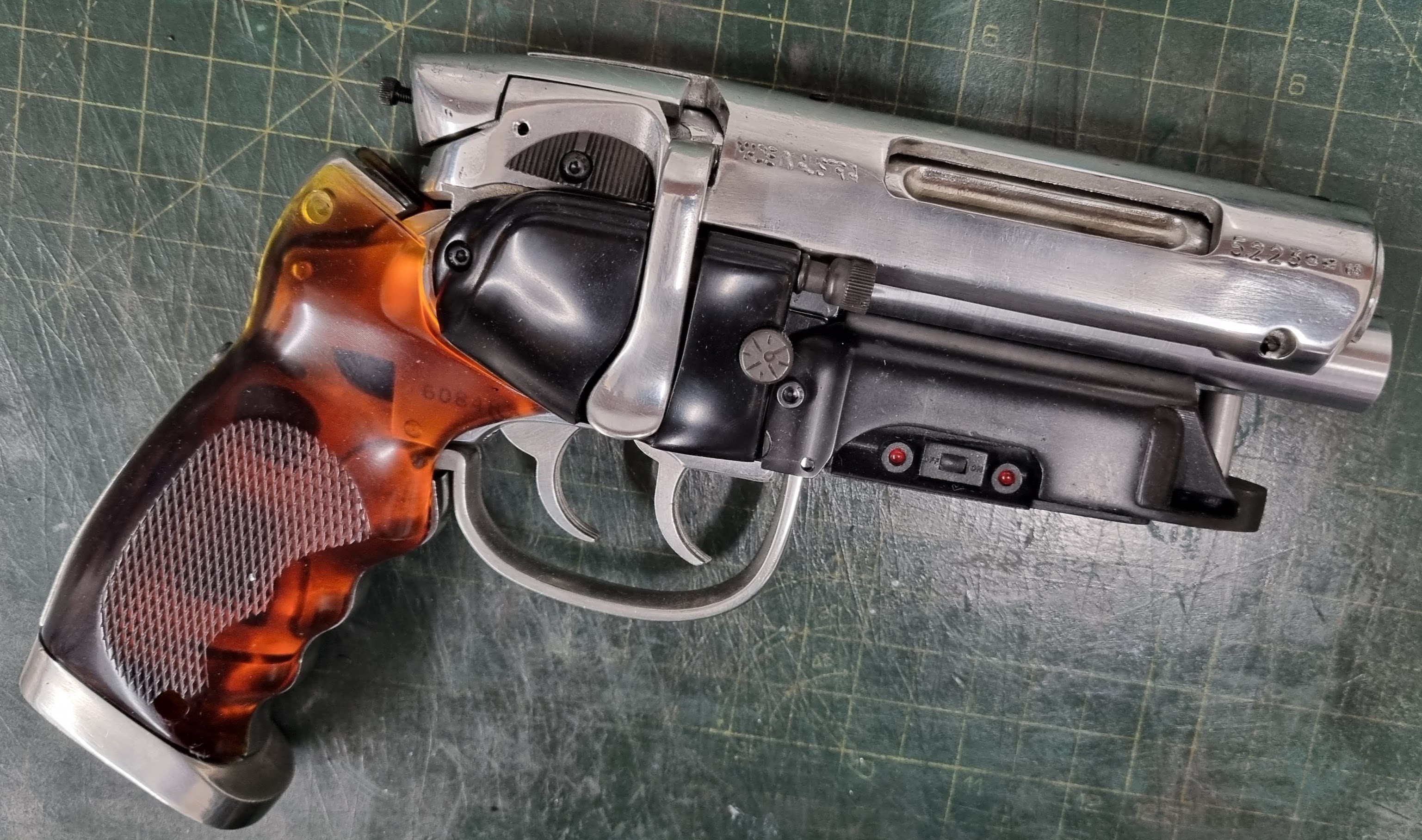

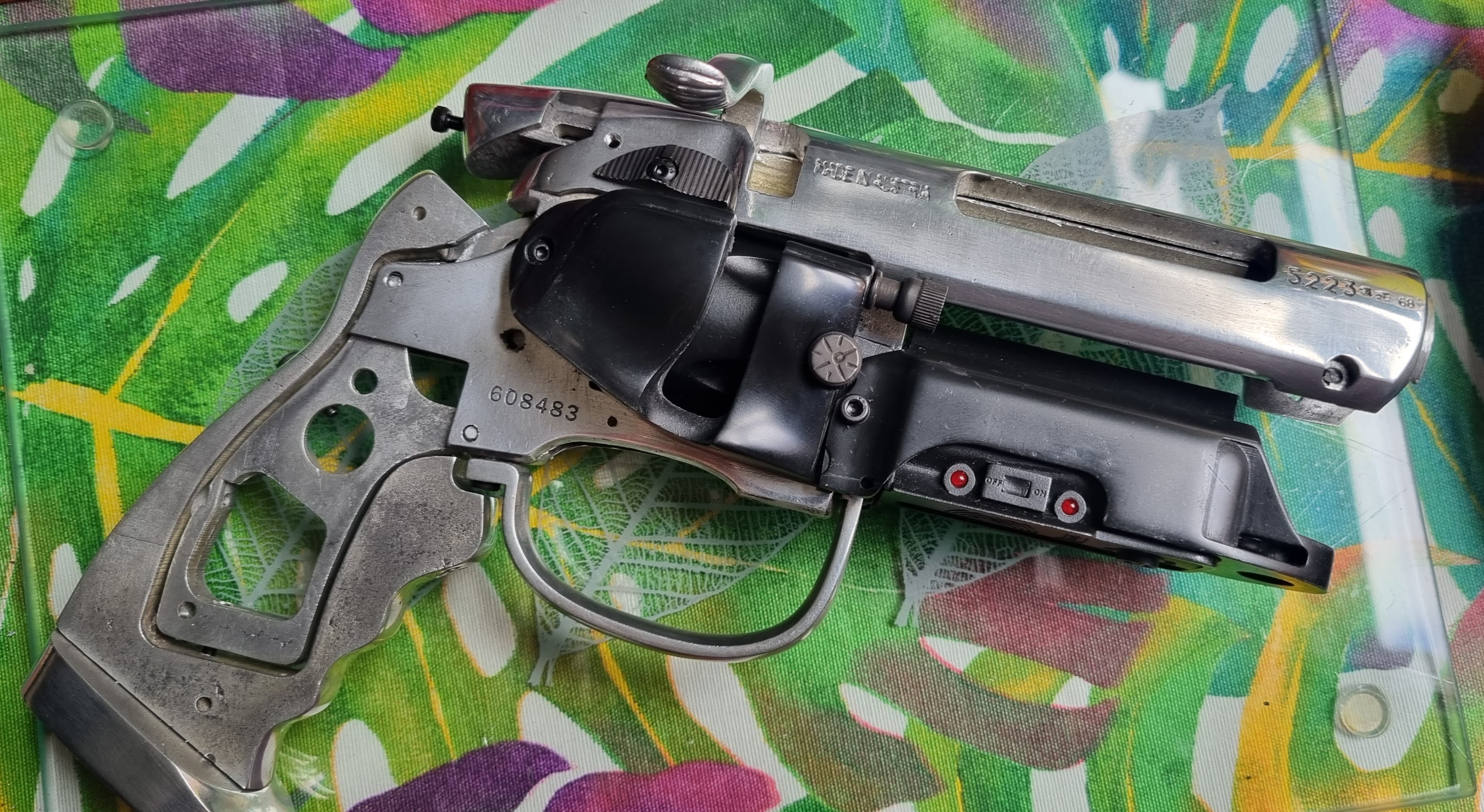

Current state of the prototype :)
Wow...the prototype looks good. I know that the letters/numbers aren't as sharp as other similar repros out there...but still (y) (y) :cool::cool:
I am by no means a gun expert but, are the makers marks and the serial number stamped on authentic firearms? If so, would that be a viable option?
On the real Styer the serial and proof logos are stamped, all the text is machined. I could replicate that process but its a lot of additional work to replicate correctly on each blaster. All will be well when I make the new mould ;)
