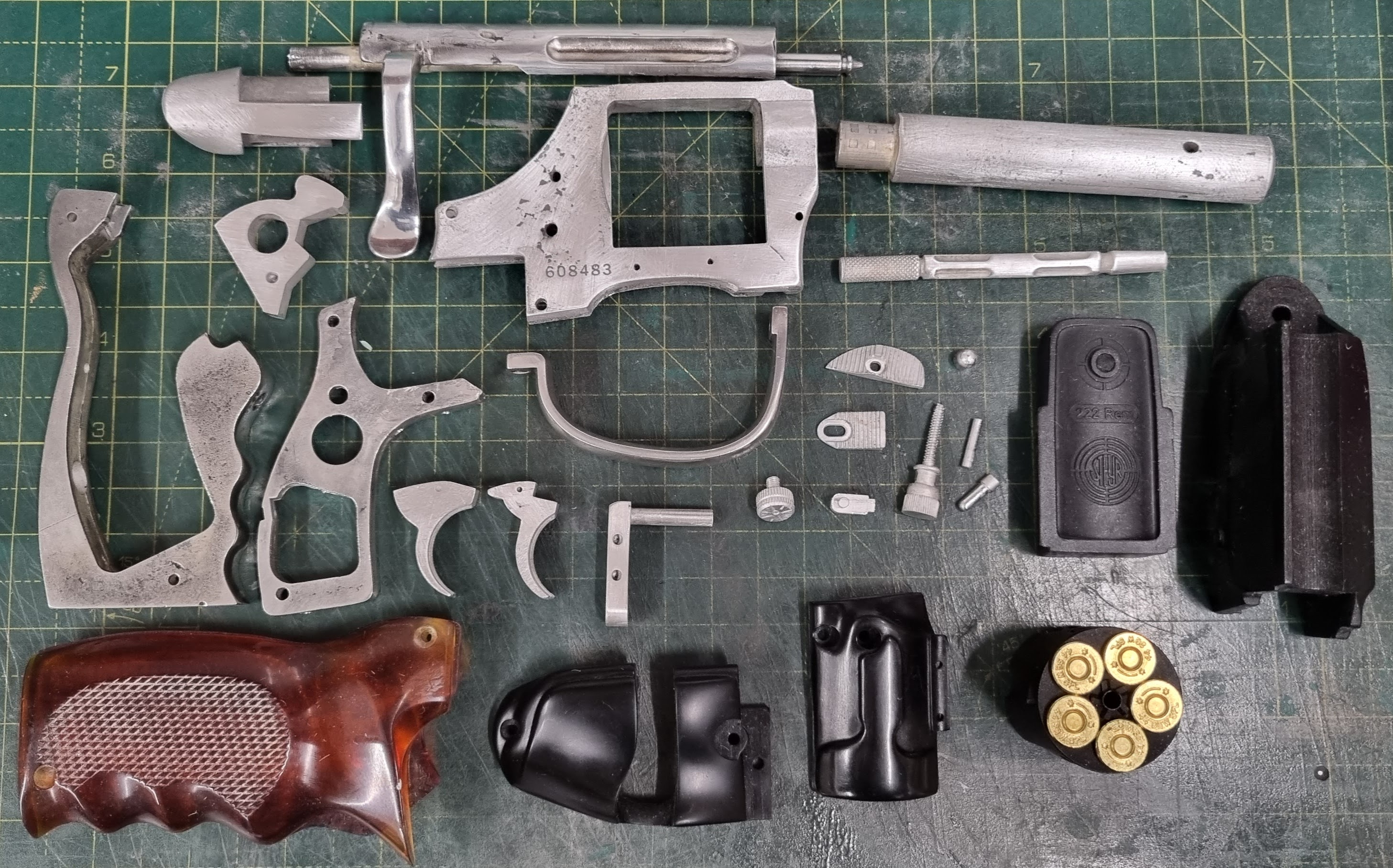

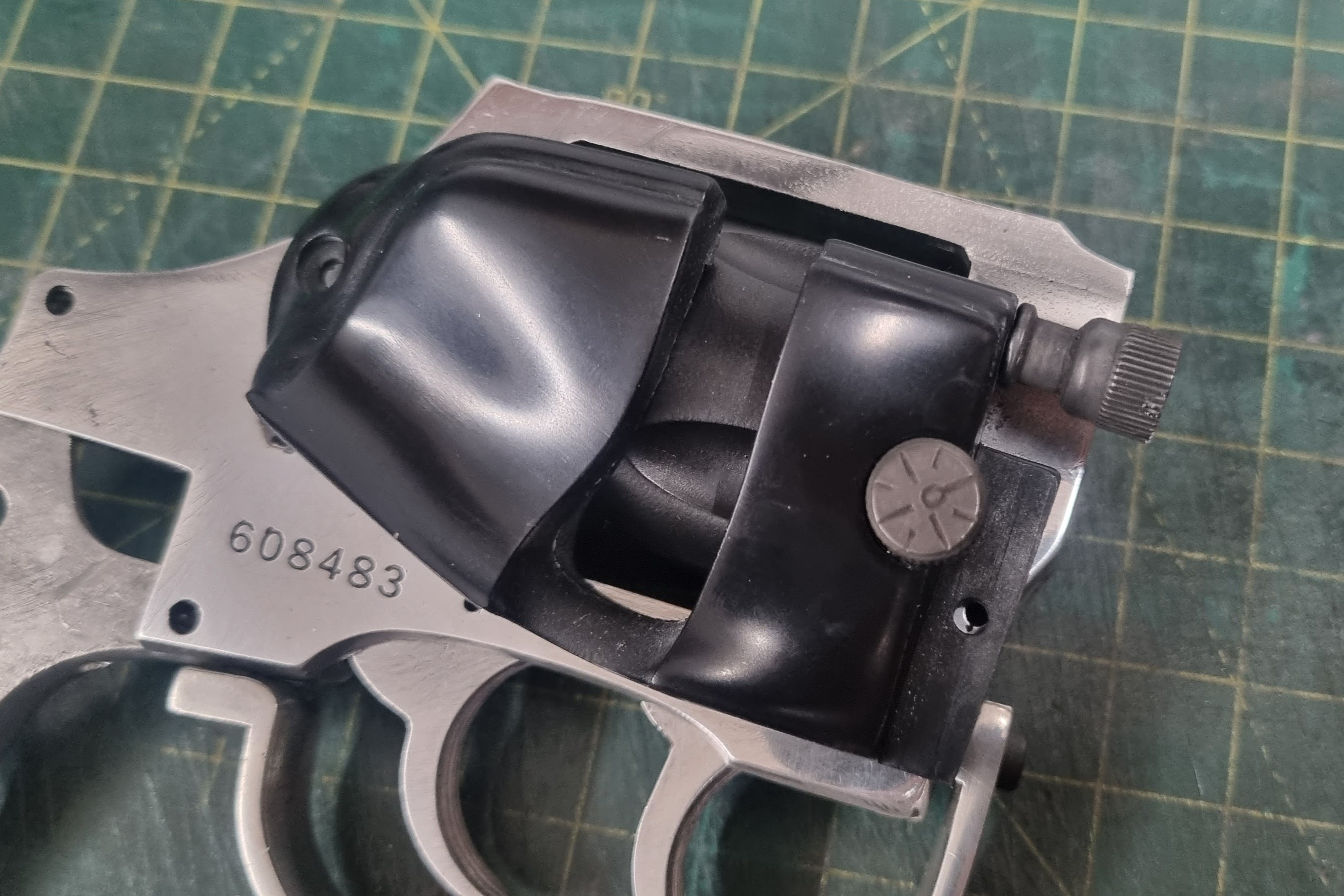

Started the final piece, so close now!

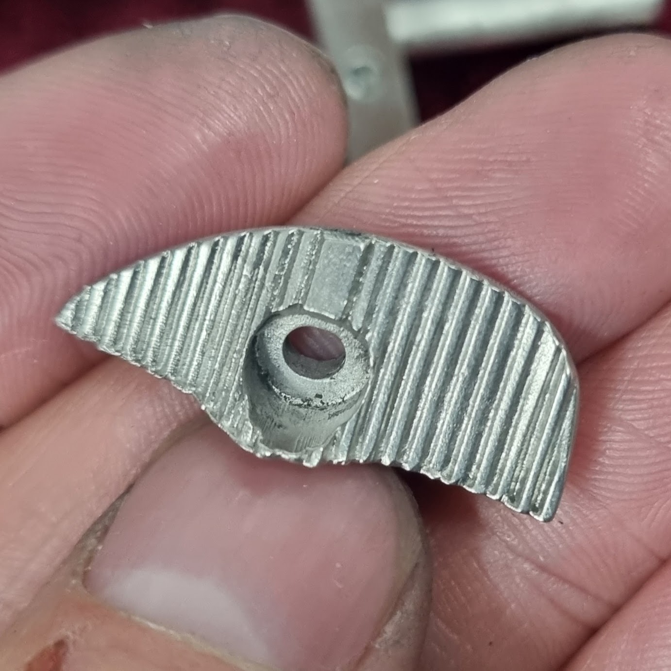

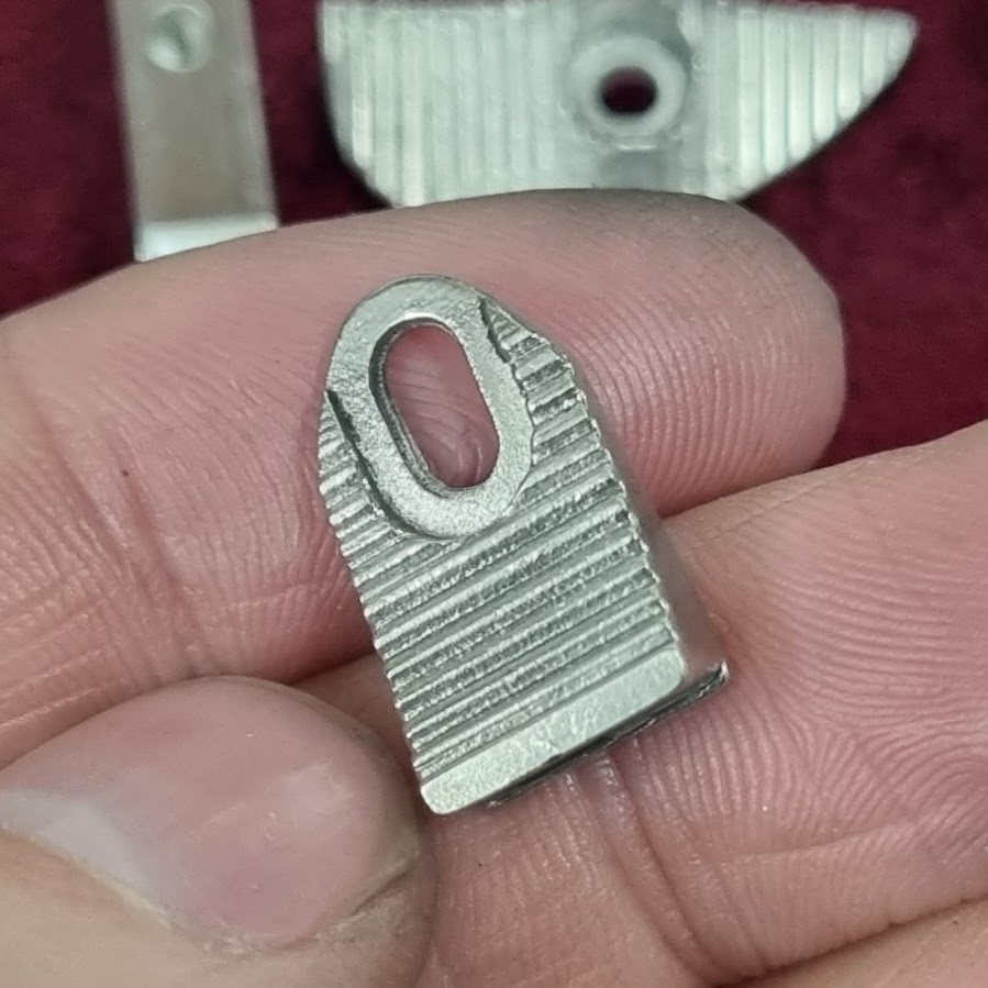

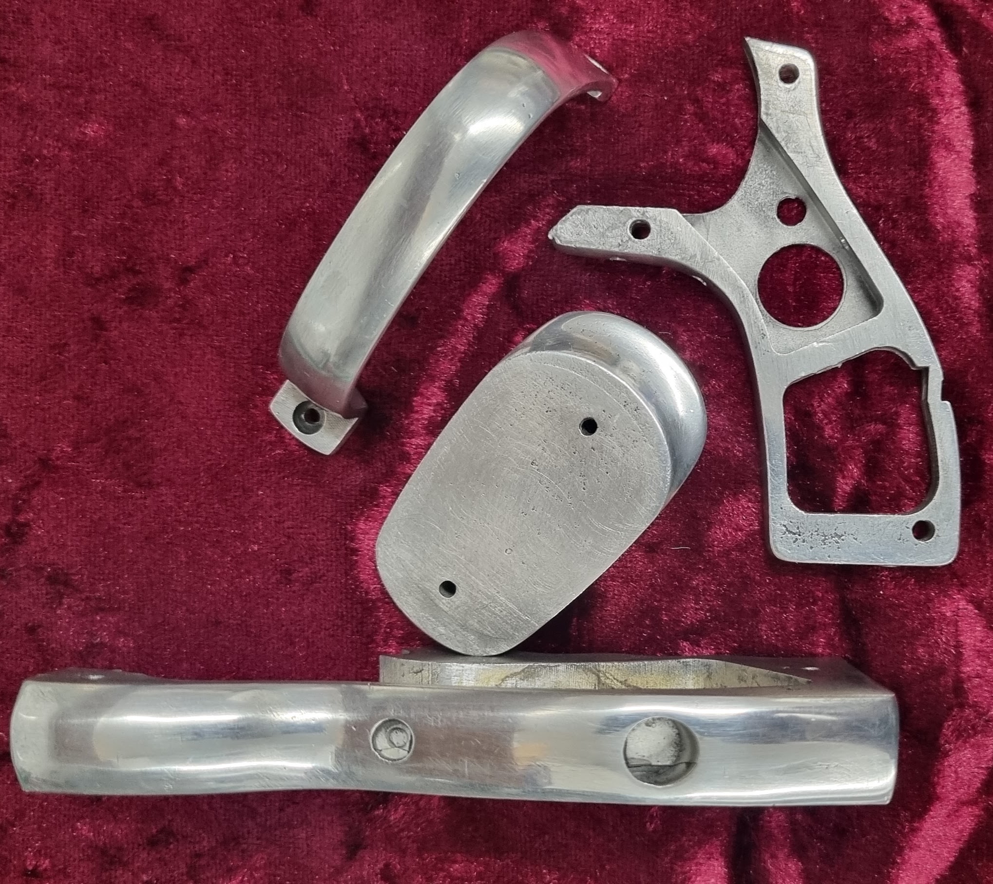

I have also started to clean up all the test casts to make the first prototype.

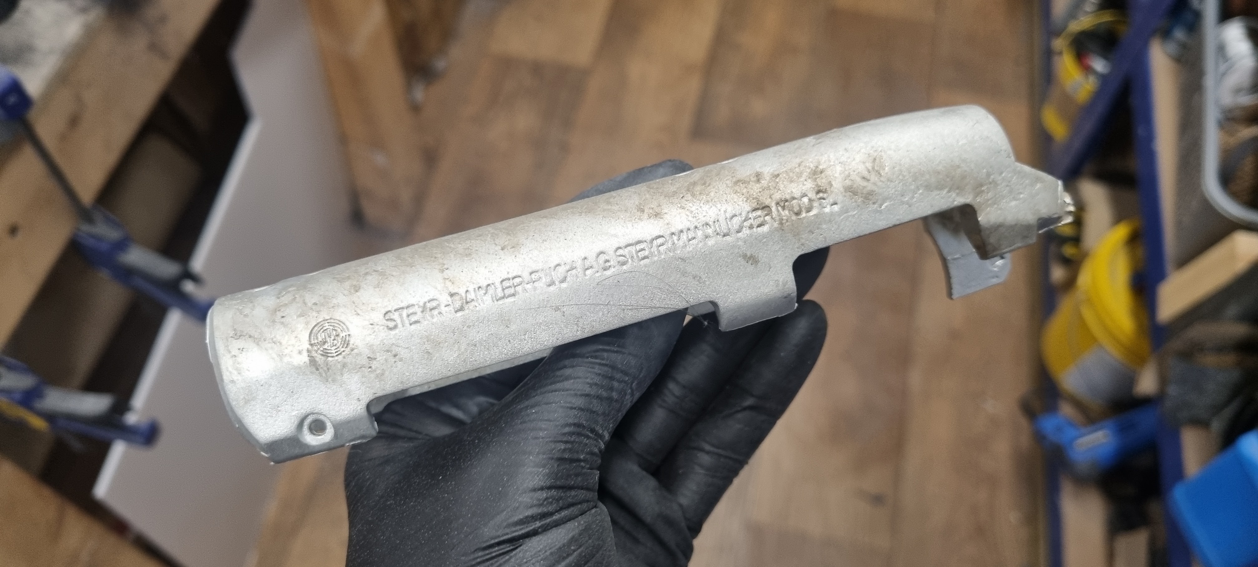

I have decided that the Barrel with be made on the Lathe out of Aluminium and I also need to remake the Grips as the resin has shrunk over time. I will scale them up a little to compensate for the shrink.

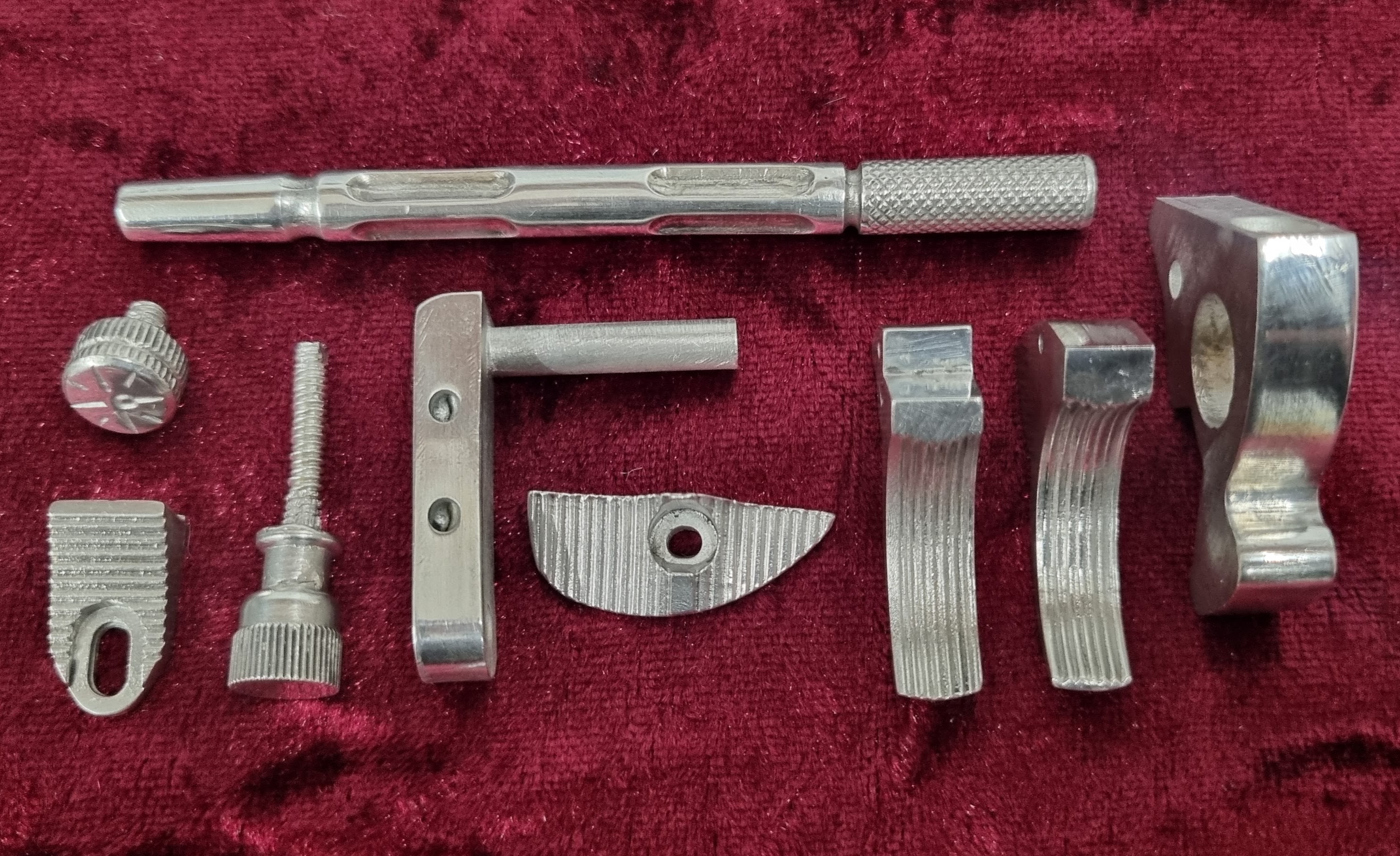

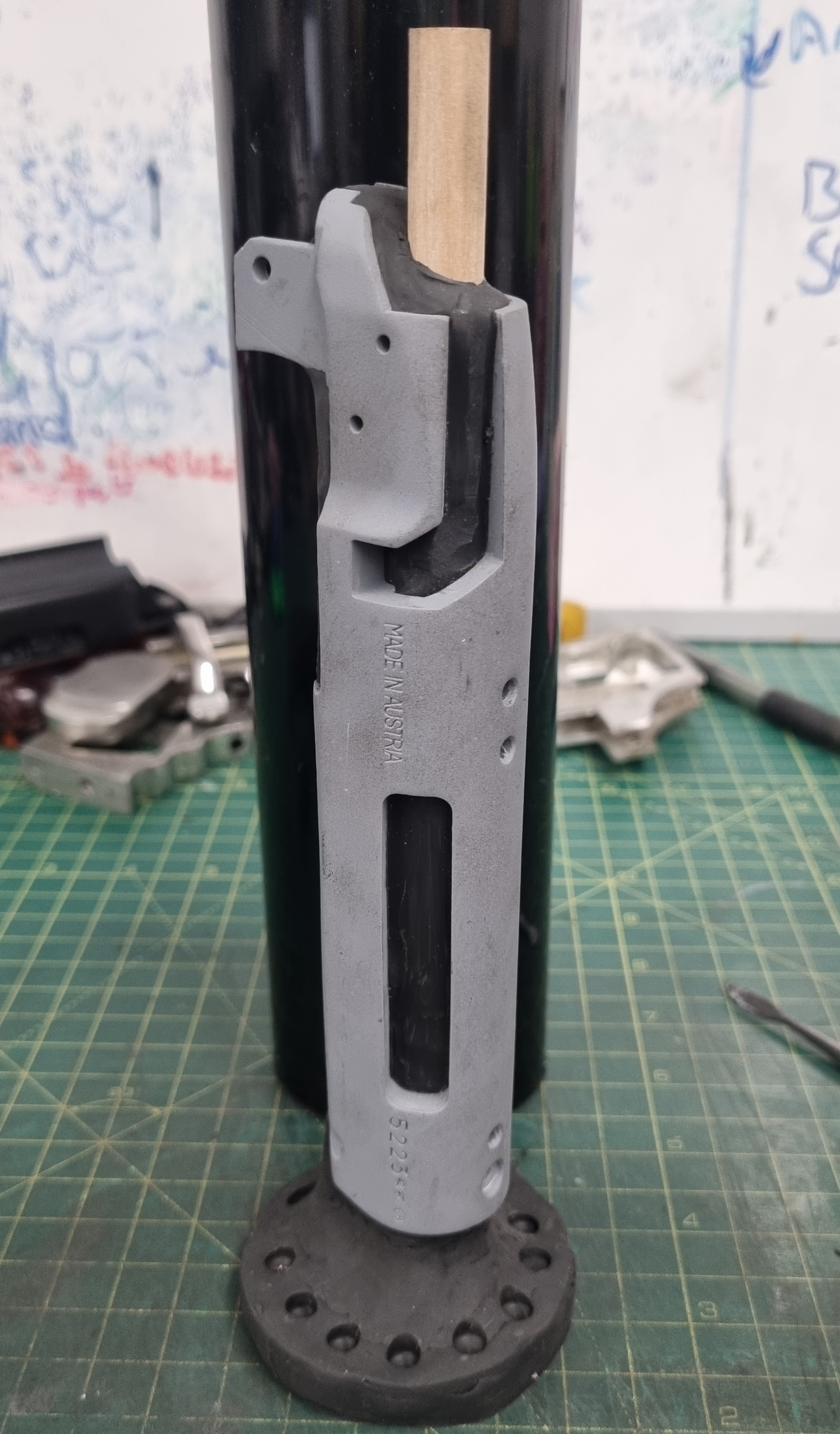

While we wait for the Styer frame mould to set I started to do a final pass of sanding and polishing on some of the parts ready to build the first prototype.

Epic project, nice work! I think the general rule is that anything thats a cylinder is better off being machined if you can, rather than cast.
