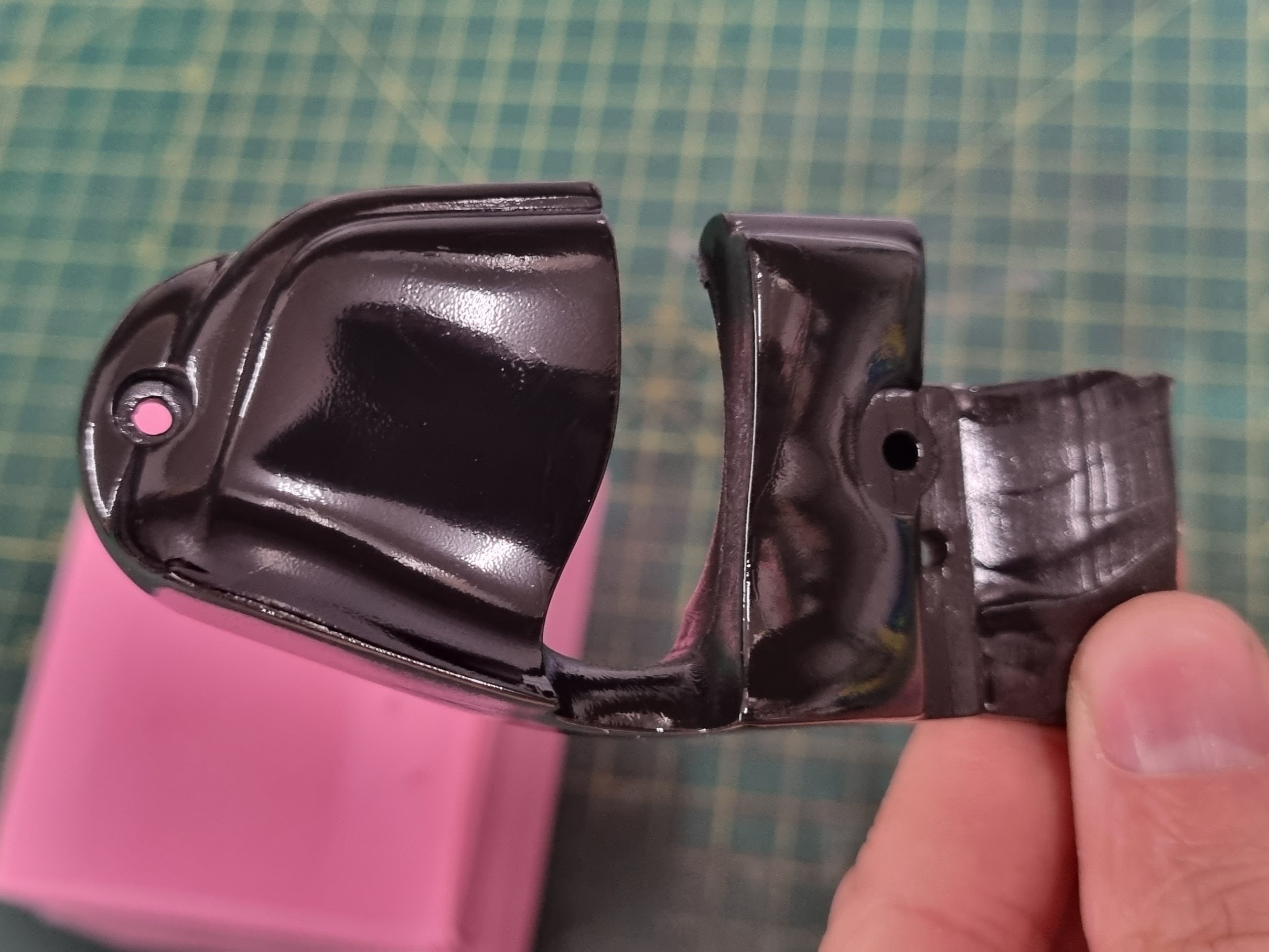

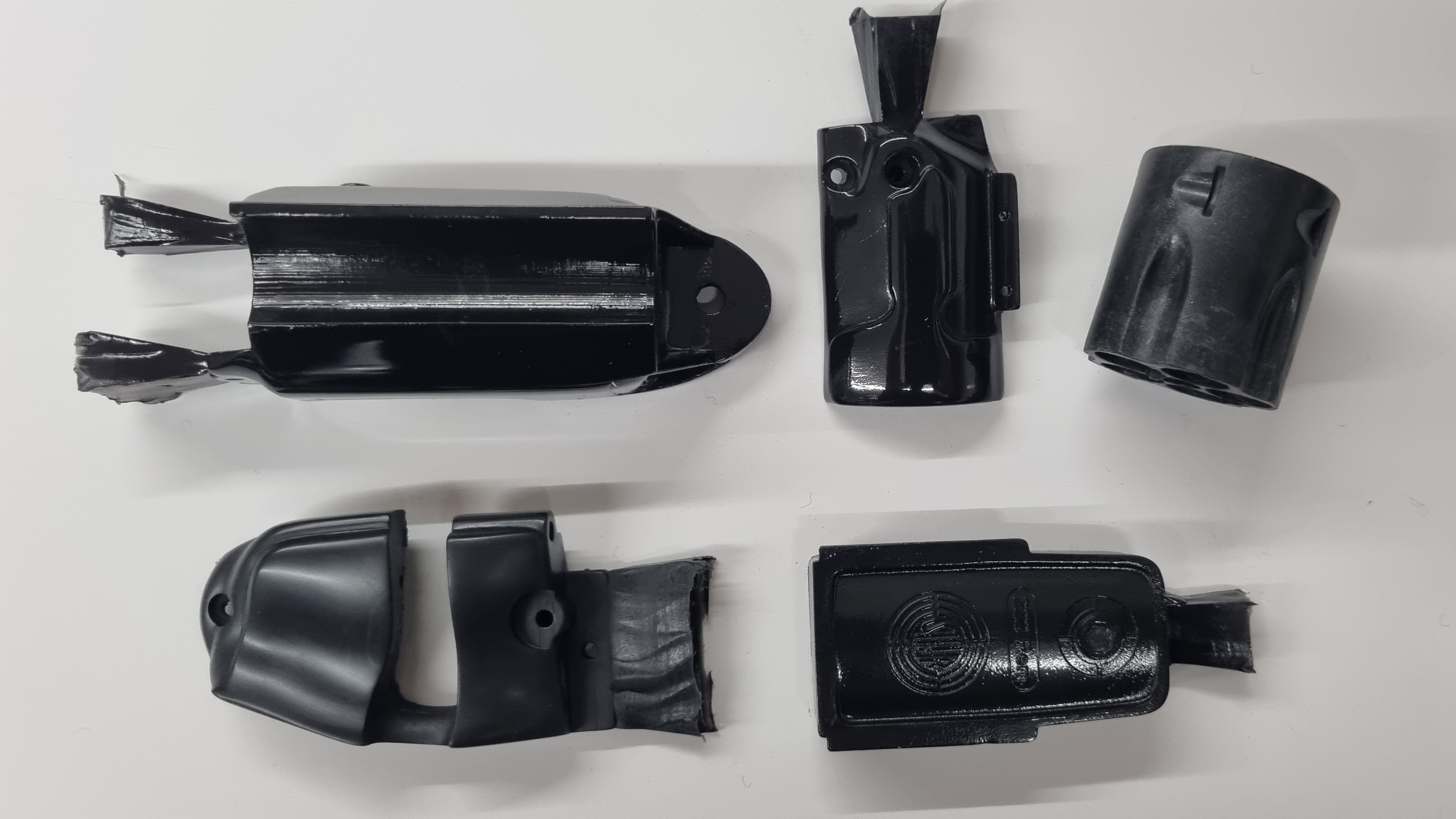

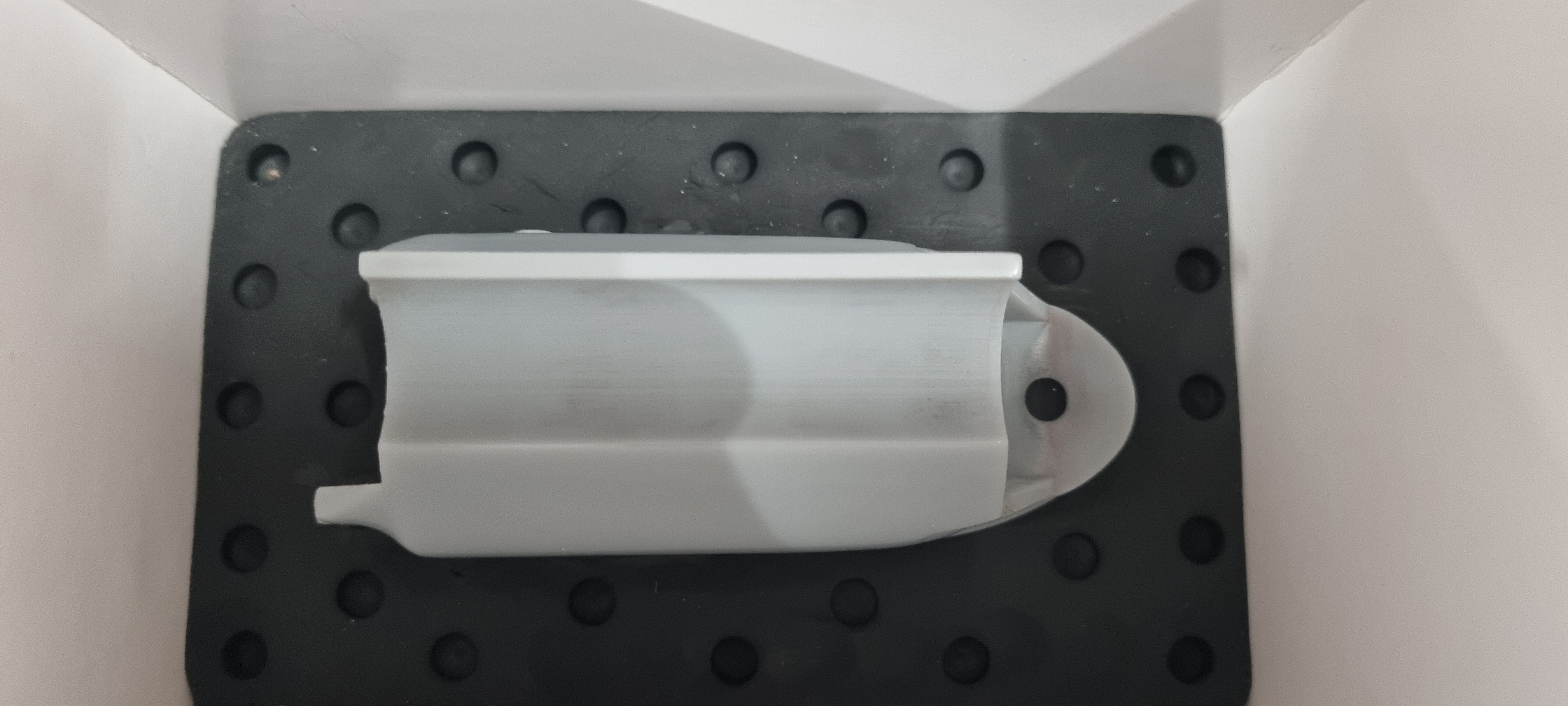

Here is the first half of the Cylinder covers.
This is the first cast out of the mould and I'm pretty pleased with it, I have hidden the seam lines at the back and it came out pretty clean and shiny. Its supposed to be a DIY kit but I don't think this part will need any post processing :lol:

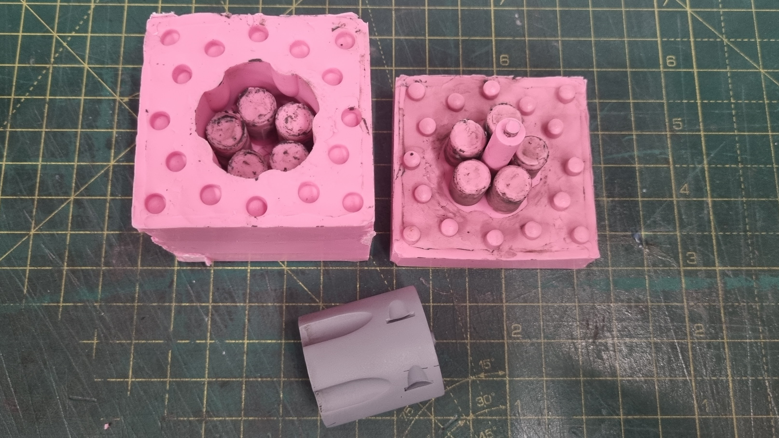

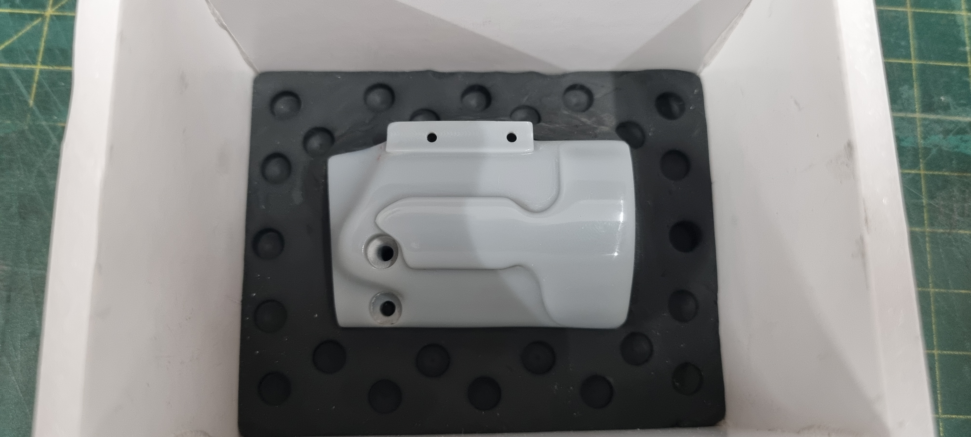

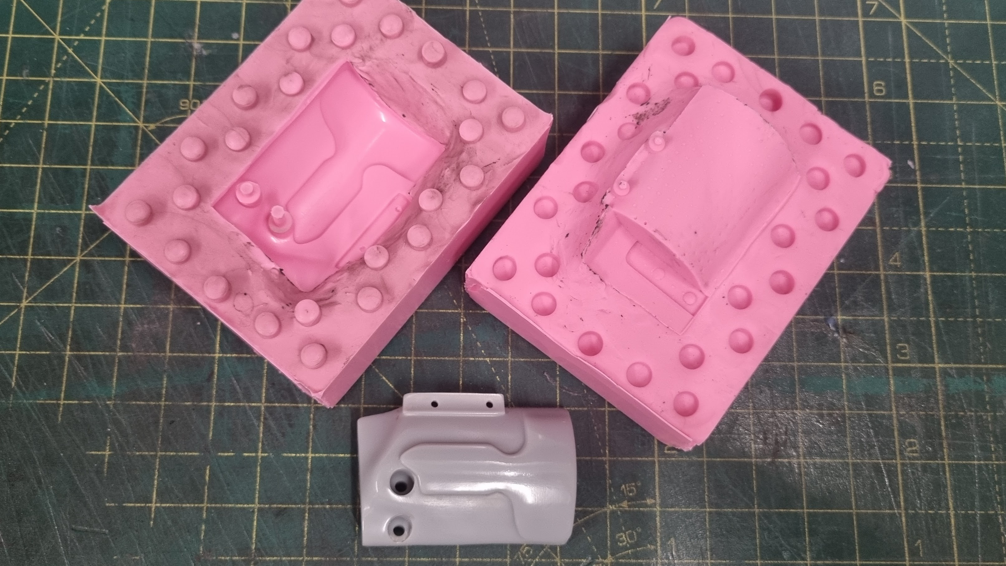

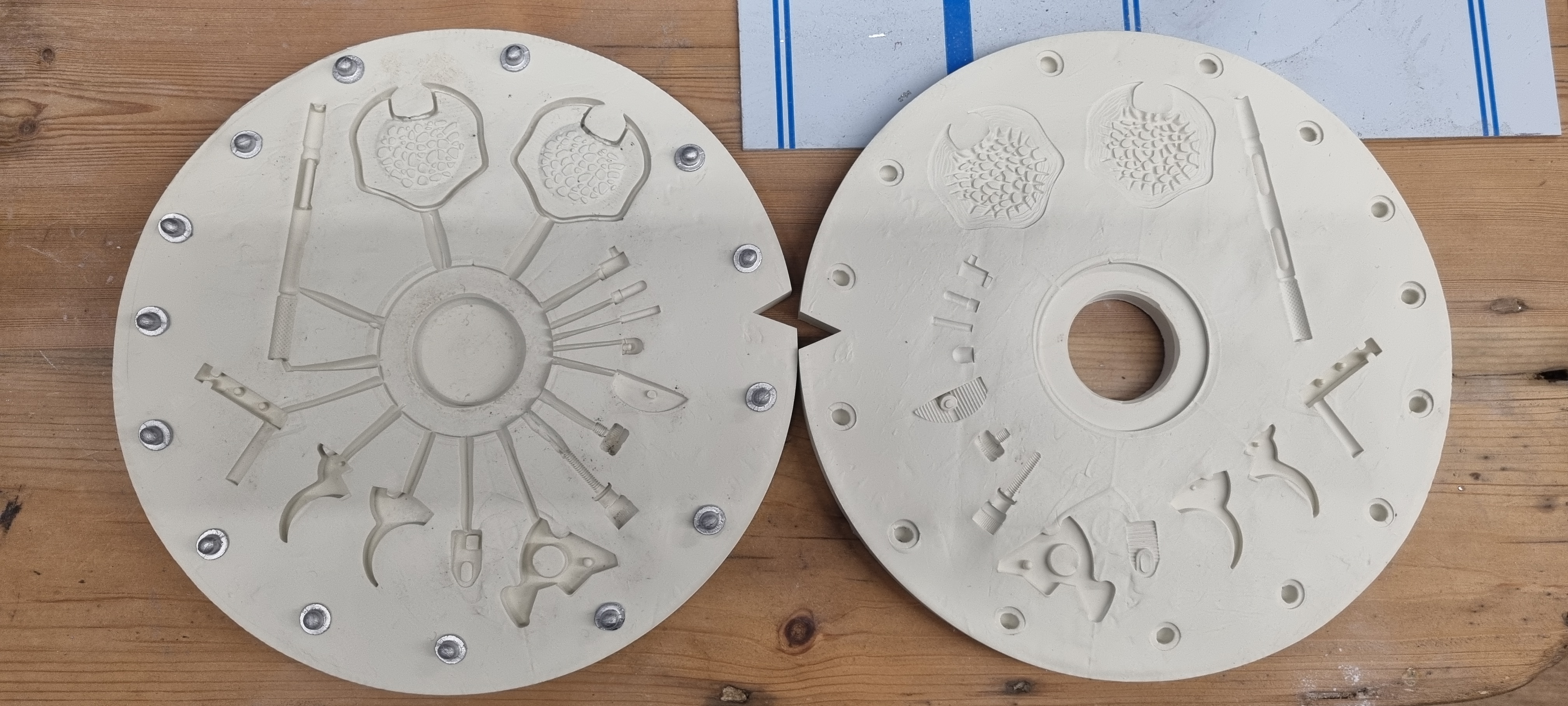

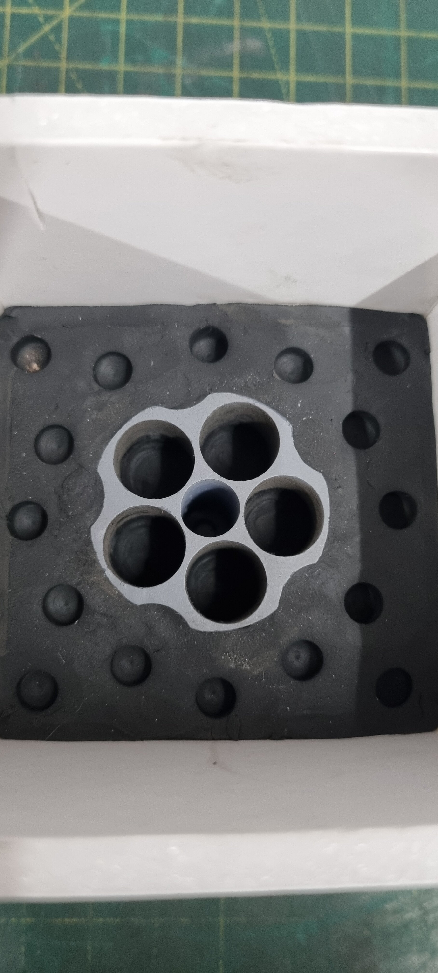

Made a new spin mold for the smaller parts, I'm getting much cleaner pulls from this now. Its a very minor change but a nicer end result!

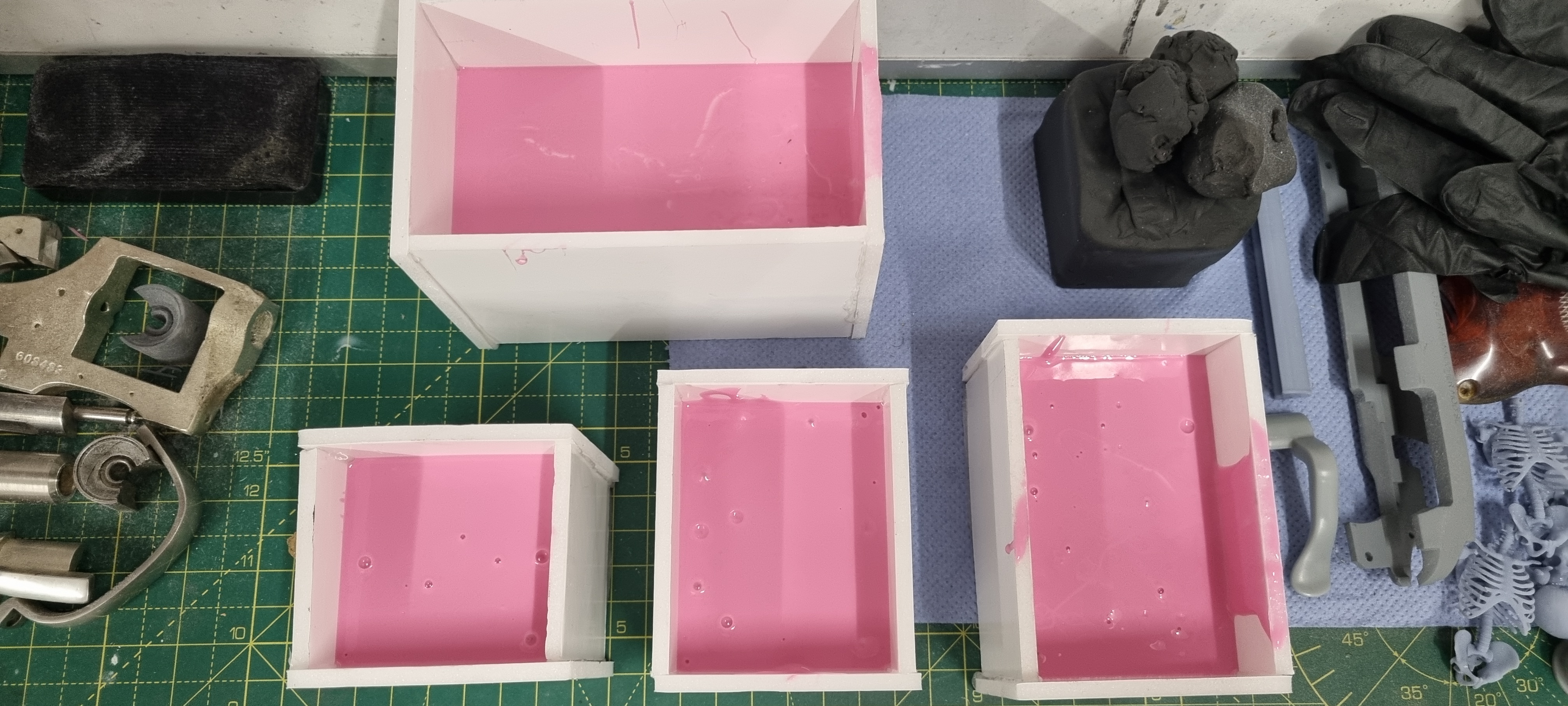

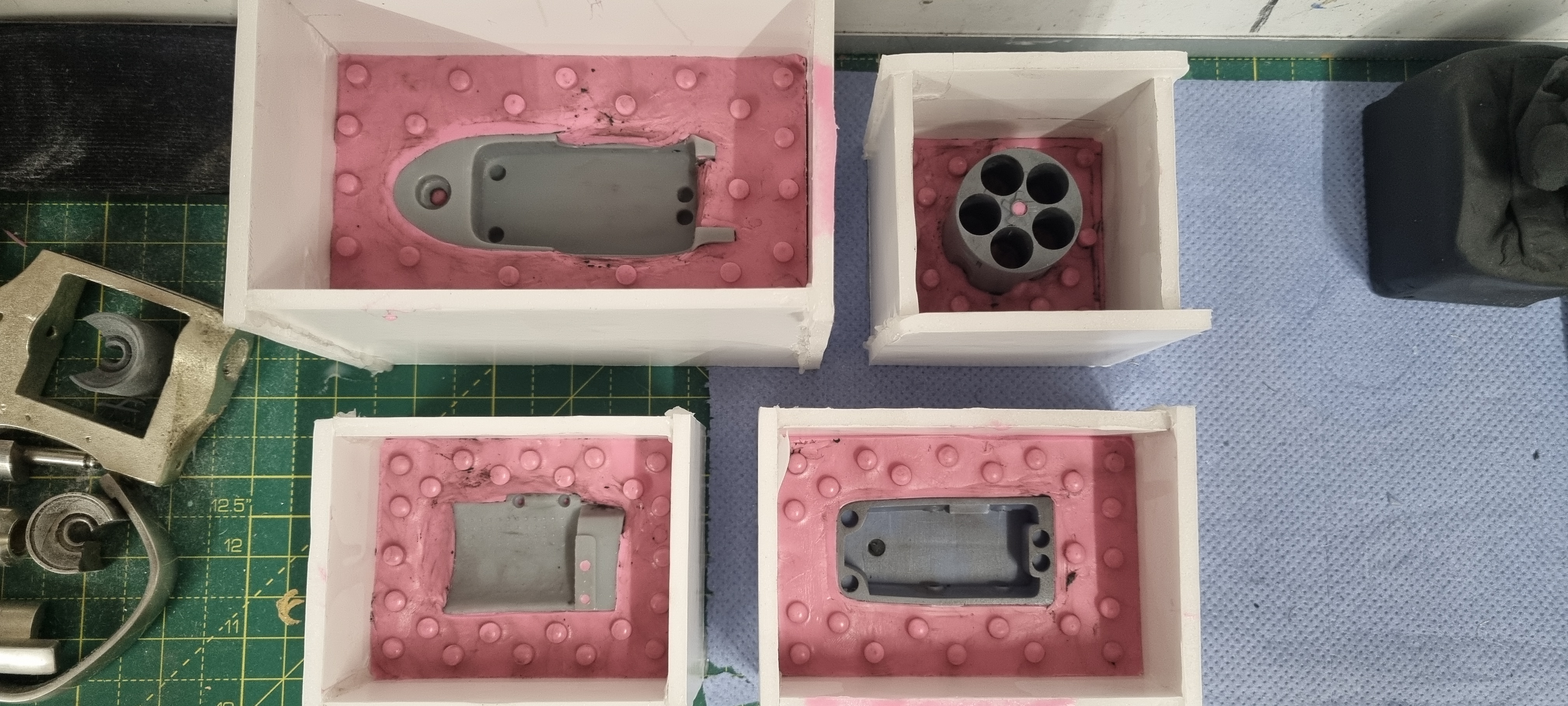

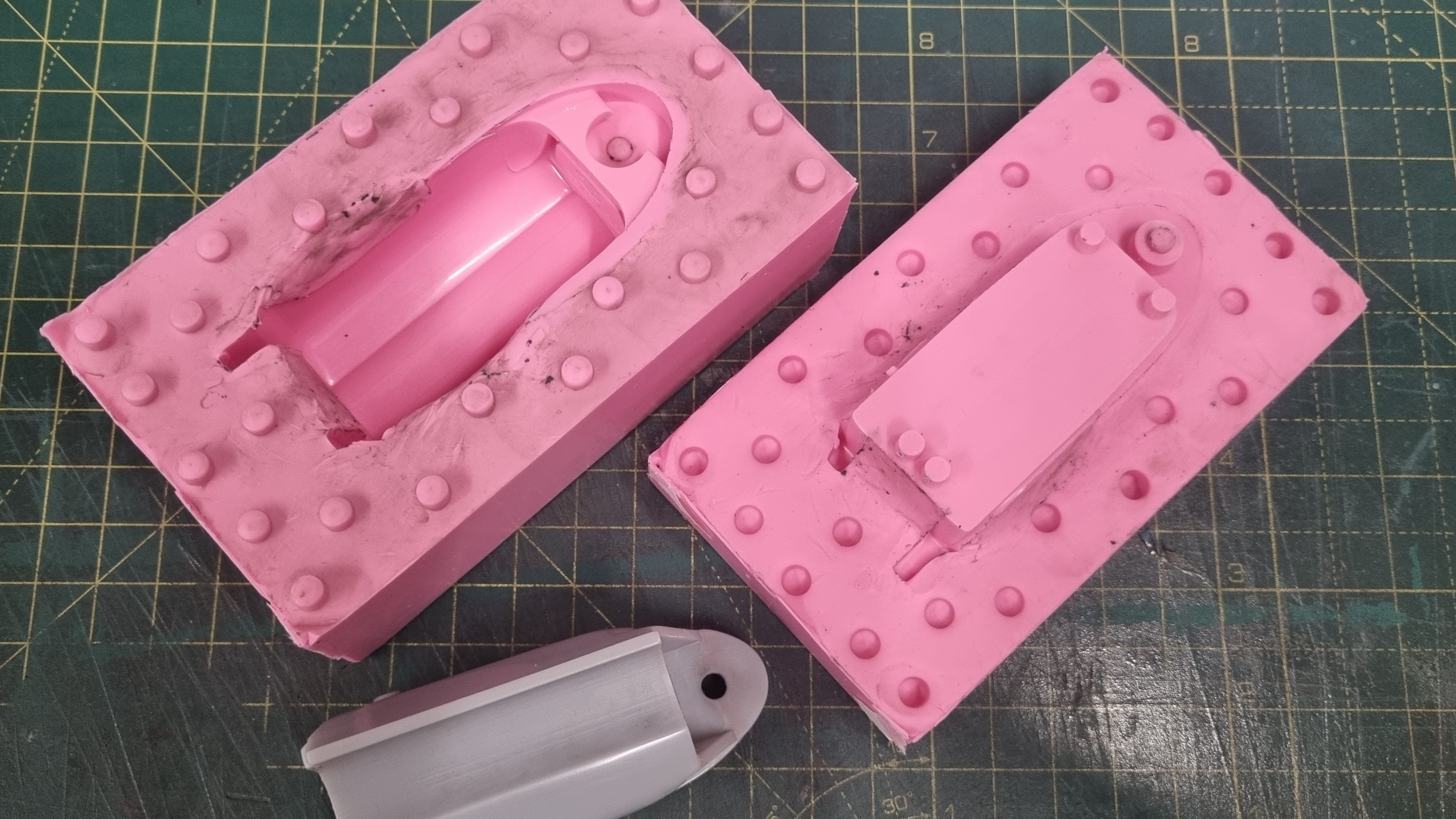

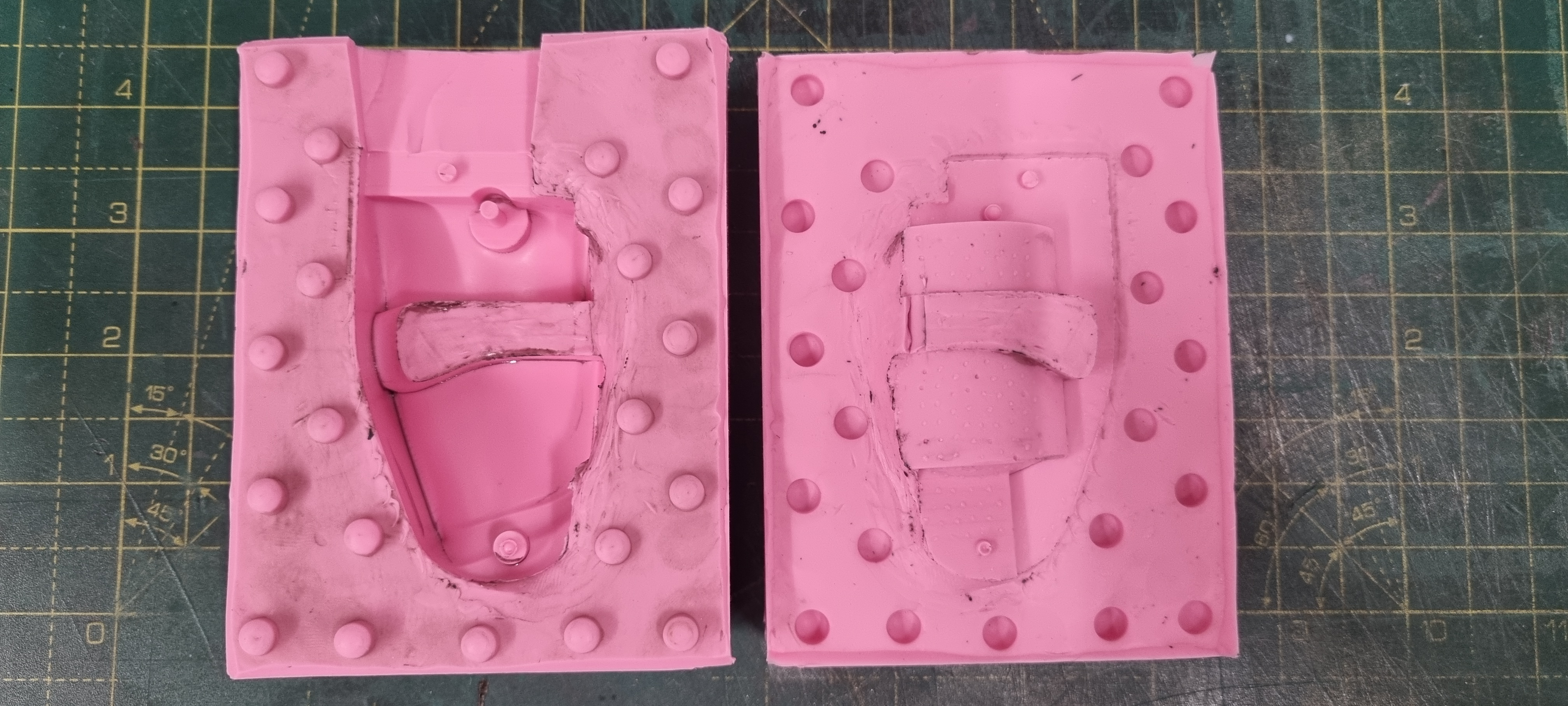

I have molded up the remaining parts that will be cast in Resin.
20211117_104209.jpg20211117_111910.jpg20211117_115051.jpg20211117_134231.jpg20211117_140650.jpg
Ready for the 2nd half!
I will post another update tomorrow with the first test casts from he new molds, after this the only thing left to do is make the mold for the Styer frame and Bulldog frame and I can start the process of stock piling parts ready for orders! :eek:

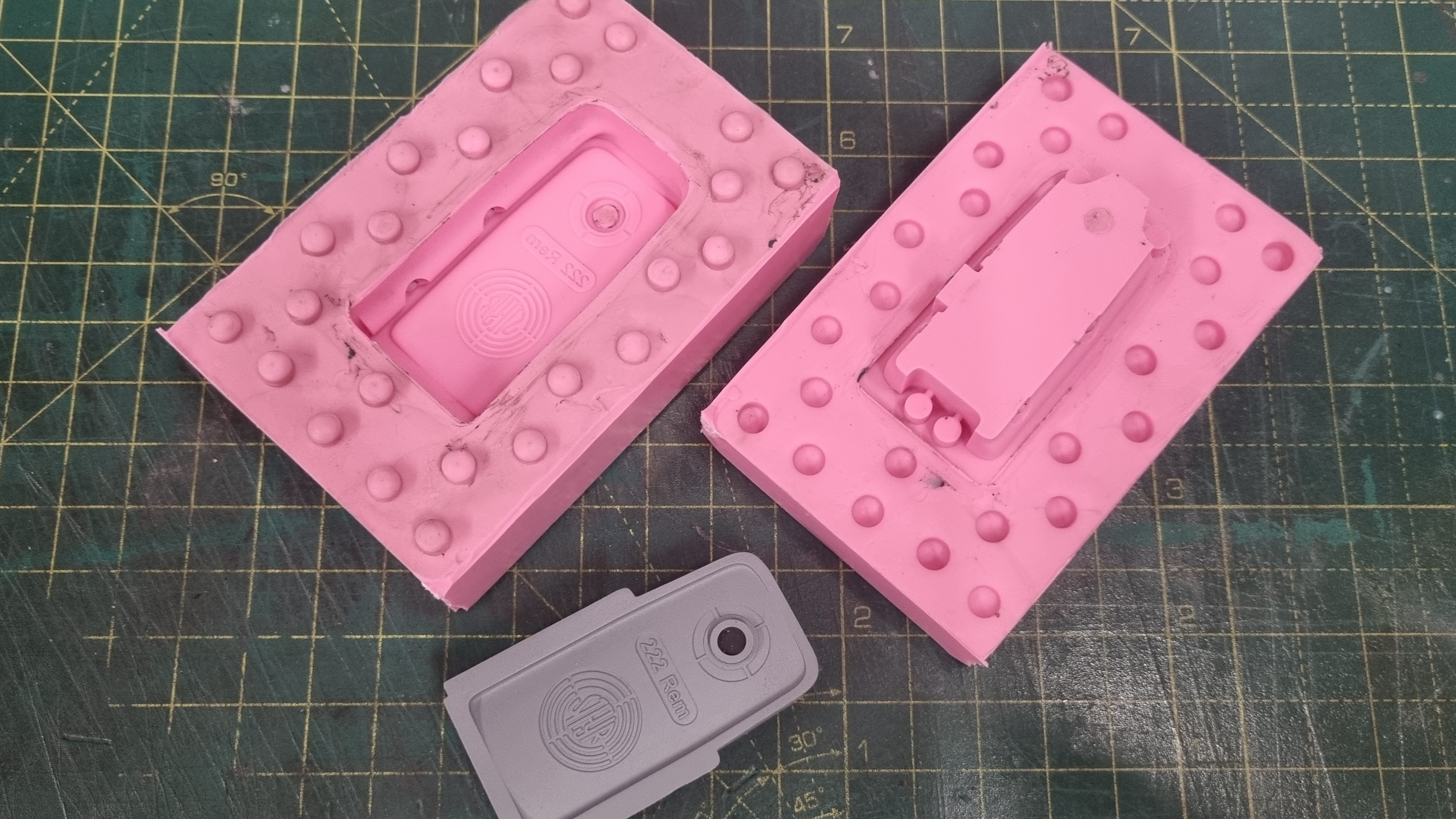

Here we go, Moulds are all done and first cast have been made. They look overly shiny due to them being cast first and came out a little sticky but that will settle down as the silicone finishes curing properly.
The Cylinder cover on the bottom left is more like what they will eventually all look like.
Here is the collection of the test casts and will eventually make up the first prototype build.
