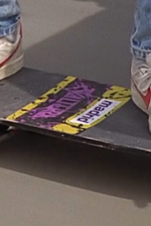

I got just the deck on ebay for way less than a full board. I'm using all new hardware anyway. The top graphic is in decent shape, but is too low compared to the screen used board so I'm stripping the board printing out a new graphic and applying new grip tape. Same thing for the bottom. It has other decals I don't want too so I will remove those the best I can and place the bottom graphic on.
I need to shorten the copers and color the yellow on the explosion decal green and give it a white background because this one is clear. I will use a file previously posted for the circle Madrid decal. For the trucks I will follow in another member's footsteps and get some invader trucks and paint them black. And since Madrid still makes the fly wheels I will obtain those soon as well. I will figure out the pivot cups and bushings when I get the trucks.
Don't strip the top. There is enough graphic there to match every screenshot. You want the angled grip to extend past the yellow just slightly.
In fact, your deck is begging for a painted color correction. Compare it to mine on the first page and notice how much more offset there is on the magenta layer. Your board is almost a completely aligned overlap. That makes the color correction that much easier since there nearly nothing to blackout first.

Thanks for pointing that out. I'm surprised I didnt notice that. I will just peel up the grip tape then and let it overlap the graphic when applying new griptape.
View attachment 479294View attachment 479295
How much of an angle is the graphic at? Ive seen pictures of replicas with a big angle and some where it's just straight across. I think with how real Valterra decks are straight across will look best. The screen used boards were completely made by Madrid correct?
Who actually produced the movie decks is still unknown. I know of two flat factory Valterra decks that are just the magenta on the bottom like in the movie, but still wider at the kick tail and not quite the same shape as the movie board.
As as for the grip tape and the graphic, you simply want your grip tape to match the angle of the Valterra text. If you're tired of squinting at screen caps you can use my board on the first page as a guide for spacing. Do not use the 25th anniversary replica as reference, they didn't get it quite right. All Valterra splatter decks have the text at an angle. The variation to the angle is very slight from board to board. There is no 'straight' across version of this graphic. Early fan made replicas did not get this right.
