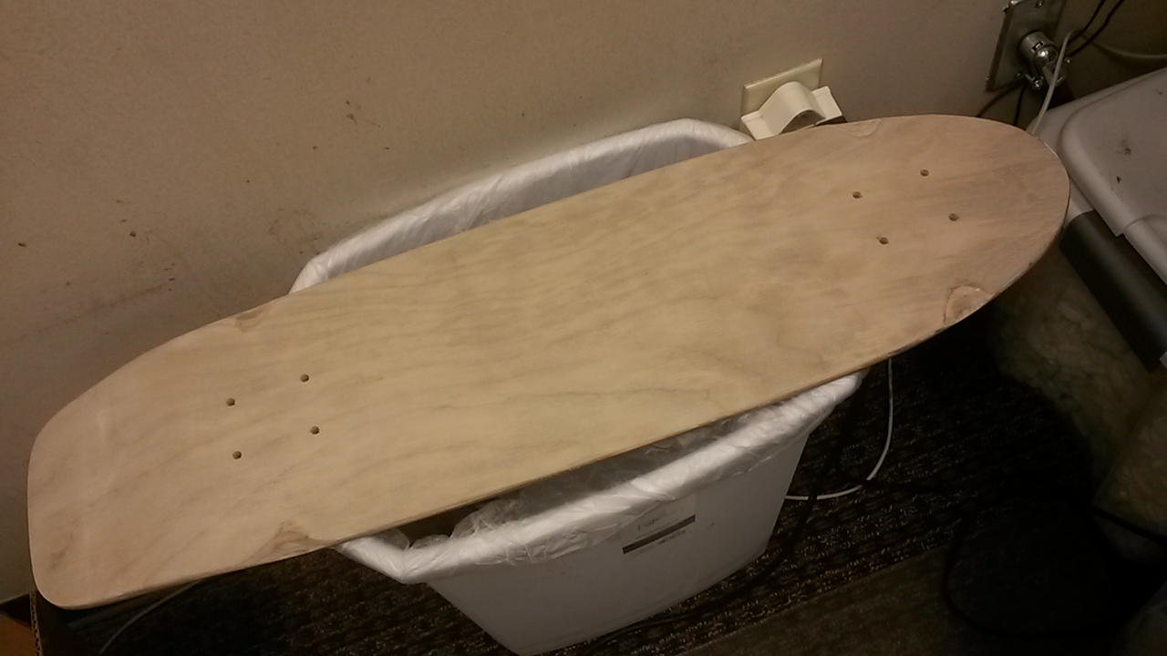

...and this is why I have to go the DIY route. I don't have $500 lying around.

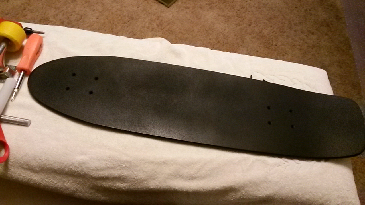

I know I lurk a lot here, but I did want to thank everyone who has offered up pics and info on the board that has helped me make my own budget built Valterra deck.
I only had a couple hours a day for less than two weeks, so I could only get it close, not as accurate as I would like if given more time.

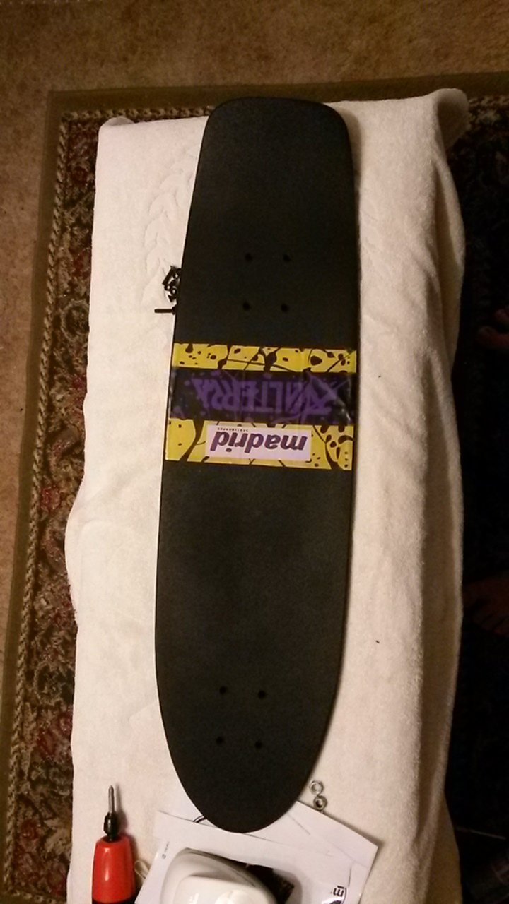

So far I'm not having any luck finding someone to print the graphics on my board. Most of the sites I've found that do print on boards only print on the boards they sell -- none of which are the correct shape. :unsure
I might need a plan B. Anybody out there have any thoughts or suggestions? I'd really prefer to get the graphics painted on, as opposed to using vinyl.
Get the graphics cut out of sign vinyl. Then use that at spray paint templates. Paint white first under the brighter colors.
Any updates? I'm with pandatrooper on the stencil idea. Lay it over the boatd and spray paint it or fill in the splatter by hand.

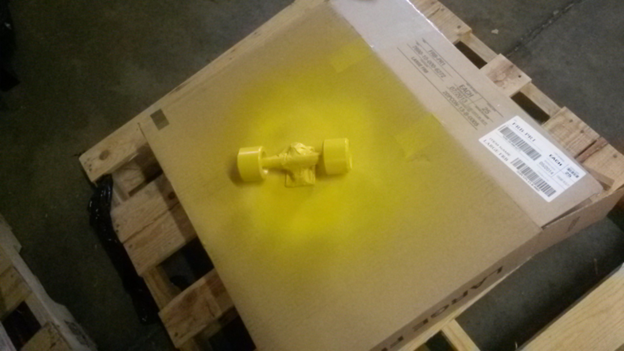

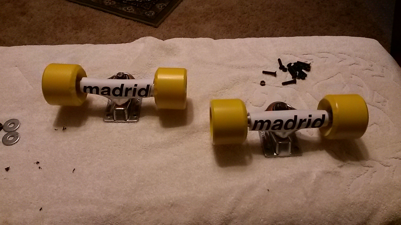

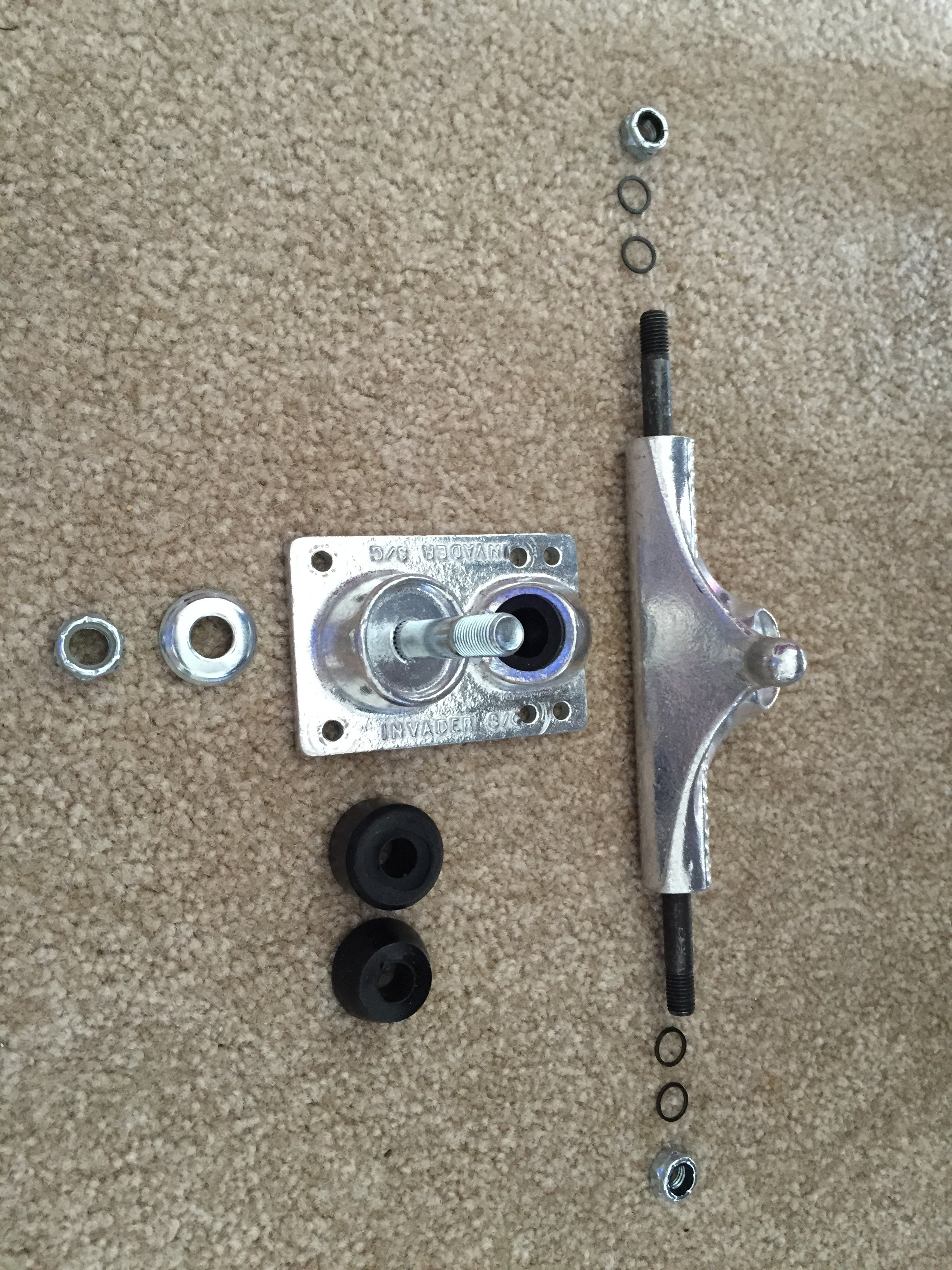

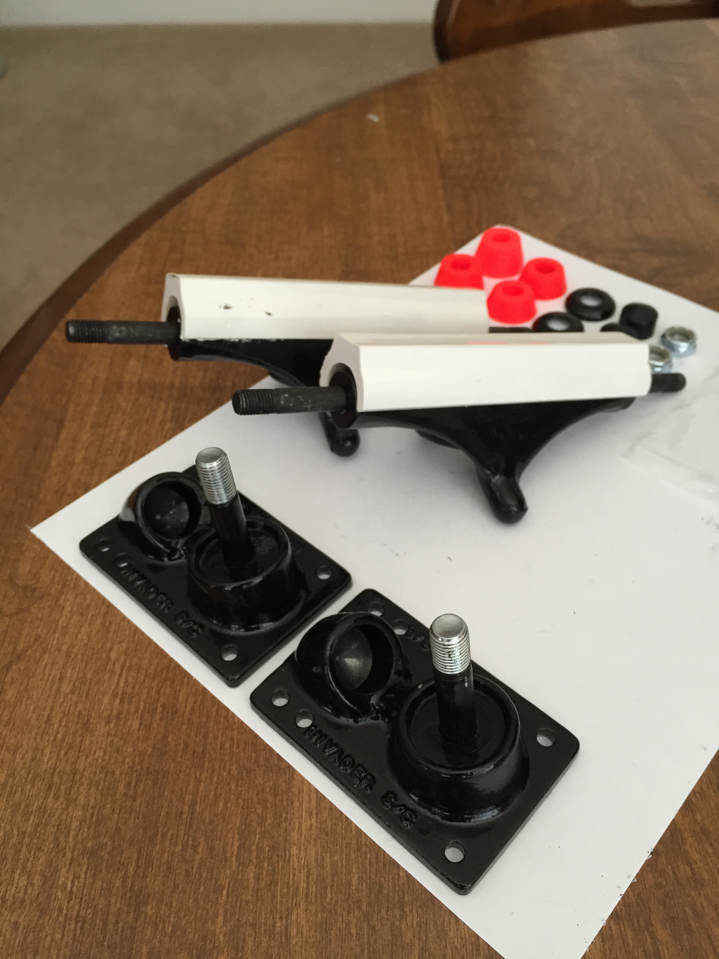

That will likely be the route I end up taking. The project is on the back burner as I have a few other financial commitments at the moment. That said, I did find a set of silver Invader trucks, which I spray painted black and applied the copers to. When I get the stencils done for the board, I'll have them whip up some Madrid stickers for the copers as well.

View attachment 475872View attachment 475873
Did you just buy aftermarket red things? Sorry I don't k?ow what they're called lol
Bushings. Yeah, I bought a set of Venom bushings in red. The trucks came with black bushings and black pivot cups. I figured the red ones are a closer match. I couldn't find any red/orange ones, nor could I find white pivot cups.
