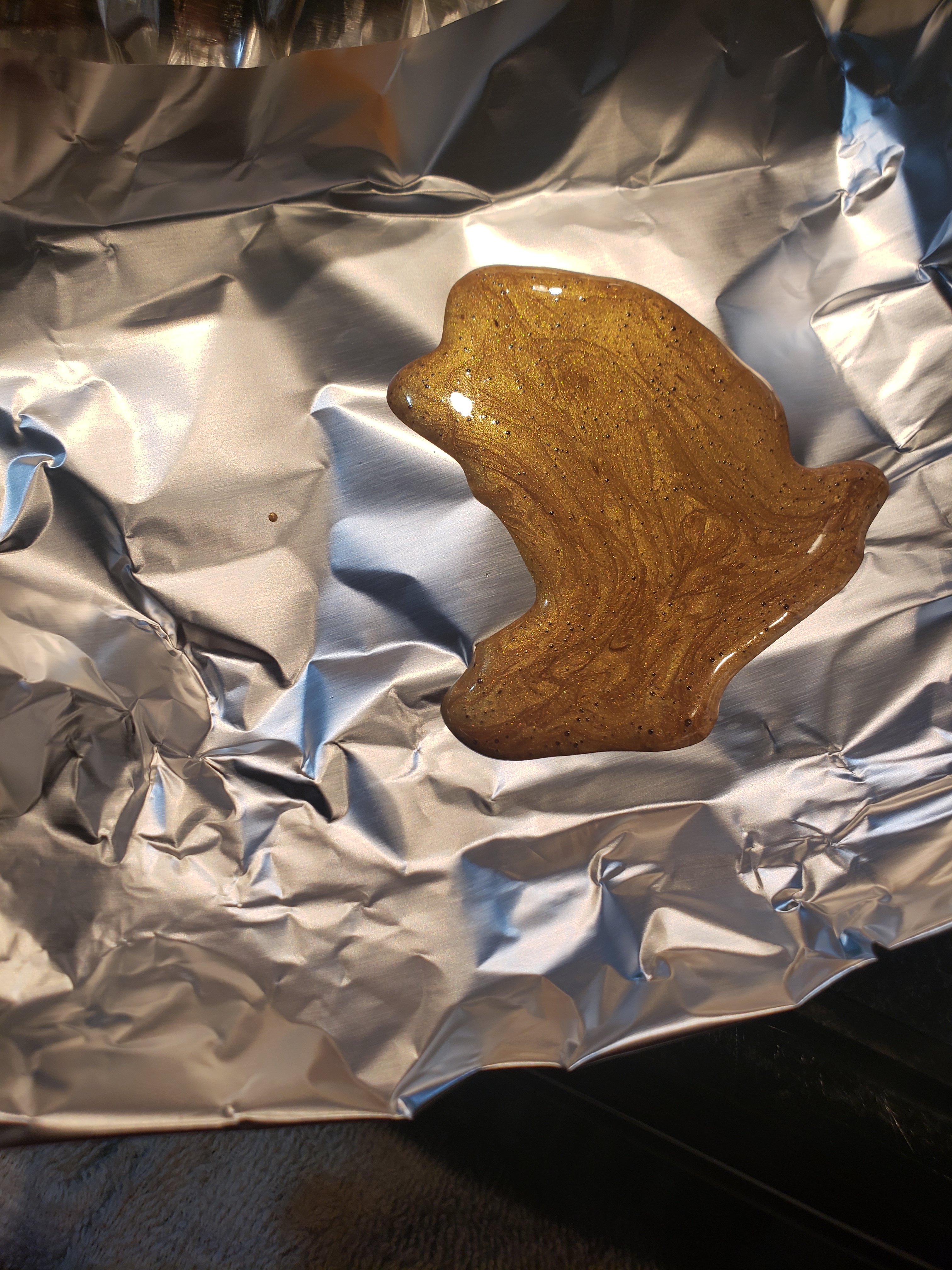

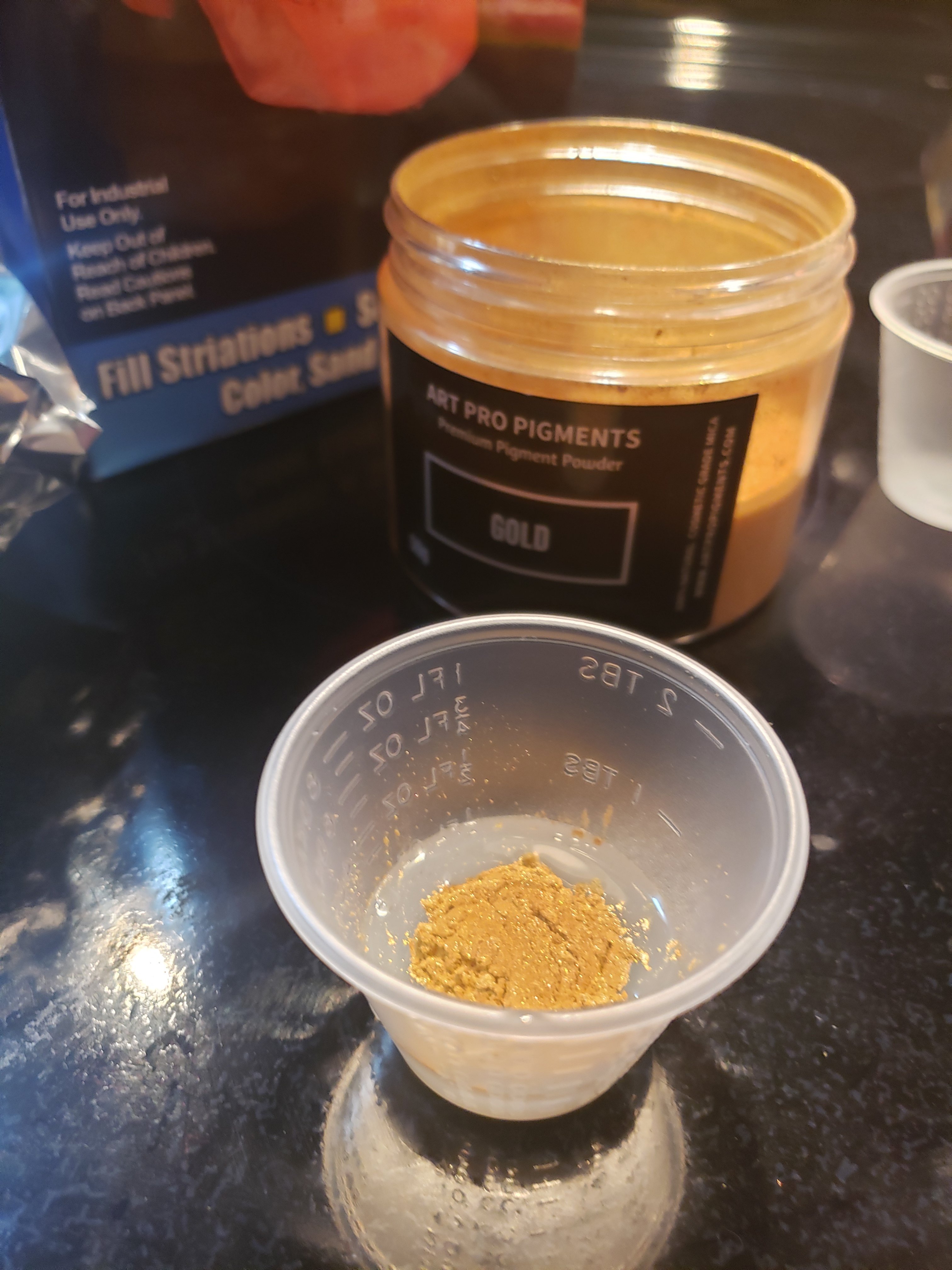

get metal mica powder to put in XTC epoxy. 1 part B, 2 parts A and 1 part silver metal mica powder.

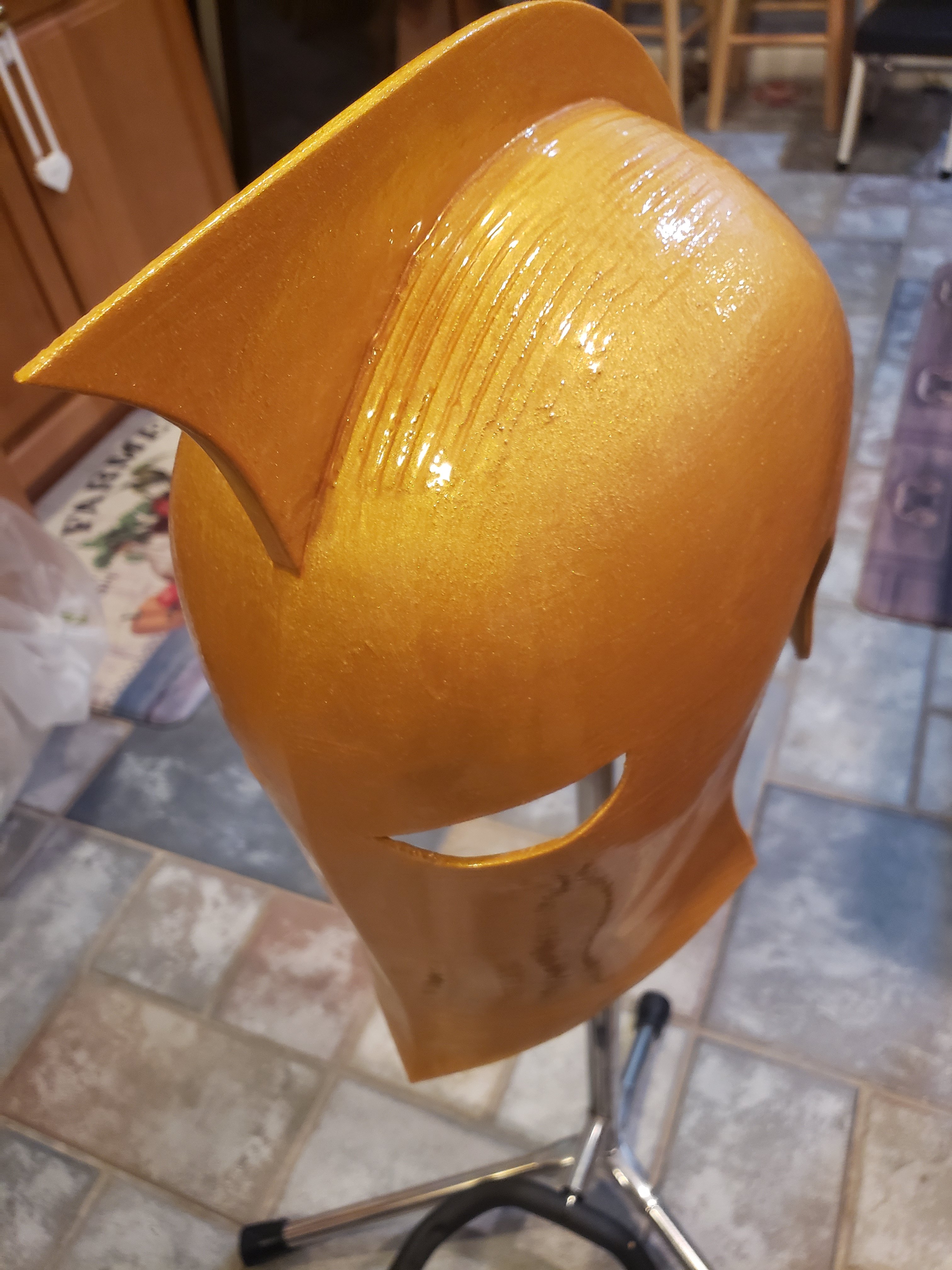

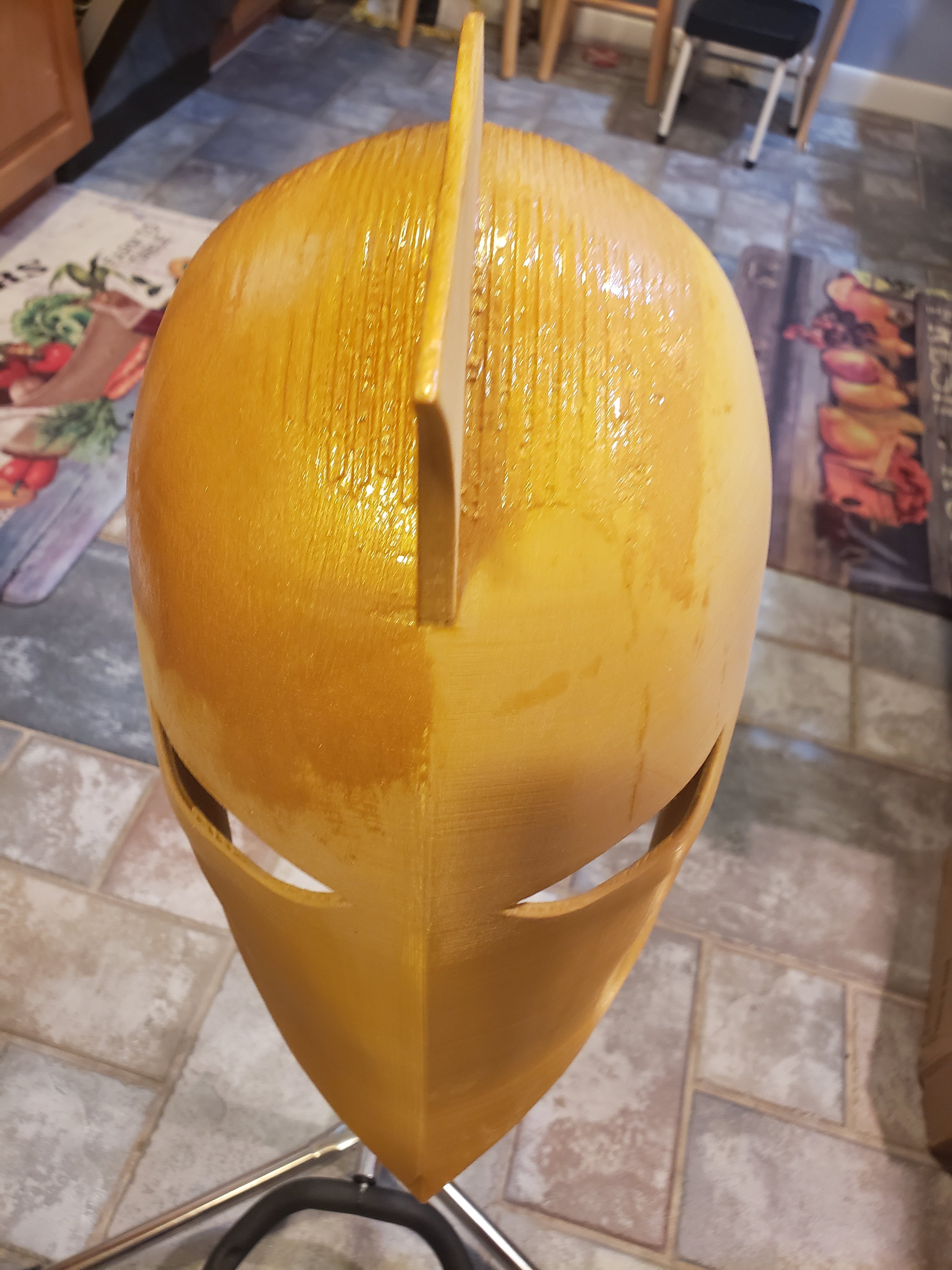

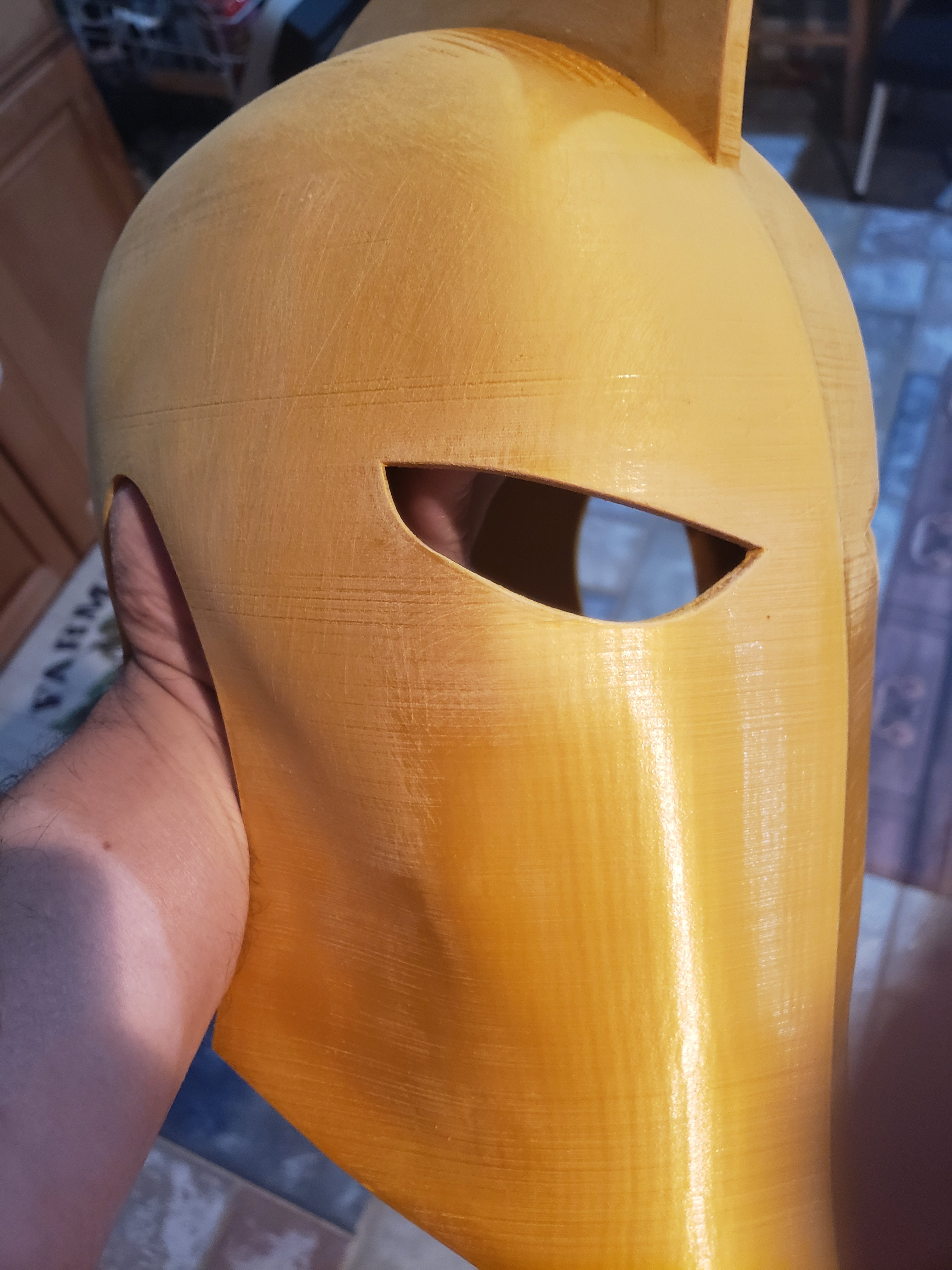

I used silky PLA for a 3d print, sanded and I am going to apply xtc until support lines go away.
