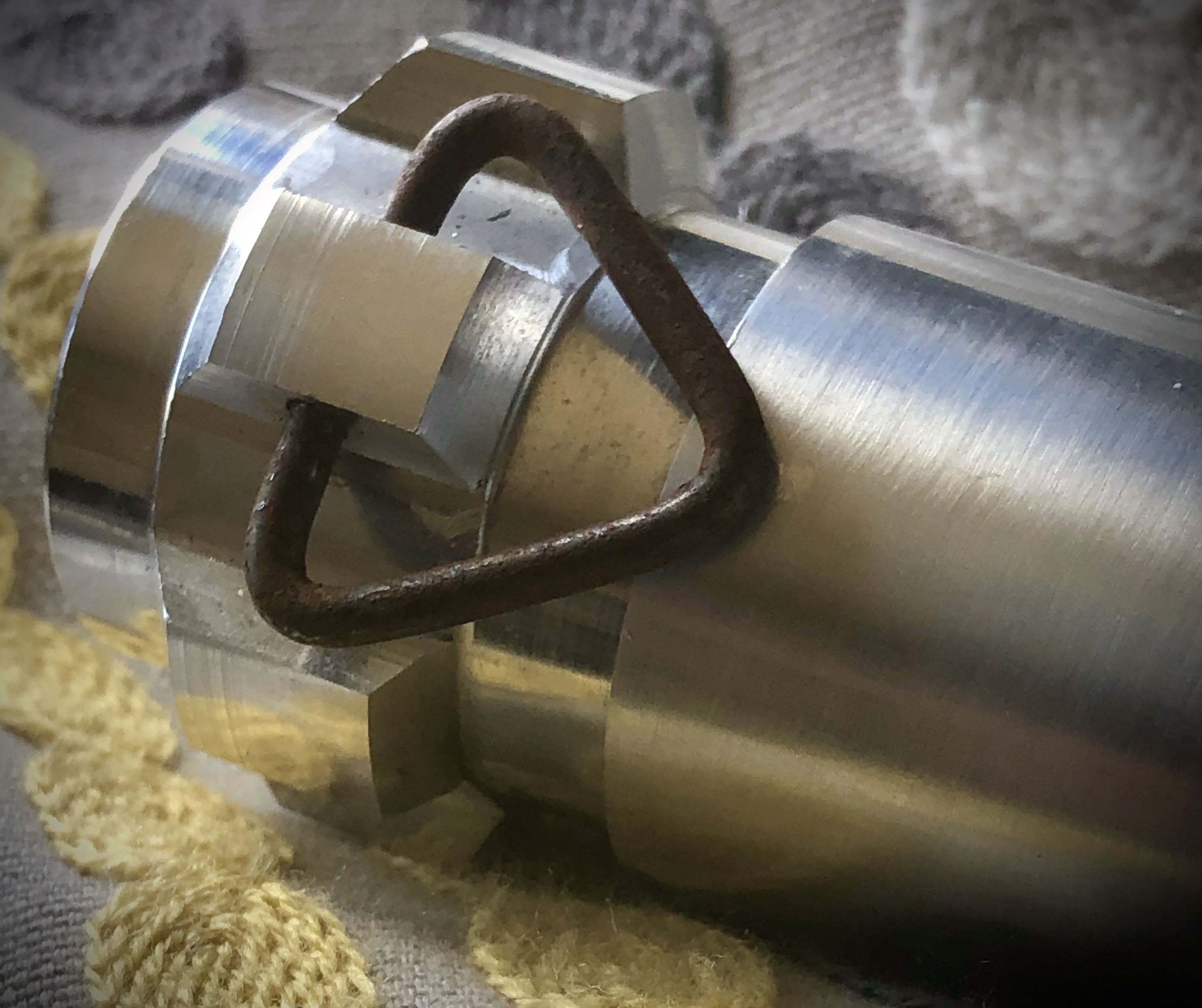

As others have said, these steel versions will rust up quite nicely. This one was placed in a chemical bath for about 45 minutes:

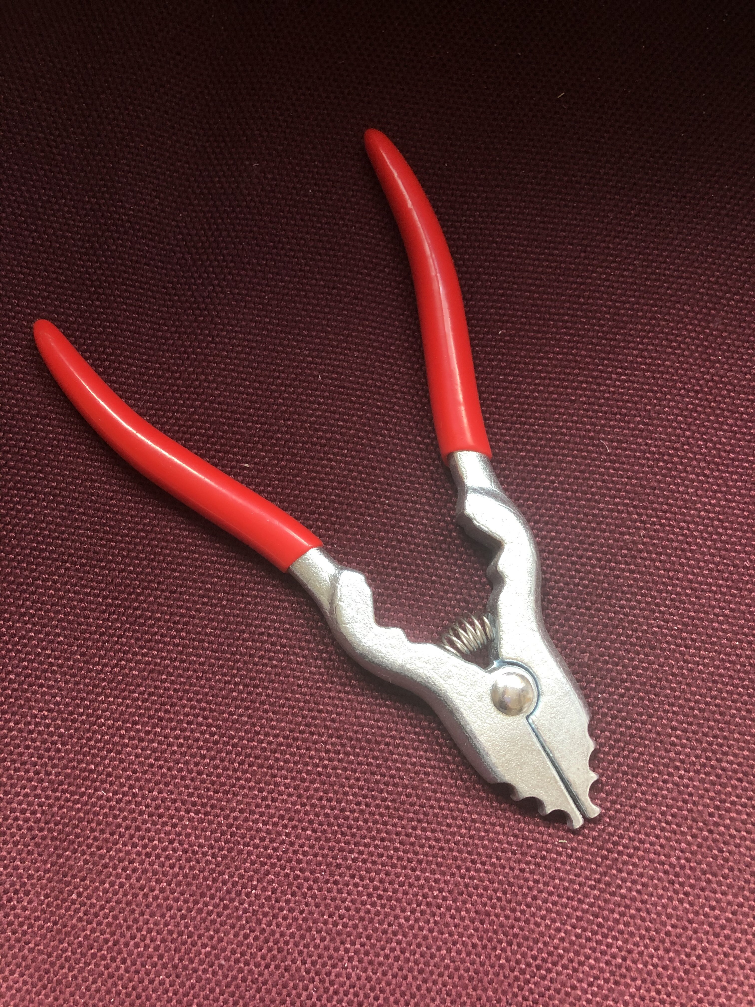

Also, if you don’t already have a pair of these chain-link pliers in your prop-building arsenal, you need to. Gone for me are the days of having to hack-off pieces of d-ring to attach them to my builds. These pliers will spread apart a d-ring (or tri-ring) and close it back up—without deformation—with ease.
That's rusted up great! Can I ask which chemicals you used?
Gotta get myself some of those too! I've been opening mine up with two sets of pliers and then closing back up in the vice. It's a pain. I guess these just hold it open long enough to get on and then it springs back when you're done?
Sure. It’s a simple bath of peroxide and salt. Place the tri-ring in a bowl and, in a well-ventilated area, spray it with a generous amount of peroxide (I omitted the vinegar and it didn’t seem to matter) and sprinkle salt over the top. I repeated this process for about 45 minutes until I had the finish I wanted.

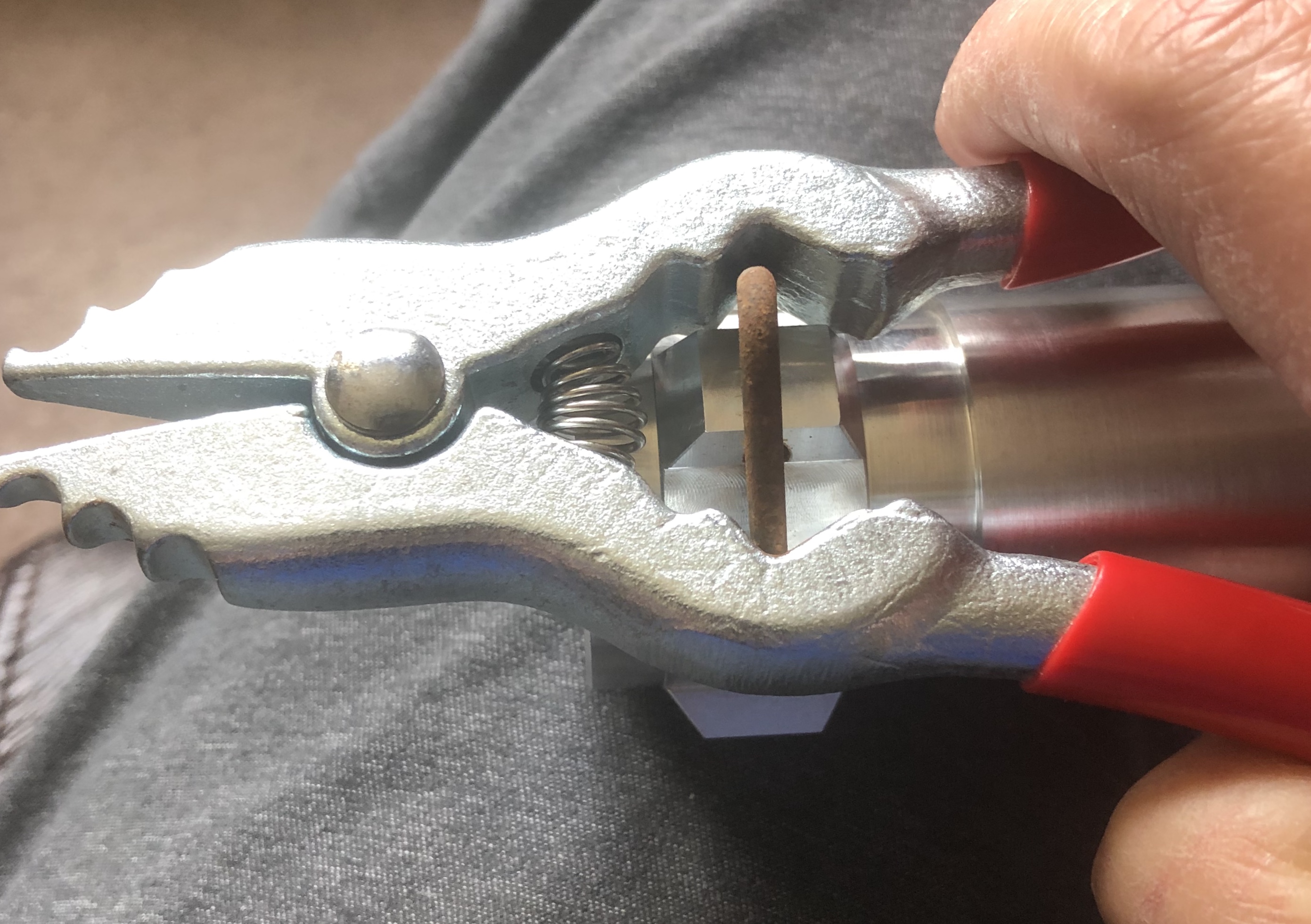

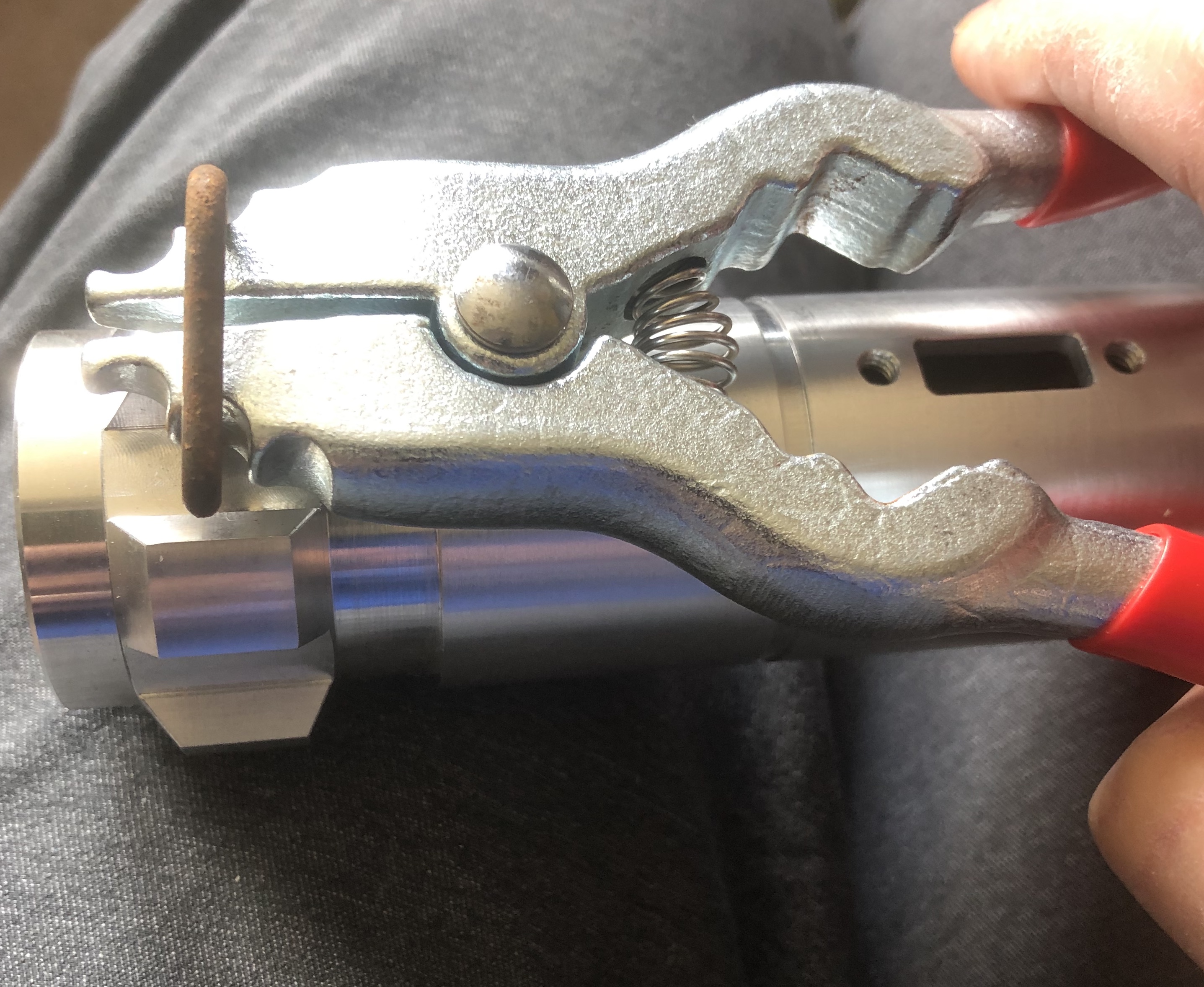

The chain-link pliers work very simply.
Open the ring using the front jaws of the head....
....and close the ring using the rear jaws of the head.
Sure. It’s a simple bath of peroxide and salt. Place the tri-ring in a bowl and, in a well-ventilated area, spray it with a generous amount of peroxide and sprinkle salt over the top. I repeated this process for about 45 minutes until I had the finish I wanted.
One opens the ring using the front of the head....
....and closes the ring using the rear of the head.
Thanks for that! That's great. Well I'm sold! It's like they were made for saber enthusiasts! :D Definitely on my shopping list. Cheers! (y)
I just ordered a set of those pliers, the D-ring and tri-ring install was always my most stressful part of any saber build. Thanks for the heads-up!
Got a link to that exact model?
