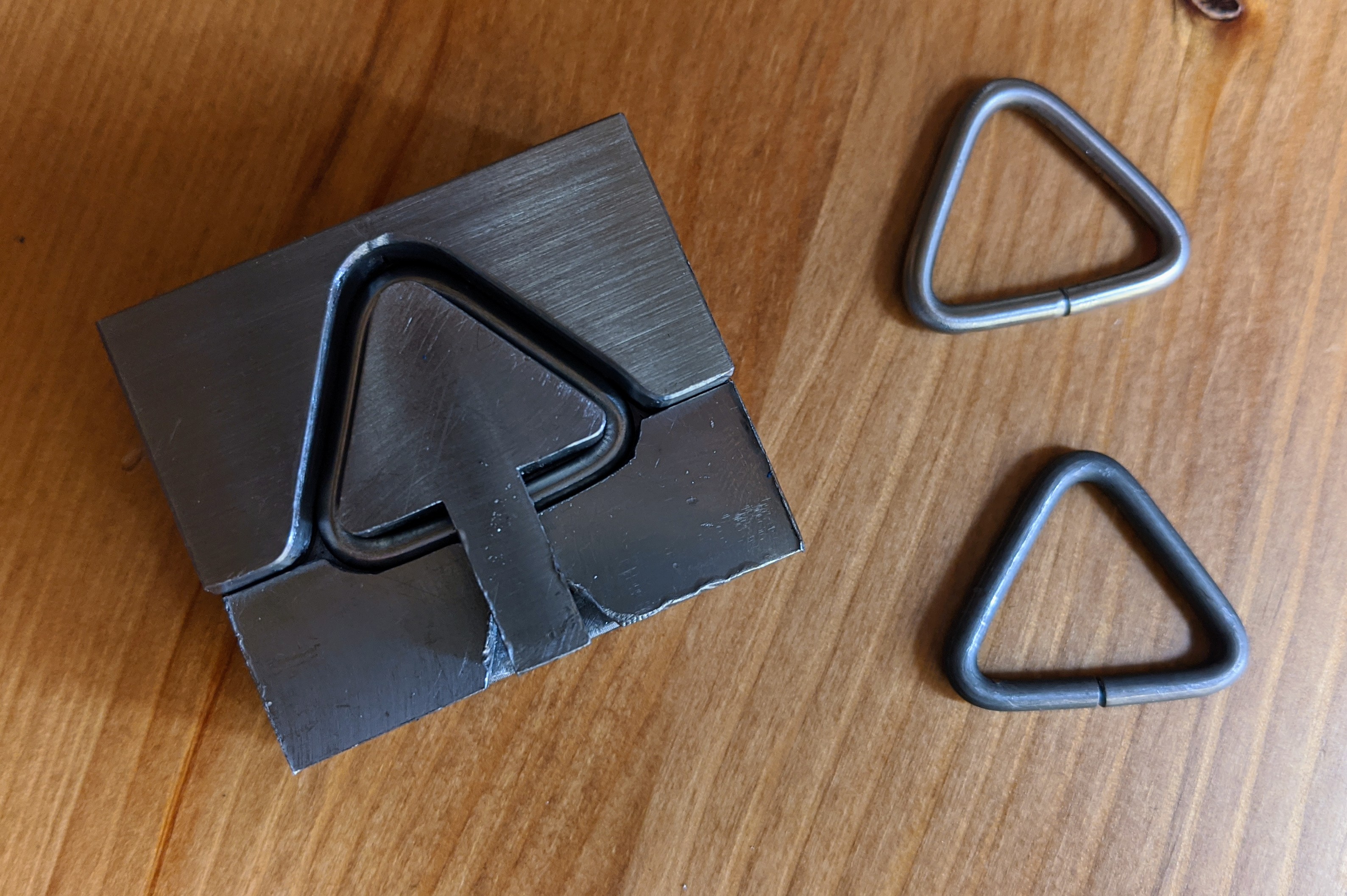

I actually included the tri-ring as part of my modelling process when I was working out the dimensions of the Yuma/ISYHCANL prop, and recreated them by hand to the best of my ability, having worked out the length of steel rod required for each bent and straight section of the ring.
Mine were originally made from stainless steel, which I dulled and discoloured to look more like mild steel (the actual material). This was because I didn't want them to rust uncontrollably over time.
Because they were made by hand, using a vice and pliers, they were particularly difficult to get right. There was also a degree of variation and irregularity to them which was something that bothered me (even though the original itself is slightly irregular).
So, based on the accurate model I'd produced, I decided to design a vice jig to help make them in future:
This was originally intended as an interest thread, in the hope that, if it gained enough support, I could get the jig made and offer the rings for sale on here, as well as providing them in my future runs of Yuma/ISYHCANL/Hero kits.
Well, there was a LOT of interest, and I got the jig made! It's still going strong and making lovely, screen accurate Tri-Rings for anyone who wants one. :)

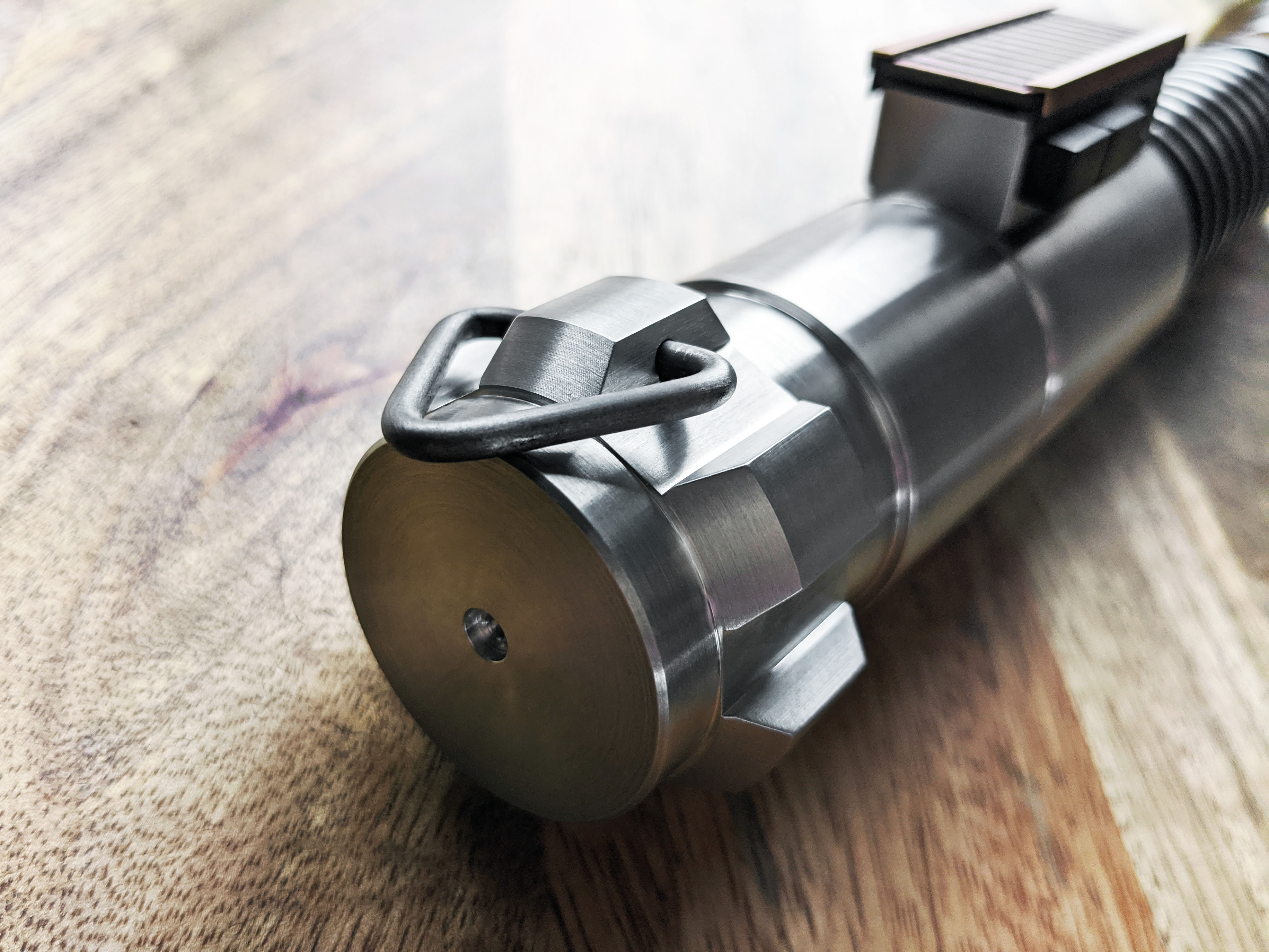

They are available in screen accurate Mild Steel (which will rust over time), or Stainless Steel (which will remain shiny and new forever):

Also, what diameter steel are you planning to use 4 or 5 mm?
3mm is actually the correct diameter for the ring. I believe I use a 3.5 bit for the hole but I'd have to check that. In bed at the moment! :lol:
