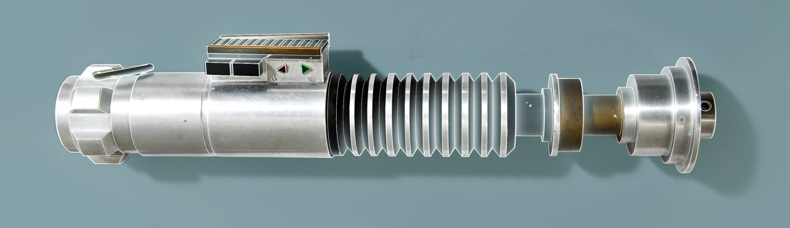

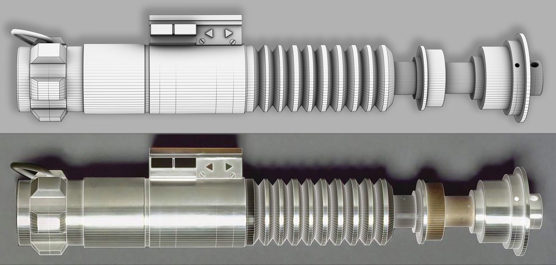

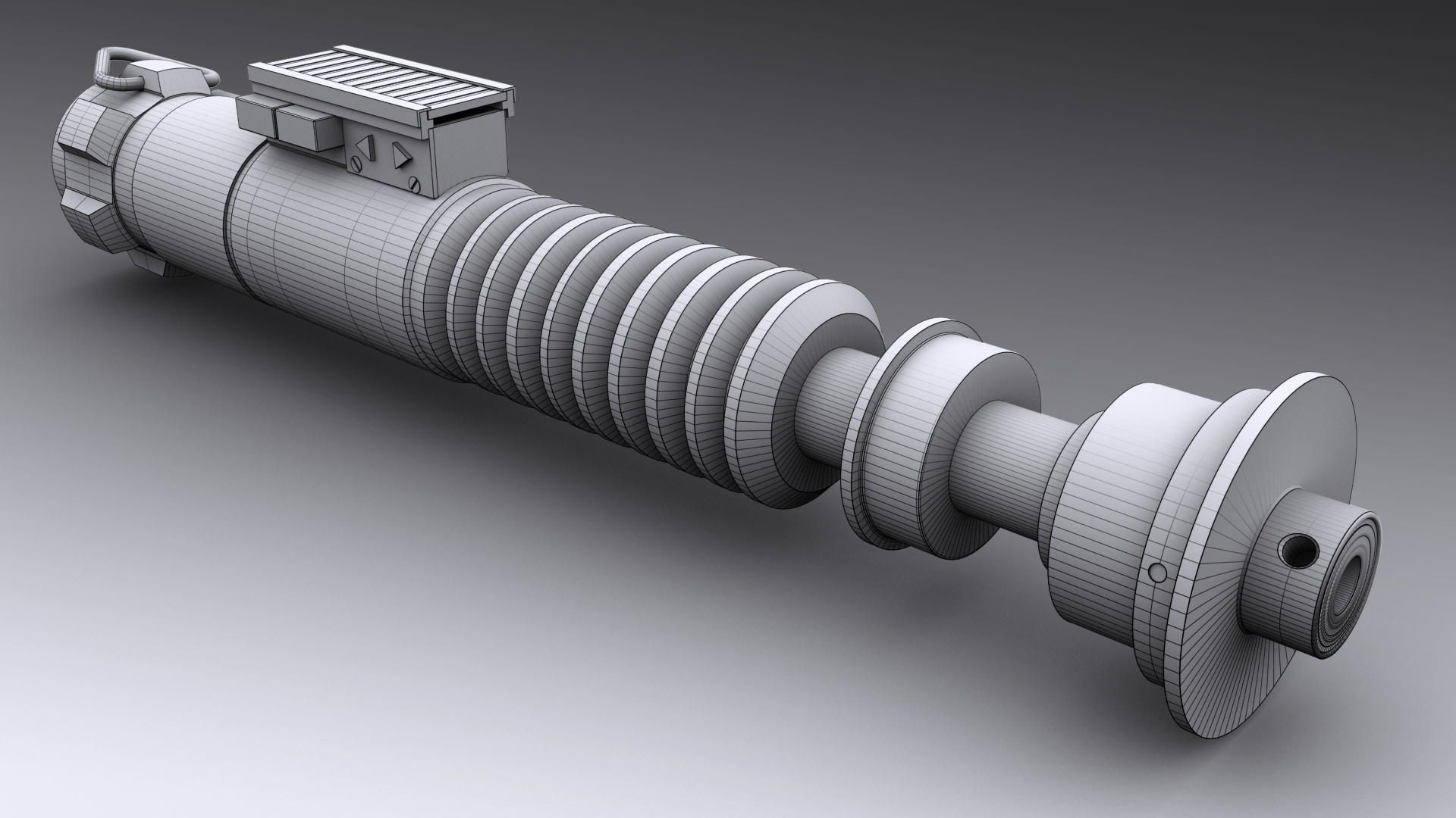

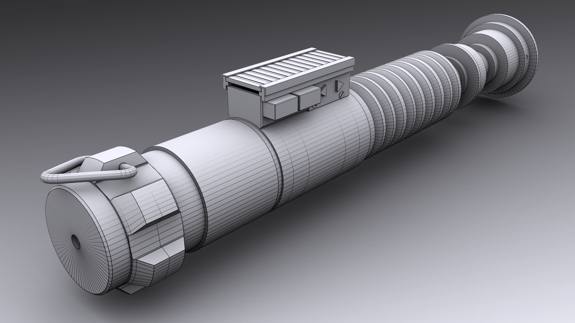

Here are some shots of the final models:
The previous run was already very accurate, so the changes are very subtle, but here's a quick list of some of the things that have changed:
  • Every edge has been reevaluated and adjusted to match higher res reference images
  • Transition from control box section to grenade section is no longer 90 step
  • Some of the edges have been softened on the neck ("copper") section to match the reference images
  • The position of the second grub screw has moved slightly
  • The screw and triangle positions/orientations have changed slightly
  • The hero box screws are now M1.6 2mm screws rather than M1.4 3mm
  • The triangles are now a fraction larger
  • I have sourced a more accurate T strip to the one provided with the previous kit
  • Deeper black buttons
  • Functioning second grub screw (deeper emitter entrance)

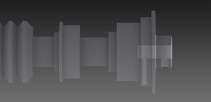

The emitter now has a deeper entrance to take a short Yuma blade tang, which can be secured using the second, functioning grub screw:
For the Hero version, this can be filled in and painted, as it is on the original prop.

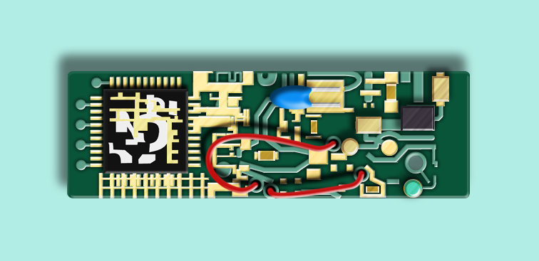

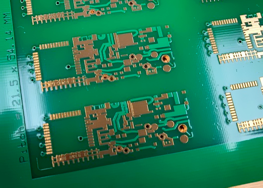

I did receive a picture from the manufacturer today.....
These are still in production and have another process (gold plating) to go through before being cut out, but I couldn't resist sharing!

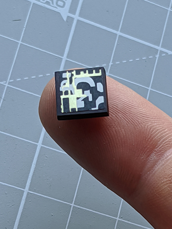

The other image is the stand-in microcontroller that will sit inside the blank square. It has one of the gold foil labels I've had produced applied.
Hopefully you can picture the final thing based on the concept I mocked up:

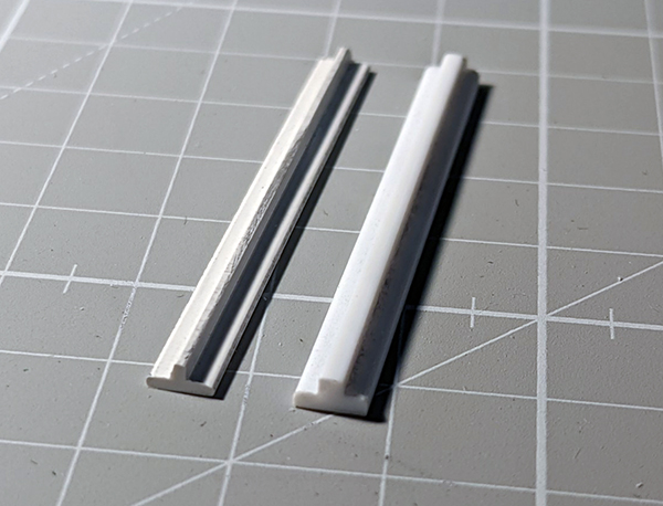

Another welcome development is that I had a delivery of new T-Section. I'm happy to say that it's a massive improvement on the previous run! The T profile I sourced previously was a little thin for my liking, but it was the closest thing that I could find at the time. All attempts to have them manufactured came to a dead end, with the 3D printed ones I had made warping and chipping due to their size (Which is why they weren't included in the kits).
Well, I'm happy to say that I've finally found something that is as close to screen accurate as you can get! They are also a much sturdier material (the last ones were a little rubbery in texture):
*New ones on the right

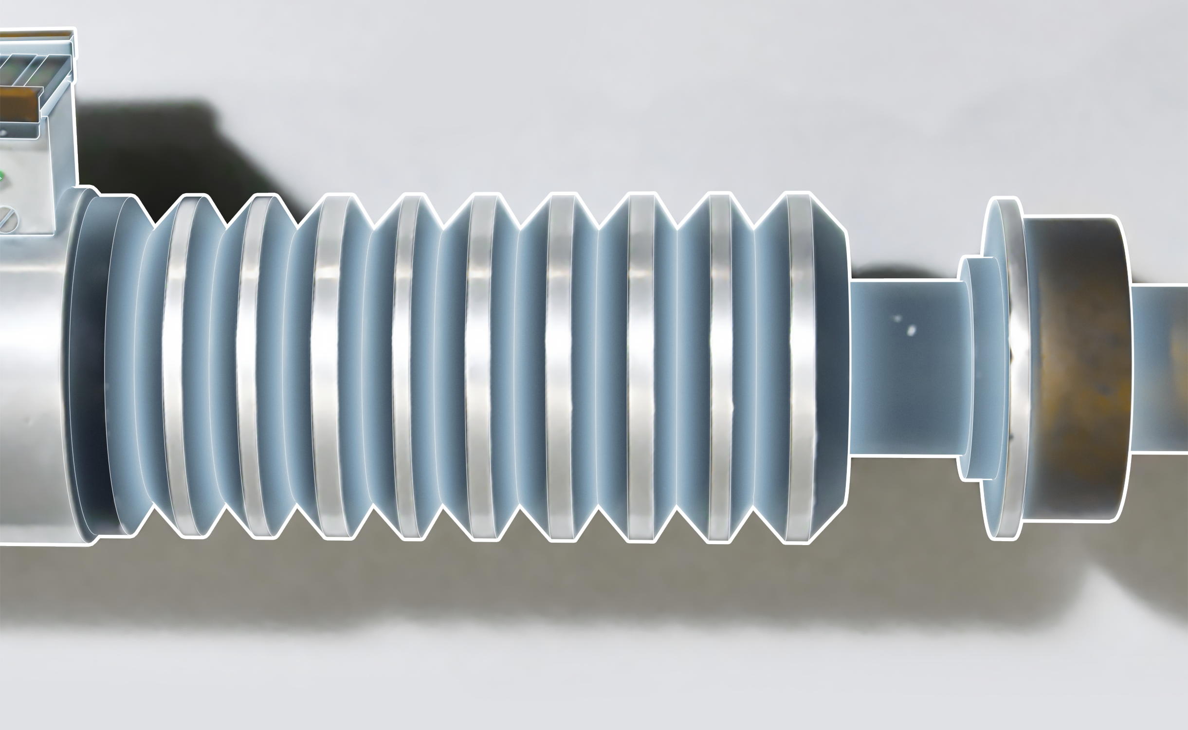

I know I said I was done with adjusting the model, but there was some discussion behind the scenes regarding the grenade section...

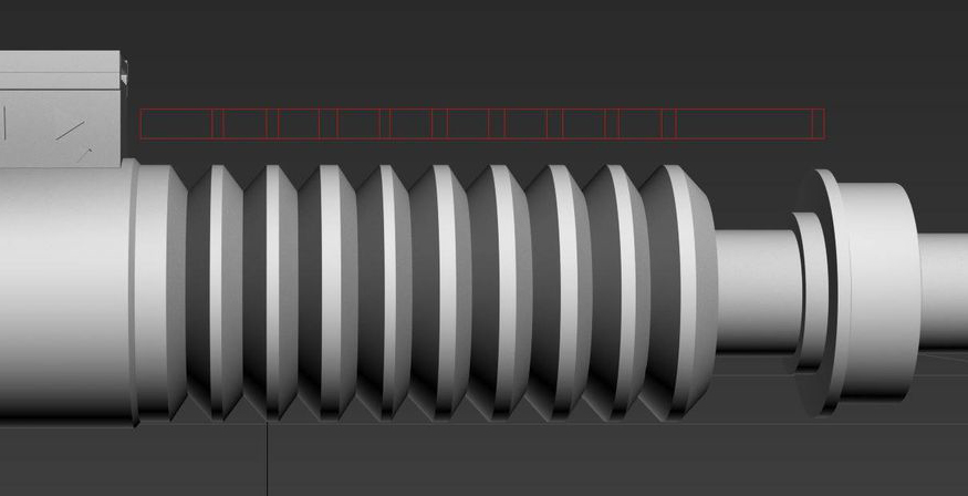

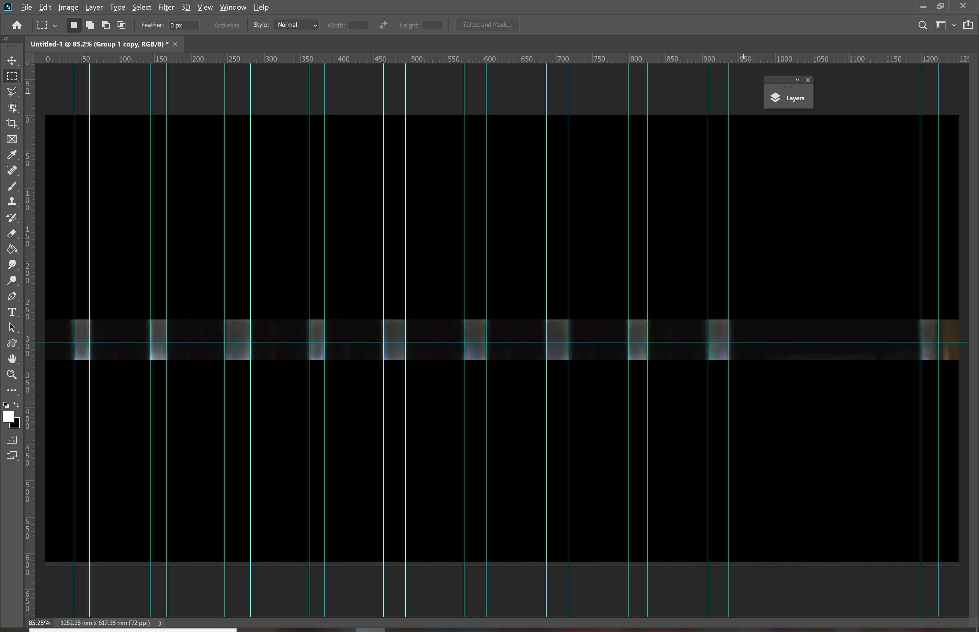

In order to put the grenade ring thickness debate to rest once and for all, I decided to do a little old-school photogrammetry using photoshop.
I took the most side-on high-res shot of the grenade available, blew it up to 4K, increased the contrast and played with the levels to remove any bloom, and then proceeded to use the analysis tools inside of photoshop to get accurate measurements for each ring and each gap between them (to three decimal places of a mm). I used the known distance between the first ring and the neck ring to set the scale.
I then built a reference grid inside of 3DS Max using these measurements, for me to snap the vertices of the model to along the X axis:
The model changed very little, so I won't be updating the renders and overlays. It was a valuable exercise though, as it adds to the certainty that the model is perfect before sending to the manufacturer. :)
