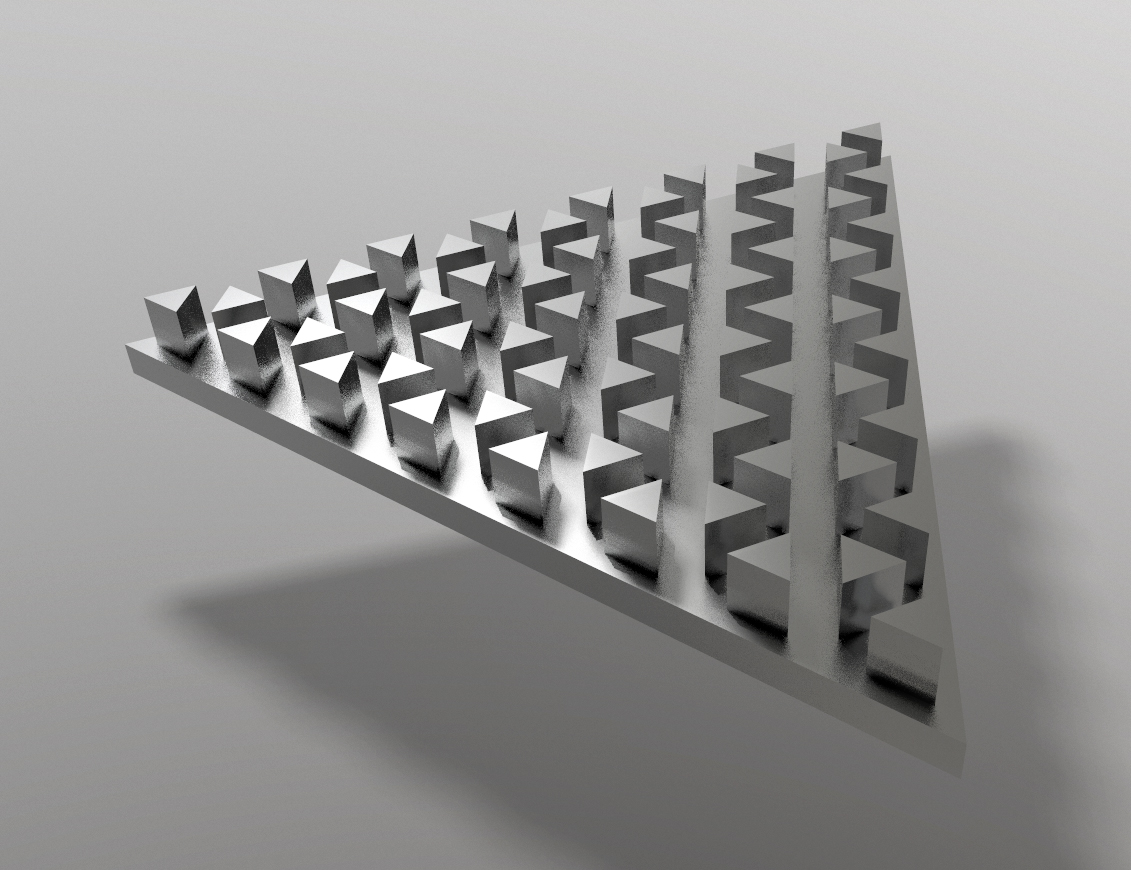

I have ordered the master for my new triangles. I've mentioned these before, but I actually ordered the part to be CNCd this week. This was a bit of an upfront cost to the run, but it will be well worth it to ensure that each triangle is identical in size and shape. I have had the master CNC'd in aluminium and will be making a silicone mould of this when it arrives. I’ll then be casting in clear resin with red and green pigments. The master will make for a nice memento after the run is finished, and will always be there should I need to make more in the future:
The triangles are obviously longer than they need to be on the master. Cutting them to length is easy. It's the shape that's the tricky part! :D

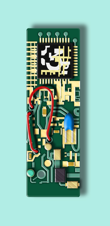

The PCBs have been an interesting journey! I can tell you that I've now placed the order for 100 boards! Half for the run, and half for a stand alone run that I'll be posting once they're ready. These are going to be beautiful! I've opted to have the layout printed in gold! The masked areas will show up as two tone green (as you'd expect). the exposed metal will be gold. The reason for this is that the additional gold overlays present on the original prop have been incorporated in to the board design, which I think is going to look great!
Here's a very rough Photoshop concept of the final design (*Component positions/sizes are subject to change*):

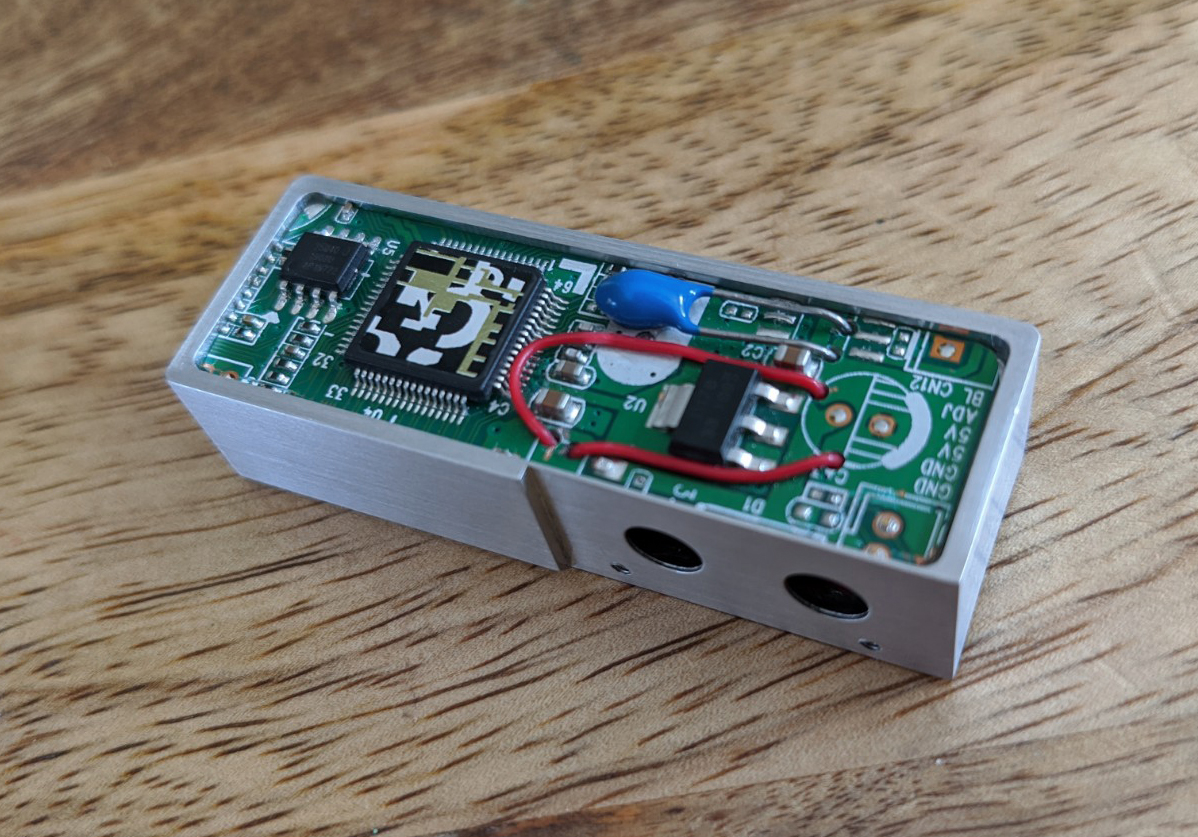

Unfortunately, the cost of having these assembled as well as printed worked out WAY too expensive! This has forced me to think creatively about how to build up the components on the boards myself. I've sourced some real components, including the blue capacitor. I've also sourced some 10mm acrylic squares to represent the micro-controller. The connectors for this have been incorporated in to the board design, so it will look like the real deal.

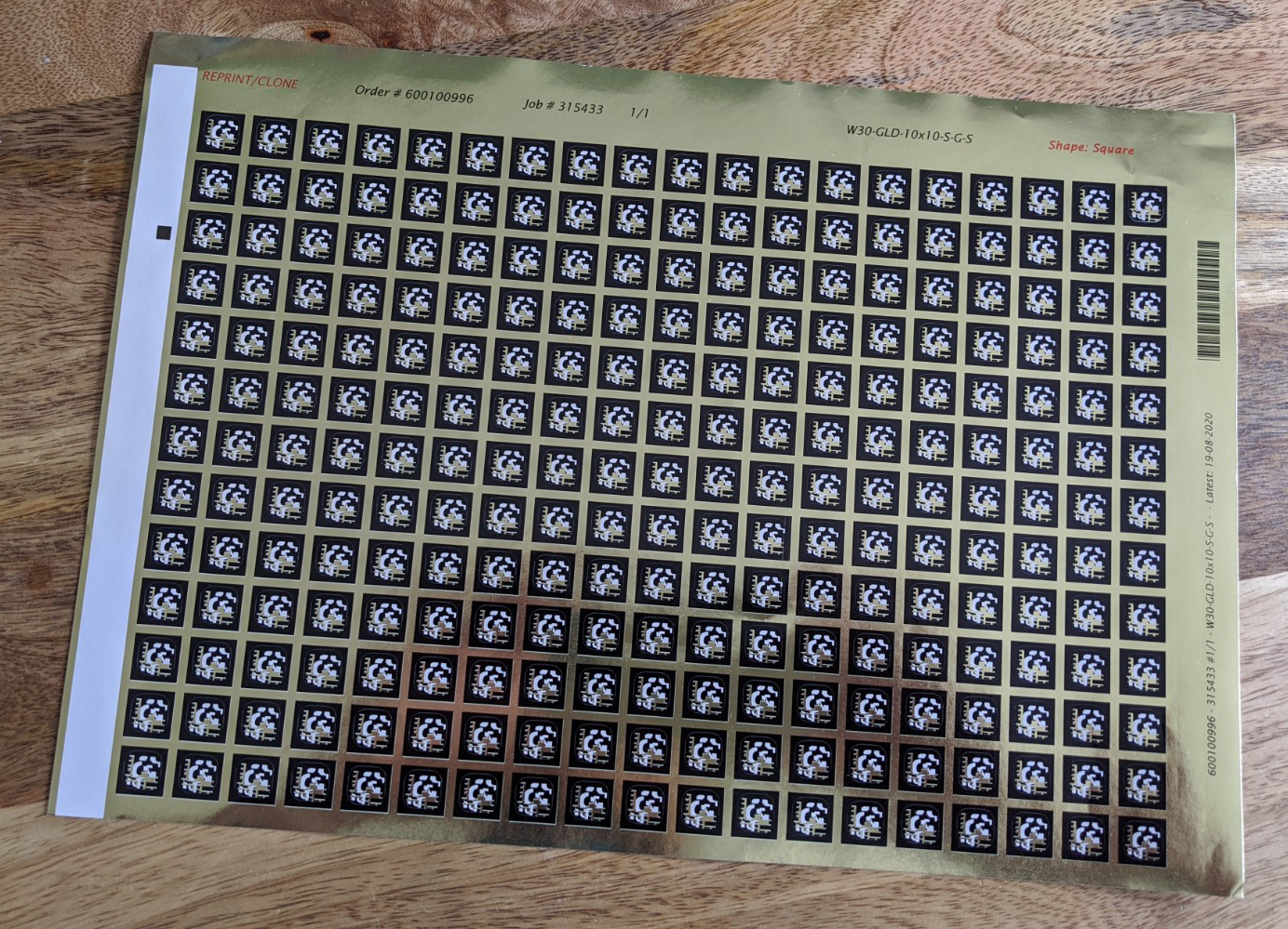

To finish off the look of the controller, I’ve had the unusual logo/gold foil design found on the original prop printed on to 10mm foil labels. I’m REALLY chuffed with how these have turned out! It’s just a small detail, but it really makes a difference!
I’ve tested it out here on a piece of PCB that I’d been messing around with (The layout of this board isn’t accurate to the original prop):

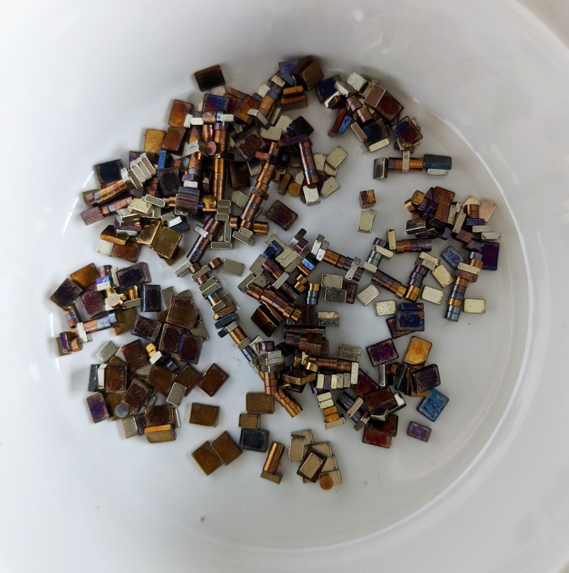

In addition to the real parts, and other bits, I’ve sourced some tiny neodymium magnets to represent some of the board’s features. I demagnetised these by heating them past their curie point. This aged them nicely too and added some interesting colouration (y):
