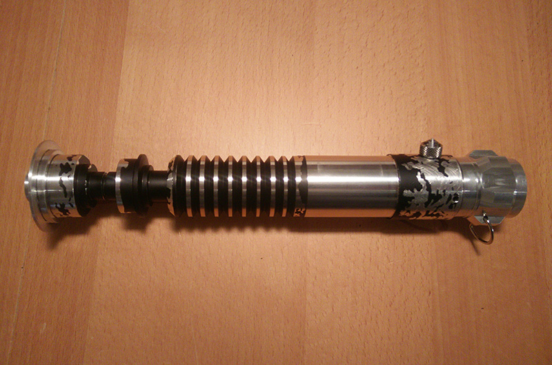

HI. After some days of work, here is mine finished.
I used "spraymax" black epoxy primer for an "ultra hard" adhesion over aluminium, I used booster and emmiter front face trent stencils and customized after to break the flat look (used some wood and plastic tools for it to avoid scratching the surface), then sanded the primer with a 400/600 sandpaper and polished with "renaissance wax".
Thinking on weathering the booster a bit more but not decided yet. Also need to add the chunk piece but unfortunately, i dont have the neccesary tools...
Anyway, hope you like it :)
PS: Clamp is a vintage one. Roman´s were taking too long
luke v2 lightsaber by inigou, en Flickr

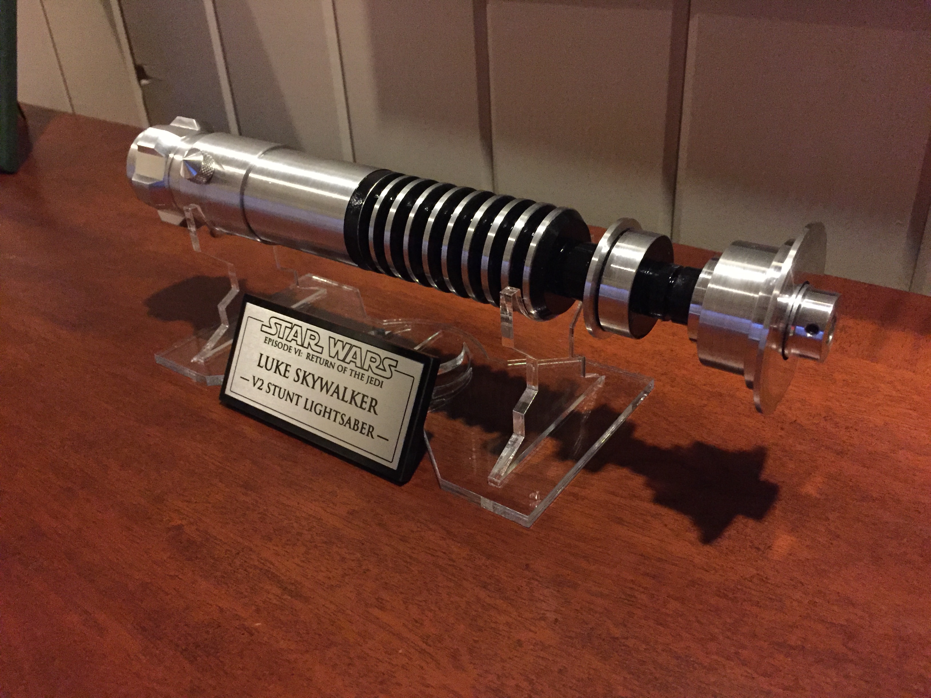

My Luke V2 lightsaber.
Finished the paint job on it today, only missing the lever, clamp and the mystery chunk.
Thanks.
I used the stencils made by Trooper_trent and for the paint i used CRC Pro Paint Matt Black Acrylic. I might do the paint job again as I feel the paint isn't sticking enough to the aluminum. It can easily be scratched off using a finger nail. But for a first attempt on a lightsaber build, I'm quite happy with the result.

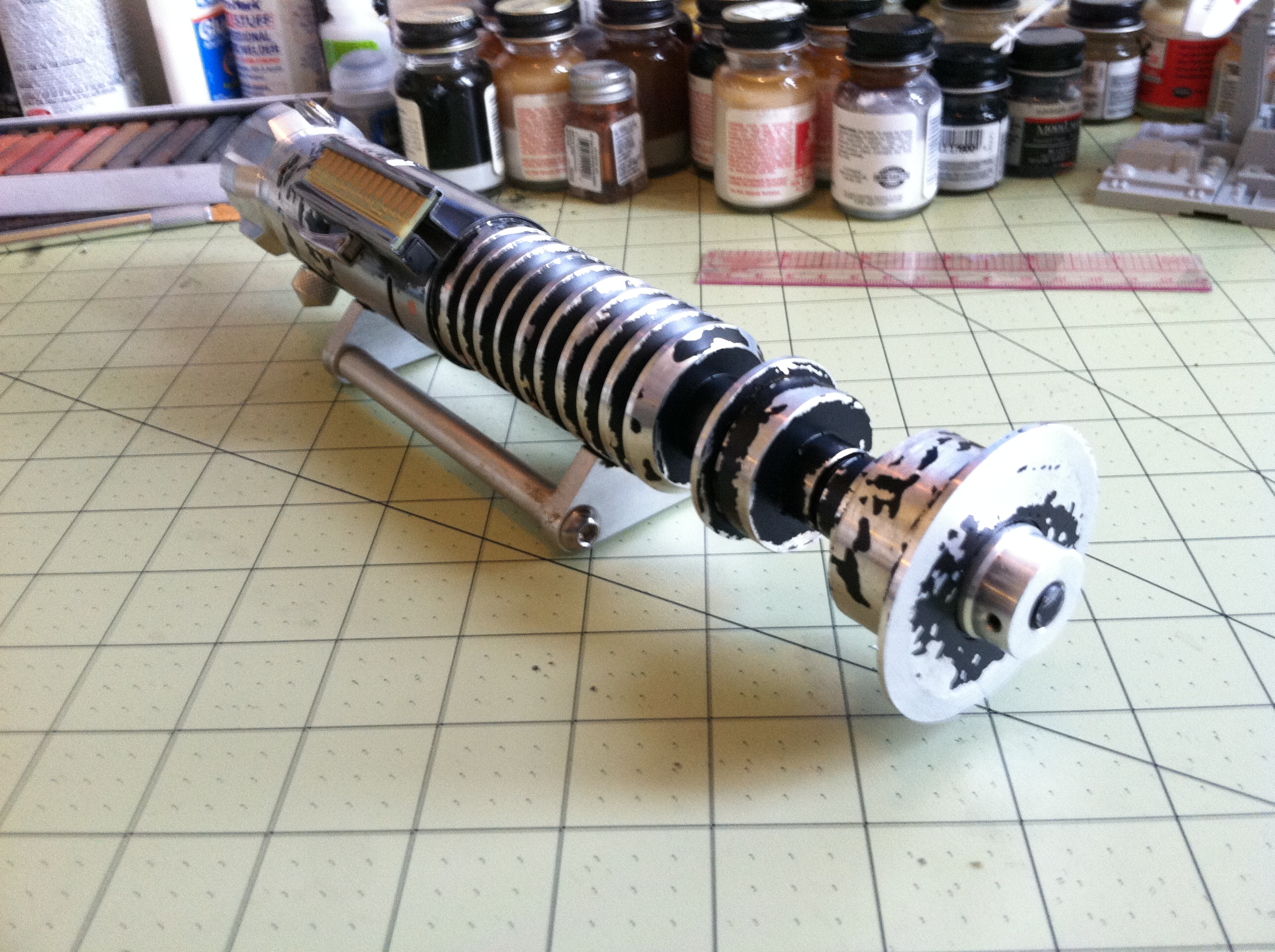

Here's mine, painted a week ago. The clamp I stole from my Obi-wan ANH saber for now, new Roman clamp will go on once that shows up mid Summer. I used Trooper Trent's stencils and chipped other areas myself. Paint is Krylon Colormaster paint + primer satin black. I took a hammer and sandpaper to it prior to painting and discolored the aluminum a little with multiple soakings in oven cleaner spray. D-ring is from Roy, ordered with the clamp lever (and parts for the new Roman Graflex flashgun) Rod end I painted black too, then chipped around the edges so there is a rough black paint area in the middle. Still need to tin the leads on the circuit board
