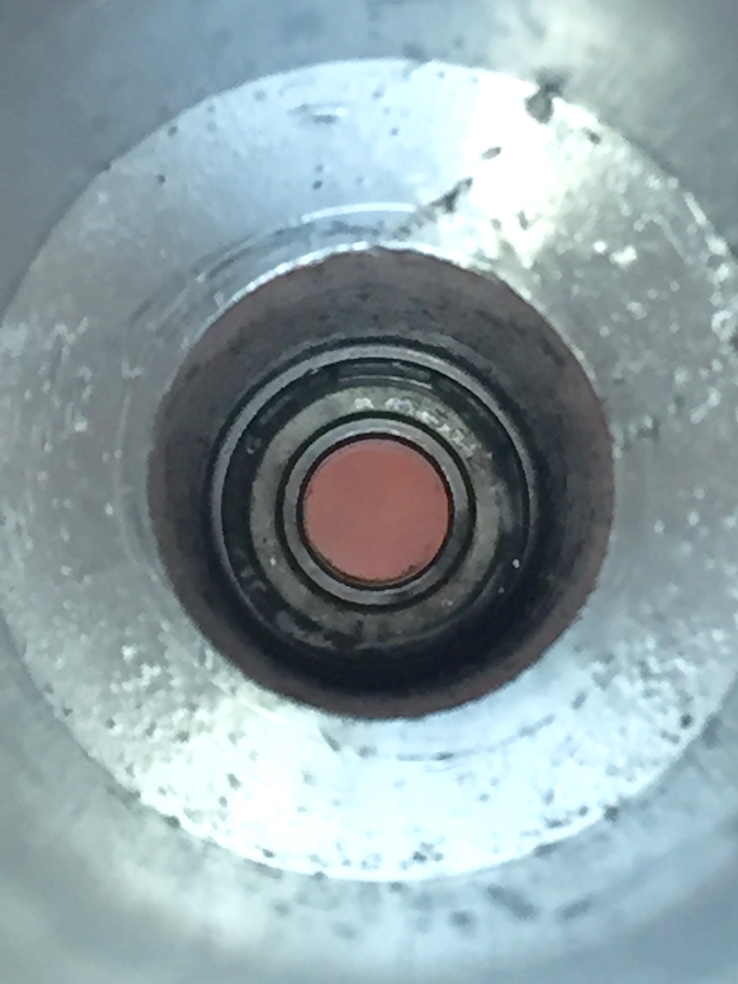

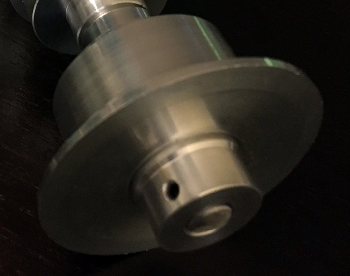

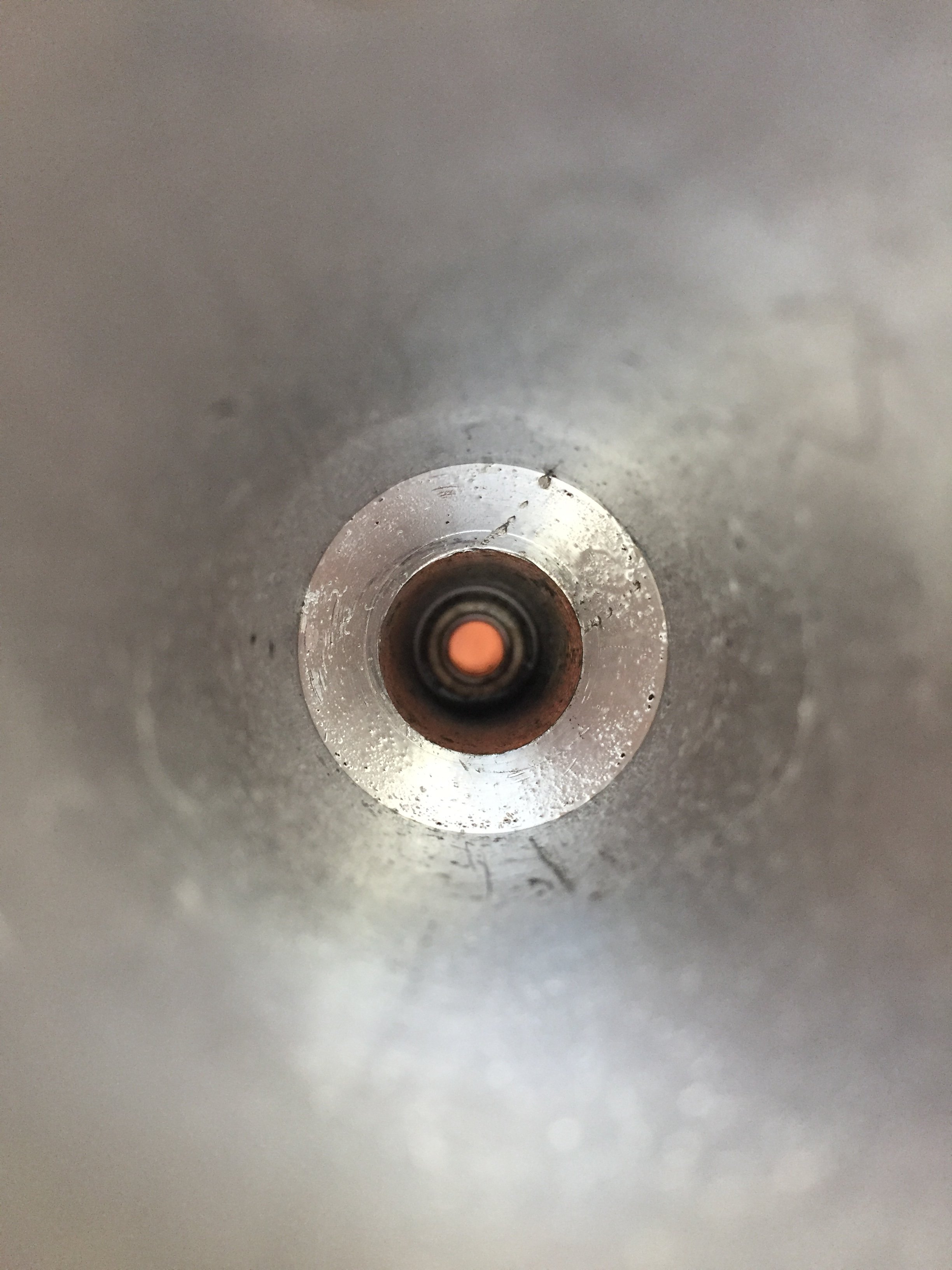

I'm not quite sure that I understand what you mean? From which end do I slide the pipe, and how does that relate to the rod? Are you telling me to put the rod back in? Sorry for all the questions, i'm just a little frenetic trying to figure out a solution. Also incase anyone was wondering this is the hole I meant was missing from mine. (I hope you don't mind me re-ususing your pic) View attachment 611681. Here is the current condition of my bearingView attachment 611682View attachment 611683
I have the exact same problem. The farther in I push the bearing into the hilt the further angled the shaft becomes out of the tip, to the point where it binds and cannot be pushed in any further. At this point it does not stick out far enough to attach the emitter, which I wouldn't anyway since it is not aligned with the hilt. Really seems the bore inside the hilt is not parallel with the body of the hilt and the hole at the end. Not really sure what can be done. Only thing I can think of would be to use something else instead of the bearing and have it loose fit inside the hilt. Only issue for me in doing this is the centering of the emitter would rely on the fit between the hole in the hilt and the shaft, which is a bit loose, so the emitter would be a bit wiggly. Not ideal.

I'm sorry to say that I have not. The closest I've come to is that using a drill attached to the rod and allot of lubricant to get it in far enough to where the emitter stays on, however it as at bad angle, so I would also say it is not an Ideal solution either way. I agree that it seems that the bore is somehow not parallel.
I had a similar issue with my bearing as well. No matter how hard I tried, I couldn't keep it to stay even and it would always bind on one side or the other. Eventually, from tapping on the sides trying to make/keep them even, the side of the bearing came off. Not wanting to make it worse, I used the shaft collar. There's a tiny bit of rattle but I pretend the original may have had a few pieces of the old motor in them still lol.

I spent many hours trying to fit the bearing and shaft collar to the metal rod with no such joy at all. I finally got out the Dremmel. Using a sanding drum i gently sanded the end of the rod down until the bearing and shaft collar fitted on. Problem solved and all good i thought. As many have experienced though , the bearing does not line up straight inside the hilt causing the metal rod to exit for the emitter at an angle and about 5 mm to short for the set screws. I tried everything from hitting it with a long screw driver to adjusting its position on the rod. I really wanted the bearing to be used and not just the shaft collar like some have done.
Anyway out with the Dremmel again and a slow process of gradually sanding the outside of the bearing little by little. A case of keep test fitting until it finally slotted into position and the rod was clear and able to spin freely. With everything lined up and the emitter now held on with the set screws i then quickly ran the dremmel around the pommel lip. 1 complete Sabre..

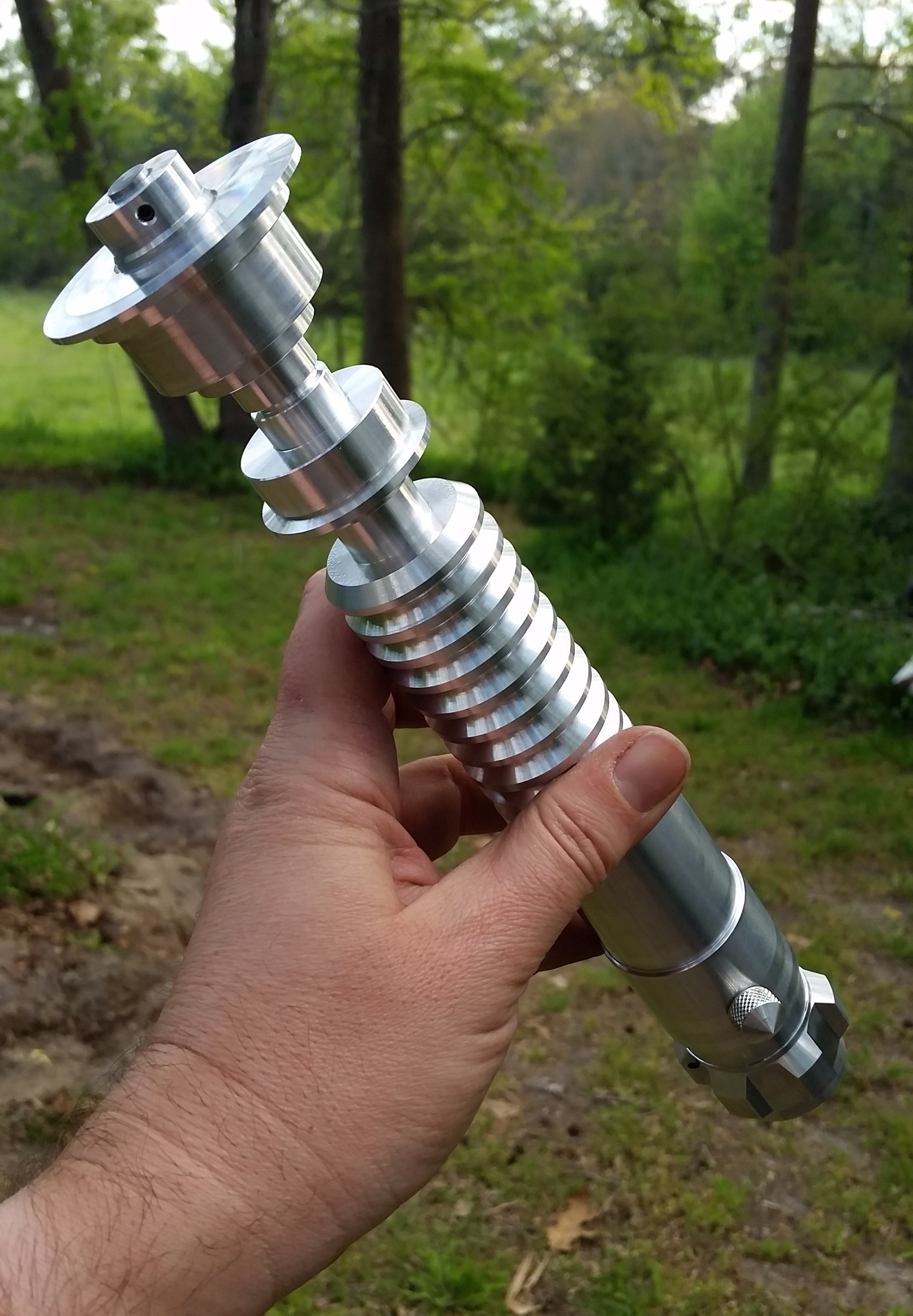

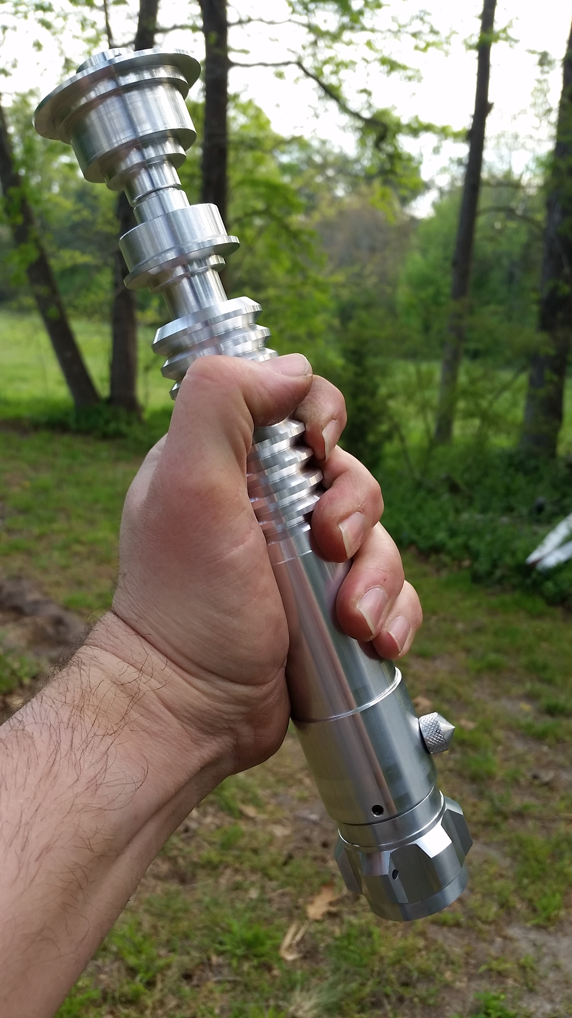

I must have lucked out. My bearing and shaft fit great. I pushed them into place with a wooden dowel rod. Here is a photo before painting. I did have to sand the pommel down to get it to fit nicely in place though.

At my wit's end here. Got the bearing and rod inside finally, only the rod is crooked and now the bearing is damaged. It doesn't spin. I cannot straighten it. I cannot remove it. I maybe could remove the rod but for some reason even that is proving difficult whereas it never was before. I think it's because it's making contact with the inside of the saber's neck. The bearing is all the way up in there, and it was difficult enough to get in, I don't see any way of getting it out now. I've tried using a dowel, and then a screwdriver, and with a hammer using it to push one side of the bearing in an attempt to straighten it out, but it's not working. Also probably how I damaged it.
The rod is at the correct length for the emitter, so at this point I'd settle for just being able to straighten it somehow. Also inclined to pay someone to fix it for me at this point, it's making me crazy.
