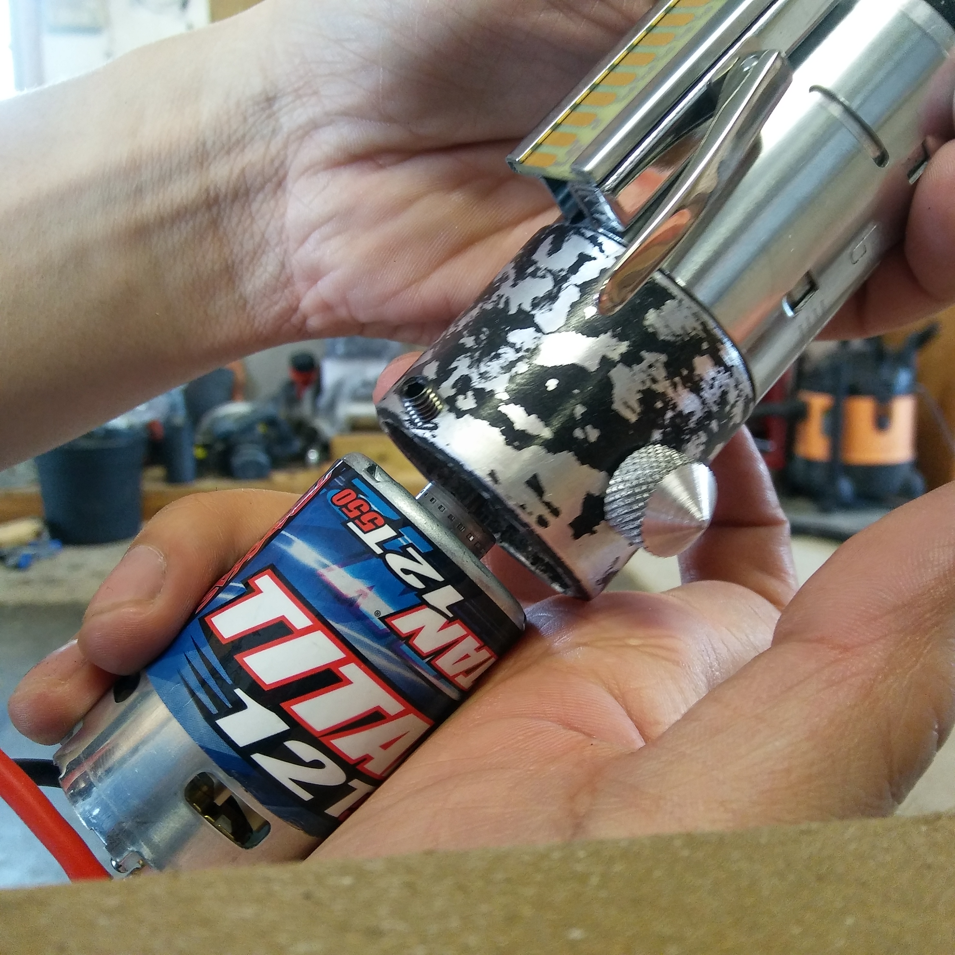

I've been looking for motors for some time now to fit inside both the Graflex (it was needed first for the production) and the fencing stunt. I figured it had to have been an RC motor of some sort, readily available at the time, fit inside the Graflex and had enough torque to spin the fencing dowl/rod assembly. I figured that whatever method they settled on had to have been carried over the stunt hilts, as well: high torque, compact fit, and something readily available.
I settled on it having to be a truck motor and went to my local hobby store, actually owned and managed by die-hard enthusiasts, and the first thing I told them when they asked "What are you looking for?" was, "An RC motor, something readily available in the 70's, with high torque, high speed, and roughly the size of a D battery." Without missing a beat, one of the proprietors asked if I was working on an old Tamiya RC truck. I quietly considered my suspicions validated before I replied, "Yes."
They pointed me to this and said the only difference between this motor and the one then would've been the lack of the sticker. It fits the Graflex like a dream (give it a few hidden screws to mount the motor inside) and I could see just how easily it would've been to whip up the Luke ANH stunt. It's a 12T 550 brushed RC truck motor, if anyone is thinking about making an ANH stunt.
My test cast was machined before I had a motor in hand and I was really surprised just how close I got to getting a perfect fit. The motor, I think, could take a few love taps to get it inside the hilt chamber but if I just shave off something like a quarter of a millimeter from the inside, the motor would be able to slide in and out. Put two or four grub screws under the clamp to mount the motor and I'm positive this would be bang on to the real prop.
Since I'm going with "like original" parts, I tried to see if this would work on my Starkiller V2. It was a resounding no. Although, I did spot modern, brushless equivalents that were smaller and those might put out enough power to spin the rod assembly, should anybody be so willing to try making a V2 fencing stunt.

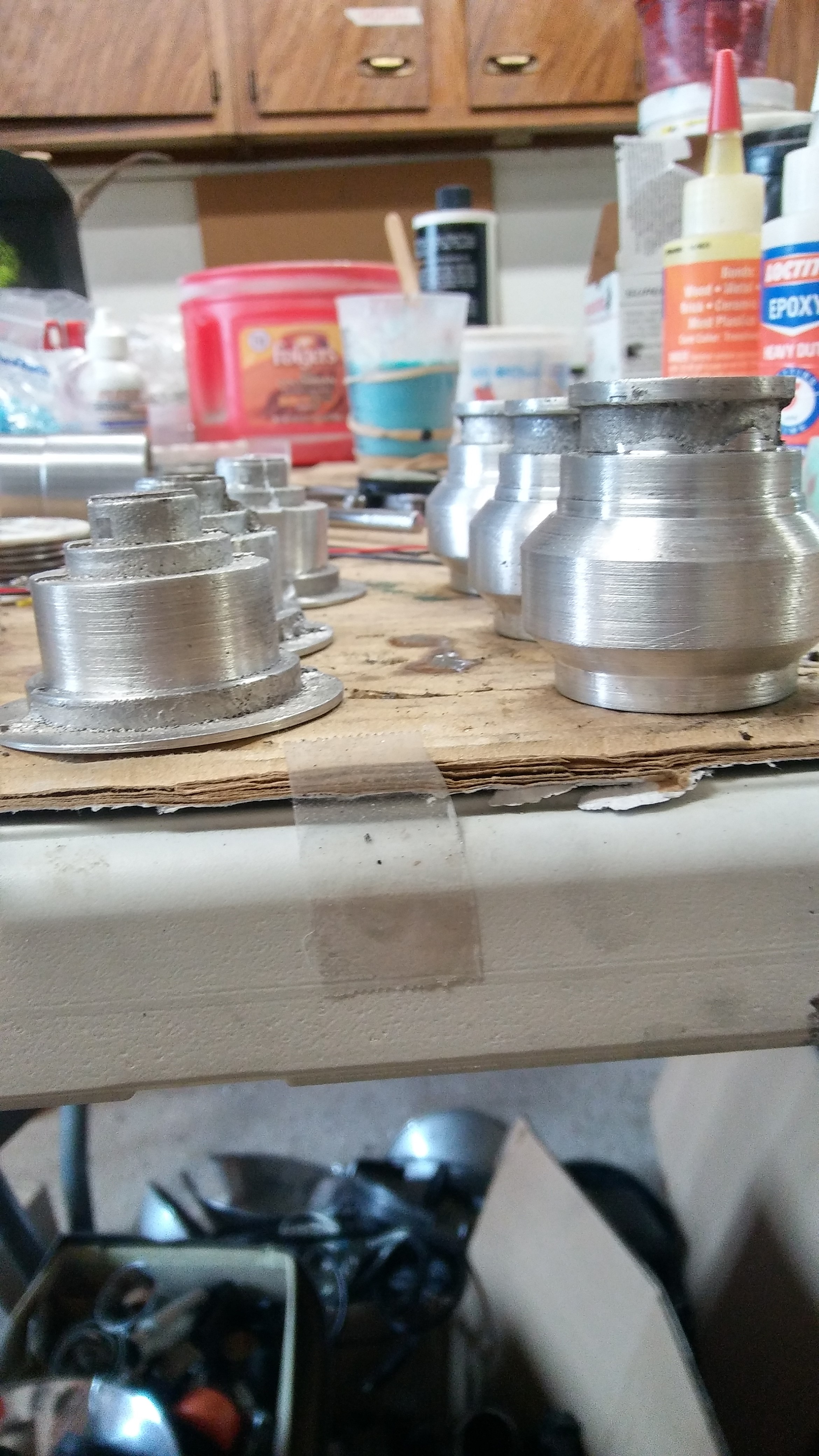

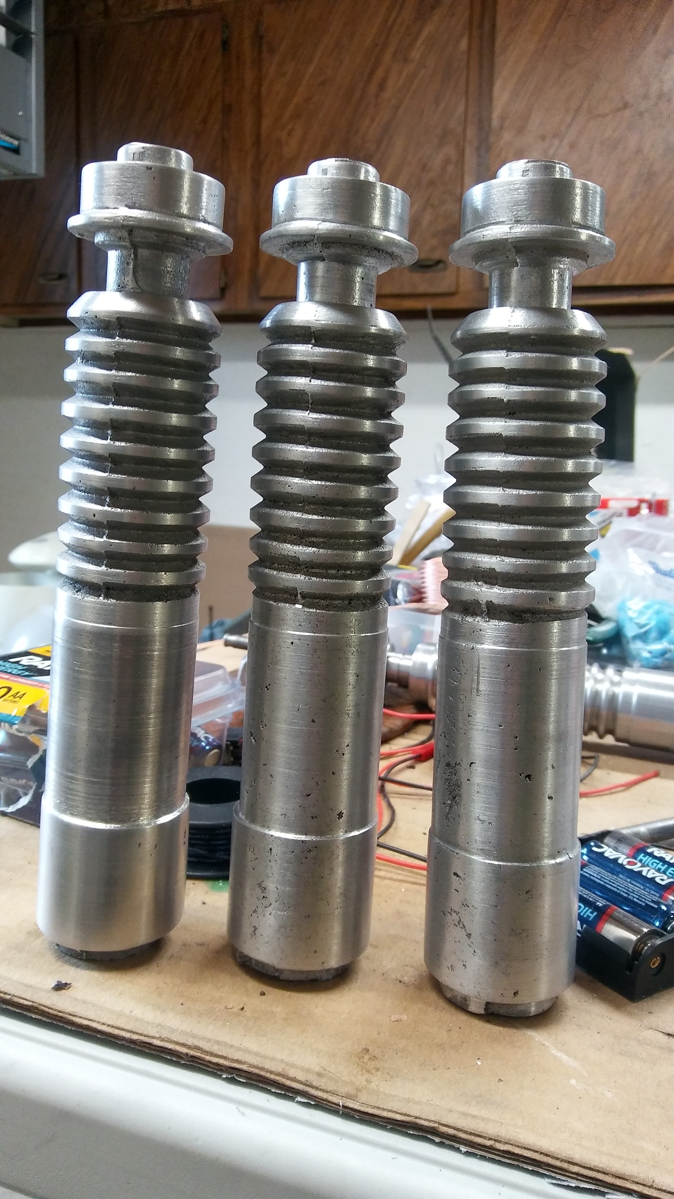

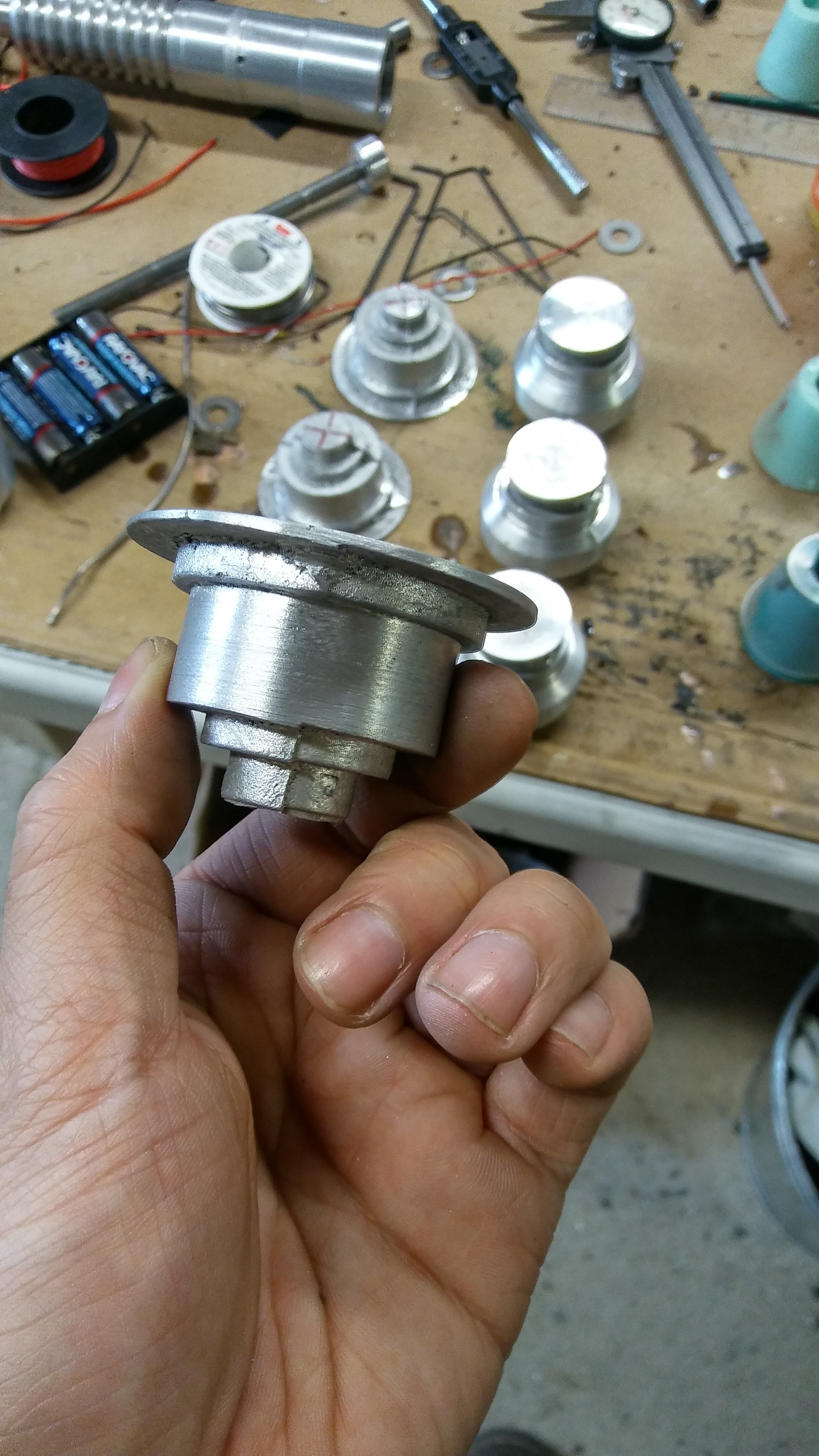

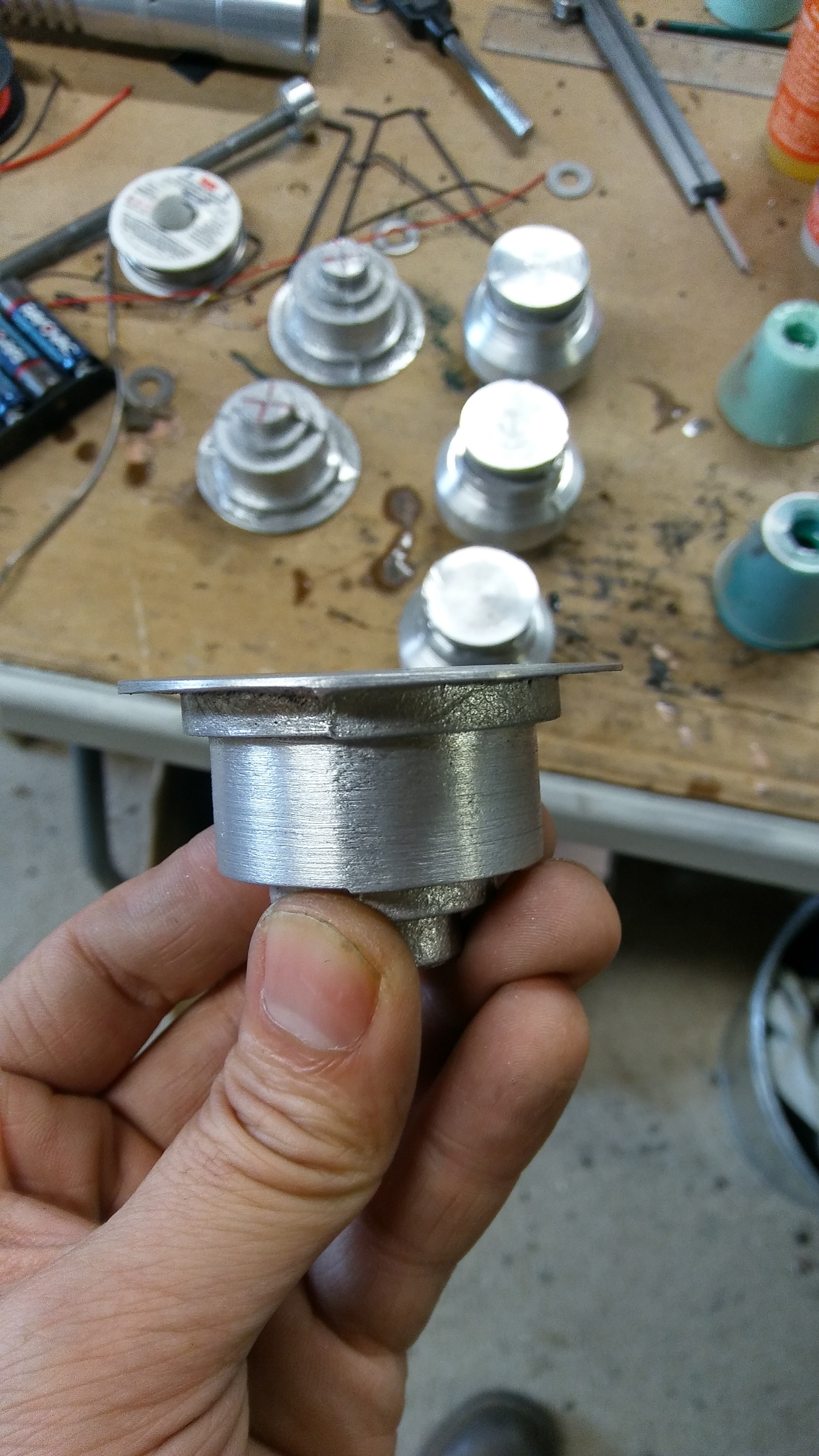

All of February was spent making repairs to my lathe and much of March has been me working on getting these machined hilts out. In fact, I've done--- and redone it--- twice now. I'm still unhappy with the porosity and some shrinkage of the metal in some areas when I cast it, so I've invested in a few things that'll help solve the problem (or reduce it). I want you guys to get the best and closest replica of the prop imaginable.
These are the current casts so far...
I'm proud of the level of detail and I've got almost a complete match with the original. It's a one in billions chance of me completely recreating everything that exists on the original, where they're at, but I can recreate the same kind of details.
You can see what I mean about the porosity. Towards the booster section is where it becomes pockmarked heavily.
The emitters and pommels below, I'm most likely keep and move on with. The hilt bodies themselves, I'll likely melt and cast again to cut down porosity and other surface defects.
So I'm gonna post this across the multiple threads but I wanted to let you know where this is at.
I'm proud of the level of detail and I've got almost a complete match with the original. In a one in billions chance of me completely recreating everything that exists on the original, where they're at, but I can recreate the same kind of details.

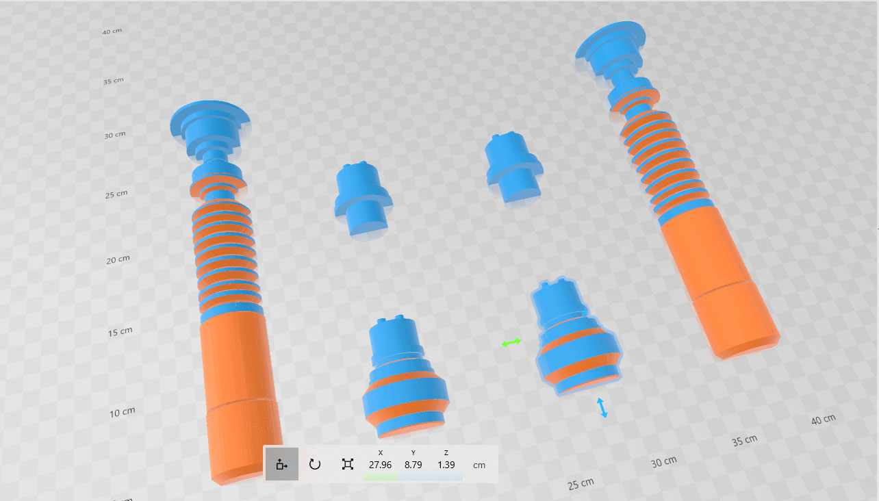

Spent the last couple days and nights re-hauling my wood master model to get it even more accurate. I wasn't liking where the revised model was off and spent way too long fixing it up. My measurements are tighter and, after much fuss, I got the taper of the clamp/body section spot-on.
I'm also trying a modular thing for the pommel, so I can make the pommel and the "pommel knub" that existing copies have today.
So I guess a big update to come with this new and revised v3 V2/V3 model. Time to see if my arms and legs will be enough for this on Shapeways.

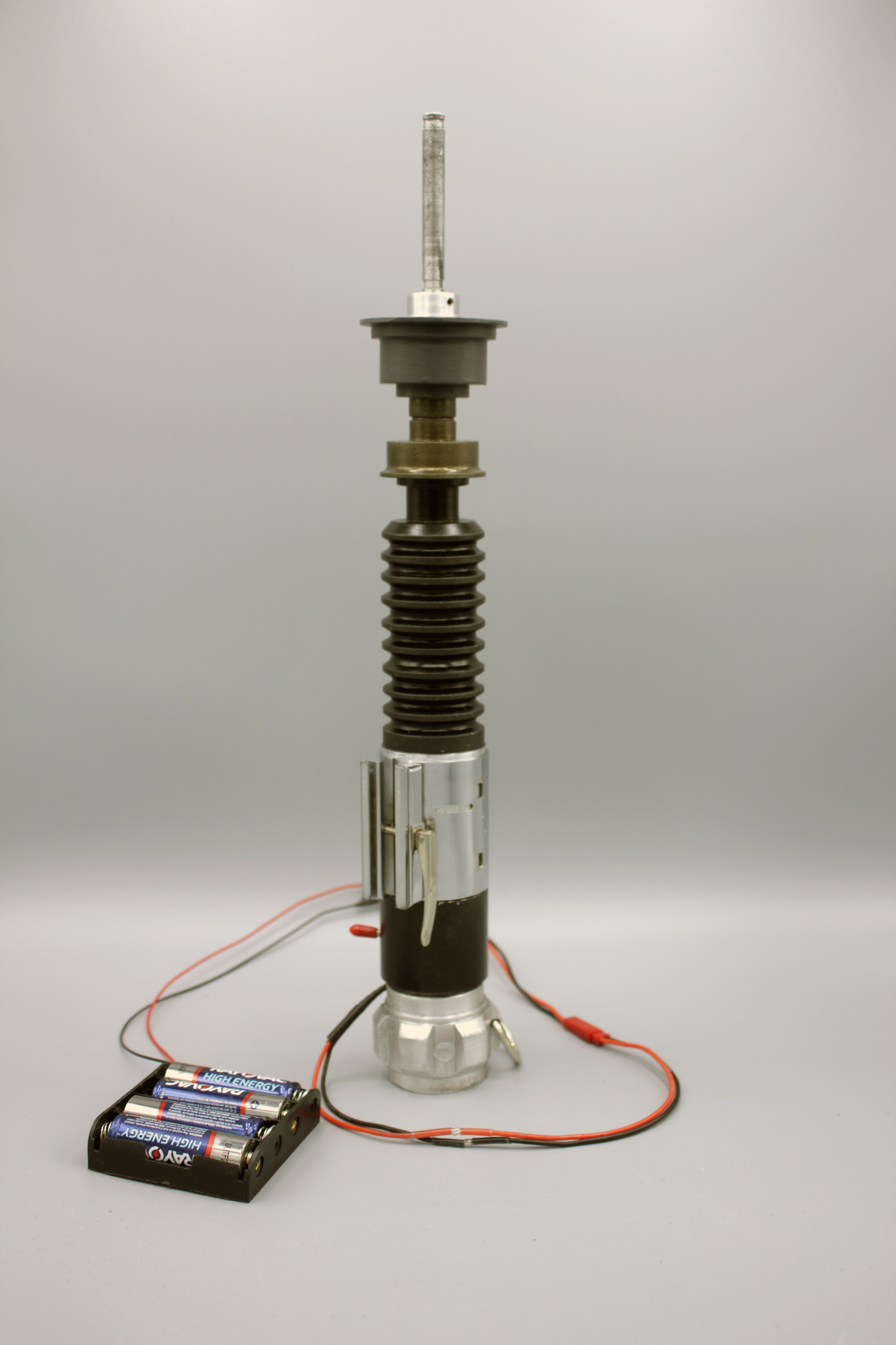

Here, aping what Halliwax called his, is my "Legacy" hilt. A whole heaping lot shorter than "As-production-built ANH Ben Kenobi Stunt/SpFX hilt."

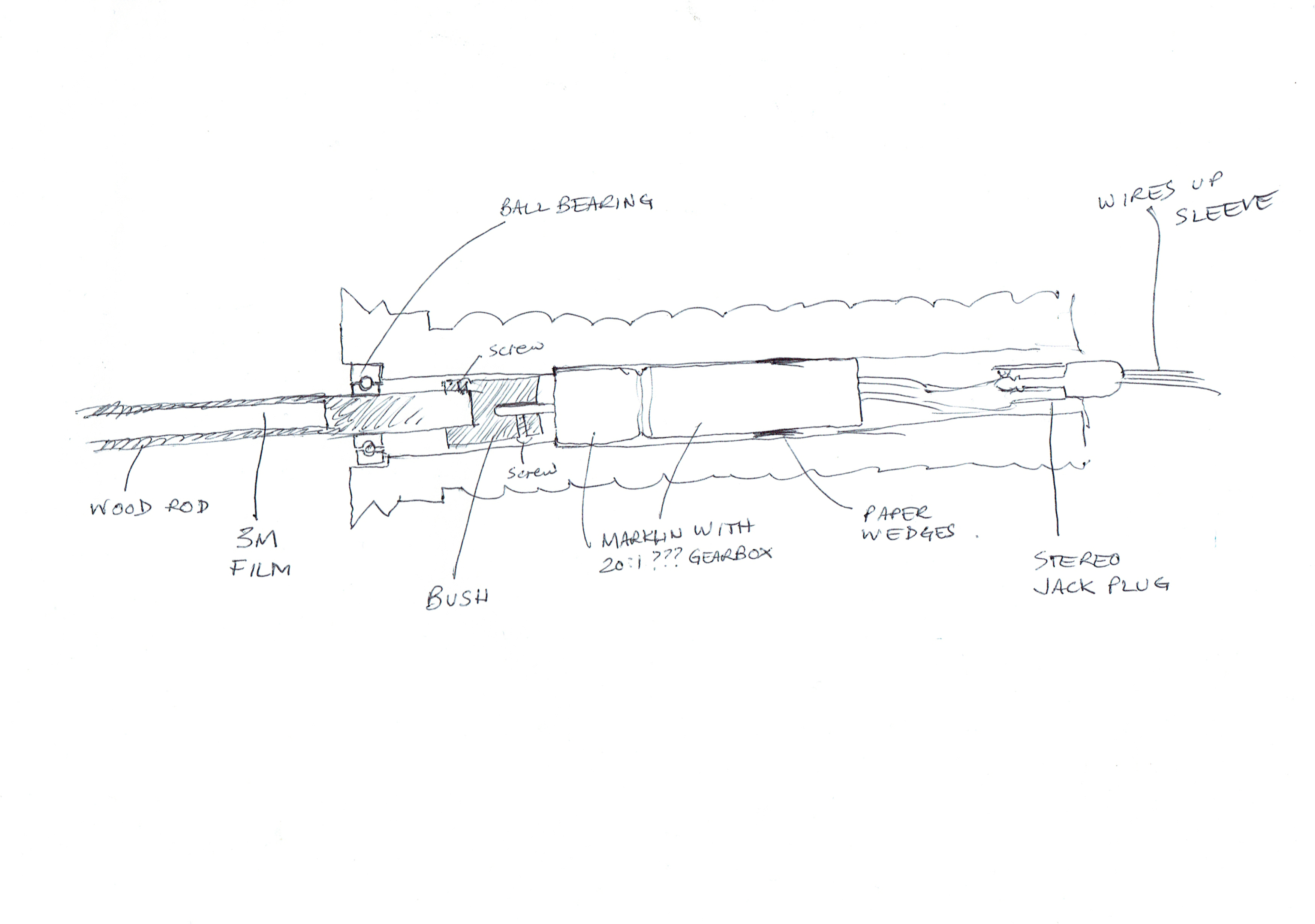

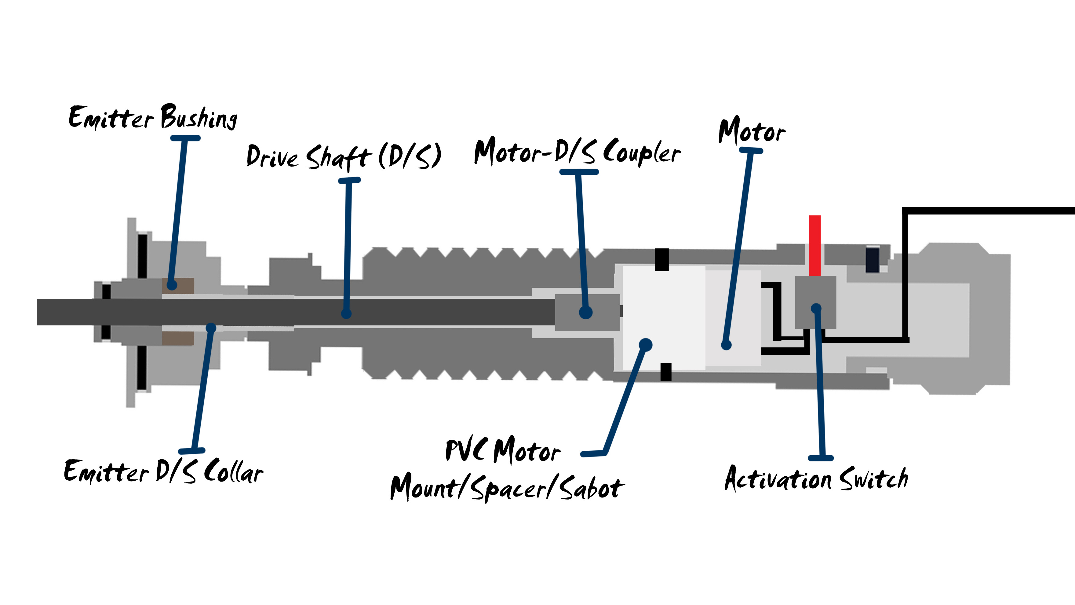

  • Internal layout based off of Jon Bunker's schematics and known first-hand accounts/observations of the V2
  • Cast Aluminium
  • 4 piece design: emitter, nipple, hilt/body, and pommel
  • Single 6v motor
  • Red micro flip switch
  • Modern red connectors instead of the white, boxier versions to save space in the inside
  • Painted in colors to match as close as I could get to the BTS on-set photos
    • Satin Black
    • Dark Gray
    • Metallic Gold+Dark Brown mix
(Rough schematic by Jon Bunker, provided by vadermania)
The cross-section of my Stunt hilt

I've gone over before how I think the emitter is most definitely a separate piece---why, I can't say--- but the recent discussions about it being static isn't completely ruled out. In the video, I tweak fastening the emitter to the nipple a few times to demonstrate, but don't know how clear it is for others, but when the rig is fully assembled, tightening the emitter to the nipple creates more tension on the d/s which causes the motor to work harder to spin, potentially wearing it out sooner. The strain also makes it churn a bit louder. Whether it's the latter or the former, or possibly just one of the emitter grub screw threads tore, with a looser emitter there's less stress on the motor and runs just a bit quieter (and maybe just a bit faster) than it would normally spin if the emitter was fully tensioned on the nipple. I can't help but think one of these scenarios lead to there being a static, or static-looking emitter in the film. Whether it was purposeful or an eventual result of prolonged usage, I can't say but evidence is now strong for both ideas, in my mind.
(A quick note, one of my emitter grubs' threads tore out, so I'm sure tensioning from one of them is having an affect on the d/s, but before it tore, I encountered the same scenario with two fully tensioned grub screws.)
It should also be mentioned that if the original is anything at all built like mine, a loose/static emitter will still spin, as demonstrated in my video. When it's caught by the nipple, it will partly spin and stop, or stutter slowly around it. It really depends on how it's held in cases like that because the length of the fencing pole/rod will slightly shift the d/s enough to affect its spin. I think had my d/s been longer, the effect would be more pronounced.
After doing this, I have come to conclusion that the bushing in the emitter in Jon Bunker's schematic, while maybe necessary for the Graflex stunt, may be unnecessary for the Kenobi stunt. With the original wood buck sporting a separate emitter/neck area, I'm sure that's how they made extra emitter pieces and most likely how the V2 got it; I did without it because having something stop at the corner of the neck and windvane, and hollowed out for a collar, I worried that it would be a stress point liable to warping if enough force was applied to it whether it be by striking or being dropped (why I opted for an extended steel collar). The pressure-fitted bushing and the steel collar I opted for only really serve as a means to hold the emitter to the rest of the hilt, and help to center the d/s. Had I gone the way the original most likely had gone, I wonder if I could have done without it completely. I won't be making another just to test it but it is a thought.
I said I don't like duplicates, but after having this in hand now, I'm gonna have to go back over what I said before about turning this into a V2; it looks like I'll just have to make another one of these to keep as a V2. I swear, this stuff just never ends!:lol:

I'm going to read over this again tomorrow, I'm surprised at the amount of kick it has. In this model, does the emitter kinda stay put without the nipple because of the pressure around the bearing and neck sleeve?
Super, super impressed here. Amazing work!
Thanks for the kind words; unfortunately, if I keep tinkering, it'll never get around to being done. Ya gotta draw a line sometime and gotta get a move on it.
...I'm going to read over this again tomorrow, I'm surprised at the amount of kick it has. In this model, does the emitter kinda stay put without the nipple because of the pressure around the bearing and neck sleeve?
There's a slight pressure but not enough to hold it in if you're swinging it around. It'll just fly off. The nipple most definitely helps lock it place.
I have a bad habit of machining things with a slightly looser tolerance. If the bushing in the emitter would have a purpose, it would be to help secure the emitter and have it spin, had the steel collar pressure fit into the lower neck/windvane. On this piece, I have paper shims to help wedge it all together. Though I'm kinda glad it doesn't. Nothing is straight in this. The square dowel isn't, so it adds a wobble; the steel d/s isn't, which early on had areas catching on the inside of the hilt, which created friction which had problems on the motor; it's the whole reason I can't accept that the stunt hilt was machined as a single static piece from a cast source. The cast is too wonky.
You'd have to do something similar to how I had to handle it: find center of the neck, bore in; flip around, find center of the booster/lower half of the body, bore in; have the two channels meet and have them have enough clearance for the d/s to spin freely. Do the same for the emitter. It's the only method I've come up with to make sure something that's as off-center as the raw cast be centered as possible to have the internals work smoothly.
