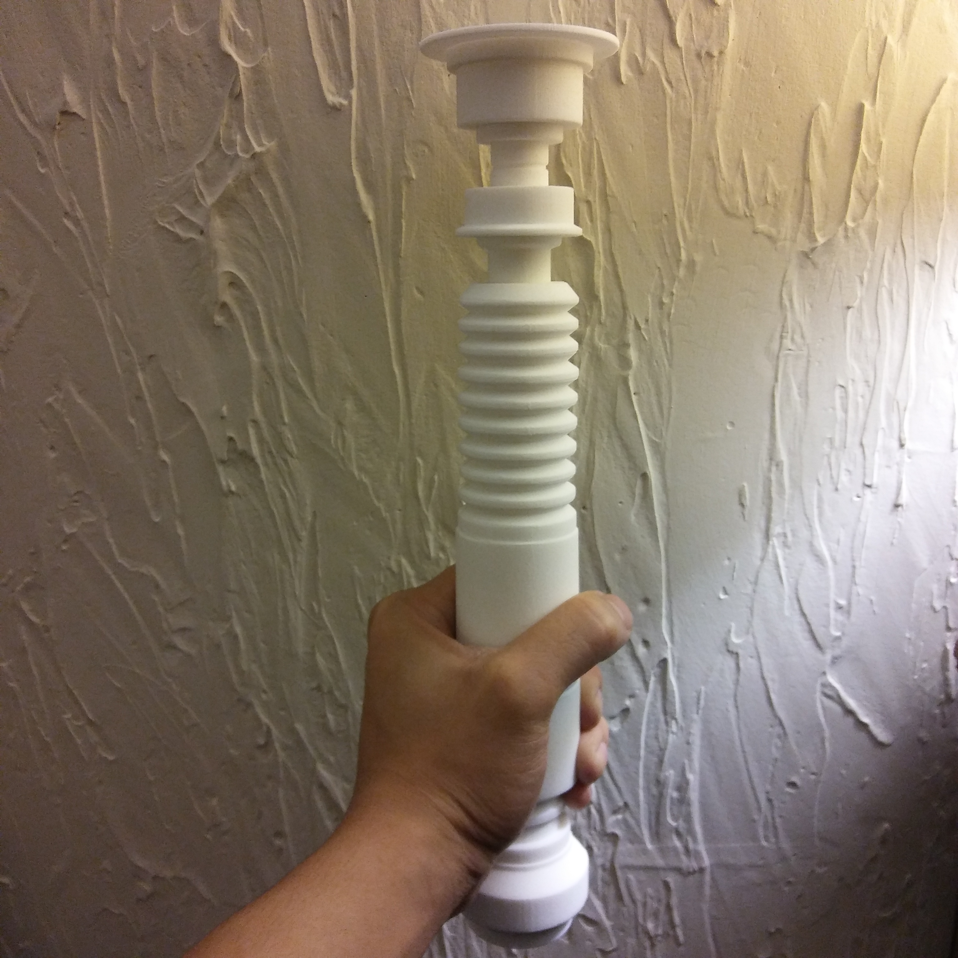

New buck arrived, quite literally, just now and I couldn't be more pleased! I re-scaled my final model and retooled some elements with it, and it's so much more accurate than before. I dare say, barring my alterations to the spacing between the pommel and booster, this thing is now spot on to the original wood buck used---At most, within a 2% margin of error--- and this time round, the two halves align perfectly. Also, from the printing, it even has wood grain!
Just having this in hand, I'm gaining all new insights on not just the V2, but the V3, the eBay raw cast, and most importantly, the construction of the subsequent stunts based on the dimensions of all three. As much as I hate it, I may have to introduce a V3 into my collection just for reference sake. I'm even more convinced now that the V3's main body wasn't even machined. Perhaps for the clamp/booster section just to get the clamp to secure more adequately, but the rest must've been just chucked on the lathe and slapped with sandpaper. It just has too many similar, near perfect details to the raw cast.
I really can't be any more excited about this piece. I'll be prepping it today for casting on Sunday (weather permitting) and proceed from there. I'll be melting down my last prototype for the fifth time and, hopefully, get it right this time round.

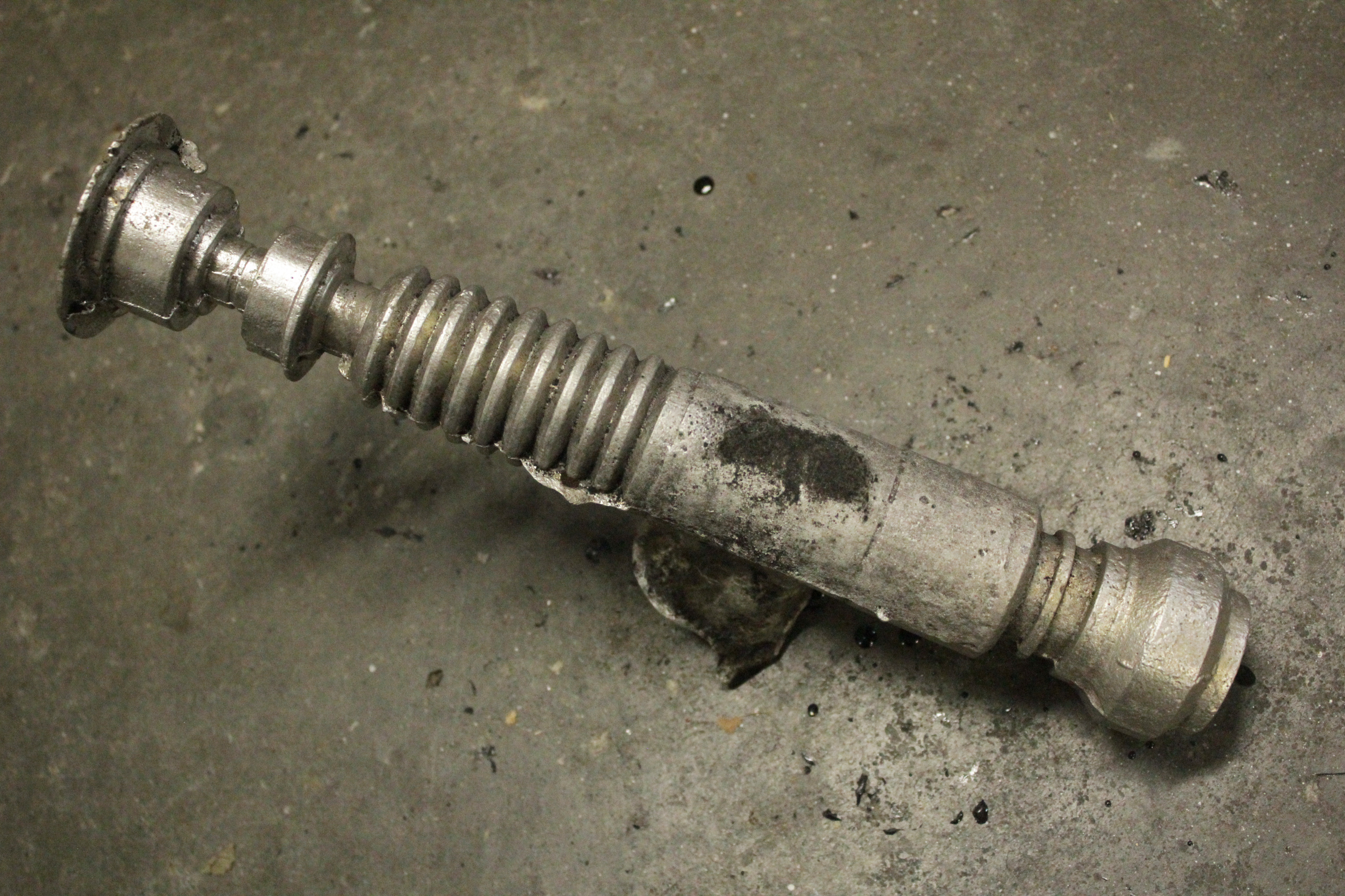

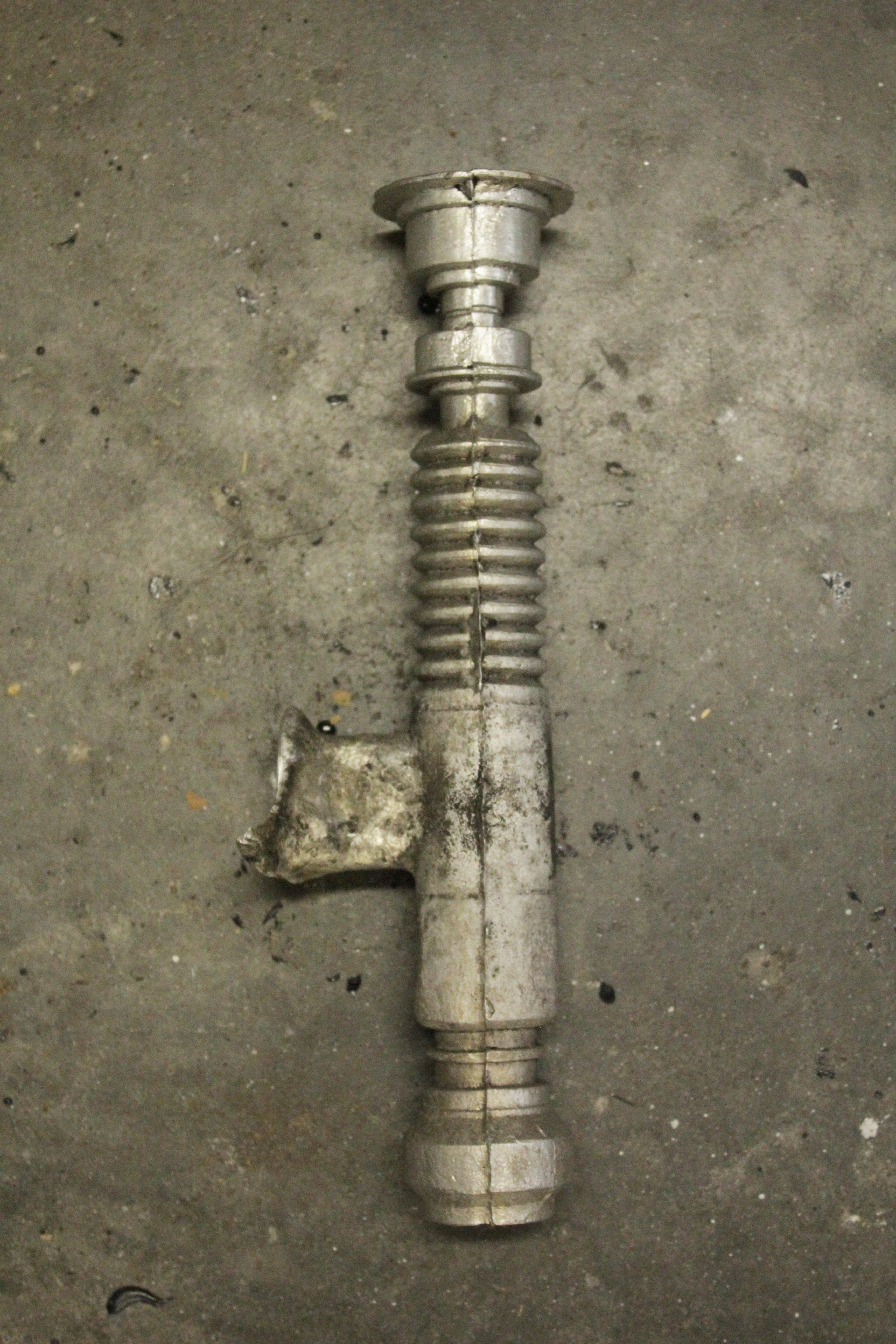

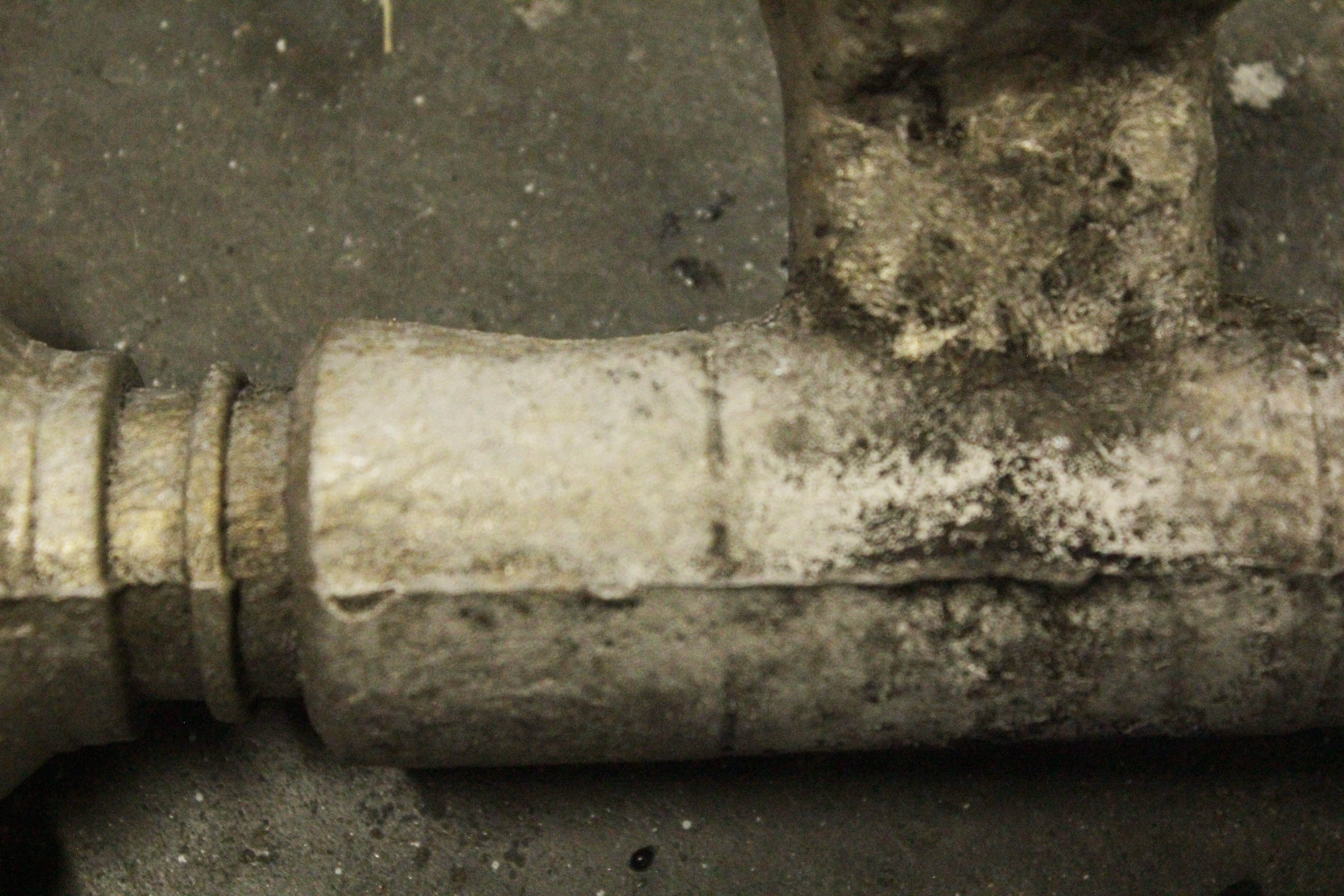

I pulled this cast a day ago and by far it is the best, most pristine of all my tests. It is near-perfect! I'm still working things out and would go with this for further machining but the dread enemy, air pockets, continues to prey on my OCD. I'm not just wanting to get a cast to fully replicate the method of the finished V2/V3, but I want to replicate getting the raw casts as well.
After this experience, I'm beginning to think that the pour spout going the length of the seam (meaning the original box mold would be sat upright instead of horizontally like I have) was by choice. Would the seam line be enough to let air out so that the cavity fills in completely, I wonder? I previously added the air traps where the dips were occurring to remedy them, but it just wasn't...right. The eBay casts didn't have them and I'm sure the cast vadermania has didn't have them either.
I'm going to alter my box mold and cast yet another piece as the month wraps up and marches into the new year. Hopefully this will yield the results I'm after and I can get a-goin' on the run!

One year on and I'm still fighting with this thing! o_O I've done casts since my last posting but none to the standard I'm looking for. And pockets/partial fills are still plaguing me and I'm having a hell of a time trying to fix them. Whether it be heating the liquid alu longer or pouring slower/faster, this process is very touch-and-go and there's always some quirk in each one that makes me want to do it all over again. I really wish there were more people who still bothered with this method locally that I can go and seek advice and help from. It'd be a lot quicker learning having someone there yelling when I'm doing something wrong, instead of me figuring out as I go.
One positive though (literally), is that after all my doings, I'm fairly apt at making clean sand molds now. I can get clean sharp details that stay and hold their shape. Before, I'd always have chipping and edge damage in the positive and having to fix the casts later with rasps. I may switch to building a more expensive, but longer lasting, forge after my current reinforced plaster set-up fails. It'll take more time and finances to invest in making but I'll be able to make casts quicker and more efficiently once I do. Once I get that down, I'll post my findings and some more photos, and then I'll start thinking about starting up on my run.
