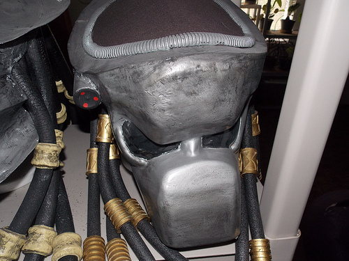

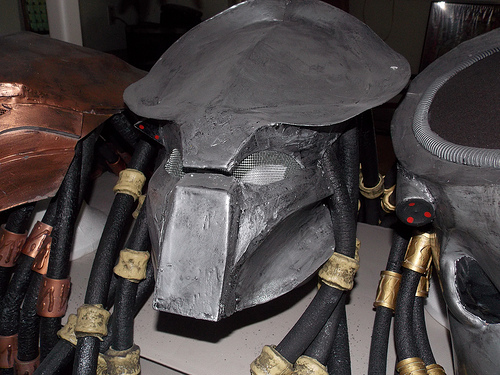

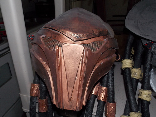

There are two basic ways that most people make their Pred dreadlocks. The first is to cast them in foam latex. That is pricey and takes some skill. The other way, which takes less skill and is cheaper, is to use "backer rod", also called "caulking tube", which is lengths of foam-rubber rope that are used to seal the cracks in walls before plastering or spackling over them. You can find backer rod online, or in most hardware depots. When I use it, I cut a long taper into each end; some people use hot water to melt them into a tapering end. Some people coat their backer rod dreads with Plastidip; some don't. Some people use the same size backer rod on all their dreads; some make the dreads at the sides of the mask thinner and shorter, and the ones at the back of the mask longer and fatter.
For the rings that slide up onto the dreadlocks (known as "dread beads") I have cast my own from resin, made them from PVC pipe or copper plumbing connectors, and cut them from a Halloween "skull/spine beer tube".

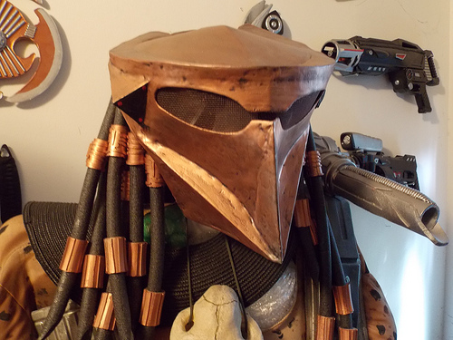

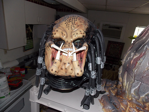

Photos of my Pred masks, to make all this clearer:
Pred mask made from posterboard, with dreadlocks made from backer rod and cast-resin dread rings.
Pred mask made from posterboard and foamie sheet, with dreadlocks made of thicker backer rod, and dread beads made from PVC pipe couplings decorated with three-dimensional fabric paint.
Pred mask made from a modified pepakura coated with fiberglass resin, with dreadlocks made from thinner backer rod, and dread beads made from segments of a Halloween "skull/spine" beer funnel.
Pred mask made from the plastic "blister pack" of a Halloween demon mask, with dreadlocks made from thin backer rod and cast-resin dread beads.
Pred face mask made from a modified Rubies Halloween mask--I added dreadlocks made from backer rod and dread beads from cast resin, and also added inner teeth made from a Halloween "werewolf" set and mandible fangs cast in resin.

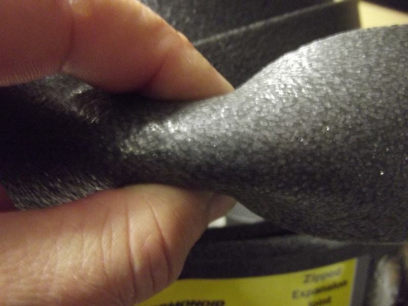

When you squeeze it, the surface appearance changes quite a bit and looks quite neat. I think this with some PVC bits will look pretty good. What I discovered tonight was superglue won't stick it together, so I will have find that hot glue gun now and give that a go.
And here is the Pred Bio after the Plasti-Dip has dried. I was told to give it a light coat first, then after 20min or so, give it a heavy coat and the product will build up. Whilst it was wet, it certainly did that to the point where the little ridges on the surface of the foam were almost gone. Yet, it seems it just soaked into the foam. I think I would have been better off using the PVA glue method documented my X-Robots a while black. Not sure if I should re-do the surface with the PVA and then get a 2nd can just for the final finish.

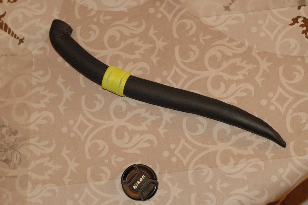

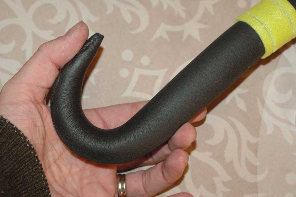

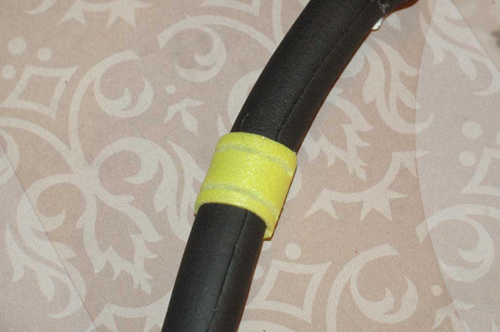

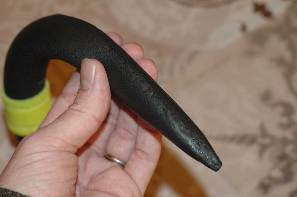

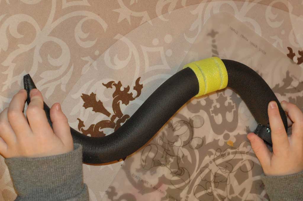

A quick easy test from a bit of foam tube I had left in my shed, and an old remaining yellow piece of foam mat (that I've thinned down to 2 or 3mm thick) :
It looks good on the picture, and is pretty flexible, but because of its lightness it still moves like a stick. :cry
