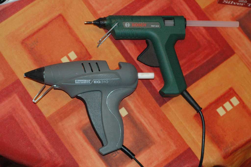

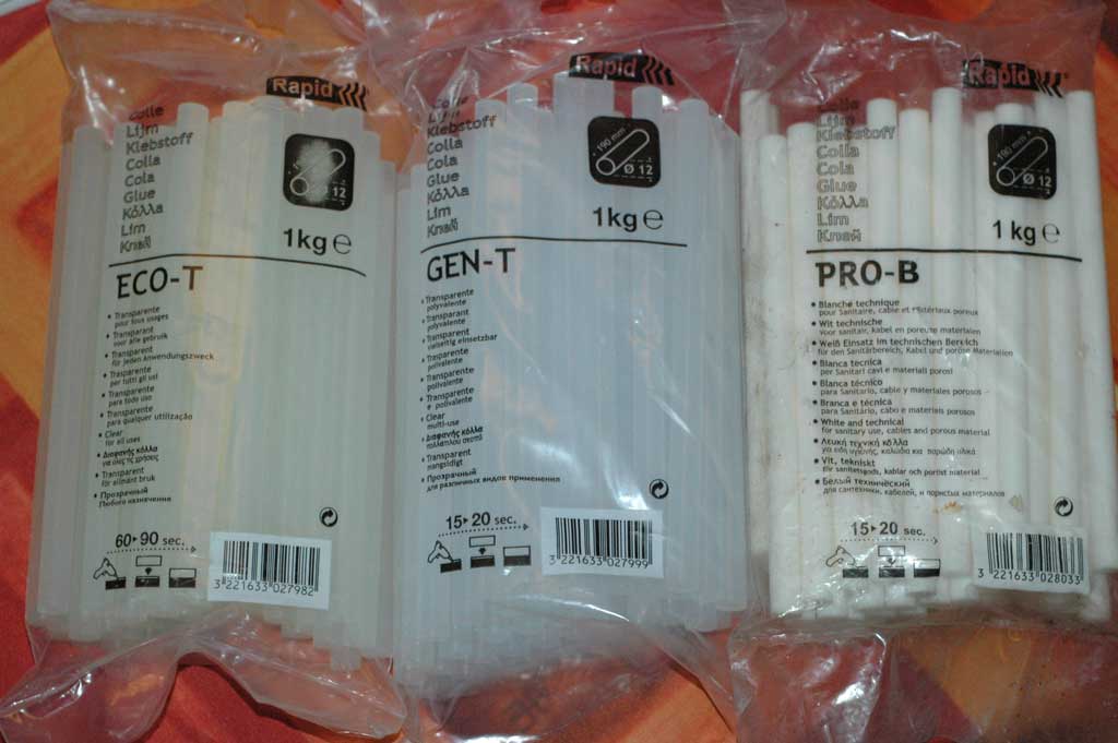

People often don't care about it, but there are several glue types and several glue gun types too.
Here, three common glue types, from left to right :
- slow glue. A long cooling delay allows to move your foam pieces to match your needs until glue freeze,
- quick glue, leaves you something around ten seconds before it turns hard,
- rigid glue, once cold it's hard as pvc and can't be bent.
About guns, the one from the video mainly for precision work, and his high-speed brother for massive gluing :

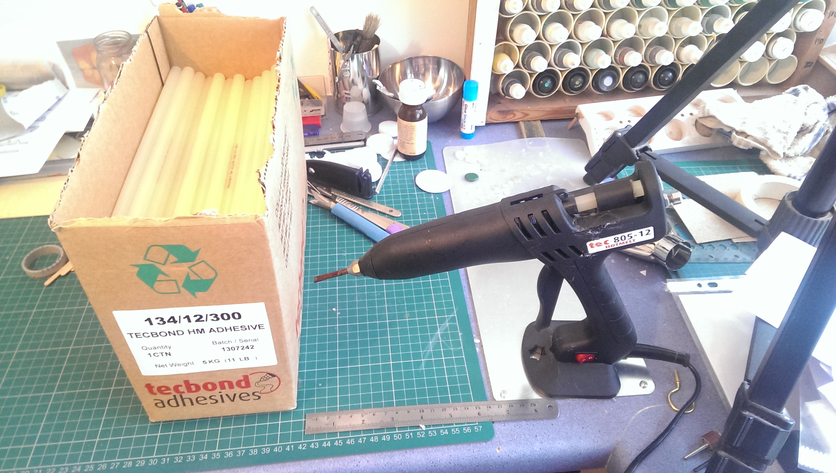

this is the glue and gun I use, got the from Glue Guns direct in the UK. They have a selection of nozzles, got the flat one and changed it for the standard one, the glue is fast setting

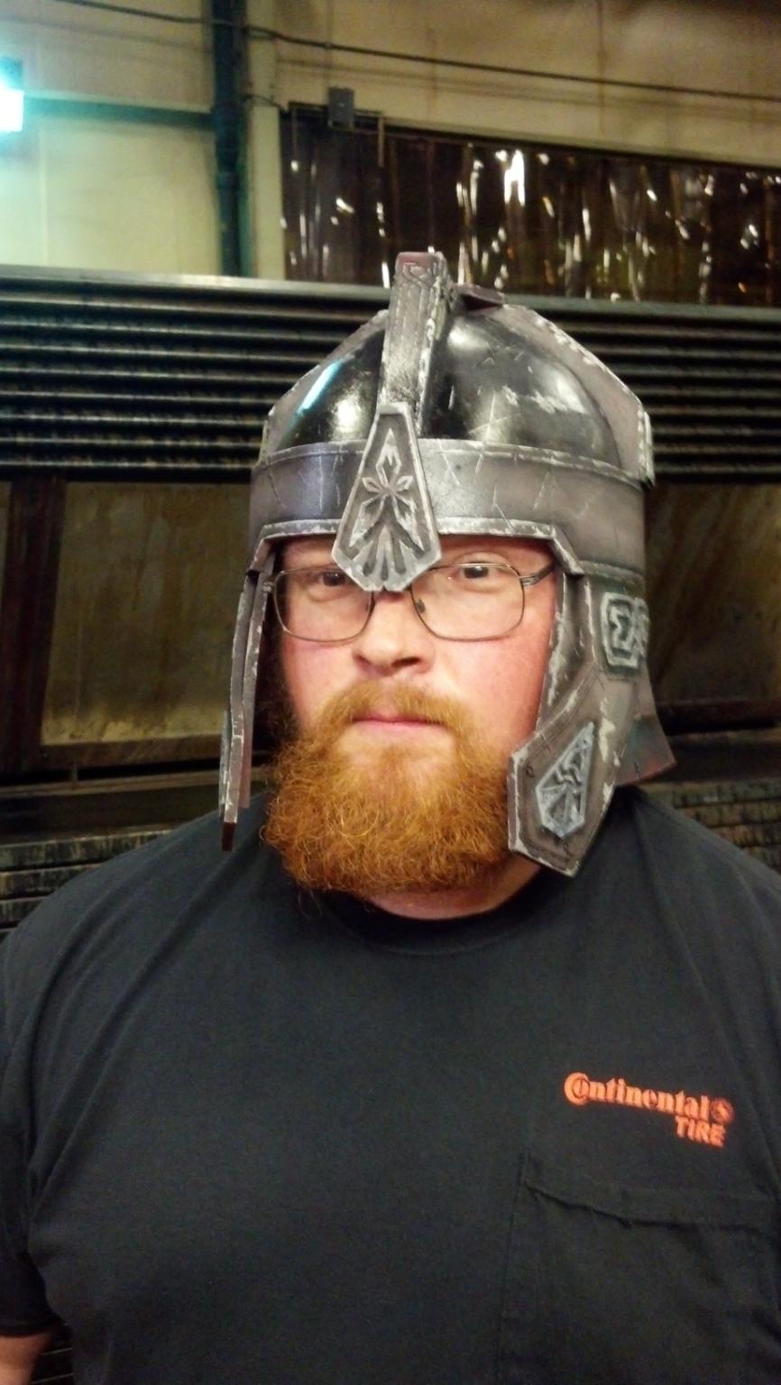

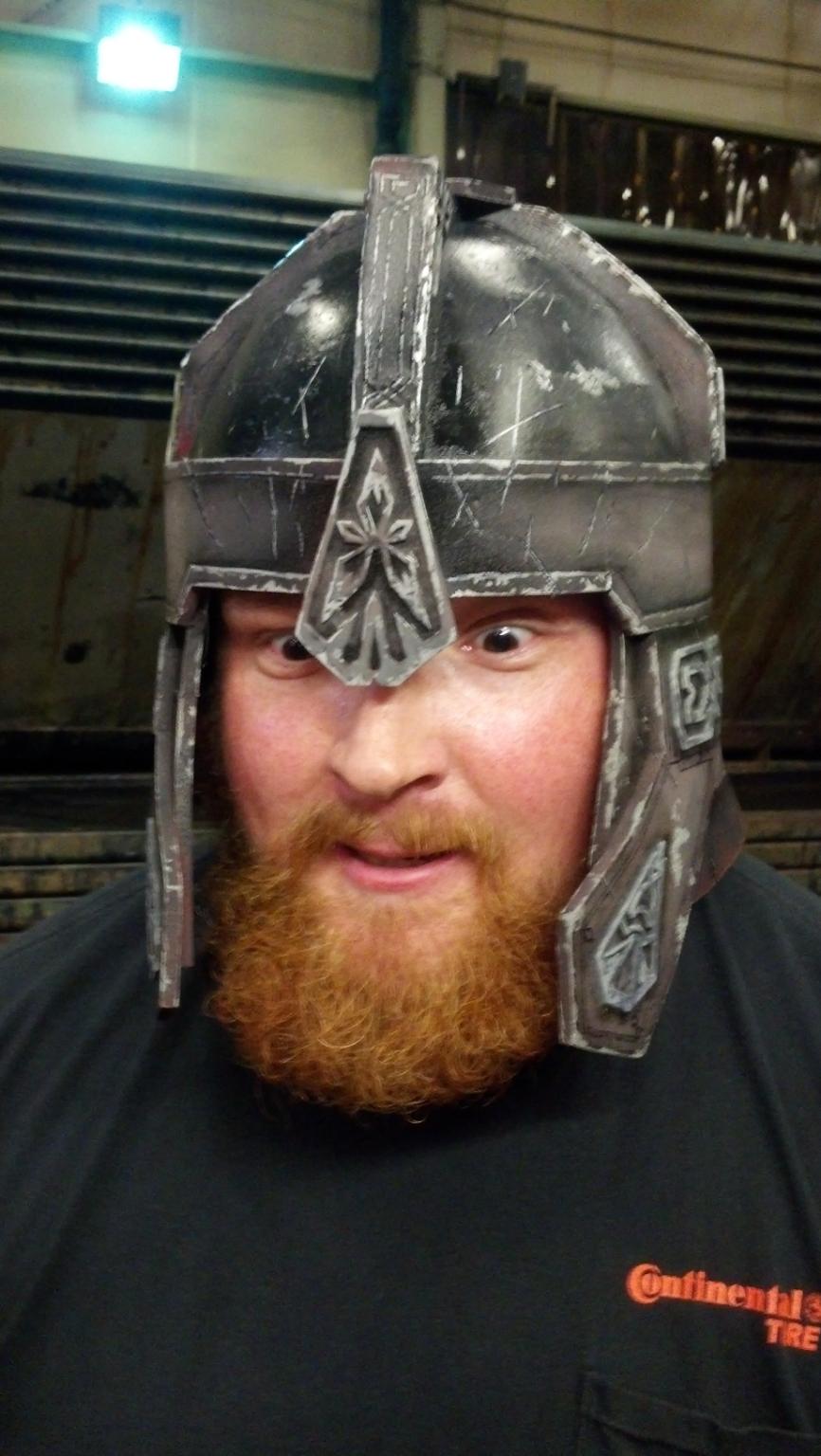

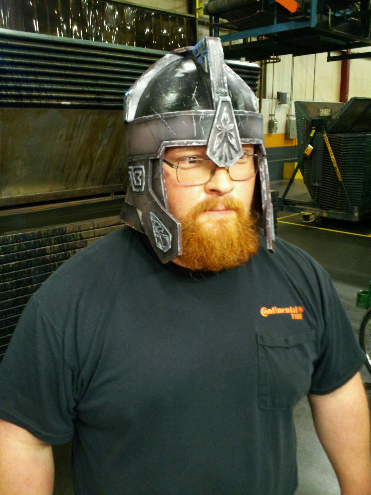

Anyway, not happy with the cheeks, so re-did them tonight using the original template as a guide and then customized it. I used that technique seen on the 2+hour video where he cuts groves out to help the foam bend and hold its shape. Very cool it worked a treat tonight. In my last "build up" I would glue a flat piece of foam on the parts, then grind it into shape. The problem with this method is you loose the finish on the surface and this way I got to keep that.
The new cheeks really fill out the face.
Re: FOAM speed building files ►Stormtrooper◄ in progress.
Excellent ! He could have been playing among the extras in the Mines of Moria ^^
