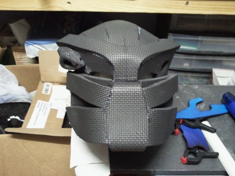

Started with new cutouts by pulling apart the compressed foam version.

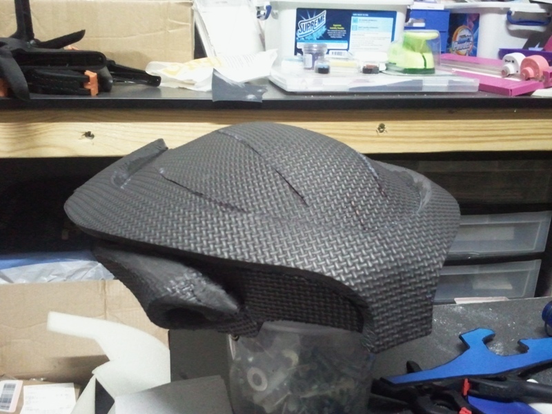

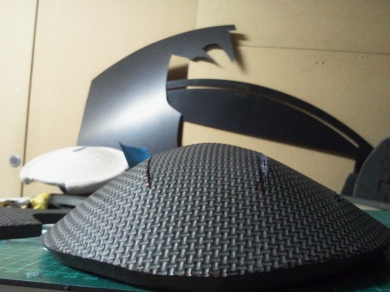

To get the dome round, I just folded the centre strip almost in half first, then in small patches, glued the sides on. My last attempt had a flat top which required a heap of filling, building up and sanding. And it never actually went round like this is.

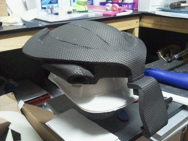

I added the brim and laser. The laser was made up prior and the back piece is actually a mirror of the left hand side. You can see where I sanded the laser to make it more rounded.

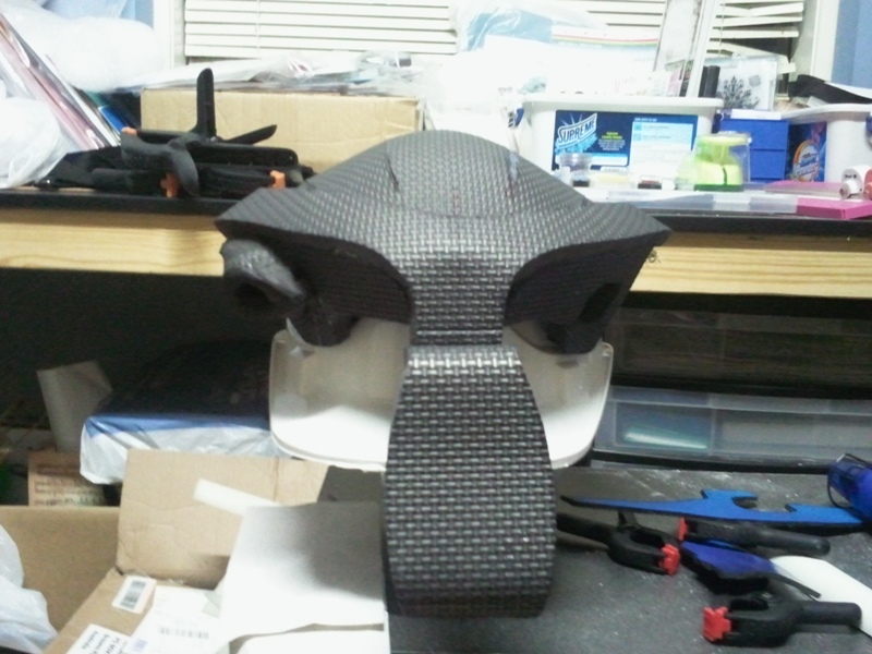

On goes the snout.
And this is when it all went south again.
Once again the cheeks were not doing what they should, so I got creative and did a custom build up. I will have an other go at the cheeks on the template tonight. If it does not work out, I will keep on this tonight and just sand them into shape.

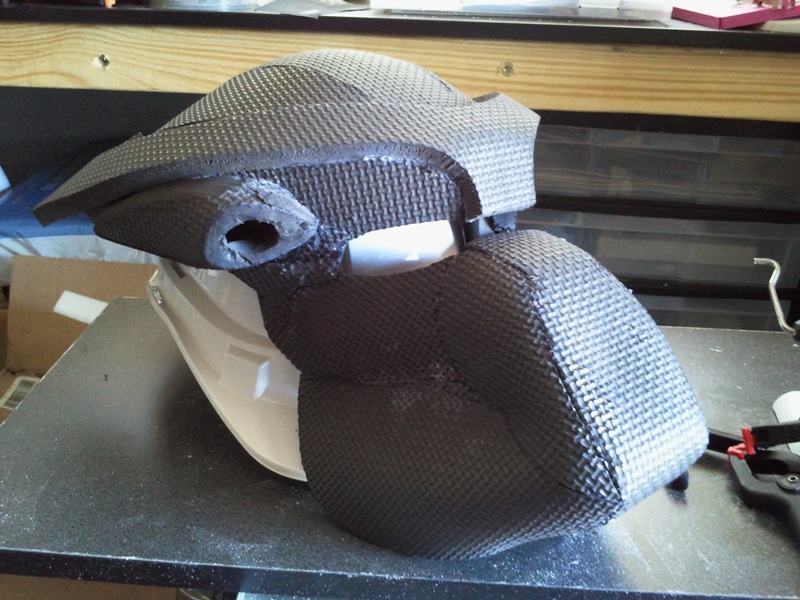

Last night I completely re-built the muzzle on the Pred Bio.
Total build time was 10 hours over 2 nights. Does that count as a speed build?

Well it's not a race ;)
Seems you got it this time ^^ Now just add the eyebrows piece and it will be perfect.

Thanks JFcustom :) That is big coming from you given you would be one of the foam masters of this site.
Cheeks didn't quite bulge again, but I do think the brow part and few small bits will complete him.
