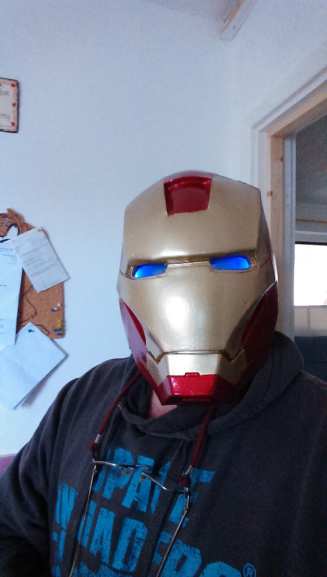

I wore my suit with undersuit etc for the first time last night and thanks to your files and help I won the costume contest I entered!

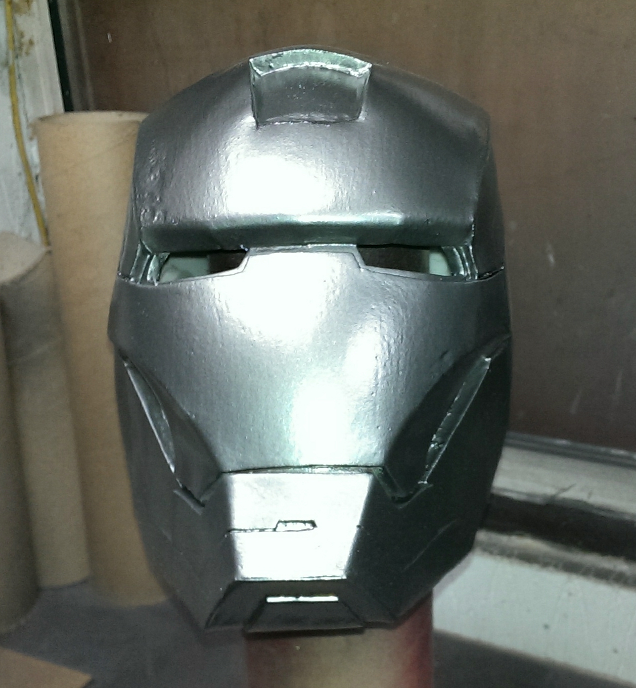

http://i.imgur.com/amjuee8.jpg

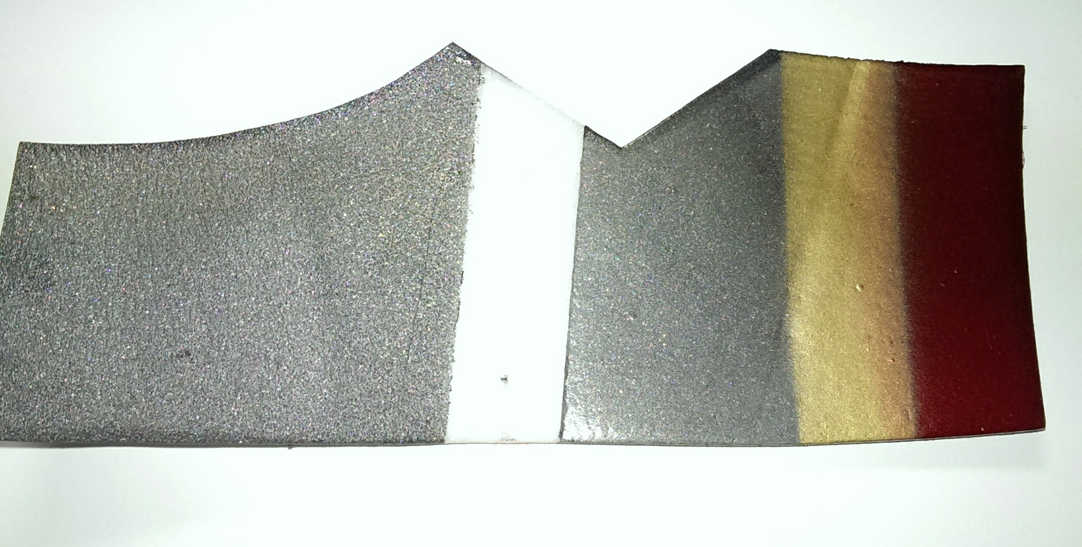

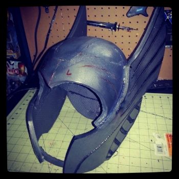

Kirk0; I seal my foam (LD45) with this:
liquid car wraps/
it comes in multiple colors, I'm using Anthracite (Metallic) as a base, they also have a clear gloss, I tested both with and without PVA and the adhesion is superb, and they are really helpful and keen to see any armour builds using their products
here's a pic of my helmet and also the test piece I did, the left side of which has no pva on it:

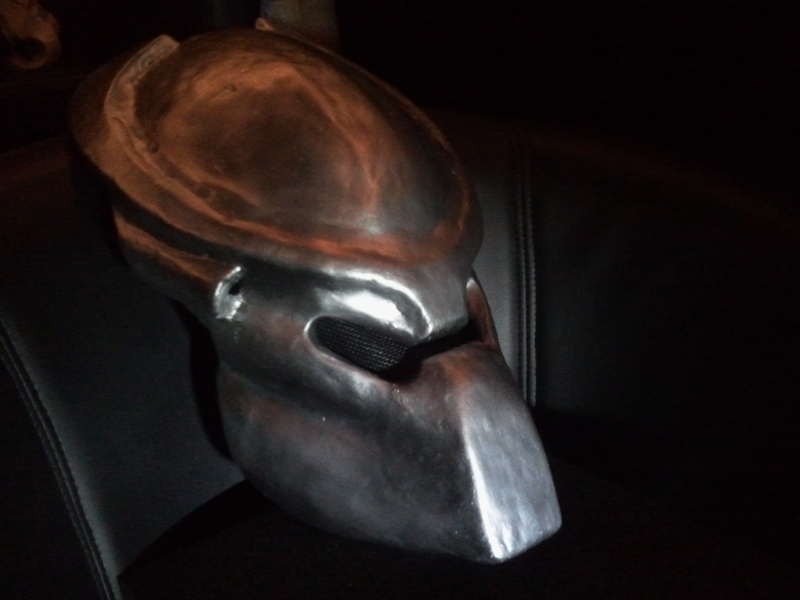

So after 4 weeks and a MASSIVE THANKS to JFCustom, I now have a Pred Bio.
Considering how rough I was when I hacked the foam, it turned out OK. I sealed the foam using ABS Sludge (ABS melted in acetone), sanded and painted.
liquid car wraps/
View attachment 248309View attachment 248310View attachment 248311View attachment 248312
Thanks, that looks good, I did actually look at this on ebay yesterday when looking at various different paints.
I'm not having any issues with the paint adhering to foam but the paint cracking when the foam is flexed is my problem, I need a paint which will not crack as easy when the foam flexes/stretches have you tested how flexible the paint is?

Kirk0:
The Liquid car wrap is rubber based so it's extremelly flexible, I've only used it as an undercoat, but it has helped, I've had some creases but no cracks as yet
oh and it works out cheaper buying the tins than the spray cans, you only need an HVLP sprayer (for fences) and you use so little
they also have a facebook page and are really helpful
I recognise that bus stop!! How did it go at The Barge?!?
I'm in the final stages of my Mk IV suit for my birthday next week, painting things and connecting it all together. How did you sort out your boots? And what foam did you use for it?
Have to say it looks pretty good, and can only hope mine looks something like this!
