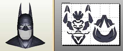

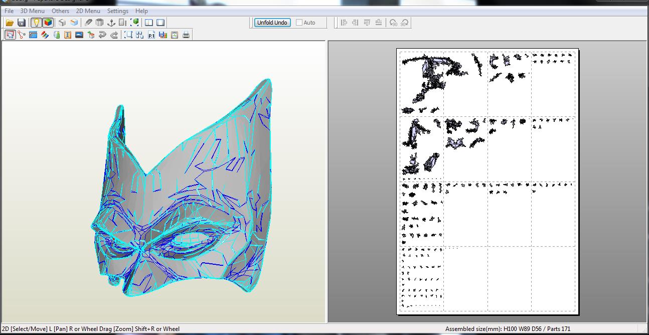

I have a model that I wanted to edit within Pep Designer
The edges and lines. I guess are too complex for unfolding
As you can see in the picture attached, they are complete mass
Is there a way to make the model less complicated within the designer?
I would like to print these out for foam
Look at the picture
In designer, select set edge color (the little box that has three different colored pens in it). From there, you can adjust the slider that determines your polygon definition. 180 degrees will create a fold at every edge of the faces, you can slide that down to about 160 and it should clean up a lot of the extra pieces. AT 160 degrees, the foam can still maintain these 3 dimensional bends that would be impossible with paper.

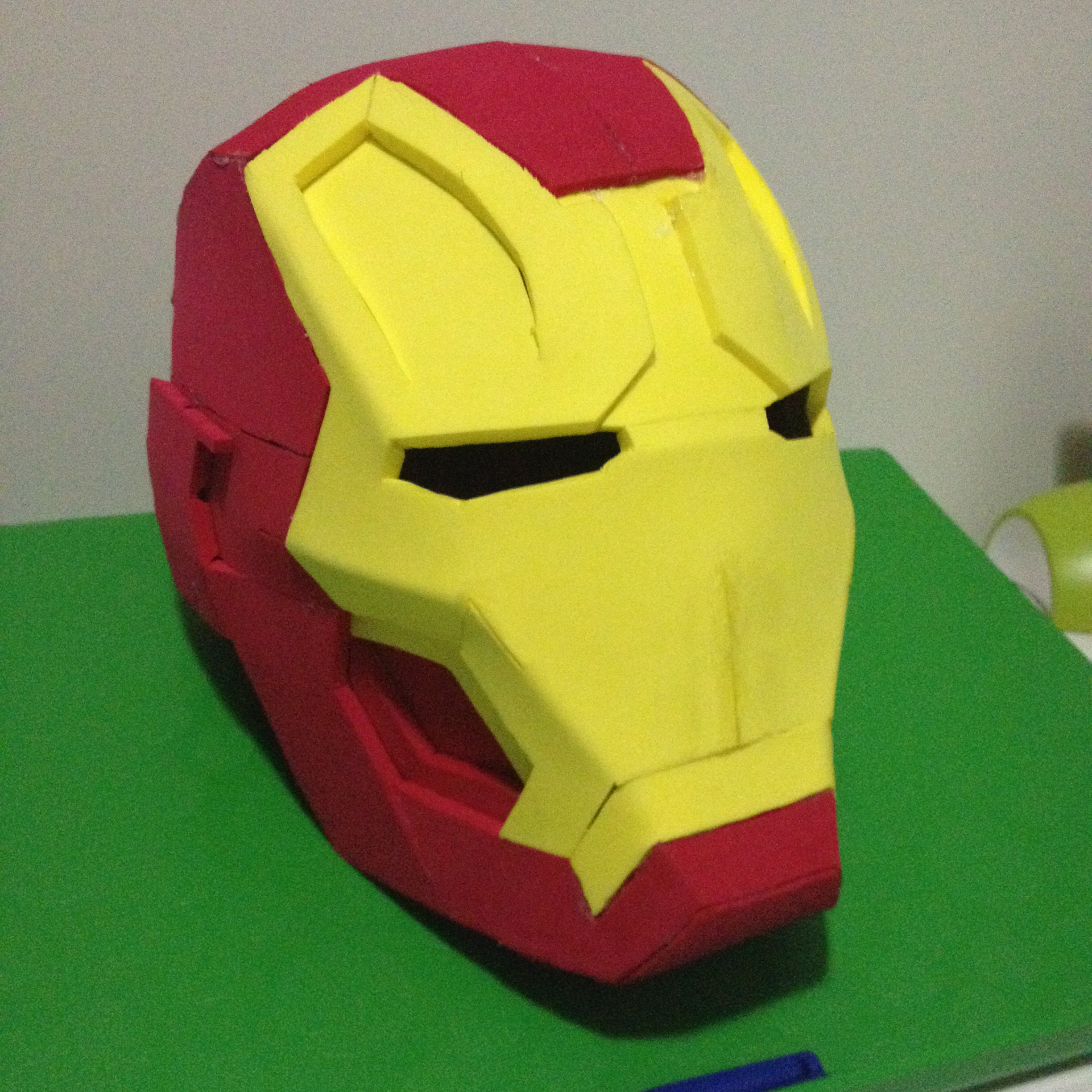

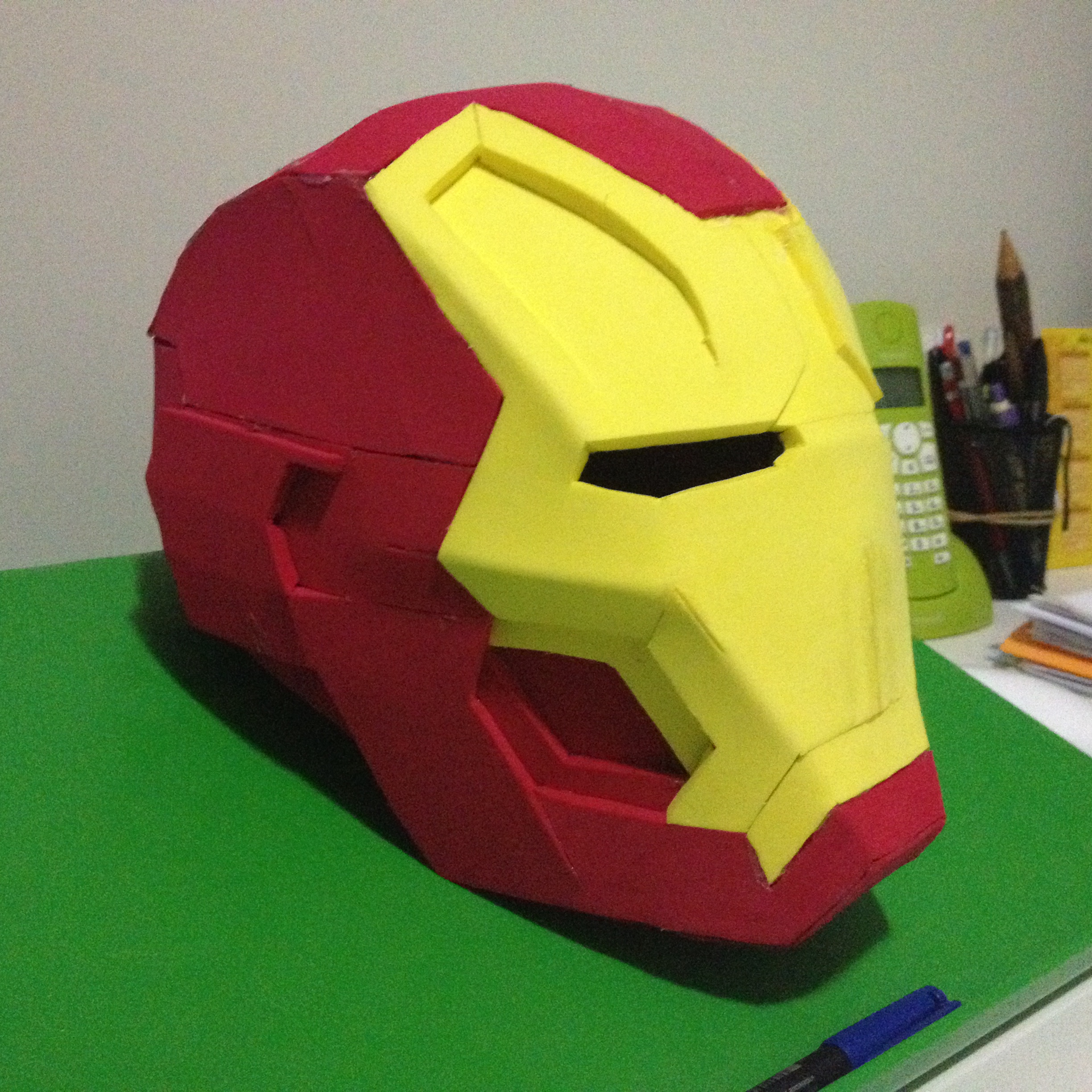

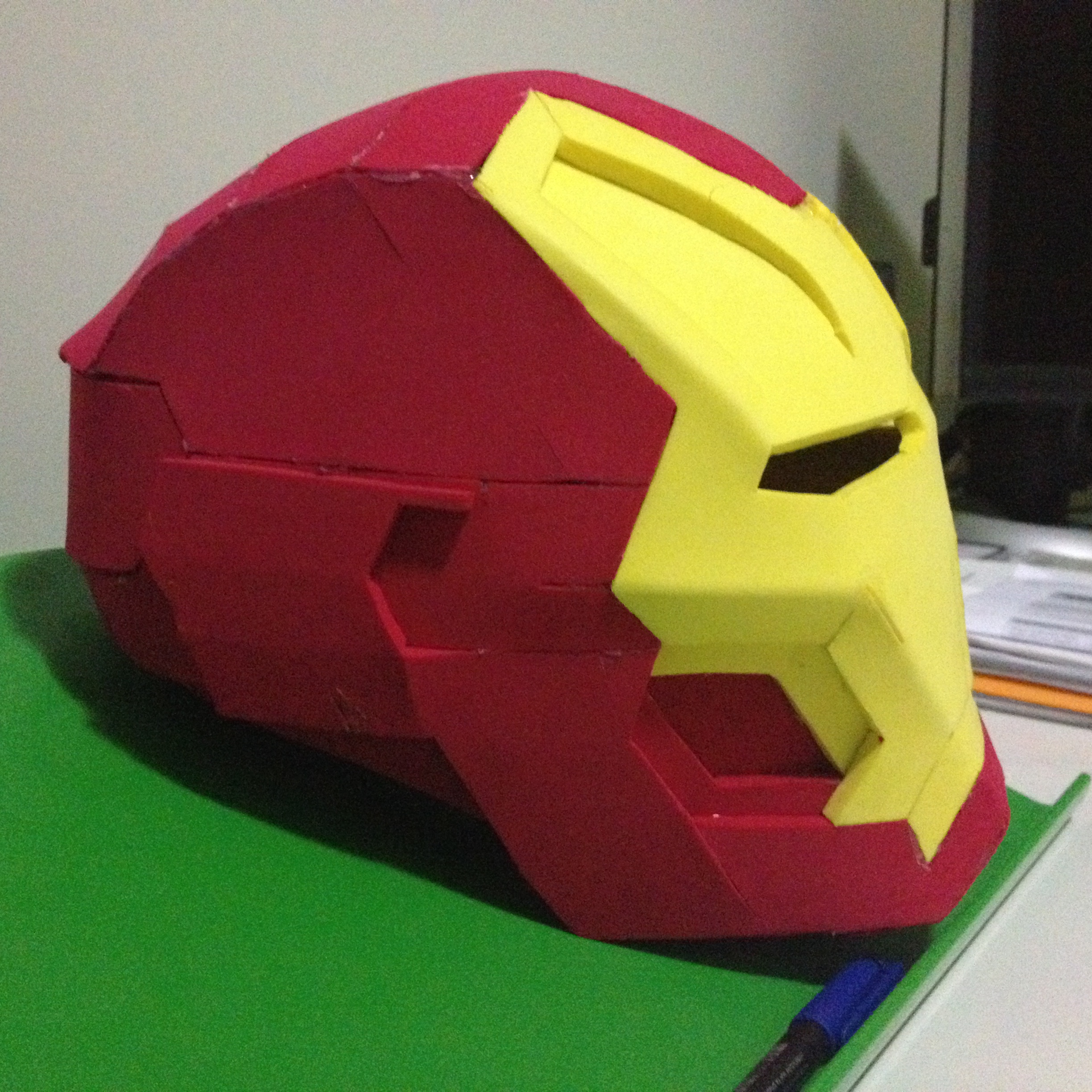

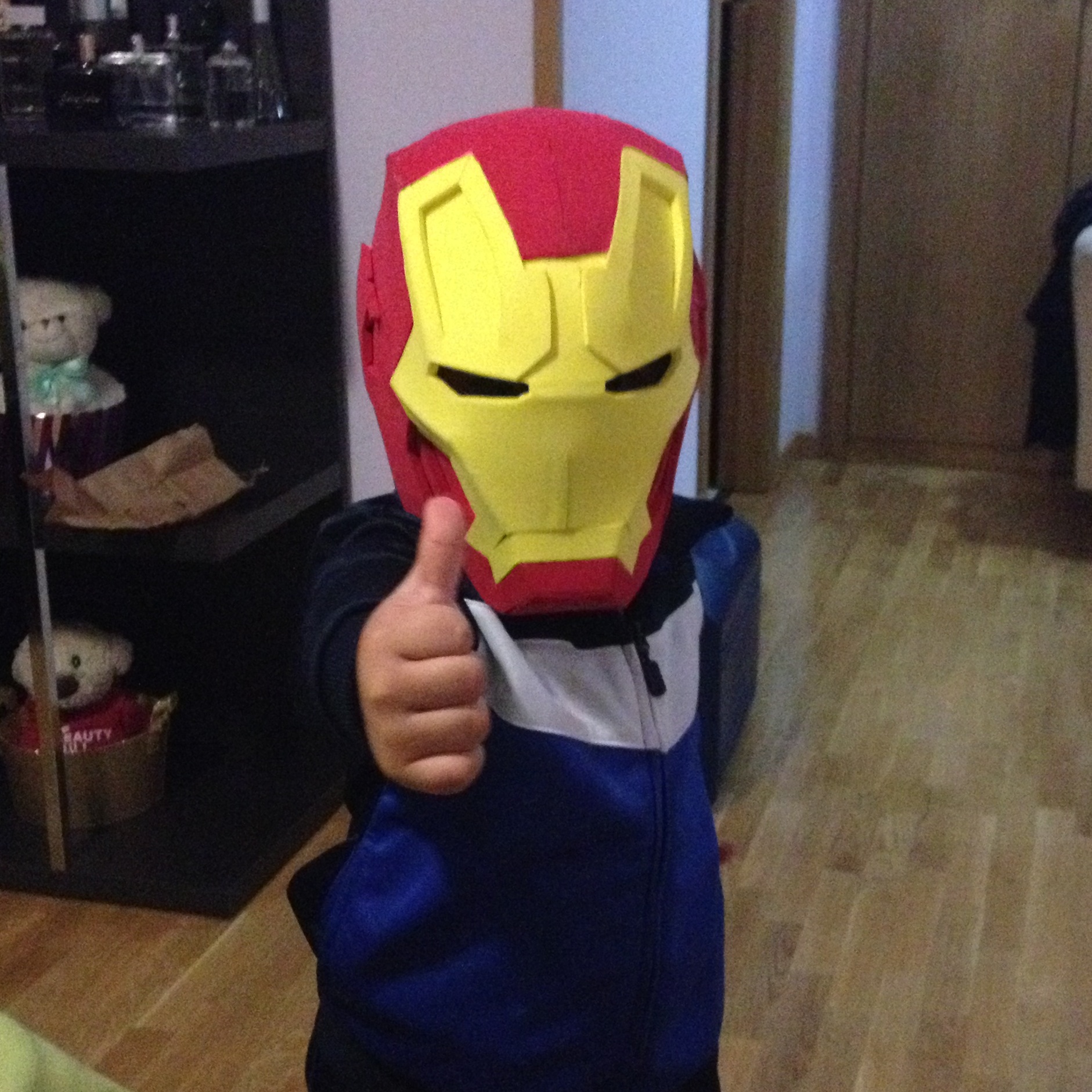

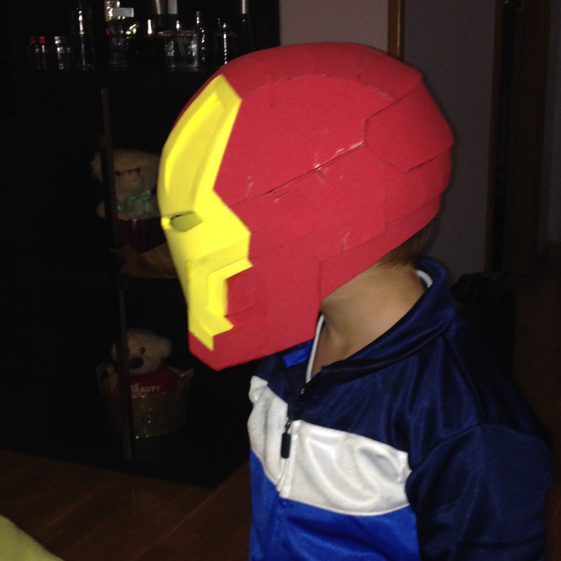

Hi all, I finished my first foam project using one of JF files
Foto 23-10-13 21 18 15.jpgFoto 23-10-13 21 18 24.jpgFoto 23-10-13 21 18 43.jpg
My cut & glue finish is very poor but is enough for my 3 year son. He's so happy with his new ironman helmet.
I need more practice with hot gun. I'm thinking about my next project, maybe Loki's helmet... any suggestions for a newbie?
Thanks from Spain JFCustom!!!

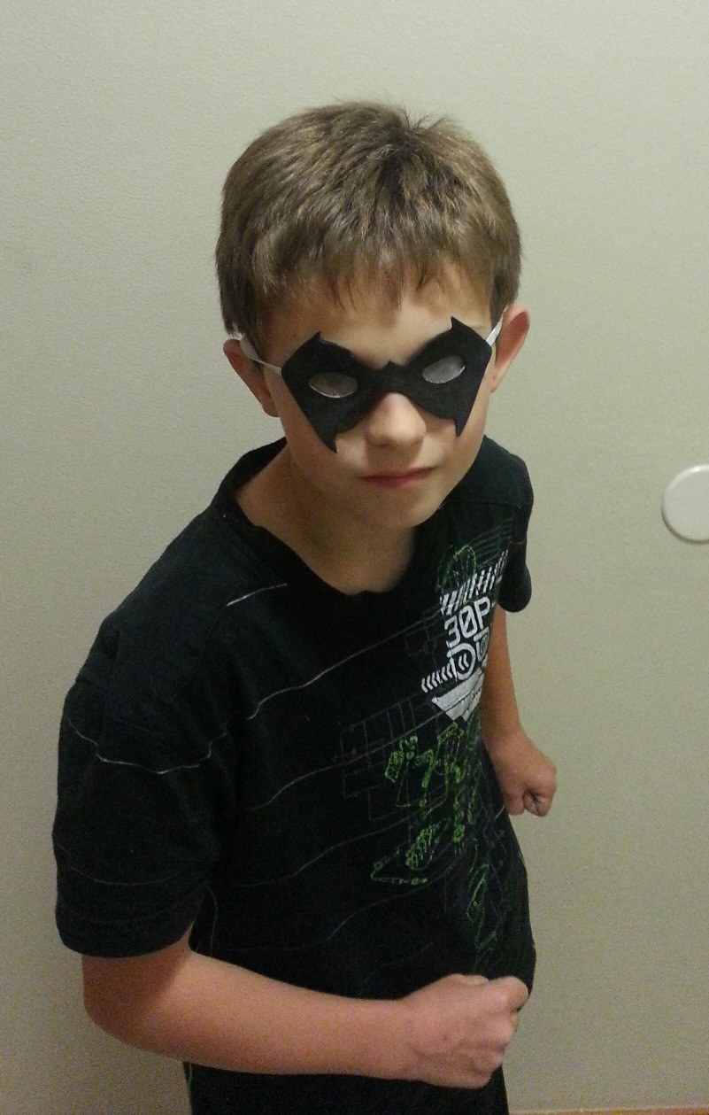

Is there a template to use leftover foam for making a Robin Mask?

Thas a very very good helmet man wow! Ithough it was another pic of Jf showing a new helmet or something lol . You making the hole suit or just the helmet?

Anything 2D you can do without a program. You can enlarge an image you see and use that as a template or just draw one. My son asked me for one and I just drew it on the foam. If you are using your leftover you have plenty of trial material to work with.

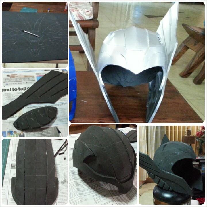

Thank you JFCustom! I won't be able to do these without your foam files. :)
Thor:
Captain America:
Took me only 1 day to do both, from scaling to painting.
