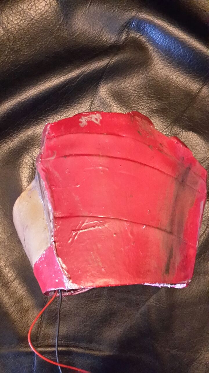

I have, it works really well. I've started making the base models out of cardboard, solidifying them with fibreglass resin and then layering on thin EVA foam. Durable, quick and easy!
ahhhhh i see , nice man. ive been trying to make them but i always get my cardboard stiff and it doesnt look like the program and it doesnt fit either , is a mess. since hes files are "easy" well i wanted to try out. thanks for the reply billy!!
It's how I do all my builds now. But i flatten the cardboard (sorta squeeze it together) to make it a bit bendier. After that, the files are a dream!
i see, i usually make undercuts to give it the form bit hes files dont have these so thats where i failed in most of the hand palms files out there. they just have alot of lines if you put the the threshold number above 175 it gets confusing. but ill try right now to see how it goes. any idea if it need to be scaled? since hes files are for people 6feet and i am that size.
Now I did scal it, but can't remember to what. What is the scale set at now?
