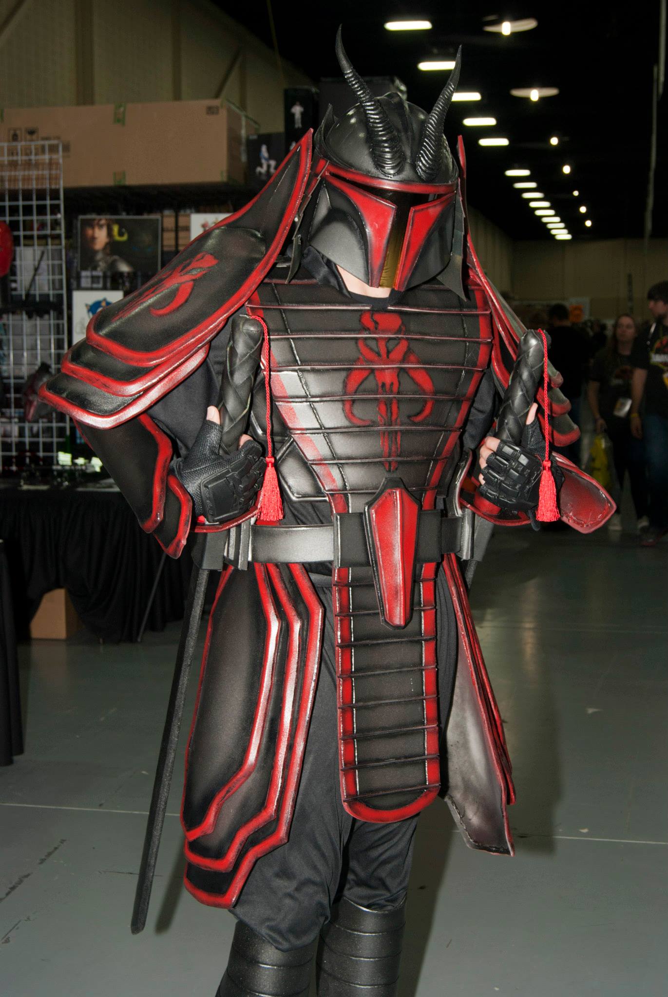

The files are based off obj. files or previous Pepakura files out there. JF did start creating some stuff in Blender - Deathstroke Injustice, Snow White, etc...
If you are wanting custom templates made you need to have a 3D designer create the model for you, then it can be imported into Pepakura. But it will cost you quite a bit to have them designed. I always try to find templates from characters and mix and match armor if I wanted to go custom. JF did that with Blue Beetle using Iron Man and modifying the Metroid gun. And I've been mixing a lot.... Jango Fett file for my Mando, Predator and Raptor, and Jaffa and Predator parts. Mix and match.....there is a bunch of templates already here.
