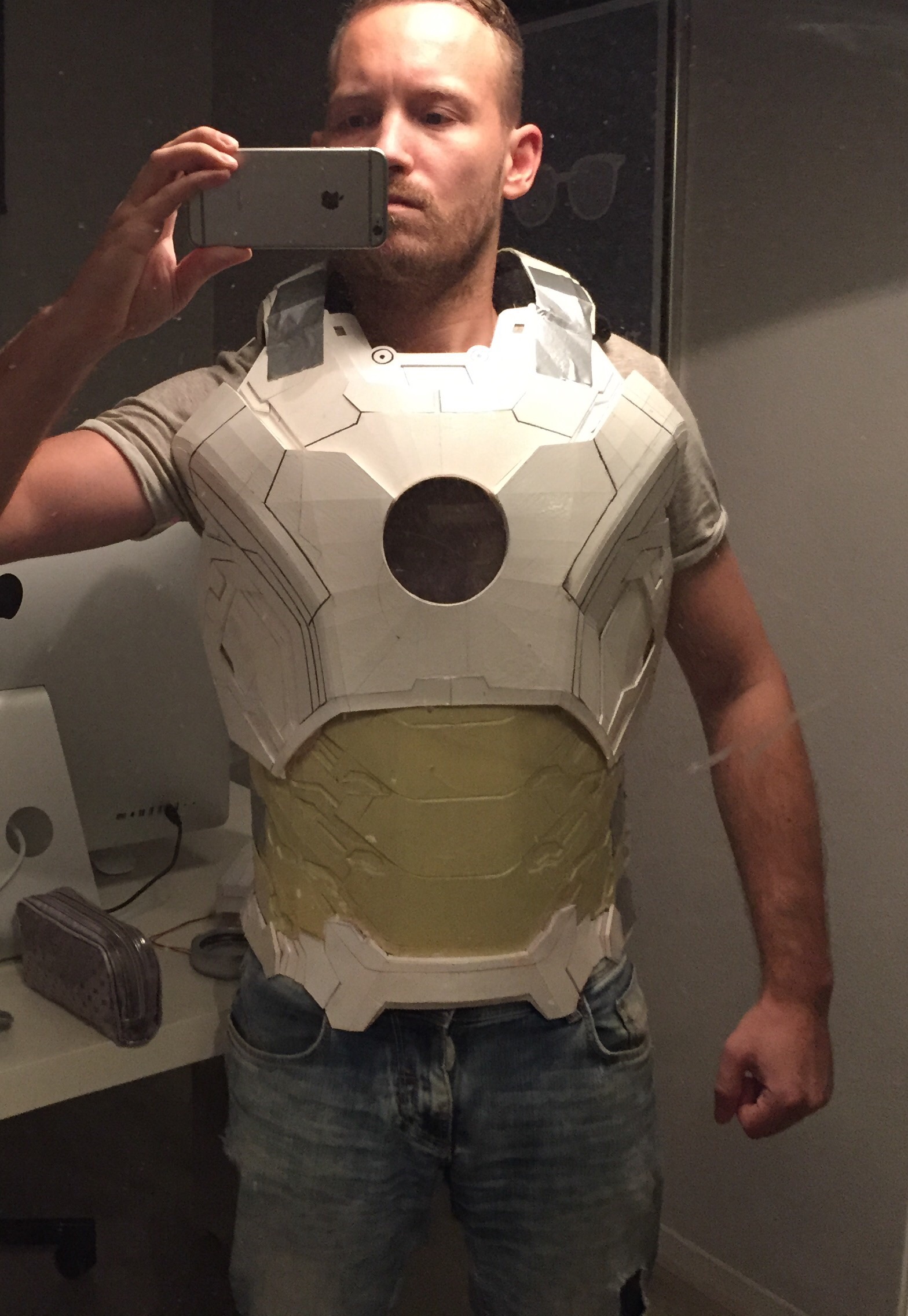

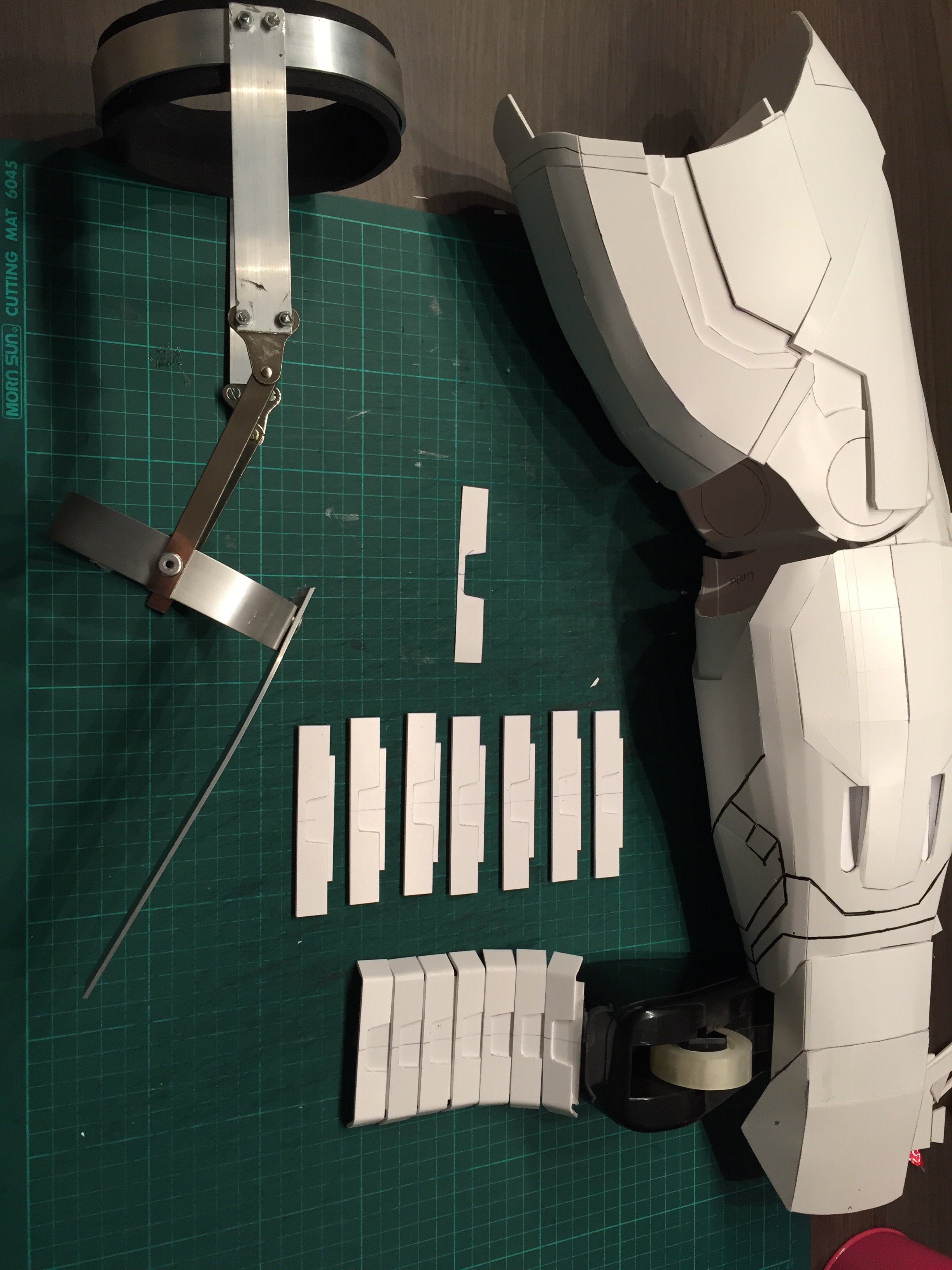

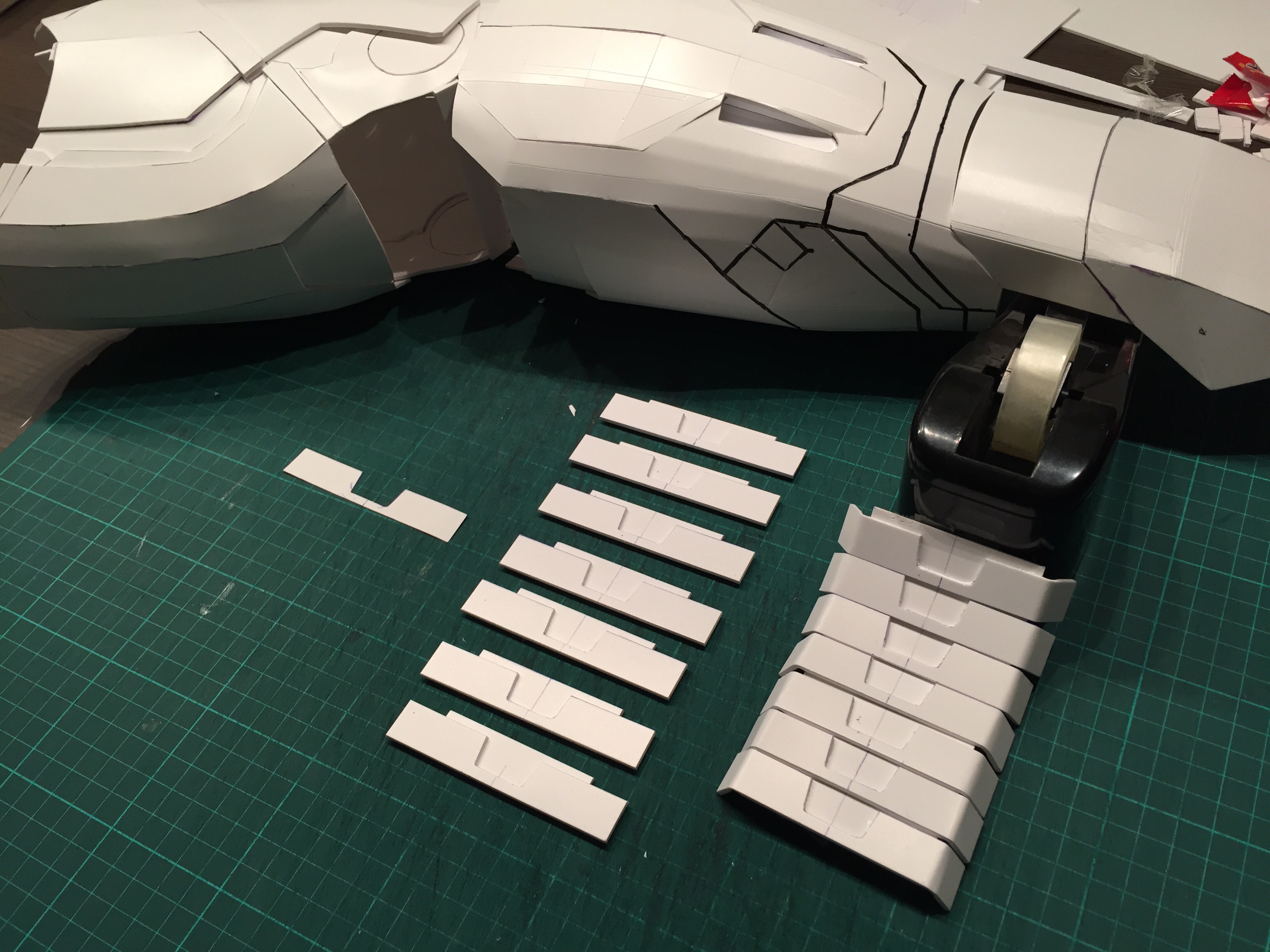

Small update. Worked on the abs. De top 2 ab parts are seperate. The will be attached with elastic bands.
I also cut out the lenses for the helmet.
here's a pic of the work done today.

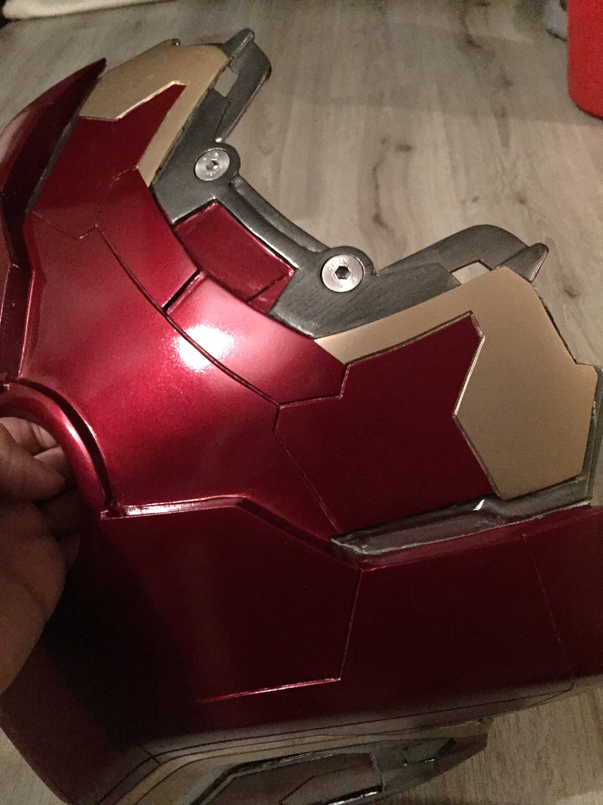

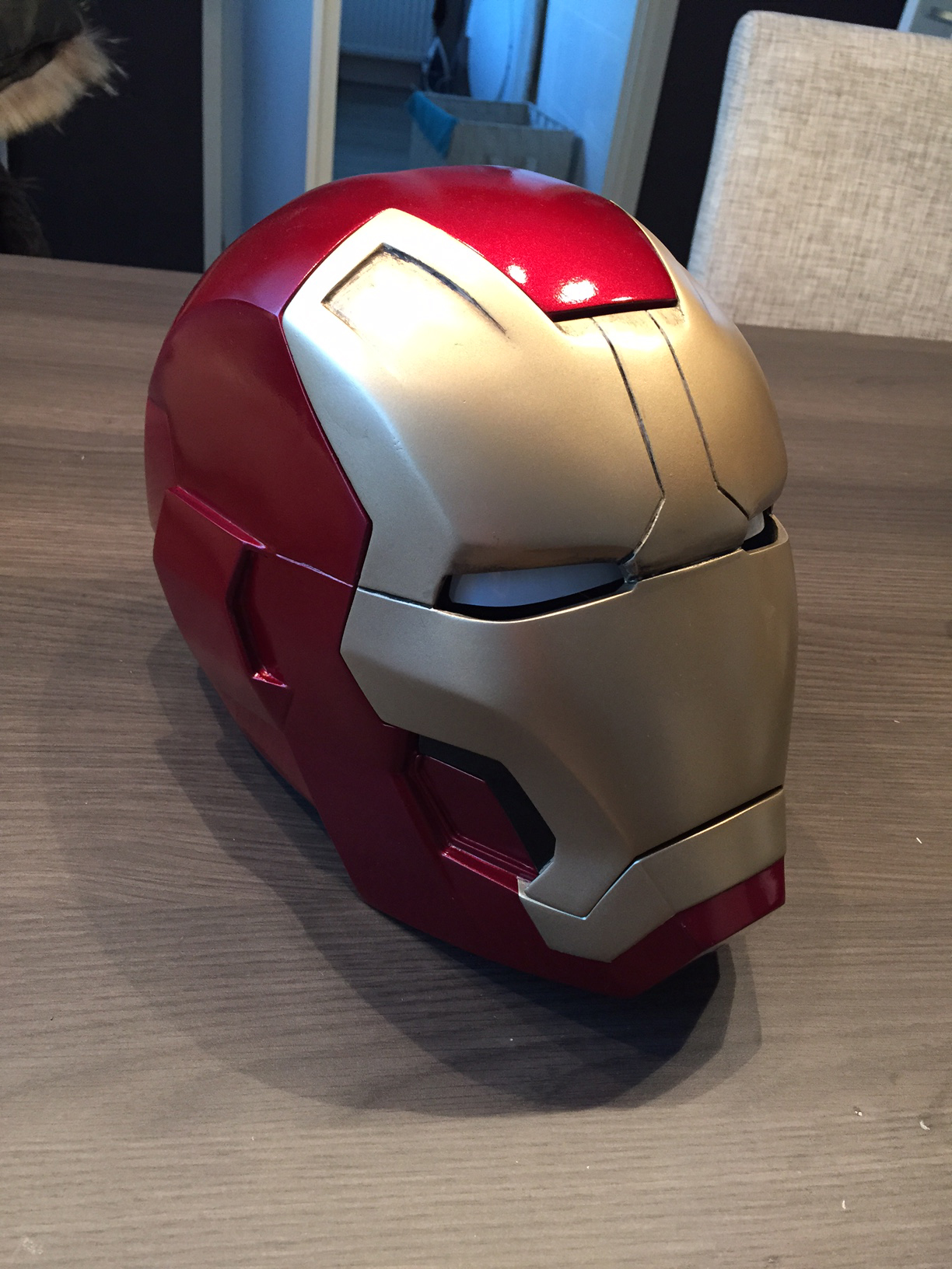

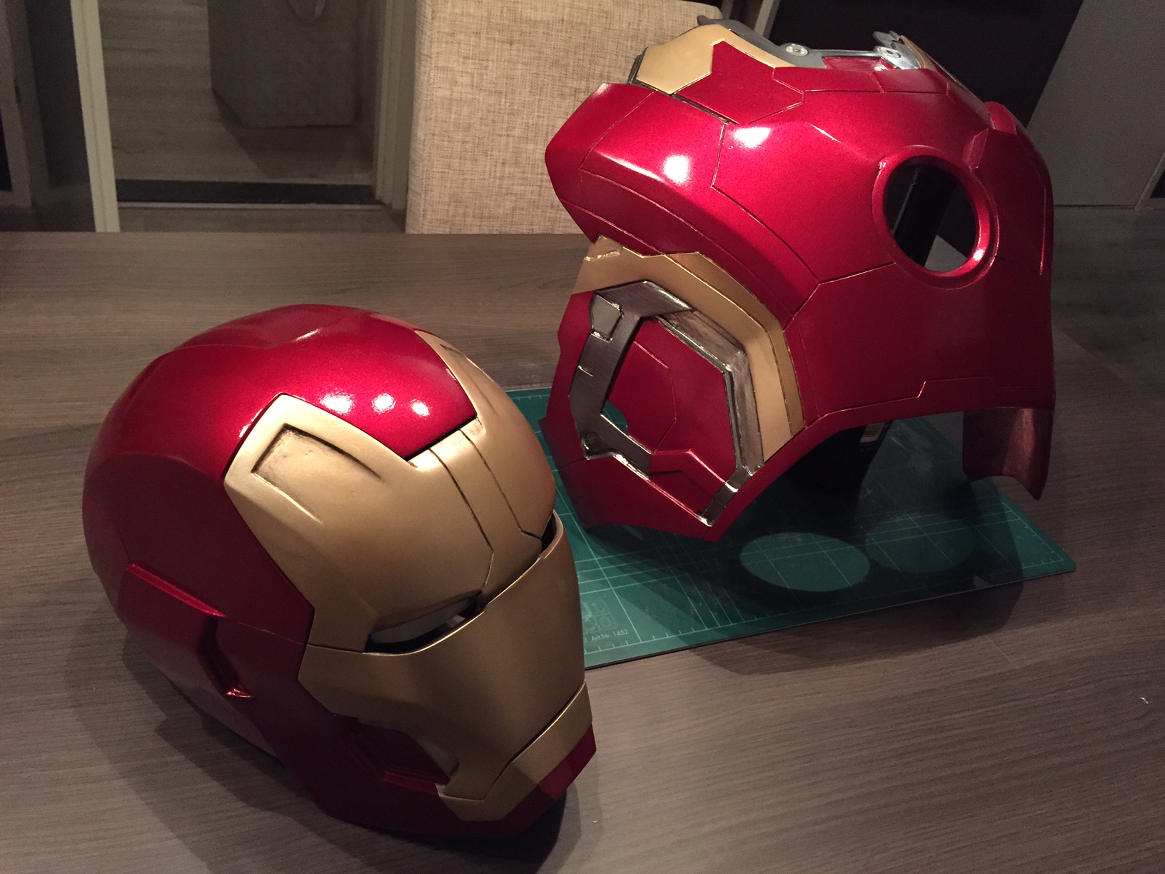

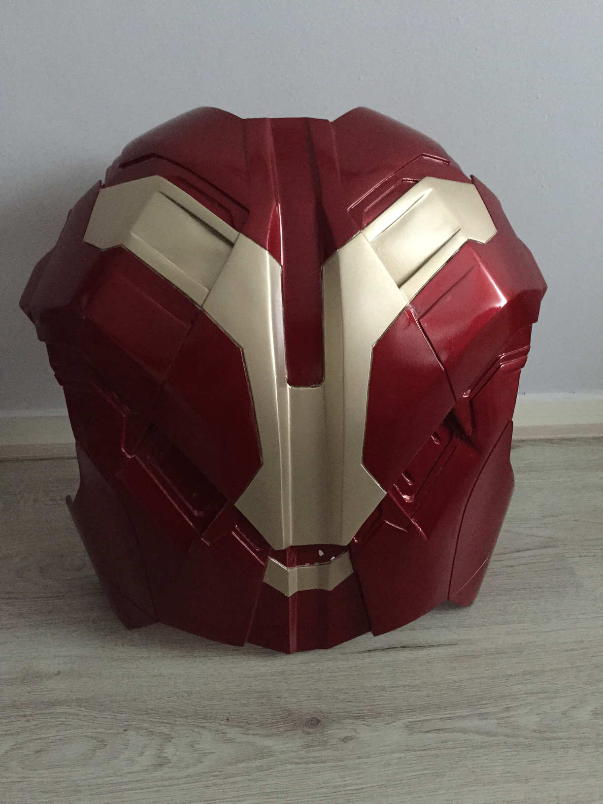

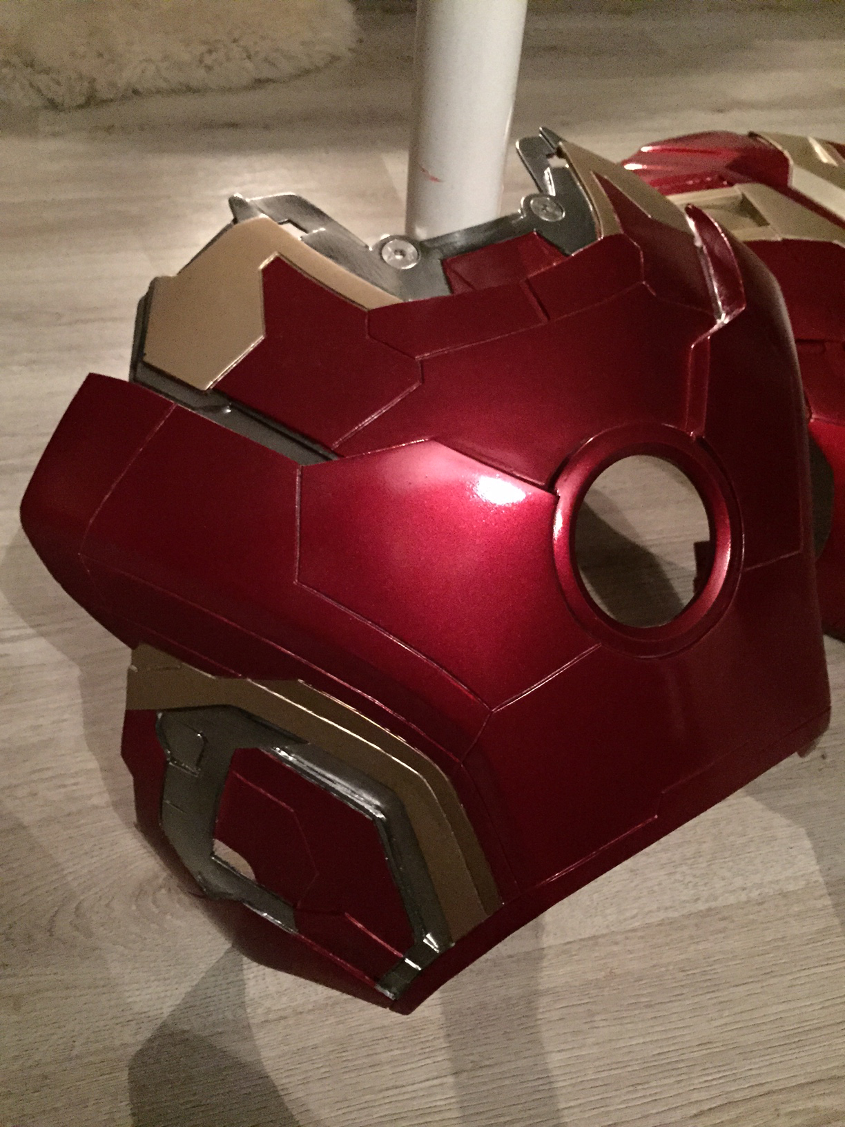

Hi Guys,
just before New Year i did some serious painting on my suit.
Here are some pictures taken by non-daylight. Colors look a bit odd but i really like the outcome. The glossy with the semi-gloss comes out nice.
I will do some weathering and maybe som flight damage. The back still needs some Alclad Airframe aluminum.
Hope you guys enjoy.
mk43 chest helmet.JPGmk43 chest detail.JPGmk43 back.JPGmk43 chest.JPGmk43 helmet.JPG

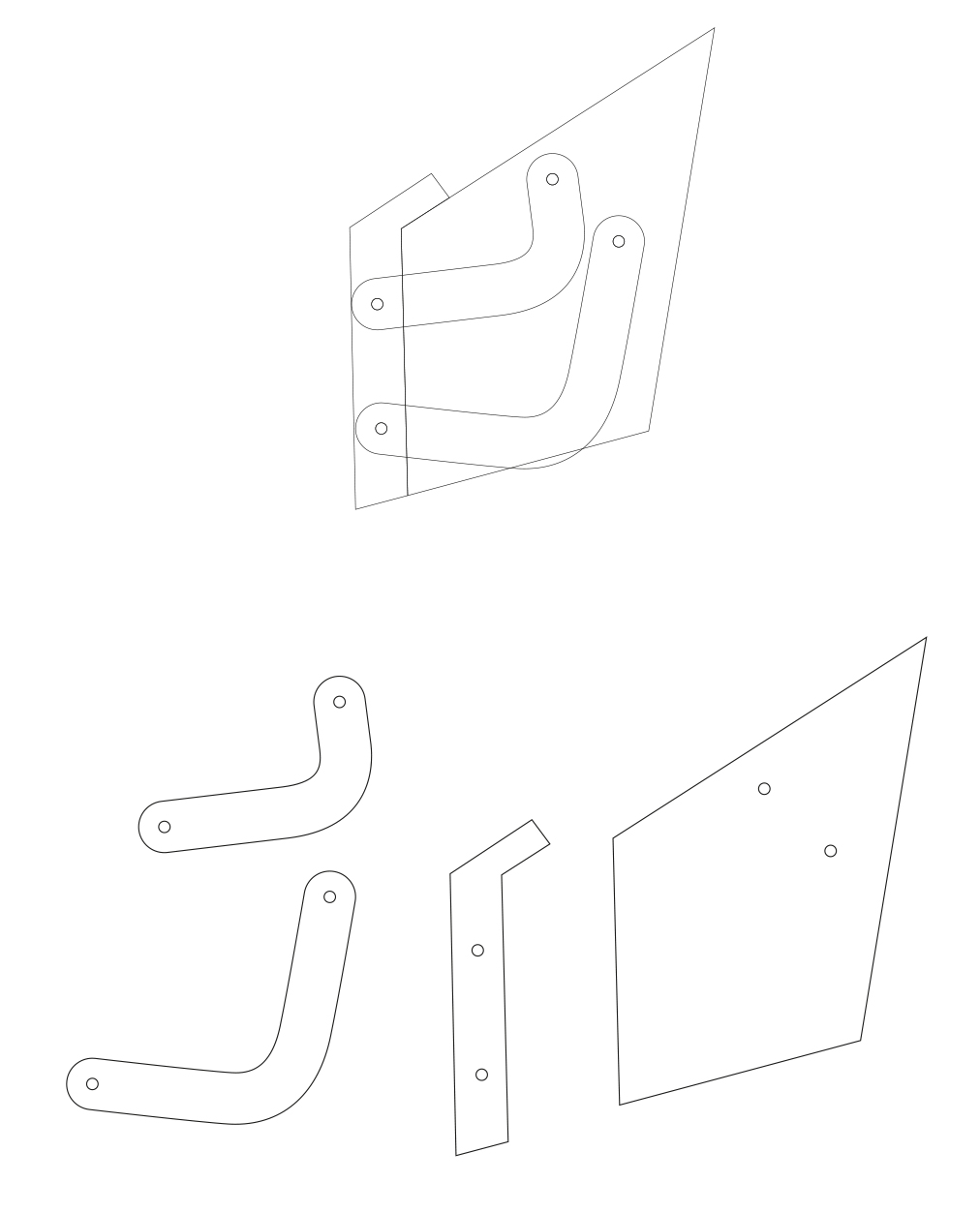

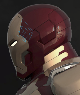

Here is the sketch i made. (i made a PDF in illustrator wich is exactly scaled 1:1 for my Helmet) the helmet was a cast i bought from detour props, so i dont know if this works for other MK 42 / 43 helmets
I also made a test setup out of sintra and its seems like this will work just fine!
On the top of the faceplate i will add some metal plates and on the inside of the helmet i will place some magnets so that when the helmet is up, it wil stay in place.
The real hinges will be made out of 2mm Dibond
