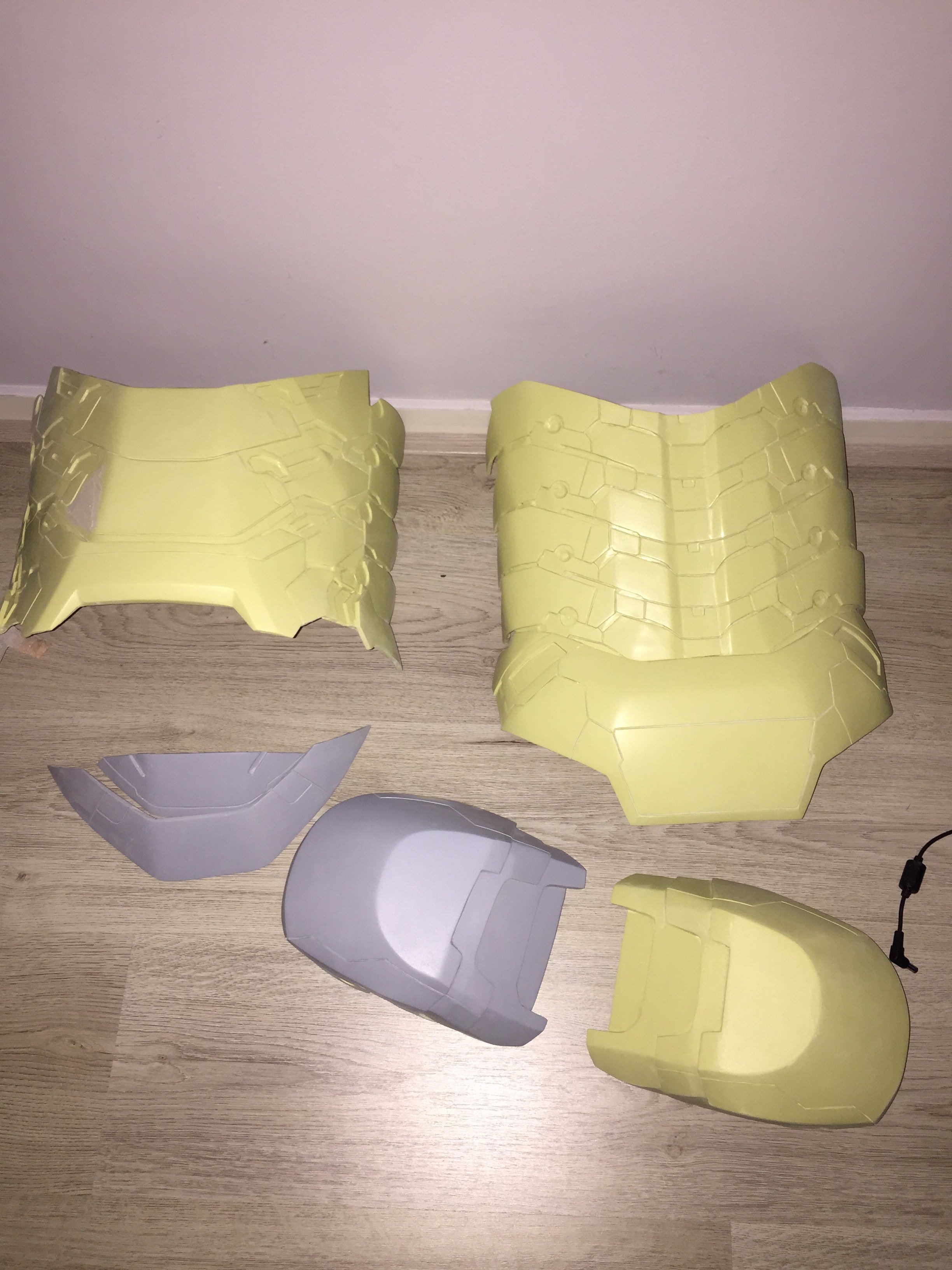

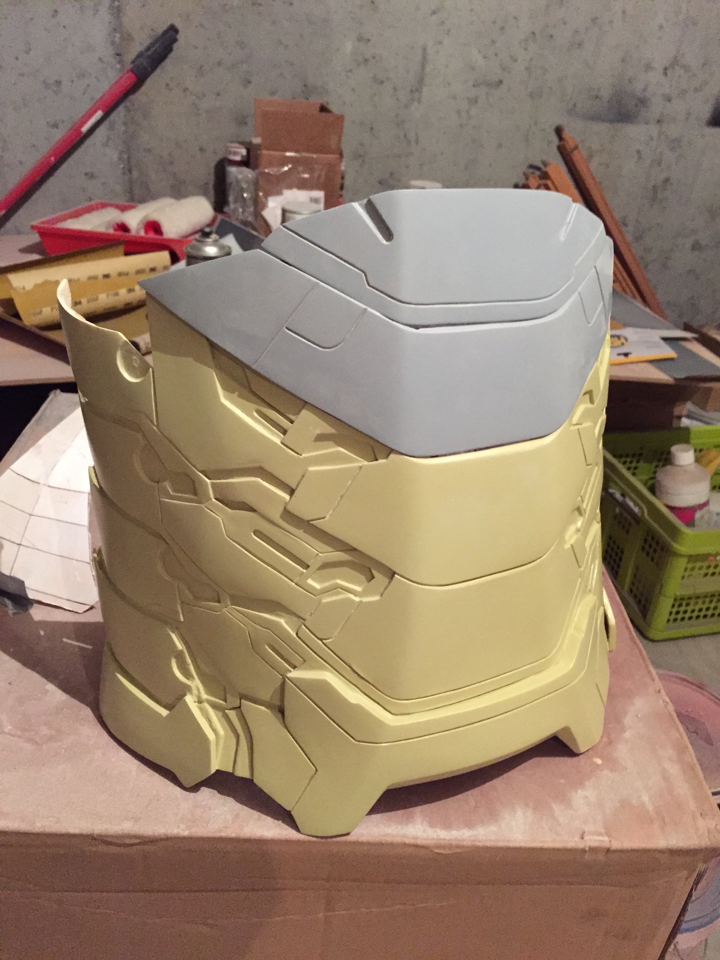

abs and shoulders ready for primer and paint. Finally. The abs were killing!
So is all this smoothness with paint simply the sintra?
or do you use some form of smoothing agent? fiberglass? bondo?

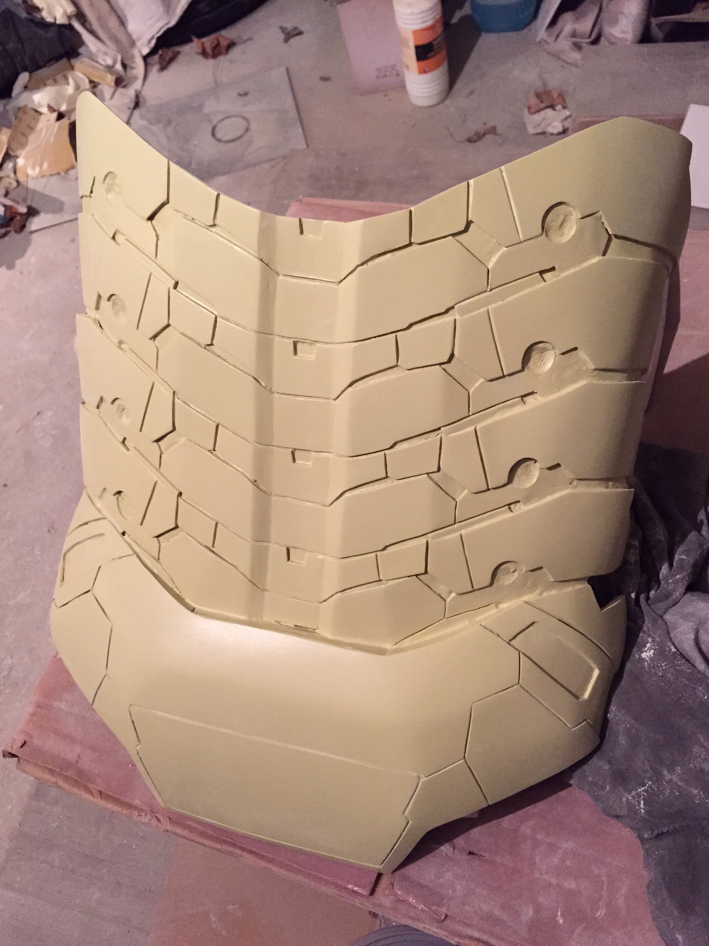

I wish it was that easy... no my friend:
1. Sintra build
2. Fibreglass the inside for strenght
3. Bondo (fibrebondo)
4. Sand
5. Soft Bondo
6. Sand
7. Filler spray (yellow green stuff)
8. Wet sand, grid 240 & 600
9 Primer
10. Wet Sand grid 1000
11Primer
12.Wet Sand grid 1500
13. Paint!!

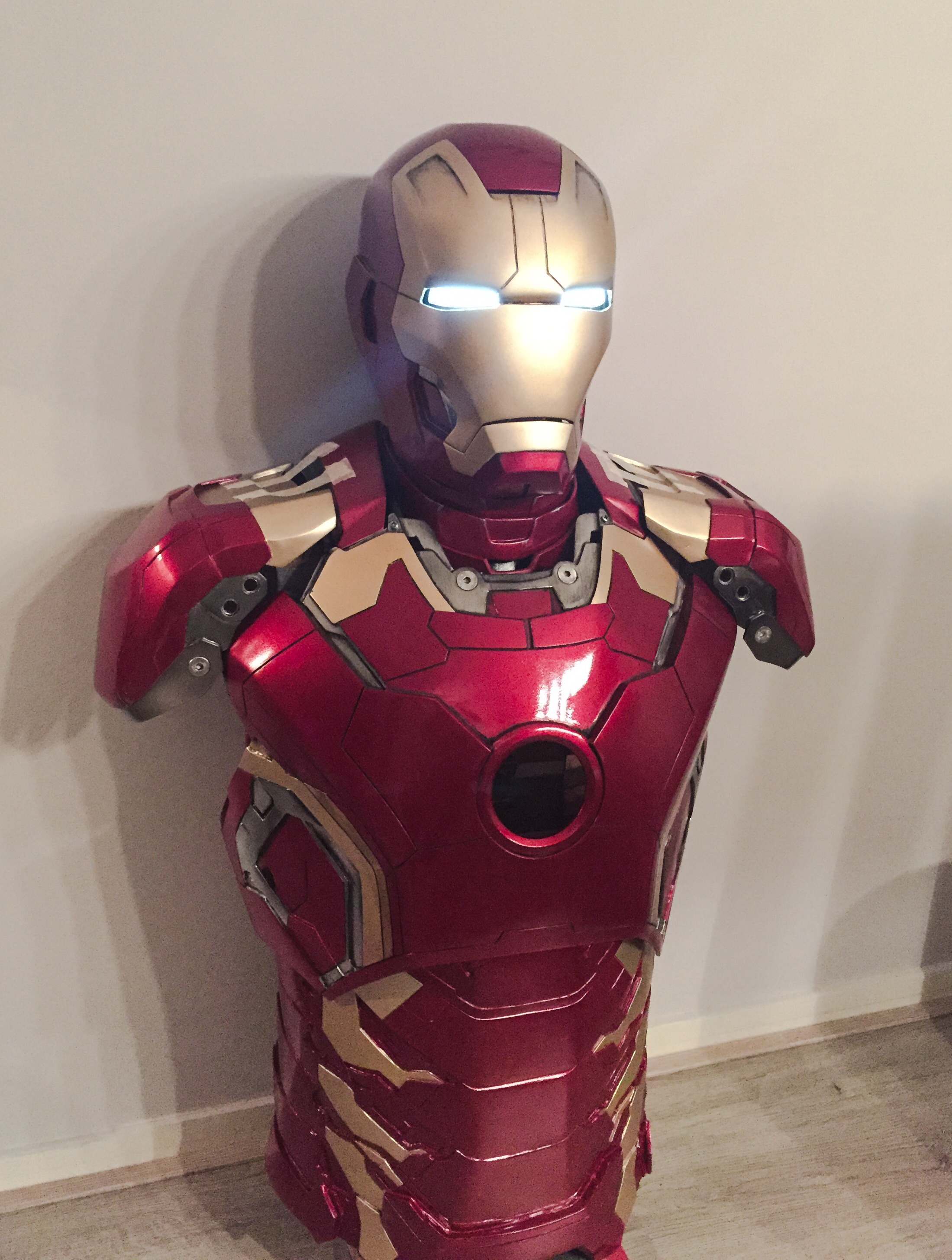

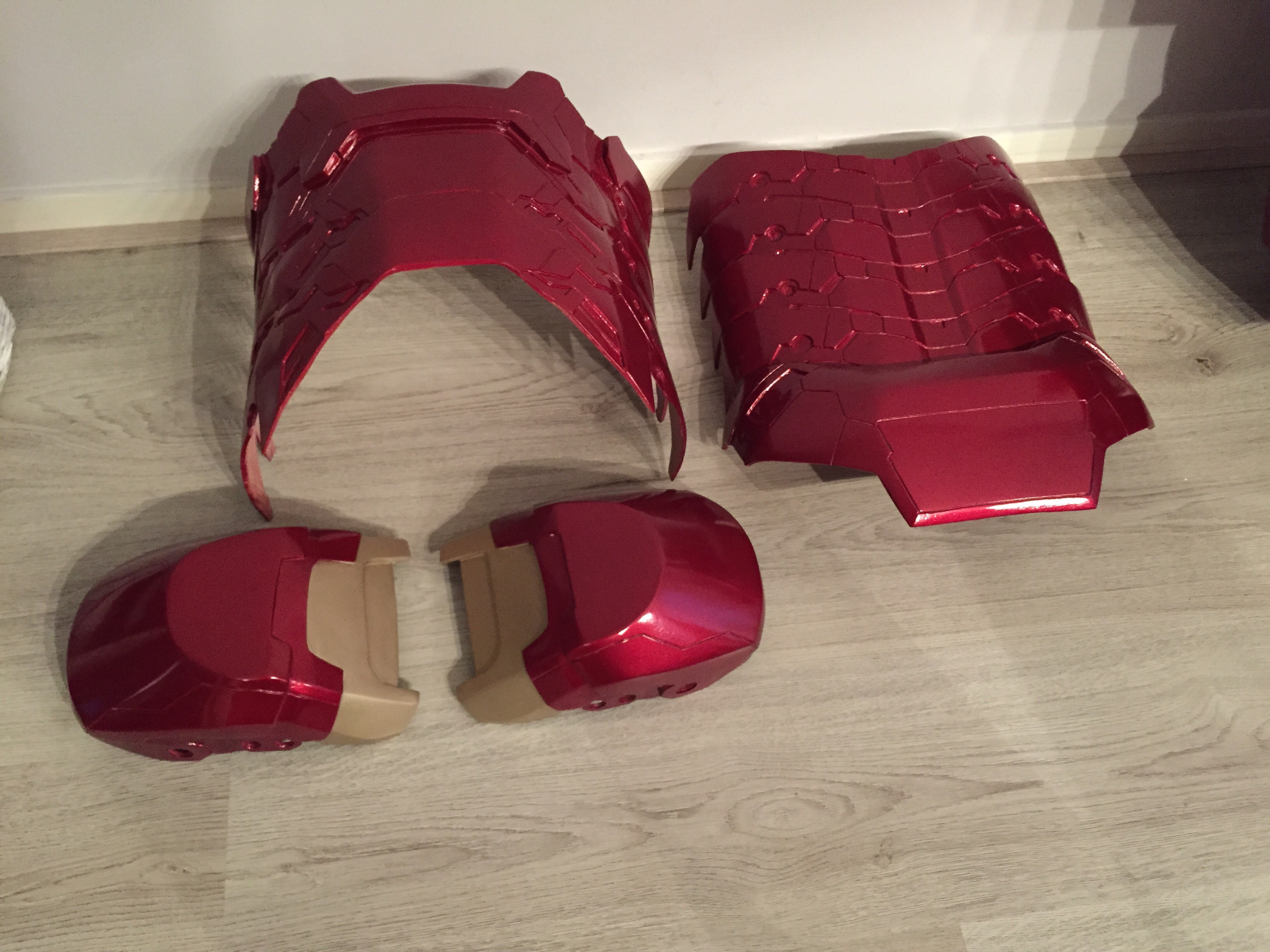

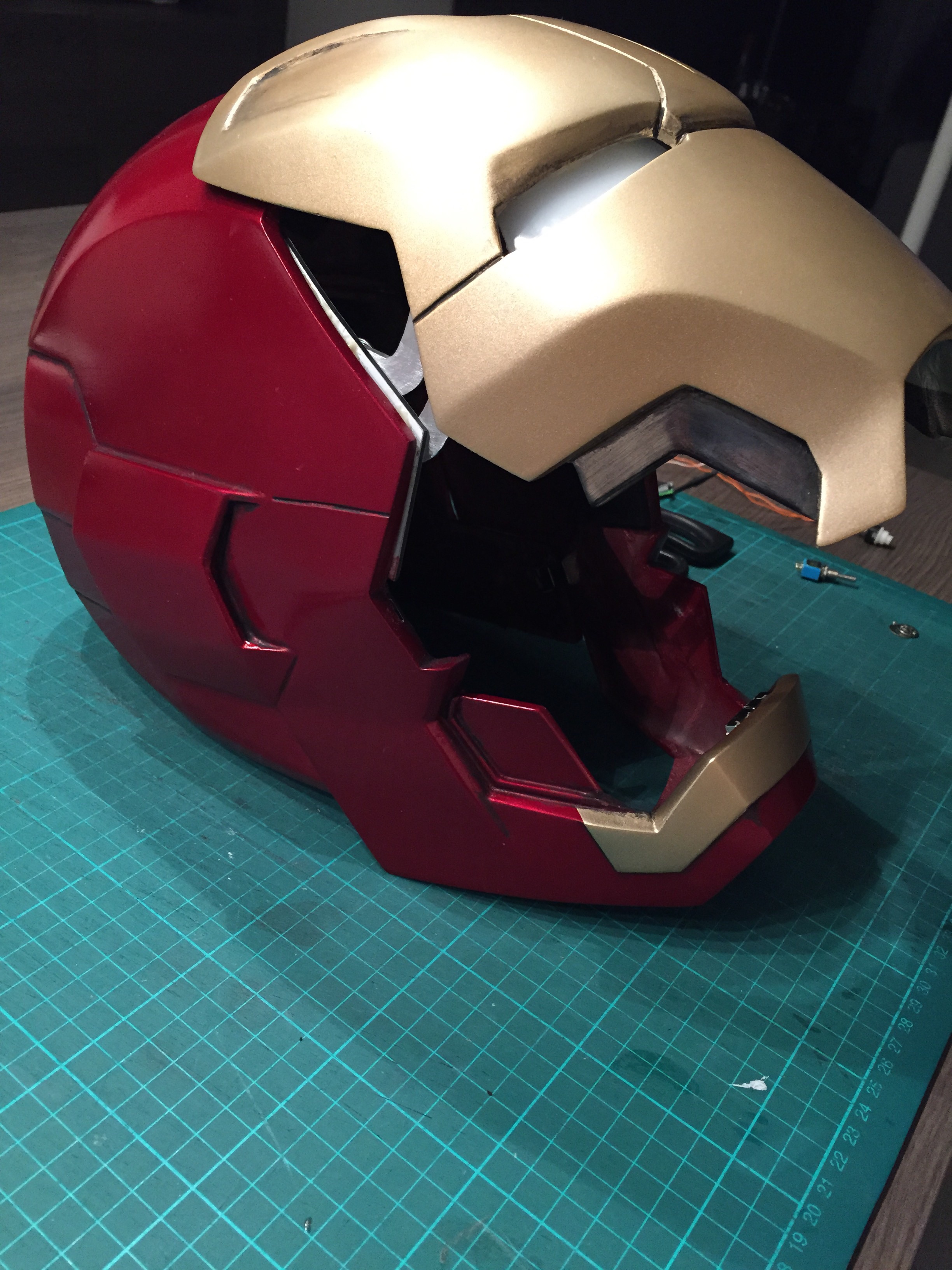

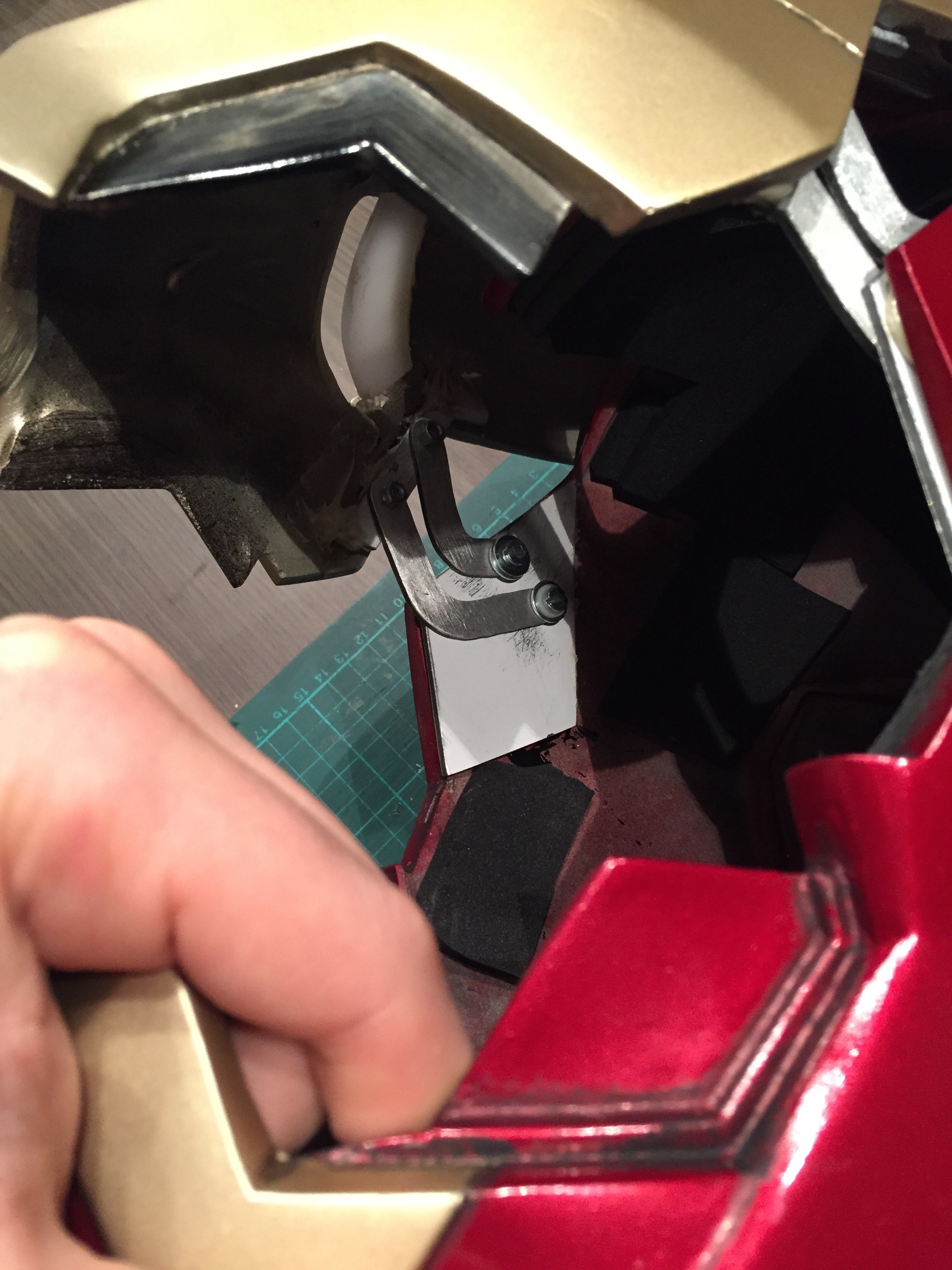

Update: some more parts painted! Still need to do the chrome. And gold on the abs. Further i mounted the hinges. Works pretty well.
i also soldered the lightning system for the eyes.

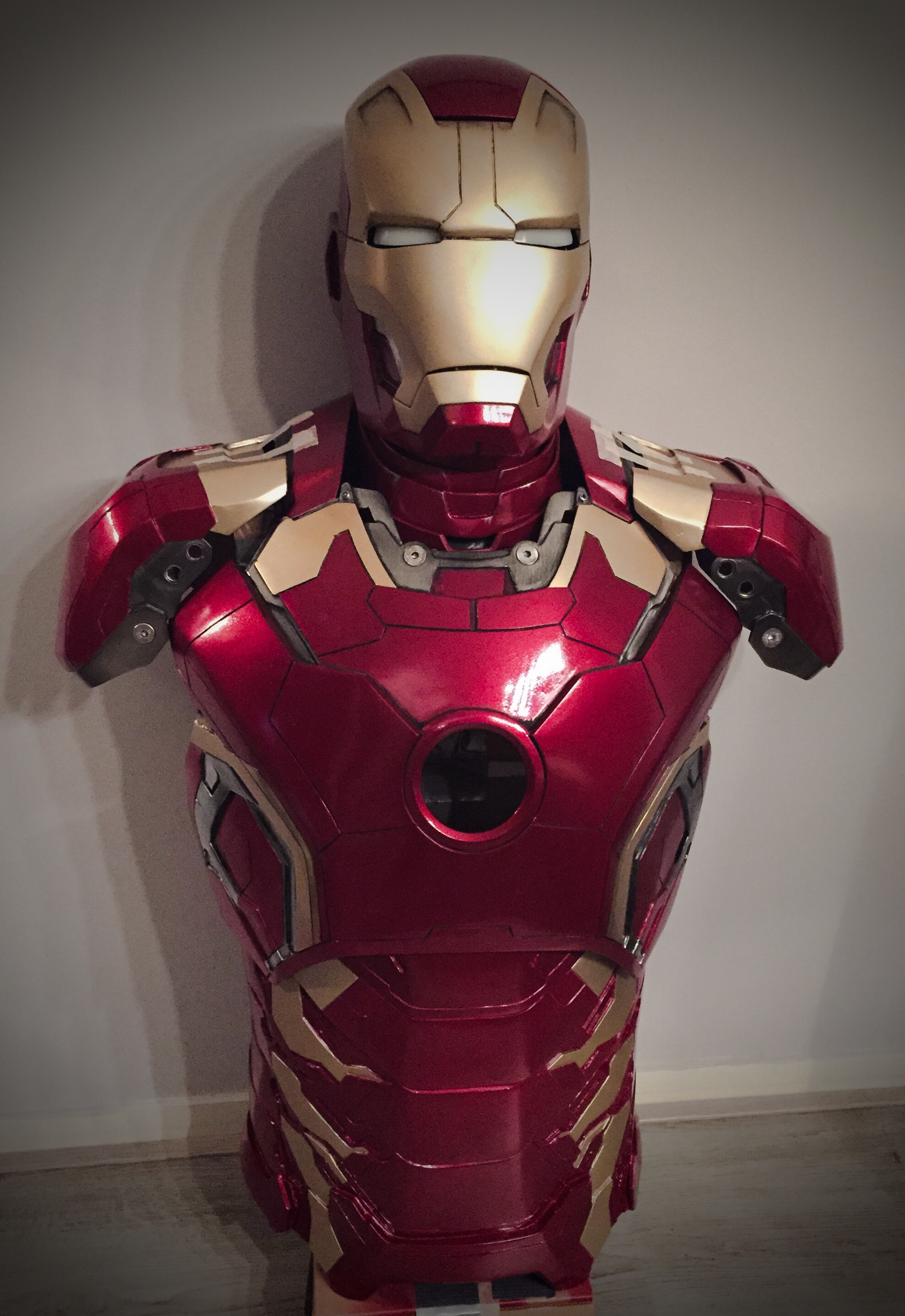

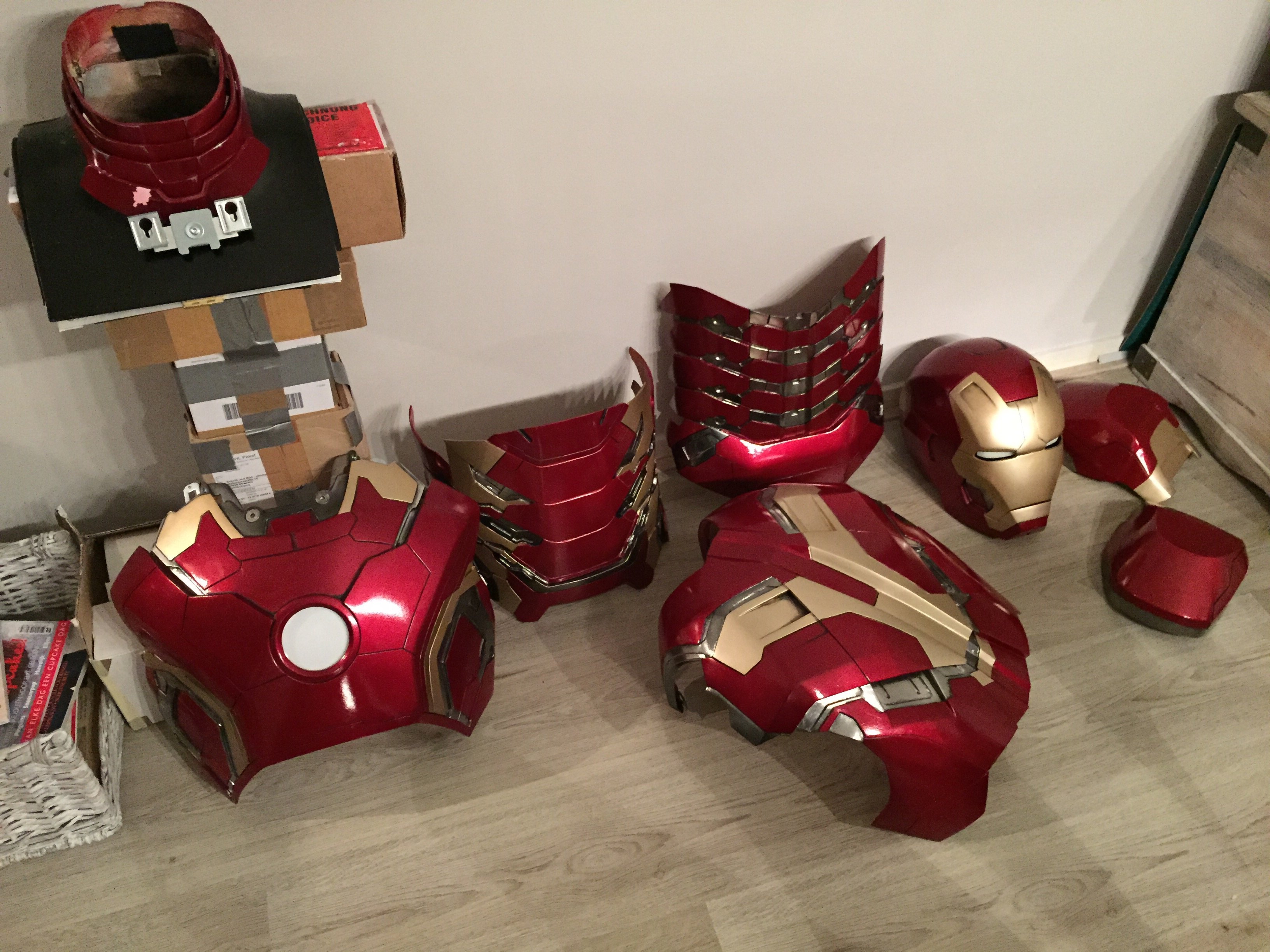

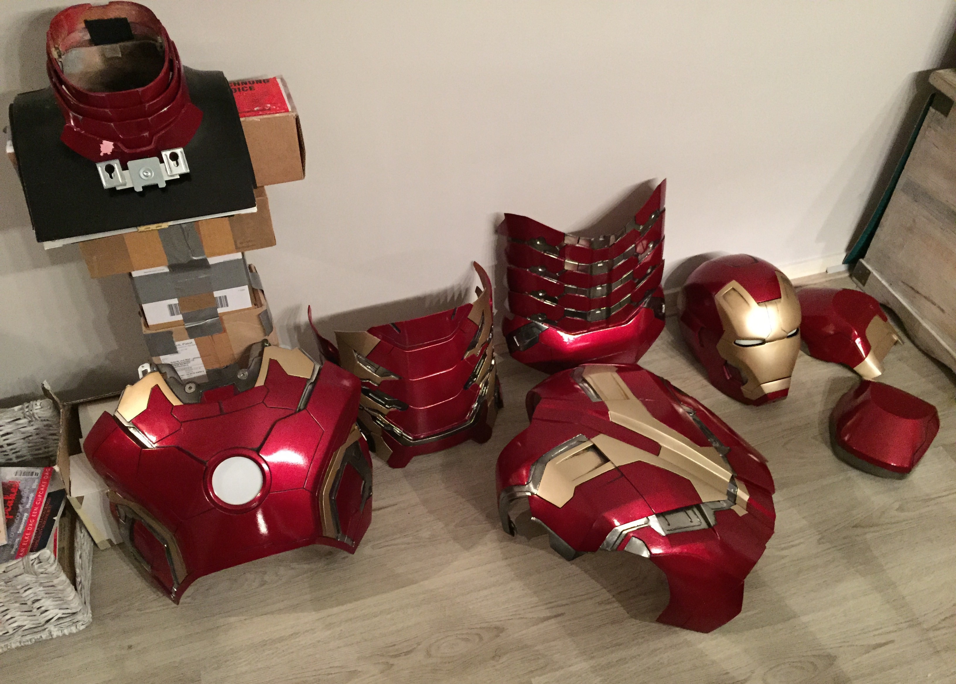

Got some fun work done! Installed the led eyes with magnetic switch. Also painted most of the shoulder and abs parts. Wasnt able to finish the chrome because i ran out of alclad.
here is the result till now:
Neat. Did you use the Mk.42 pepakura? And if so, could you tell me where you found it? Brilliant work on the painting, by the way. The colours all look extremely solid.

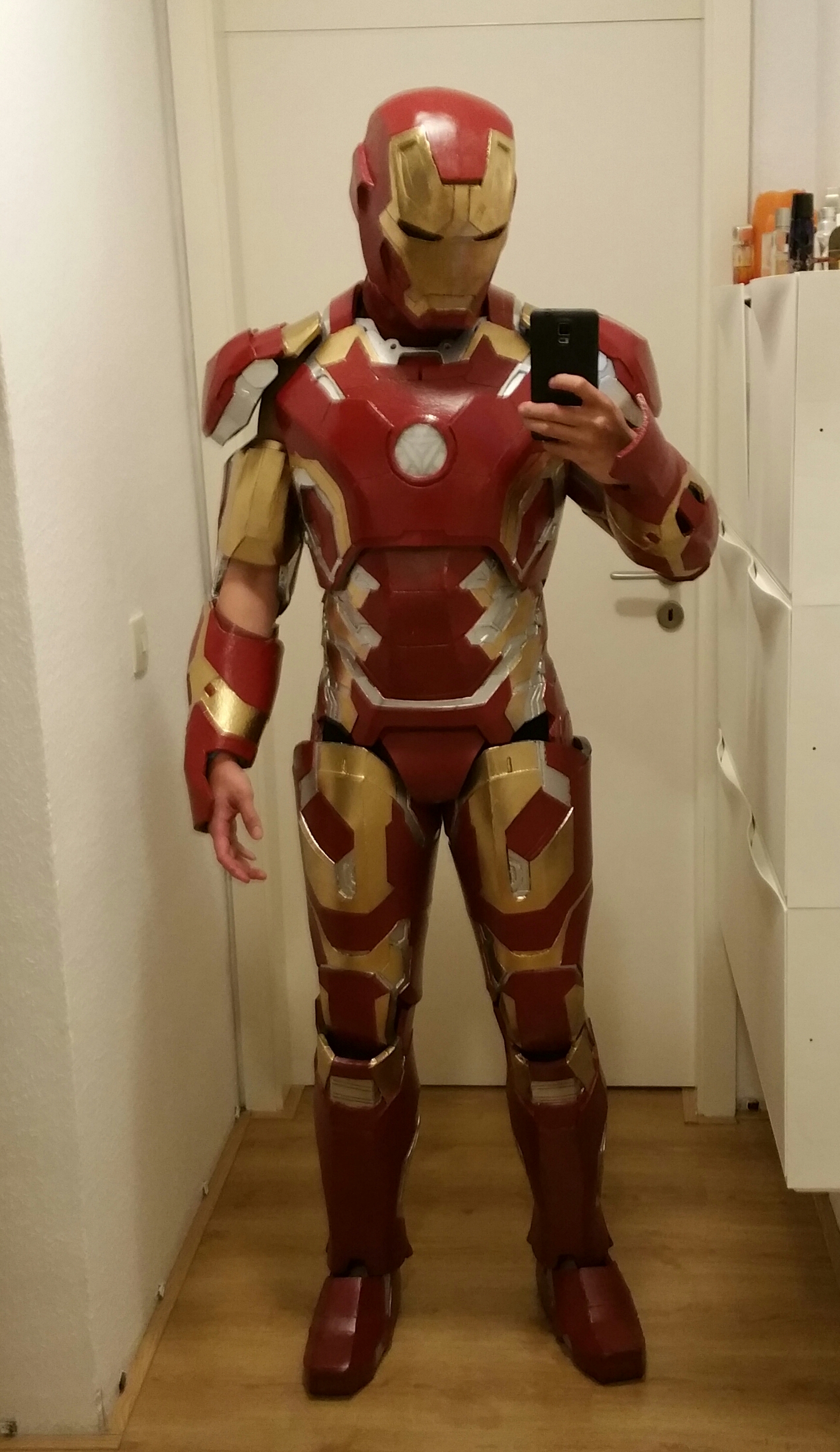

Wow jeez man u make us look like noobs hahaha! Great job! Btw I'm also almost finished, just need to add buckles and straps.

Jeej, thanks!
yes, i jused most of jackierockins files. Some of helegak for the upper arms and shoulder.
Very nice!! Especially concidering its foam. Good job man. I wont make my deadline of 14th of febr but im gettin it done!
