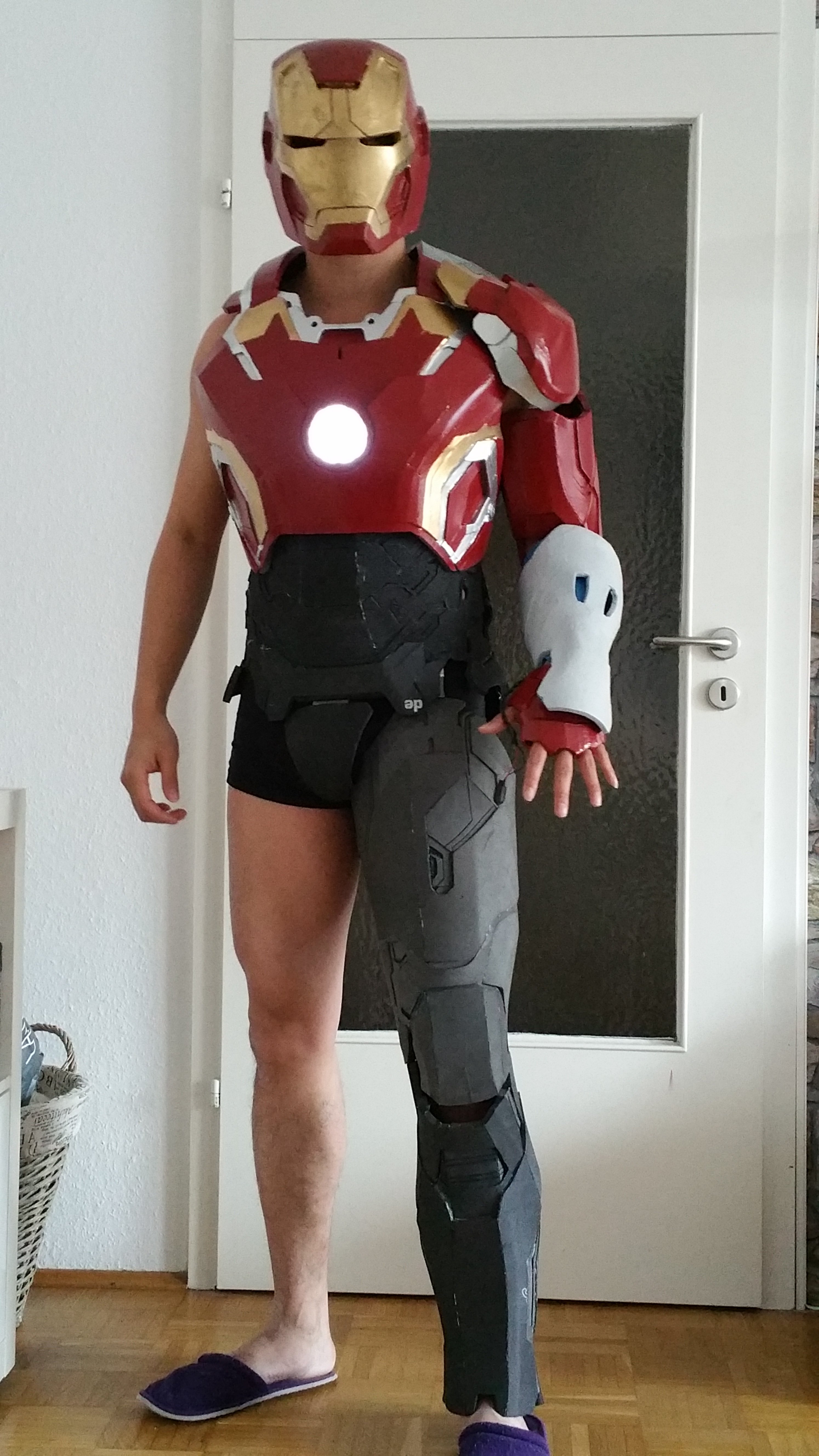

No means of highjacking your thread but here's my latest pic. Need to make the boots and the right biceps. The colors are just for testing. I'll keep the red but I guess I'll use the gold ur using
Why is the pic rotated?

No means of highjacking your thread but here's my latest pic. Need to make the boots and the right biceps. The colors are just for testing. I'll keep the red but I guess I'll use the gold ur using 
No problem. I always love to see other mk43 builds.
Haha why make boots when you've got house-slippers like that?
Your picture is probably made with a mobile phone. I also have this problem if i dont open them in photoshop first an re-save.

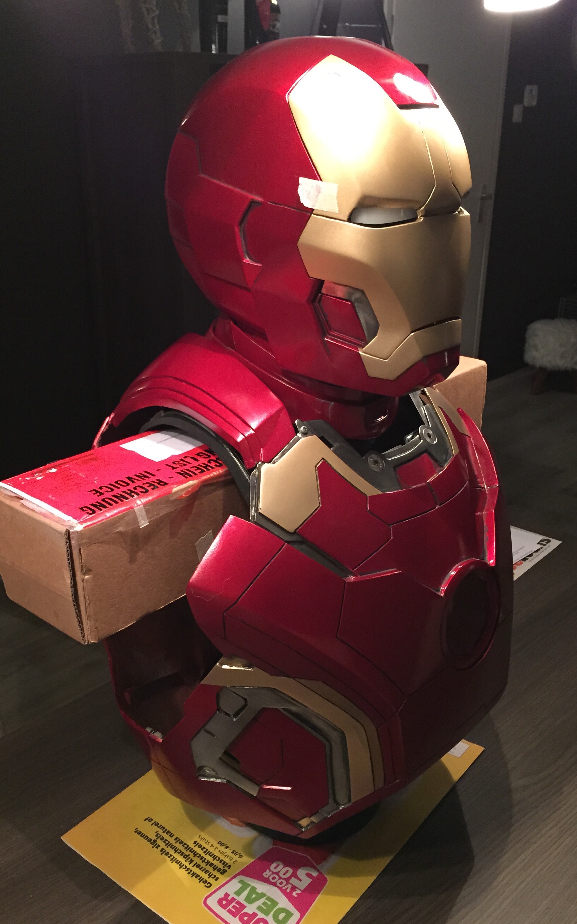

First of all : impressive build !
I'm painting my mk43 too at the moment, but the paint results look nowhere near as good as yours, despite using the same motip brand. How do you get it so glossy on the red ?
TNX
The trick in making something really glossy is:
Step 1: Sand it really smooth. (p1200 P1500 sanding paper) after the first layer of primer, sand i again, prime it again, sand it again.. then paint.
Step 2: Use enough clear varnish, multiple layers. The trick is to spray it so thick dat it almost starts dripping.. but just not yet. It has to look like a tiny waterdrops.. the will automatically float together in one smoot coat..
