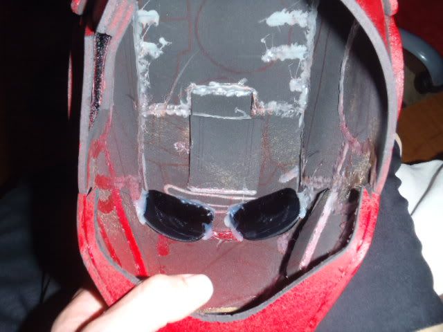

+ If using velcro in the helmet, make sure the soft cotton side is facing your head.

+ Using sun glass lens as helmet eyes is a good idea. Googly eyes behind a mask are scary.

+ Figure out how to have some ventilation in your helmet, you're going to be wearing it a lot.

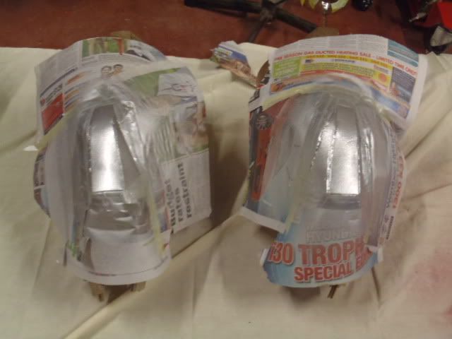

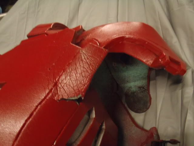

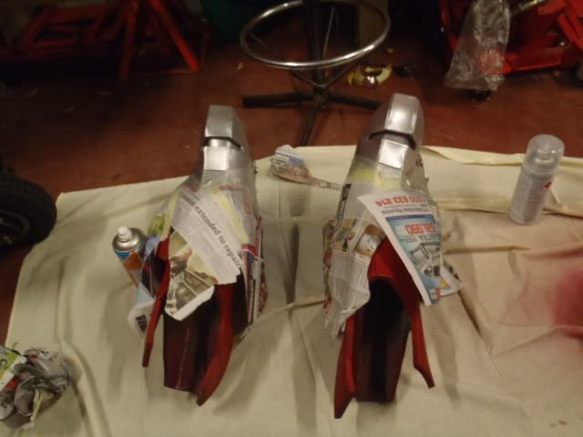

I spent all of Friday night and Saturday afternoon painting (I still had to work my full time job). I found that little sleep helped here....

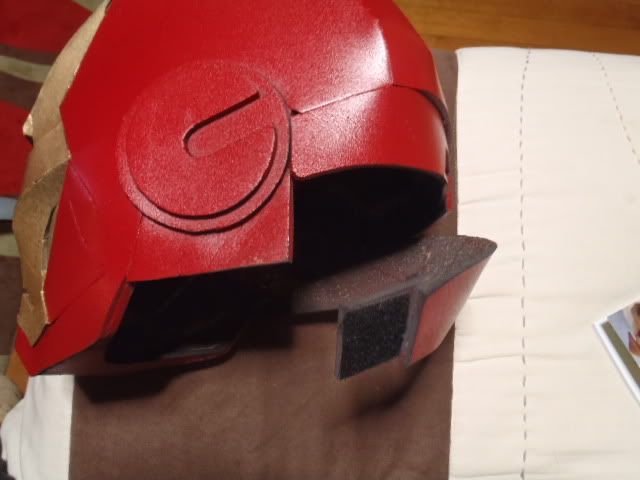

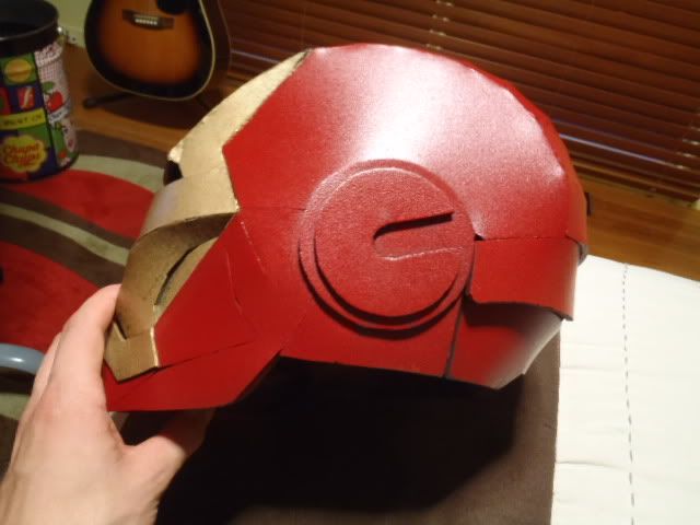

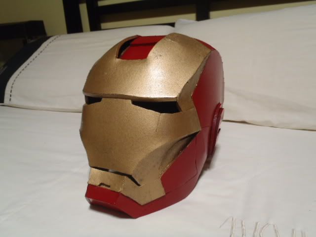

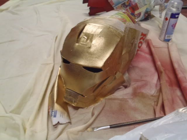

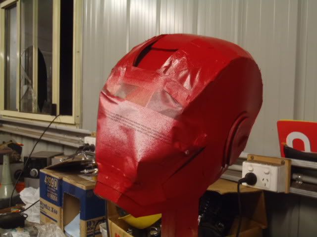

Helmet paint job
As I was about the spray the gold on the helmet the tube connecting the nozzle and can snapped!!! It was Saturday night and no way of getting more paint so I did my best to 'spray' (more like super drench/ fire hose drench, the helme in gold and used a paint brush to even out build up.)

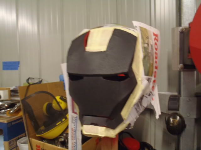

I was following this tutorial for the 'eyes'.
Lighting Up The Eyes
I never got time to add the LEDs though.

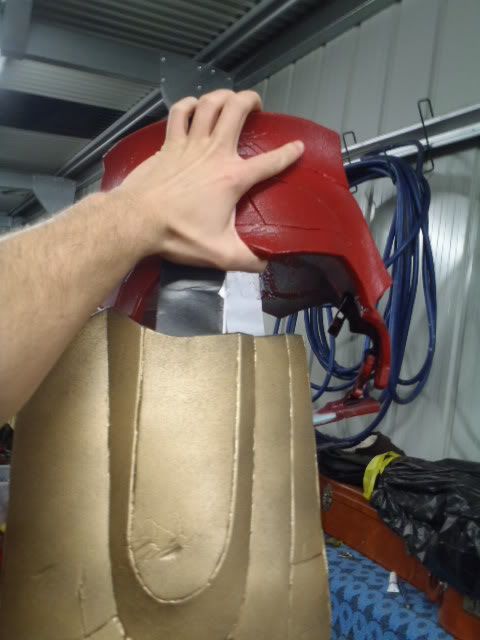

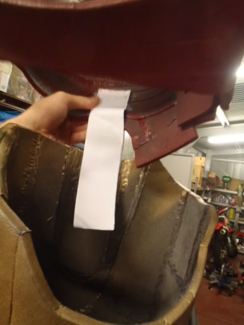

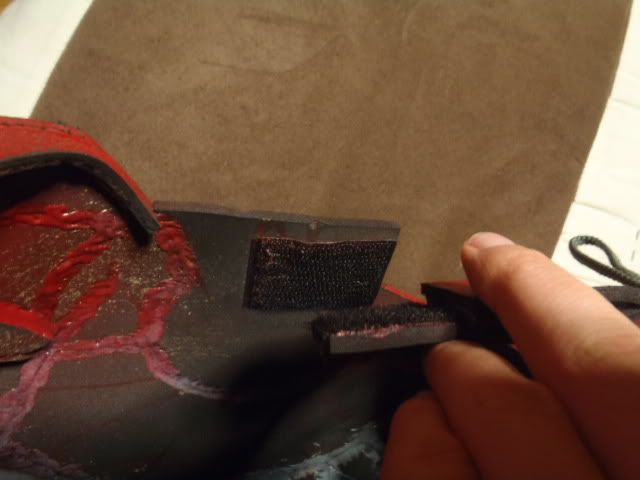

As for getting the helmet on and off, I opted for a very simple method. I just attache one side of the lower half of the (back of the) helmet and velcroed the other. One thing to take note of! Make sure the cotton side of the velcro is against your ear....

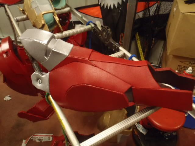

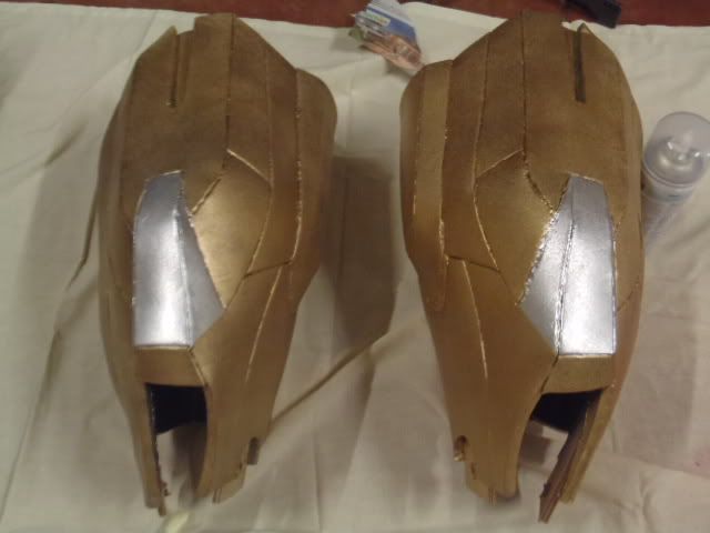

Thighs
Shins
I used the same method, for the hinges, as I did the elbows. About 3 layers of hard cardboard. This was fantastic as I spent about 8hrs walking around at Comic Con and NO sign of the joints giving way.

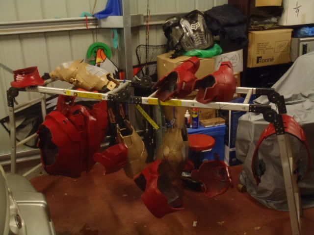

After everything was painted (Saturday night) I realised the paint fumes were pretty bad. "I won't survive walking around in a helmet with all these fumes!" I thought. So I jumped on the net and looked at how to get rid of paint fumes. The most supported thing I could find was to put an onion cut in half near the painted objects and it will 'absorb' the fumes. I figured I'd put one in the helmet.. let's just say the helmet smelt of onion AND fumes. haha
