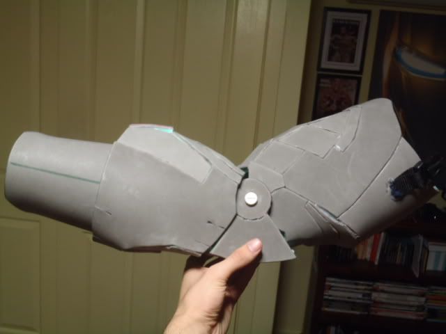

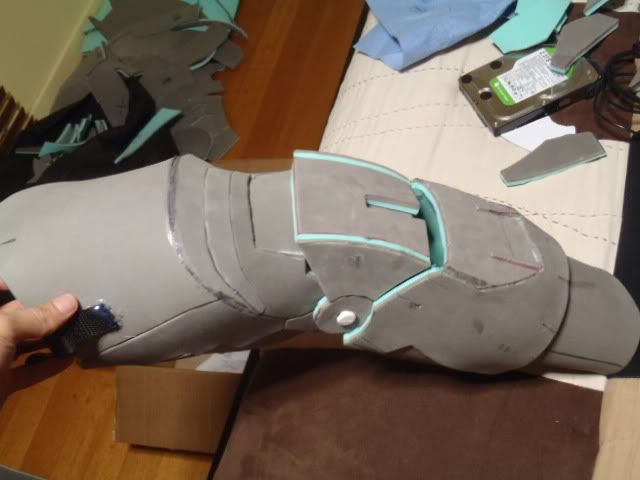

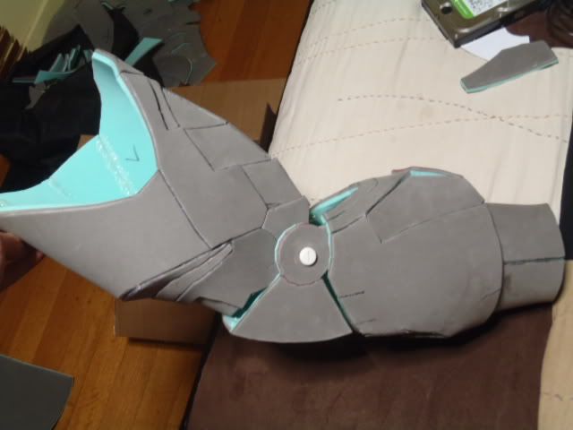

Forearms are complete. They've got some little mistakes but I hope to fill those gaps in during the painting progress.

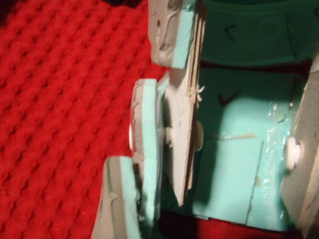

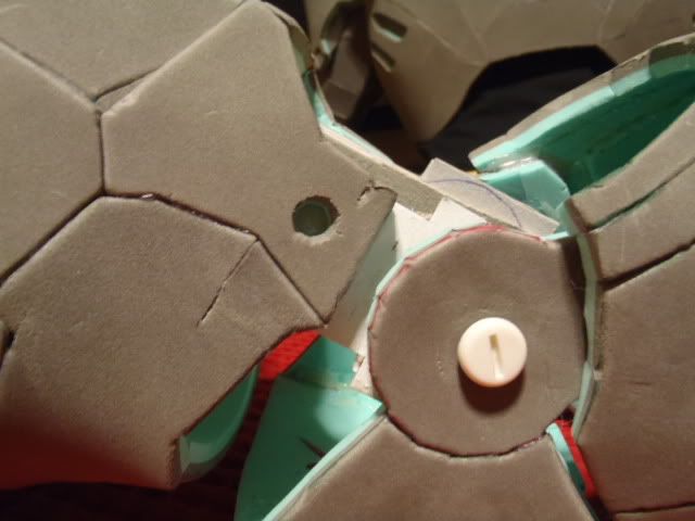

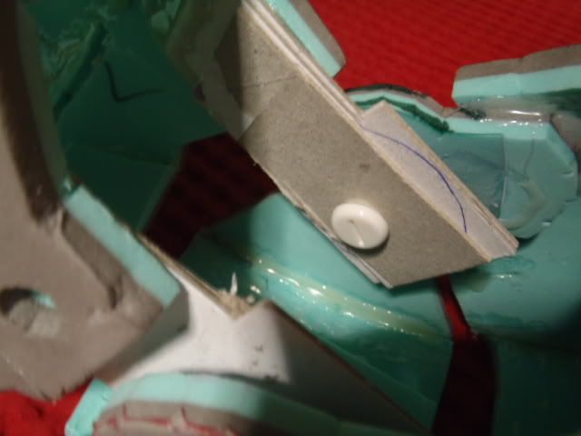

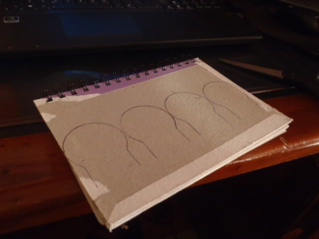

As you can see I just had the 'Chicago' screw going through the foam. This seemed very weak and vulnerable so I was going to have to change it! I saw something Demolition had done http://www.therpf.com/f24/my-ironman-mark-6-foam-build-update-127360/ and I liked it, so I replicated. I found some super hard cardboard (the covers of a notebook) So dense I needed to use chicken bone scissors to cut it and a drill to put a hole in it!
I made the hinge connection 3 pieces thick.
I'll have to fill in the old holes.

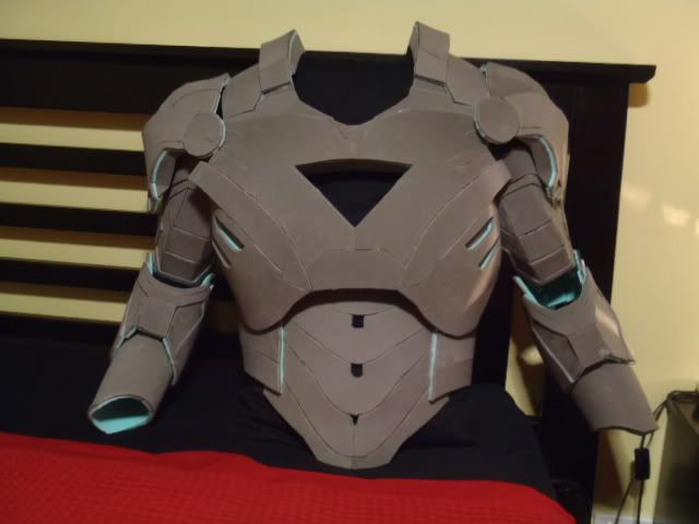

Madrick your stuff blows me away! even before it's primed and painted it looks badass!! I see you've got two different layers of foam in there... is this to made it thick & sturdy and help with and 'oh shxt, which way round does this piece go' issues - or some thing else? I've seen a few of the foam suits done like this...
I've never used a pep file for costuming and foam just looks so much nicer to use than paper/resin/bondo/etc etc (everything on here is incredible though, I'm just very limited on space for building and ventilation
Did you use the foam modded Sharkman files for the helmet I was going to start it last night and when I went to print I noticed some of the lines just didn't stop they just ended, that was on the top back piece (page 1).
Rob, I think that that is just a two toned colour foam. I bought the same mats from Kmart here in Aus and it's a foam camping mat that is one piece but just has two different colours, I guess so you can tell which side to put on the ground or something. Madrick, feel free to correct me if I'm wrong.
It's dual density foam. The grey half is denser than the blue green half

RoblightOHYEAHHHHH: Thanks for the compliment, means a lot. As paradox and tychan mentioned, the foam just comes in two densities (which I was only made aware of after reading the post lol).
