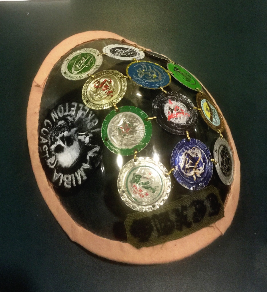

Trickier than it seems. I used a plastic "dead blow" hammer with a face that is a lot bigger than a bottle cap. Hitting the underside of the cap seemed to work better with less tendency to crumple the edge. Drill the holes accurately in one and then use it as a template to quickly drill the others. I hot glued all mine down but, in retrospect, leaving the interior caps free to shift a little would have been better. Hopefully, only you Immortan scholars" will notice I am one row and one column short so as to fit on my smallish pauldron.!
Awesome, thanks again for the info! And yes, hahahah, I did notice that your mesh of caps was only 3 rows by 4 rows, instead of 4 rows by 5, but who cares, it looks great regardless! :)

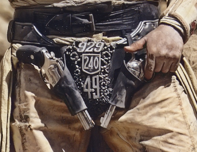

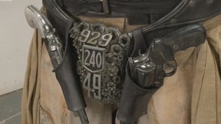

Here's a shot of Joe's guns in their holster:

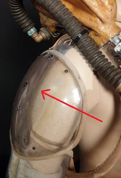

Does anyone know exactly what the strip of metal that's used to secure the bicep armor to the shoulder is called? Is there a specific name, or is it just a strip of metal? Anyone know where a good place to find these would be?
I studied this at length and even bought a strip of aluminum to use before deciding that a piece of leather would work better and be easier. A piece of aluminum tape stuck to the top surface of the leather under the pauldron will simulate the aluminum nicely, I think. Otherwise you will have to shape the aluminum to the curve of the pauldron.
great idea. thanks! yeah, i was thinking that all of the trial and error trying to shape a piece of metal like that would be a real pain in the ass.
Regular Worbla won't take the wiggling back and forth for long, I don't think. The clear might…
