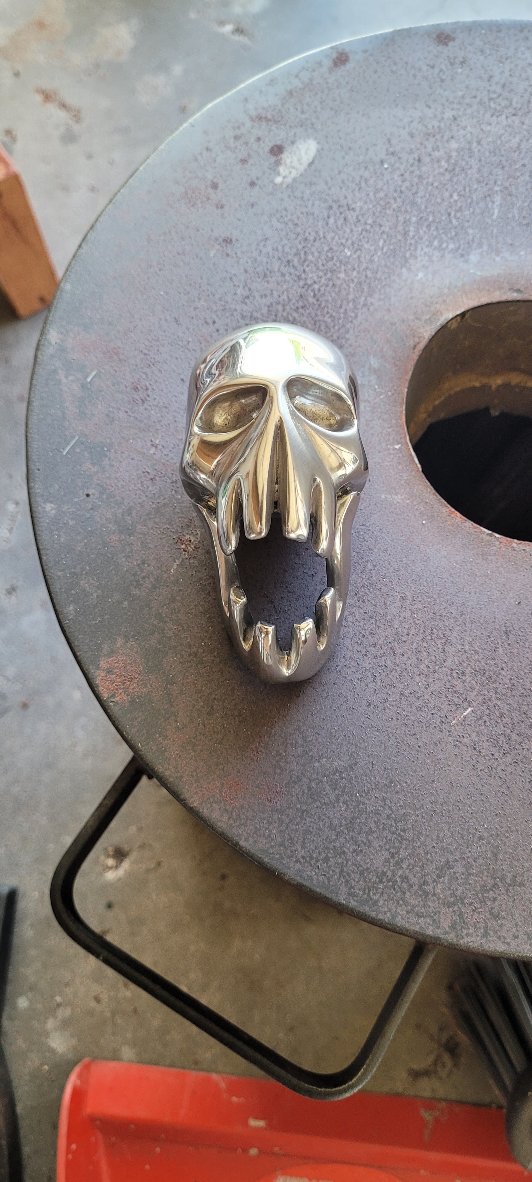

This is the second cast I pulled with some rough cleaning:
Much of the initial sanding was done by hand to clean the surface, and to gauge how far do I need to sand and buff before being able to buff much of it out on the lathe. I don't have much in way of powertools, so use my polishing stuff in the lathe when I can.

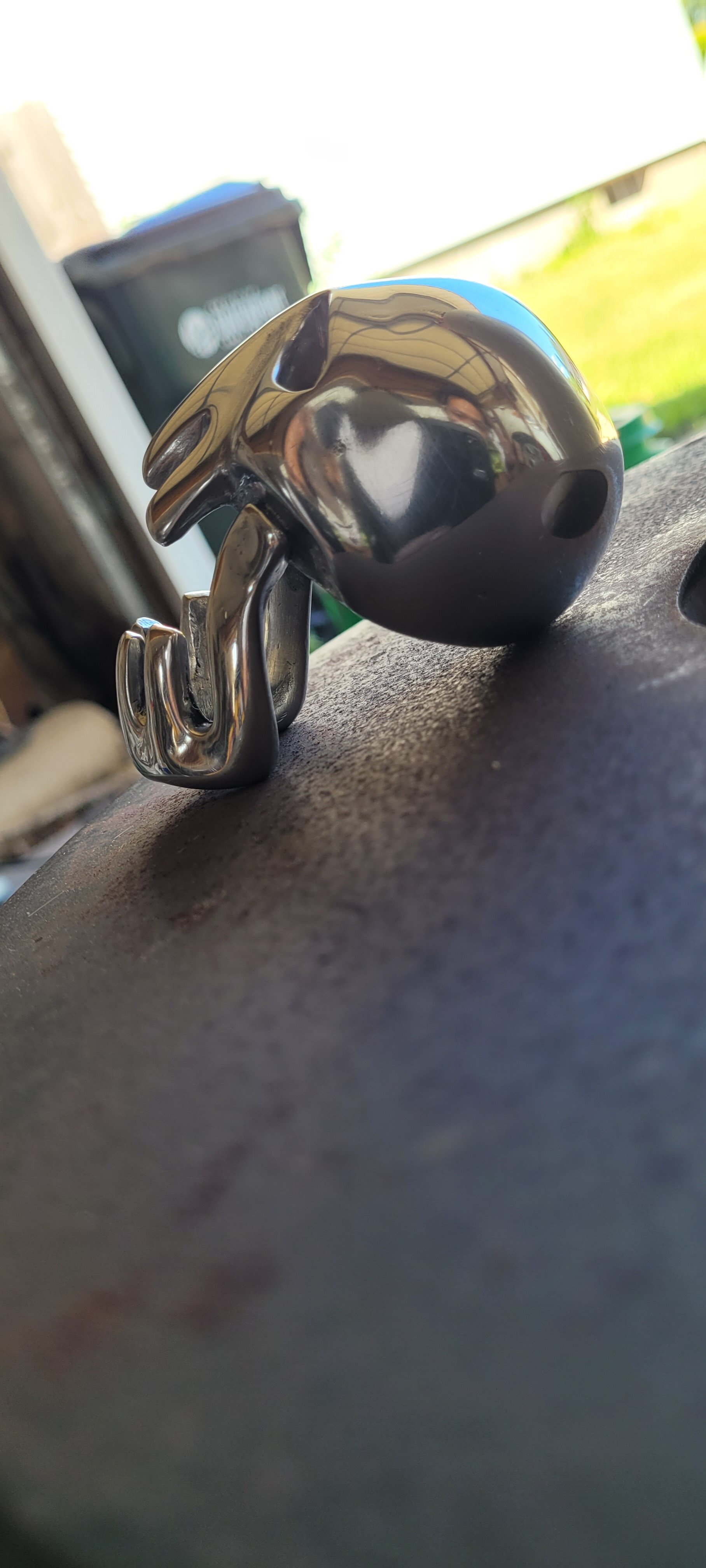

It took three days of trial and error figuring what to do first (Eyes and mouth!) but this is where the shift knob stands currently. I'll need to get an m16 tap and die set to get it actually be usable as a shift knob. Again, much of this clean up work was done on the lathe but in order to get it to the high sheen that it's at now, I resorted to use marine polish and a terry cloth. The inside of the eyes and gaps in the teeth were the trickiest thing to figure out how to do on these. It finally took all the small felt tip attachments I had, and a lot of steady engraving work to get them to where they are now.

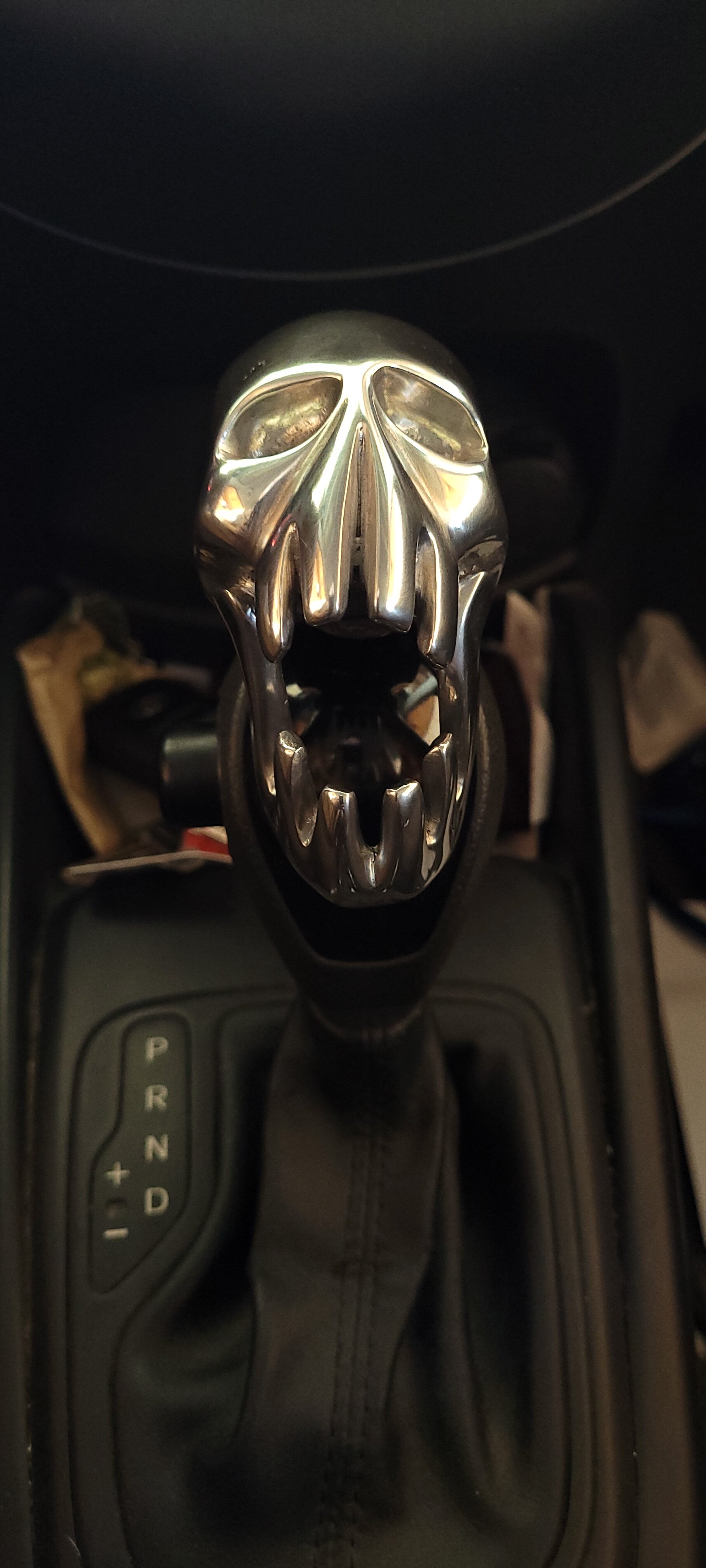

I'm very pleased with where it's at right now, especially after all that time sanding and polishing, even if a number of details were softened to some extent by the work in getting it to shine. I wish I could clean more of the undercuts around the jaw and inside the mouth of the skull but I don't have anything that could do the job without risk maring the rest of the skull. The knob, unfortunately, doesn't work with my car (as it's an automatic), but I'm thinking of some custom stand that I could specially make just for this to display on my desk.
