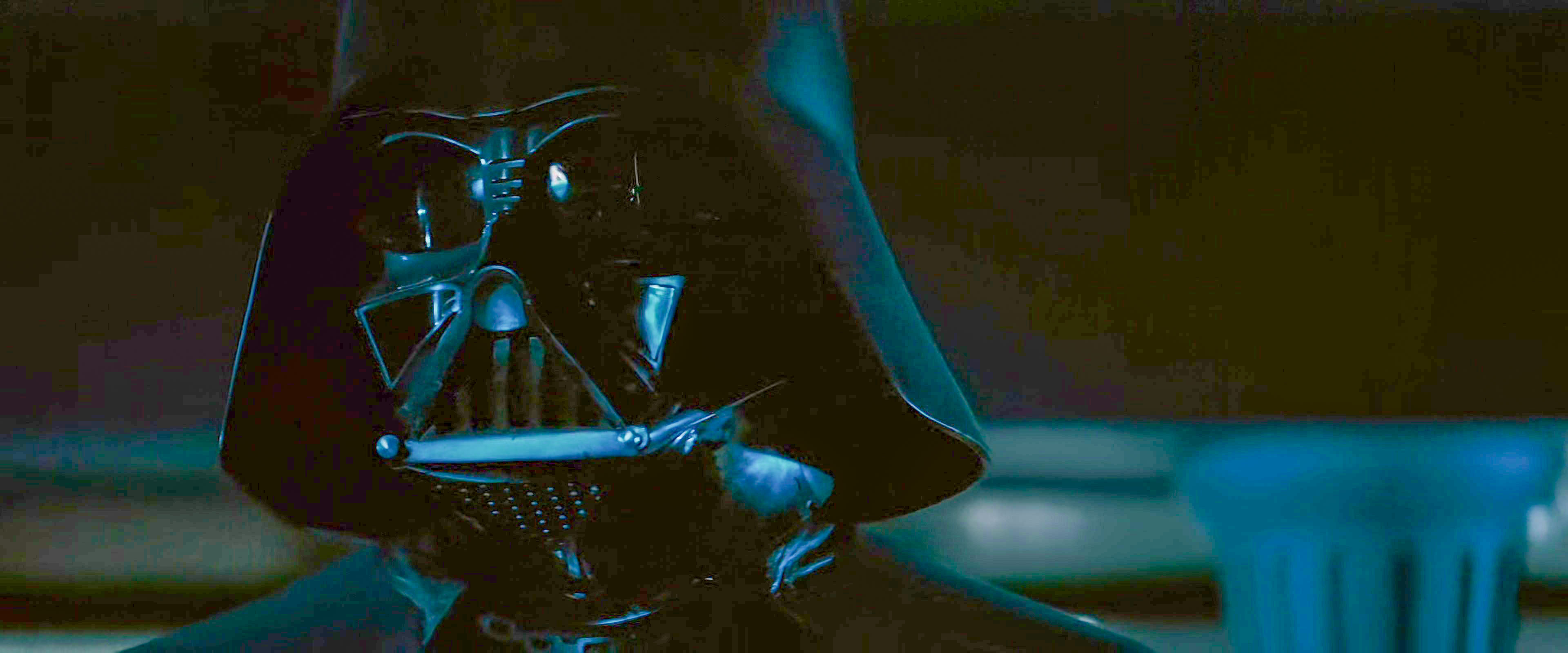

Did the rotj stunts have the clear plexi glass sections in the front like the ESB one had?
Yes, the transparent inserts on the cheeks can be seen right here. A couple of screws to hold the perspex on the neck are also visible.
