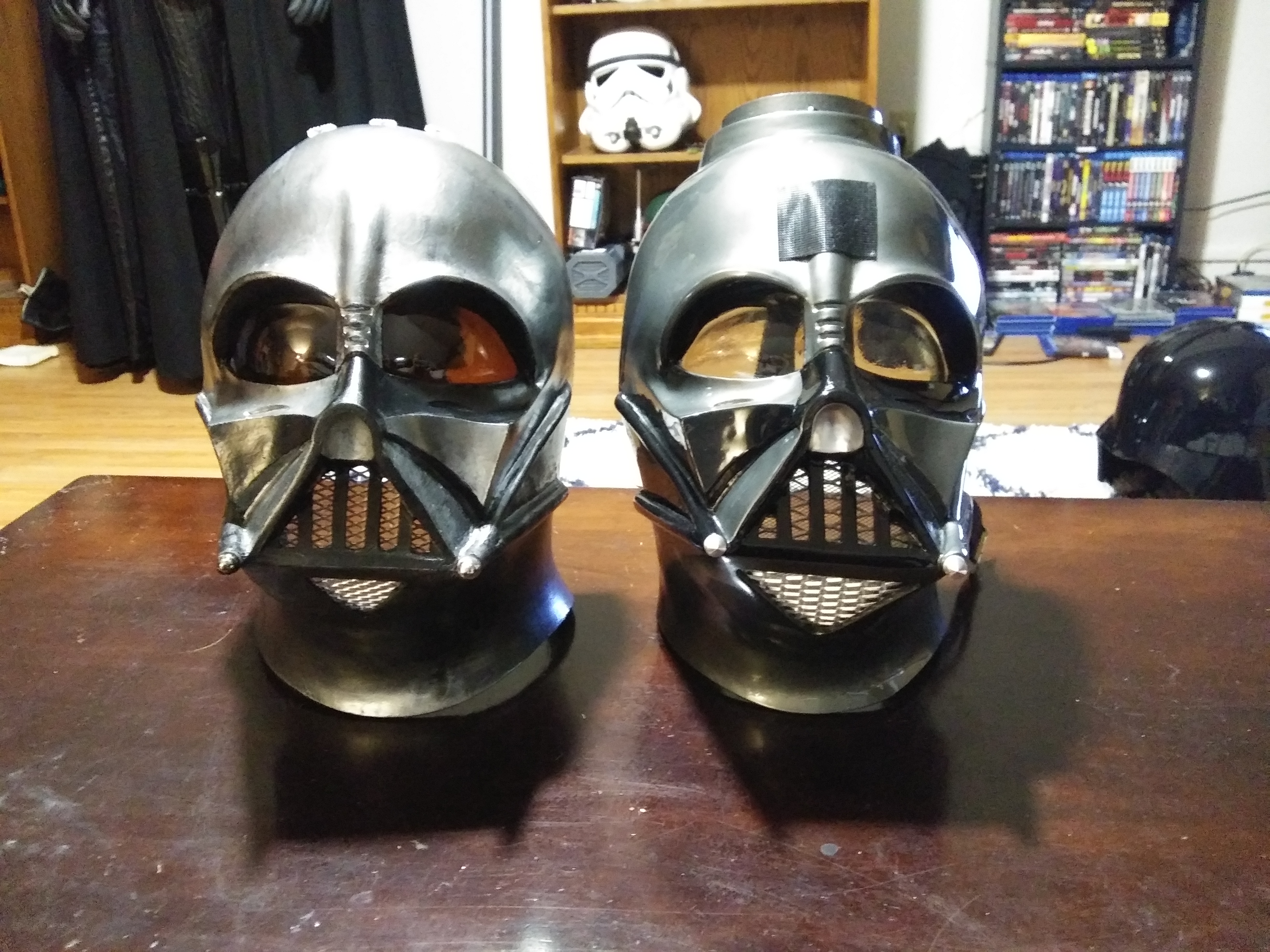

Yes the GS and SL match in geometry. The SL is a direct copy of the og while the CFO(GS COPY) comes from ESB production molds that have suffered the slight shrinkage.
Before the GS surfaced it was believed the changes to the dome were due to recasting and cleaning the molds. But we can confirm the ROTJ Dome existing during the production of ESB. So I'm not sure.
Interesting by looking at those authentic casts side by side one can really see the difference between anh face plate and Rotj
If I eyeball it the ROTJ face looks more like it is pulling to the right side is this part of the shrinkage that happened while molding during production
I can see the features of the ROTJ seem smaller yes over the ANH
The ANH eyebrows seem not as deep as the ROTJ and the outer eyebrows seem to slope at a higher angle if I am making sens
But yes there are simaler features and yet also great differences it is my assumption that using an perfectly cast ANH helmet painting it gloss and widening the chin vent to ROTJ size and sticking a Rotj dome on top will not give you a perfect ROTJ
If one wants a Esb or Rotj from an ANH one must replicate what happened to the molds as it went from Esb to rotj

Don't forget that both masks are not viewed at the exact same angle.
They pretty much match in shape.
