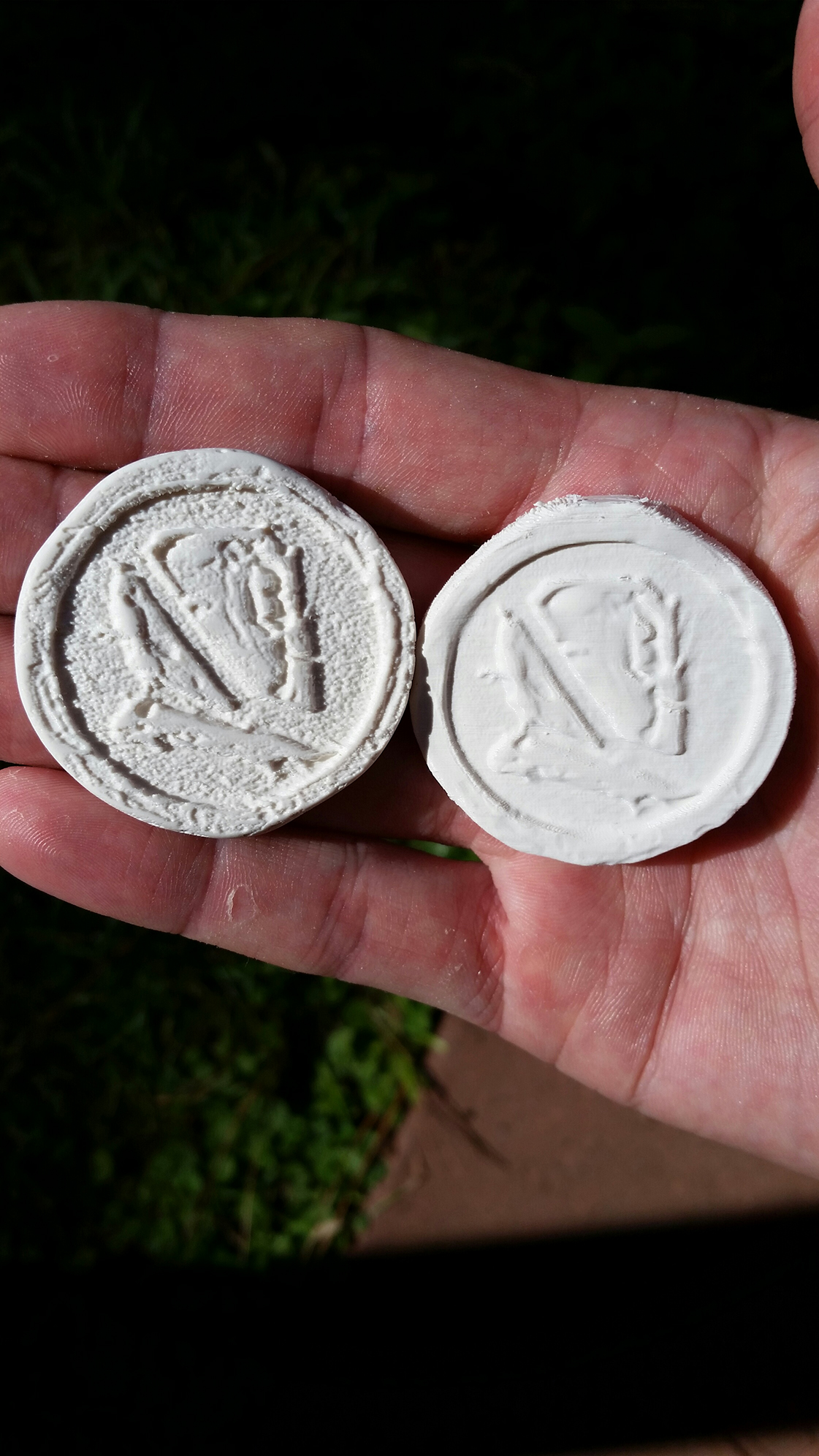

Here I have the coin printed with the dents exaggerated a little so they will so up in a mold and print well as the first version most of the detail dents didn't show up as well.
Re: GAME OF THRONES -ARYA STARK'S Assassian Coin - god of many faces
Mold is poured for the exagerated detailed one...now we wait :) I'll pour the mold for the non exagerated detailed one when I get back to the house, Fathers day, and being one my-self I have some errands to run lol. The only resin I have on hand at the moment is some ultra clear...I might mix up a small batch and try to pour one overnight just to see how the mold does. So what did you guys think of the colorfabb metal filaments? They are 80% by weight metal and thrown in a tumbler I've seen you can get some nice results..still might throw a clear coat on them just to give it that gloss...we'll experiment to see what yeilds the best results. I don't need a mold for the colorfabb metal filament option, but I made the moulds to pour metal in so we have both options to see what looks and feels the best.

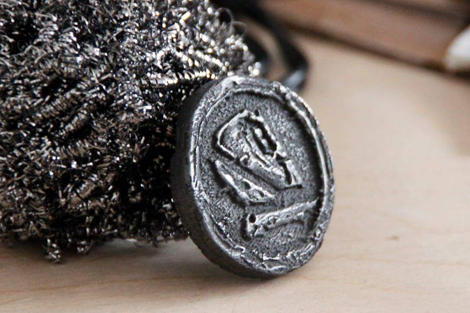

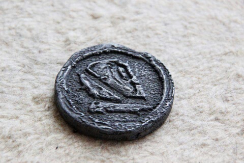

Ok, so here is a test done with stainless steel filament and about 40mins of hand sanding and polishing with steel wool...so far I think the results are looking awesome! and it has a nice weight to it too. Still going to try out the other metal filaments, bronzefill and copperfill, but I like the results so far. Mold is almost dry, I'm going to inspect it here in about 30 mins. Making progress :)arya_coin_stainless_steel1 (2).jpegarya_coin_stainless_steel1 (1).jpeg

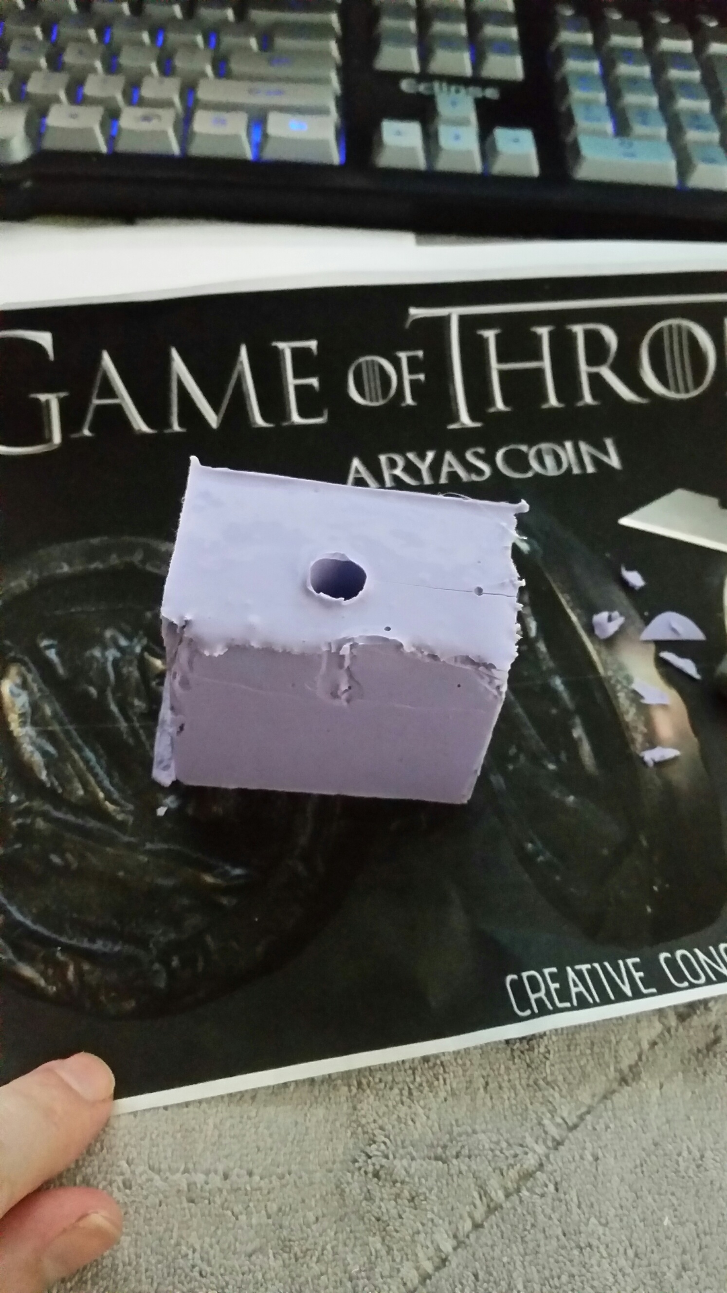

Here is the mold for the coin just in case we go with the melted metal option anyway; although I might have to make another mold with a different silicone, because I think this one is rated for 400degrees and I believe the melting points for bismuth and pewter are around the 500-550degree mark. Mold turned out good though.aryacoin_mold.jpg
