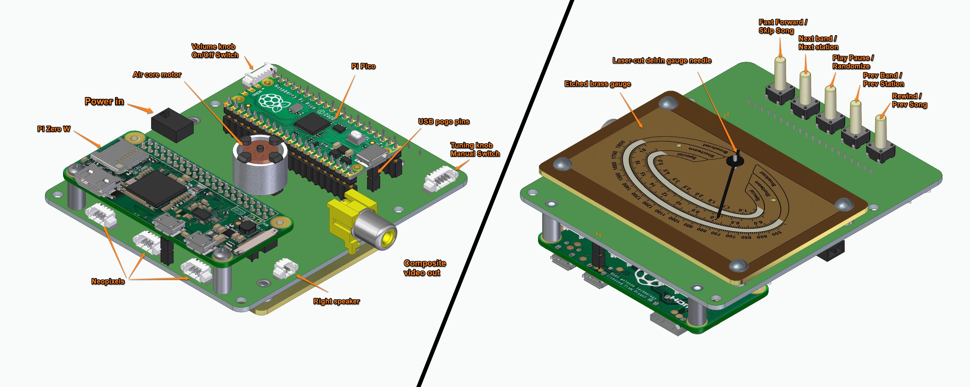

For example: Today I worked on the PCB design. I had an issue I needed to work out fully. The Pi Pico and the Pi Zero will talk over a USB connection. I could use a cable to connect the two, but why do that when they are both on the same PCB, and both have pogo-pin pads on the backside for the USB. But I had to find a pogo-pin that would work. The pads are just 1.5mm apart, and so I couldn't use any larger pogo pins. I mocked up various pogo pins I available on Digi-Key, but I ended up stacking a 1x2 1.27mm pitch pogo pin header, on top of another 1x2 socket to get the 10mm of height required. While doing that, I also selected all the headers for the rest of the board.
Also note that the motherboard design is all self-contained including the gauge. By using SMT stand-offs I can have everything needed for the joined to a single board, instead of having to be stacked inside radio. This should make any final tweaking easier.
