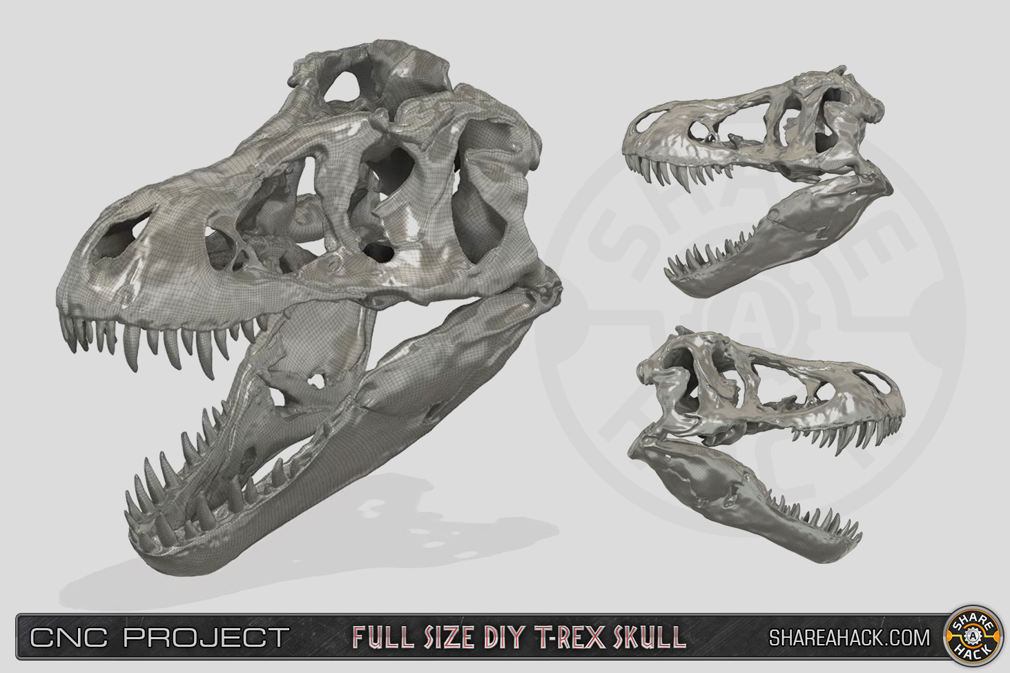

With winter coming up fast I decided to go full steam on the T-rex skull project since most of the work has to be done outside. Here's a quick update on the progress of the skull :)
Here is the scanned 3D model I'm using of what I believe to be the T-rex "Stan" fossil discovered in Buffalo, South Dakota by Stan Sacrison:

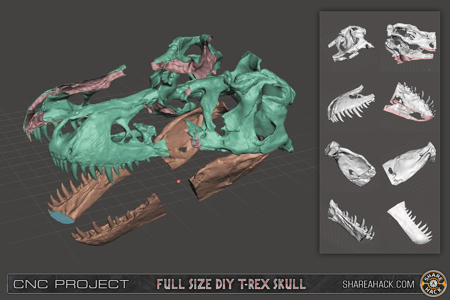

According to the Black Hills Institute, the real-life skull has the dimensions of 58" L x 33" W x 68 1/2" H. (approx. 4.8 feet wide) and I really wanted to make mine match the full scale of the original. Because of this I had to chop the skull model into 8 sections so I could work manageable sections on the CNC router (the router can only work with objects inside of a 2' x 4' work area with a depth of approx 4"):

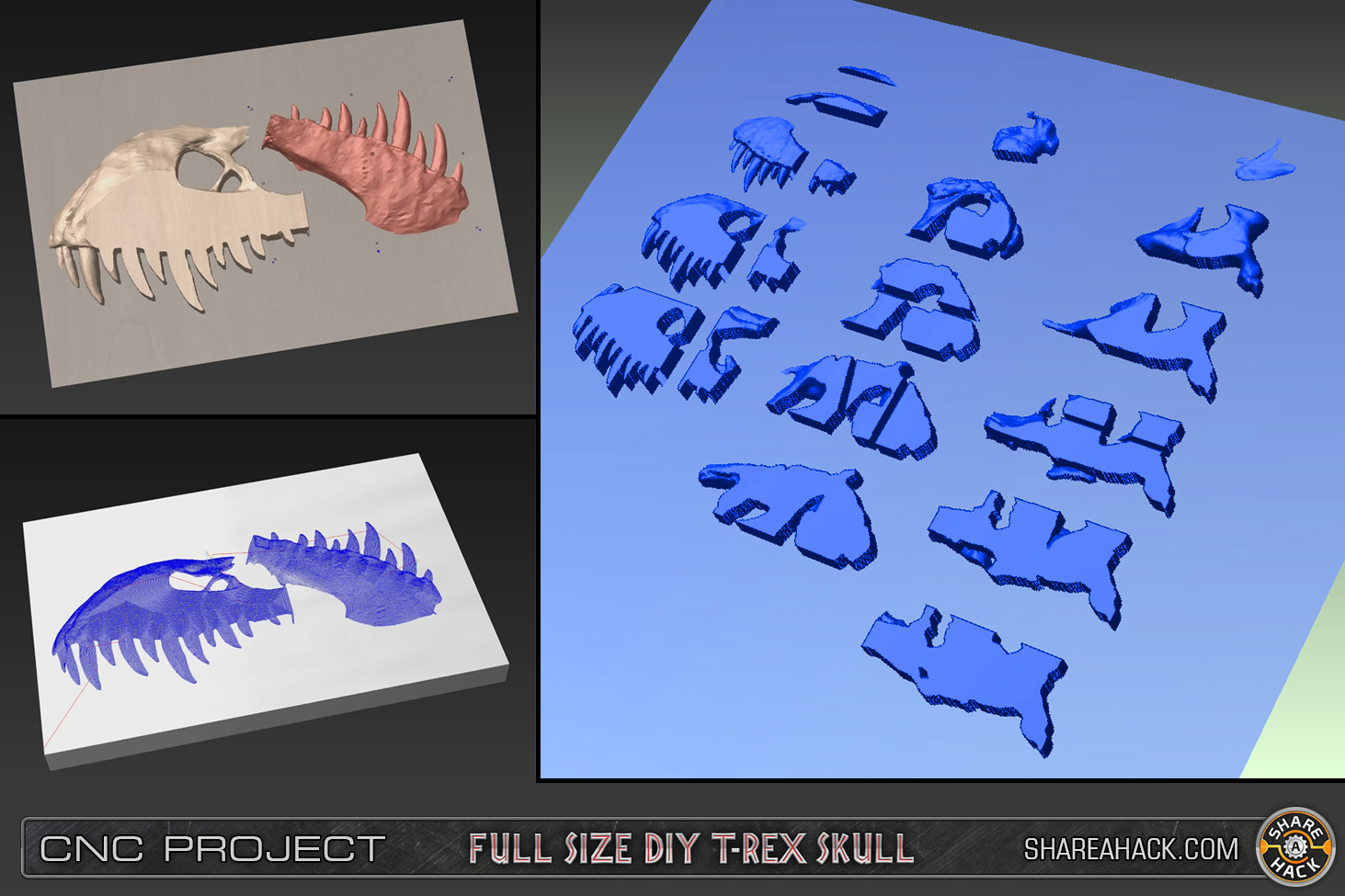

To make these 3D files workable on the CNC machine, I "sliced" them up into layers to match the depth of the pieces of foam I had (3" inch rigid pink insulation foam).
For just the TOP LEFT half of the skull, it took about 5 pieces of foam and a ended up creating a jigsaw puzzle of 25 pieces:

Hi, this project looks awesome. Can you please advise what software you used to slice and layout the slices here? Thank you :)
