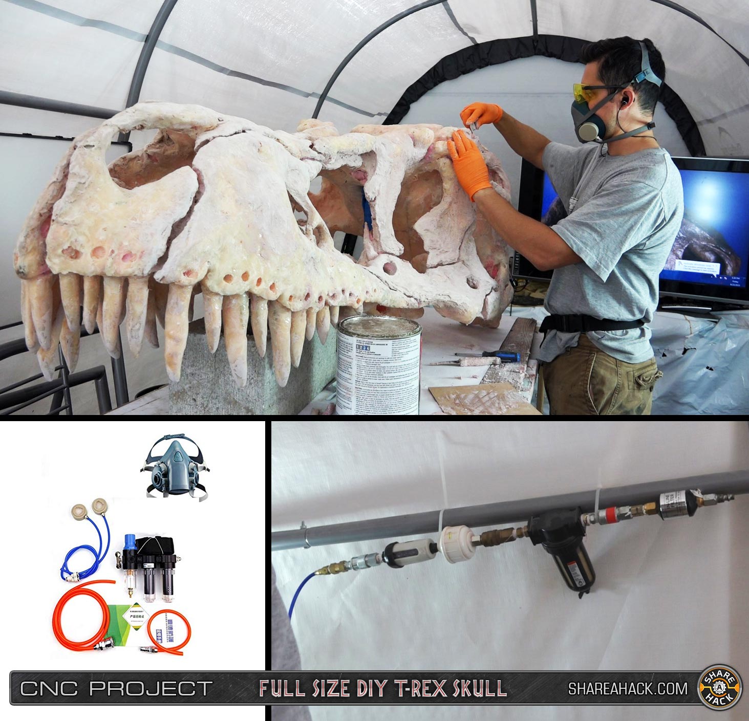

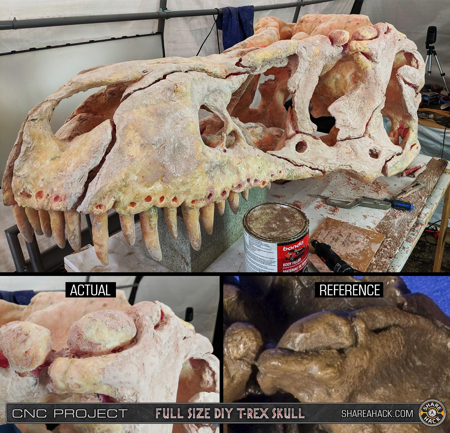

I'm still currently in the 'obsessive detail' stage trying to match up holes and imperfections on reference material. I feel like if I've come this far I might as well put the time in and get it as close as I can. It's a bit tough working with Bondo due to the bottlenecks in mixing, work time, cure time, sculpt time. You might only get to finish a single feature in an hour if you're lucky.
Also got a nifty remote air supply feed doohickey that feeds me air from the compressor in the garage. I'm running the air through about 3 different water/oil separators and a desiccant filter to make sure the air is breathable. Even with 3M organic vapor cartridges I was still 'tasting' the fumes. I tried out the respirator yesterday and its a little air-hungry but totally worth it not breathing in Bondo for hours at a time. It plugs into standard 3M cartridge masks.

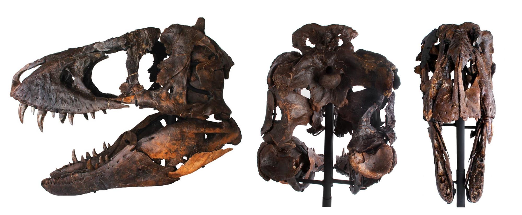

Once I've got the larger details/shapes done I'll focus on subtracting depth from the walls of the skull to give it a more fragile appearance. Nothing too crazy but something more along the lines of this actual fossil:

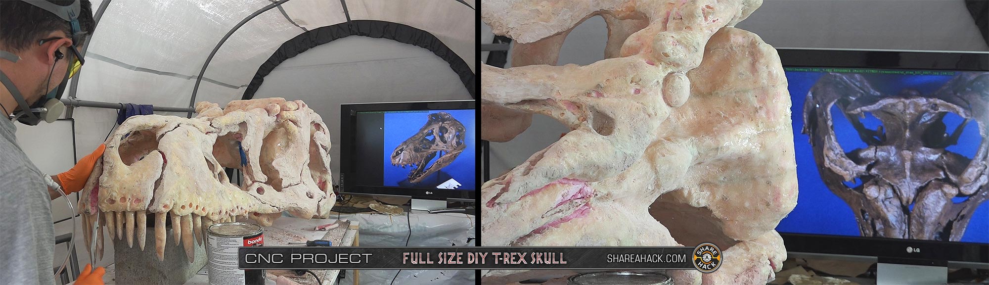

Another thing that has massively helped is this cheap/used 720 42" LCDTV that I found for $50 on Kijiji. Compared to the laptop I was using before it's been a game changer in productivity for displaying well-lit reference photos.

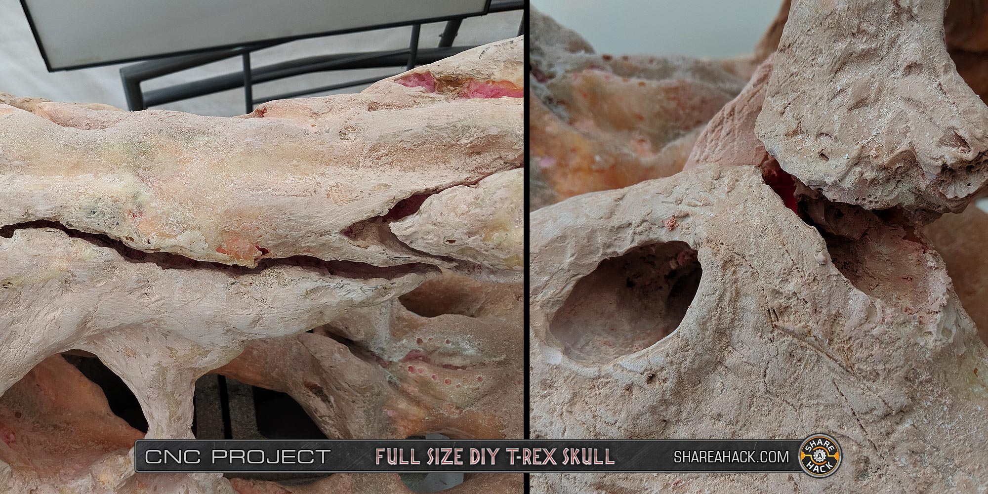

An interesting unexpected benefit of initially fiberglassing the foam is the ability to create awesome depth in the skull sutures by spraying a bit of acetone in the cracks and melting the foam down. There's no loss of integrity because the fiberglass shell more than rigid enough.
