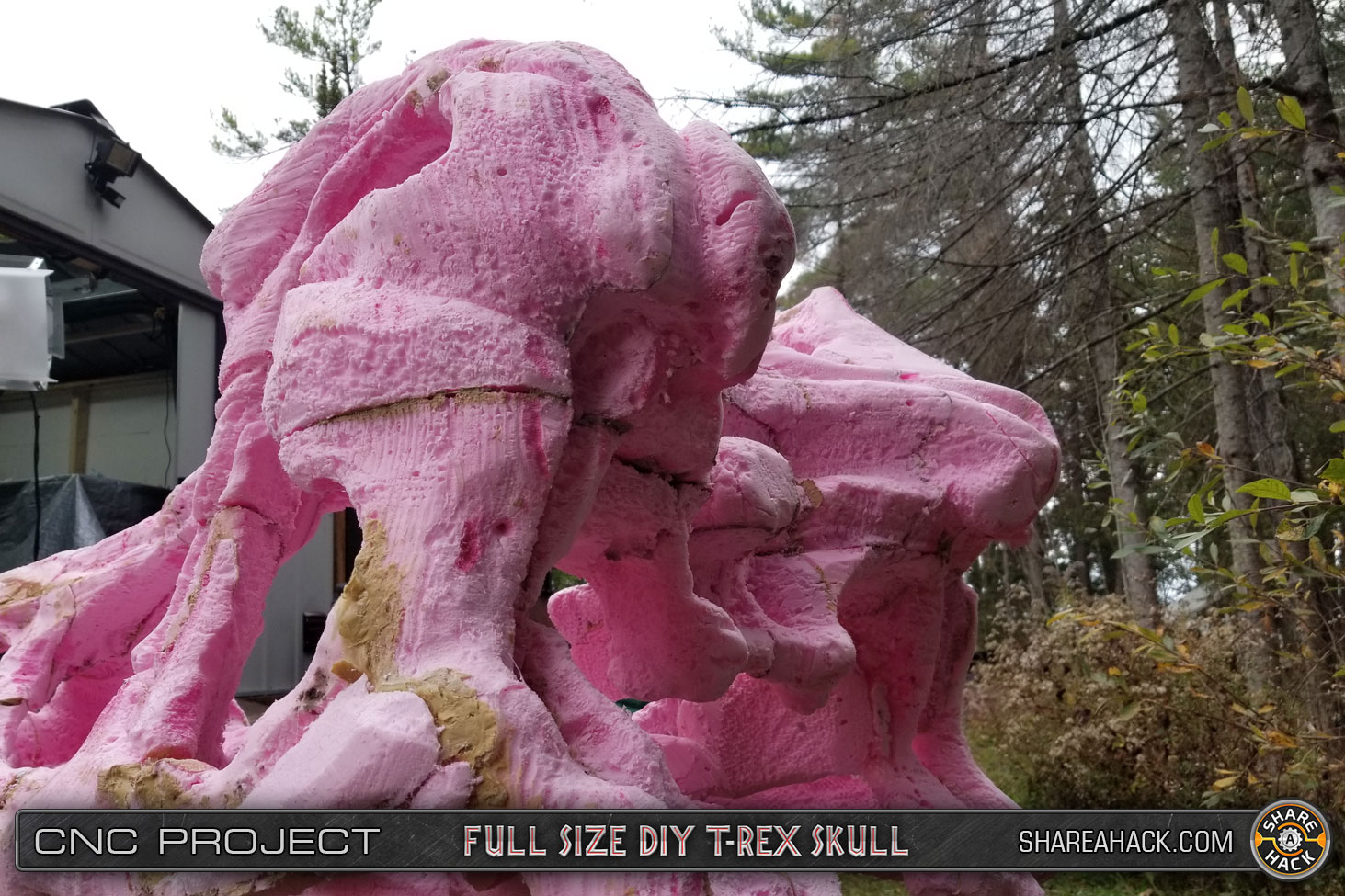

Spent so much time this week manually carving out the internal structures...skulls are weird shapes and a lot more work than planned getting the details right.

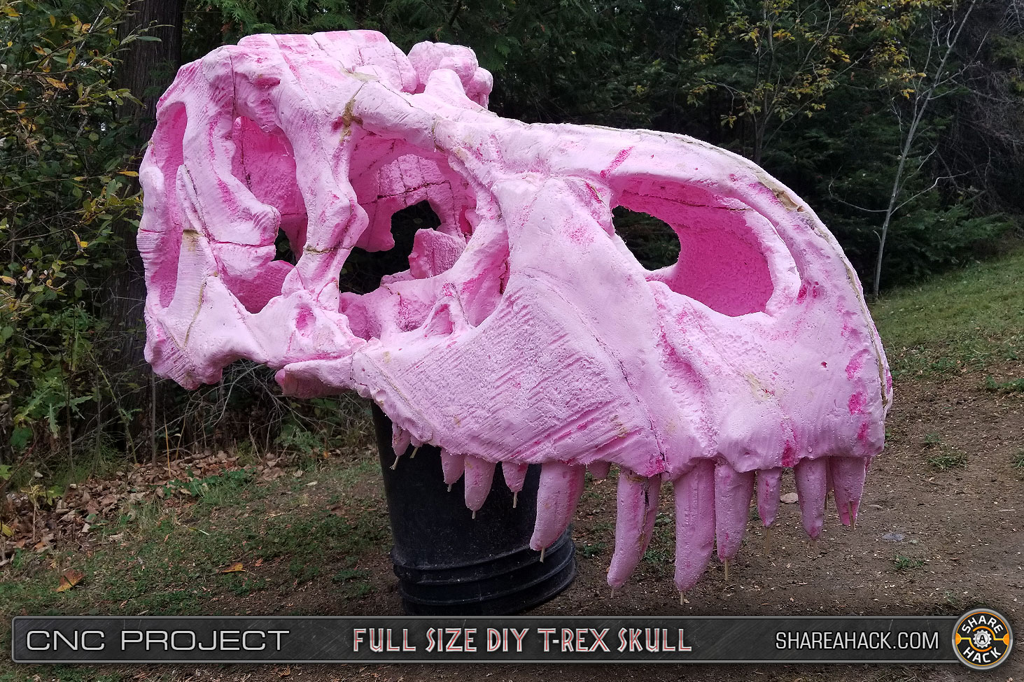

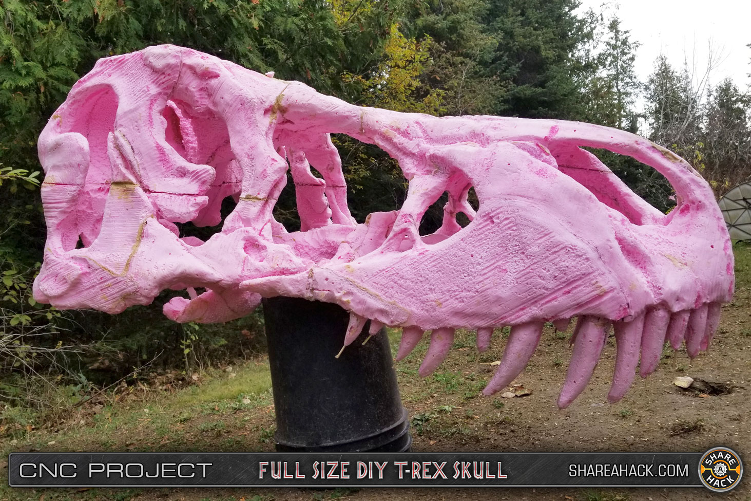

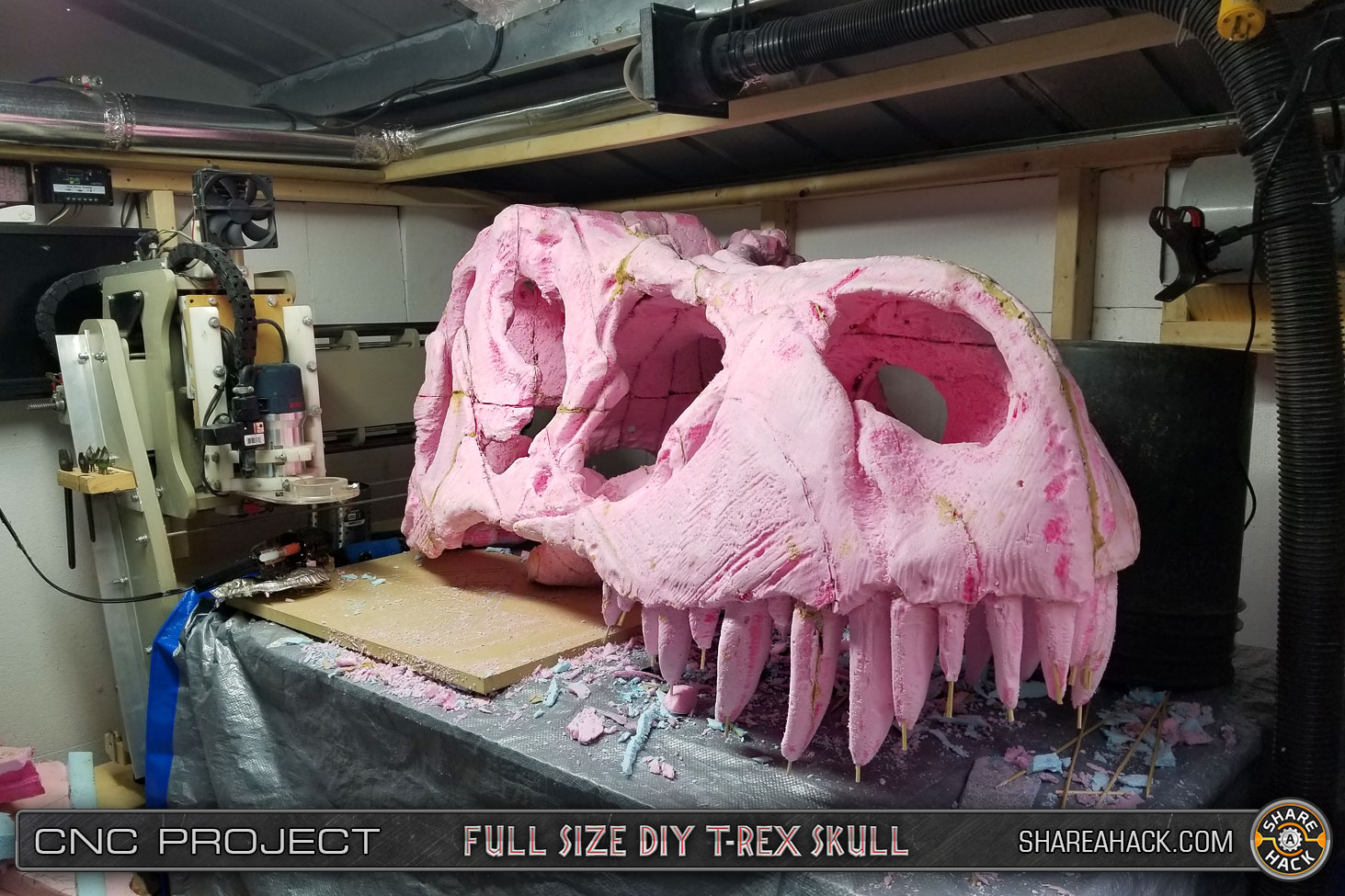

Finally finished carving out the internal geometry of the top part of the skull (took way longer than I thought!). Had to cross section the 3D model and really analyze the internal structure to slowly match it to the foam section by section. Used a combination of serrated knives, box cutters, a die grinder (air) with a rasp bit. In this photo the 4.8ft skull is sitting inside the 8'x10' CNC shed (kind of a snug fit in there right now lol):

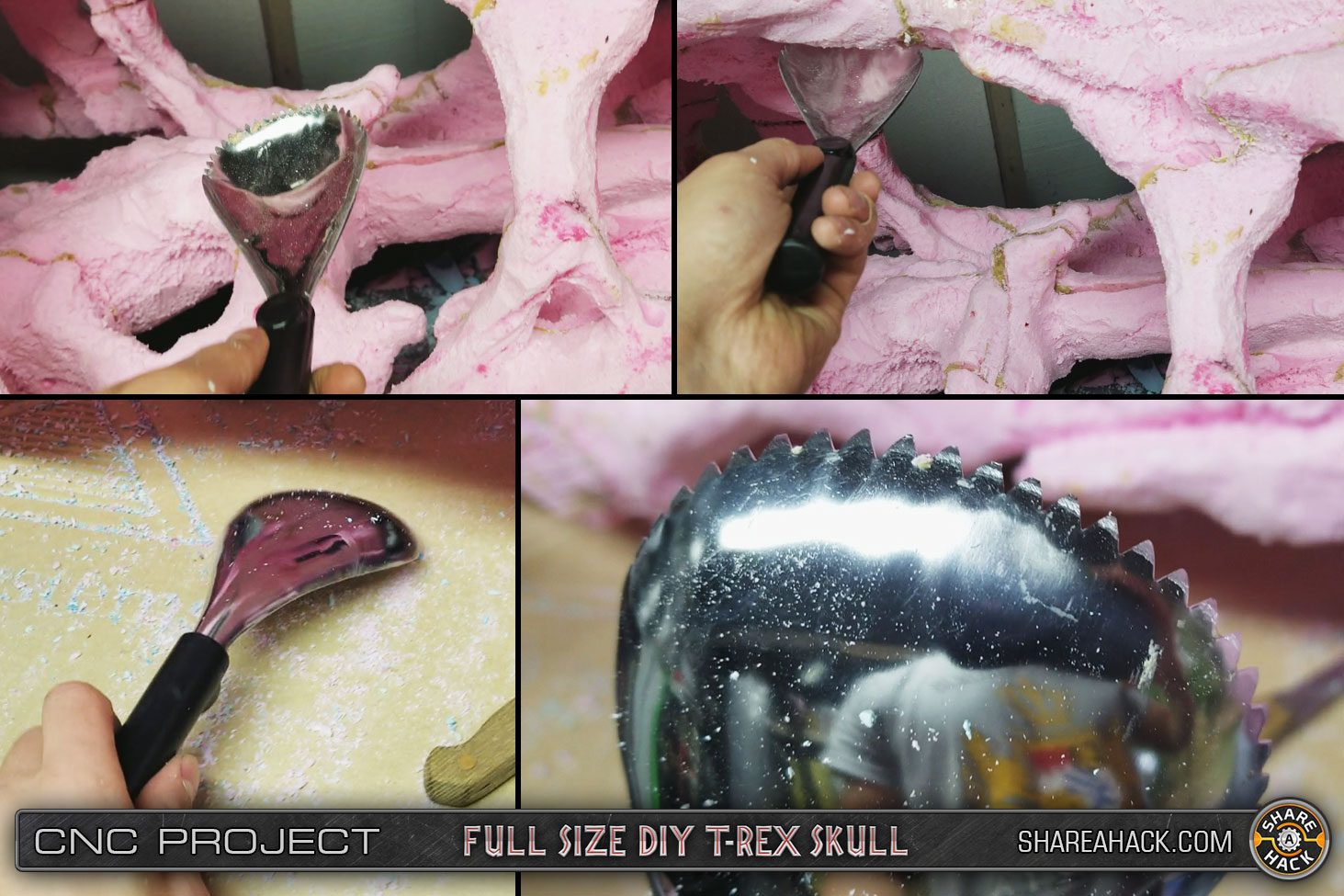

Surprisingly this was by far the most useful tool that I came across by chance. It's a pumpkin scooper that I found at the dollar store. I sharpened the serrated edge using a grinder. Really helped to remove inside material fast in the hard to reach places:

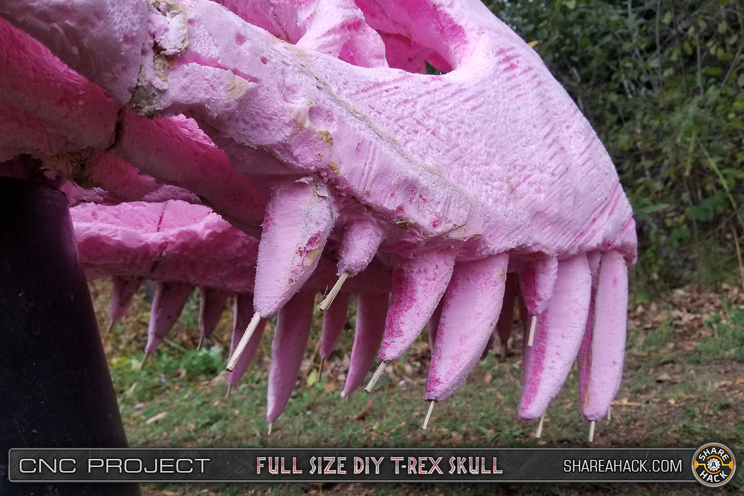

Had fun shaping the teeth! The final teeth will have the serrations on the back edges (will add after fiberglassing):
Apparently T-rex's teeth were the size of bananas. Theory confirmed! :lol
BBQ skewers added for reinforcement:
