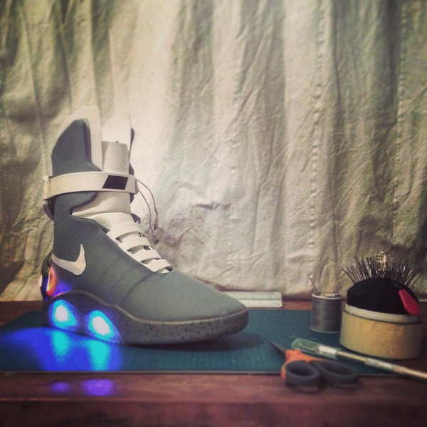

Ok guys, I've started a new Mag project ! This one will be All Black too, but I'm going to make it closer to the RD shape.
Now that my first project had helped me understood a lot about how to build shoes, I think I'm good to go for a real wearable pair of Mags.
This first project isn't really finished as it is not glued to the soles and I haven't put the decals and the swoosh but it is for some reasons :
- I want to be sure to glue the right shoe on the soles of the HCs (because of the price of them)
- I can use this project to improve some details
Yesterday, I've walk with these shoes (by fixing them on the soles with a velcro strap) and I found them pretty confortable.
The feet enters in good but when you exit this shoe, you need to be very slow and carefull. It stays in good shape and when on feet I was amazed of it being so close to the Movie props when seeing them on some angles...

the fabric is Spandex on the visible side. Inside is a random black fabric that is harder and does not expand.
Beetween the 2 layers, I've insert a layer of 1mm eva foam. (This time I won't add another foam layer. it is better for the confort but I just to see how it looks and feels withuot)
This project is really another test version to see what and how to improve the next model i'll do that will be based on the RDs.
No pattern here, I've reused the shape I did used on the first one and tweak some details. But you can scale the pattern that cavx gave me on the first or second page of this thread. It is the RDs pattern ;)

I've finished the build up of the second shoe andfinally added a layer of foam for the comfort and solidity (as I did on the first Black Mags) and made the ears holes.
Next step is to place the laces or start the ears and attach the tongue and I'll be good to go for a test walk :)
