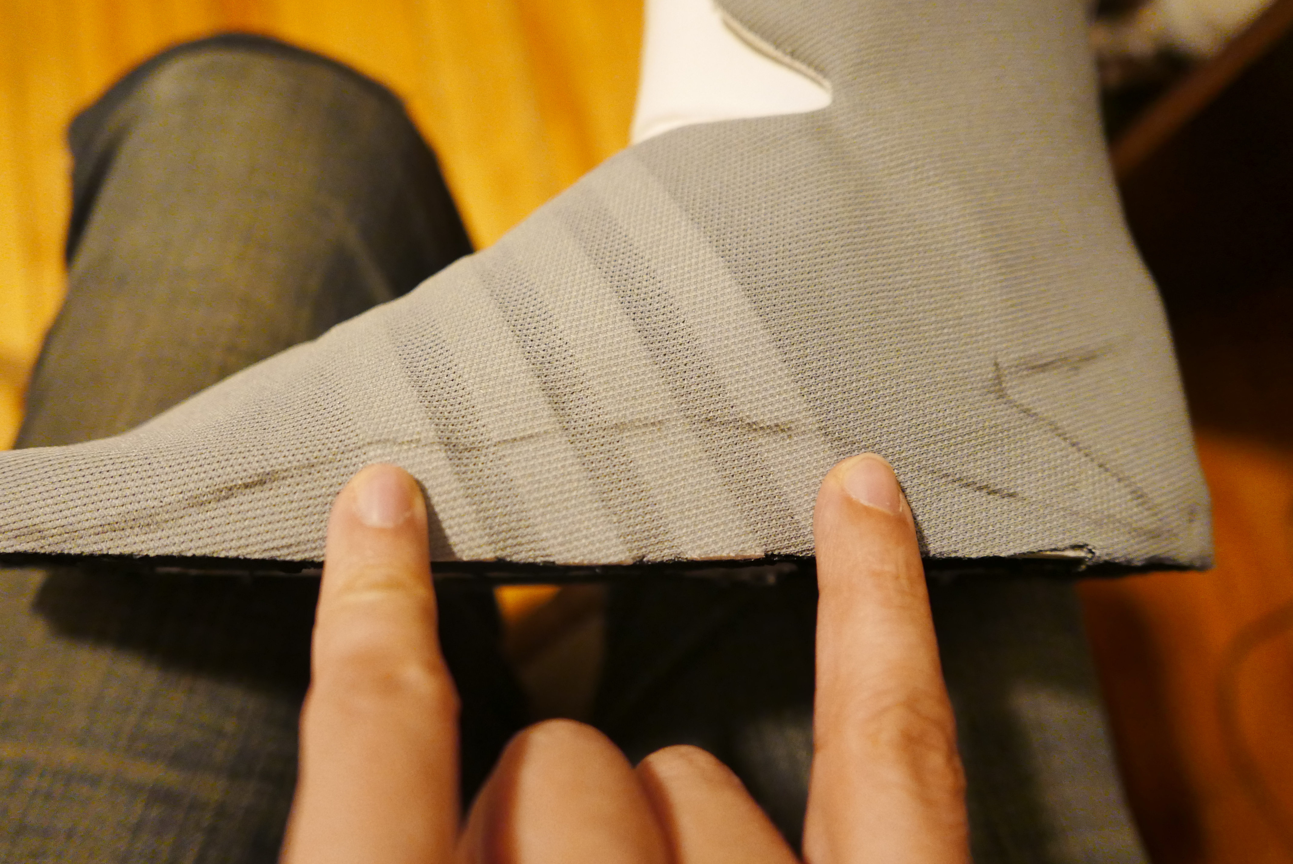

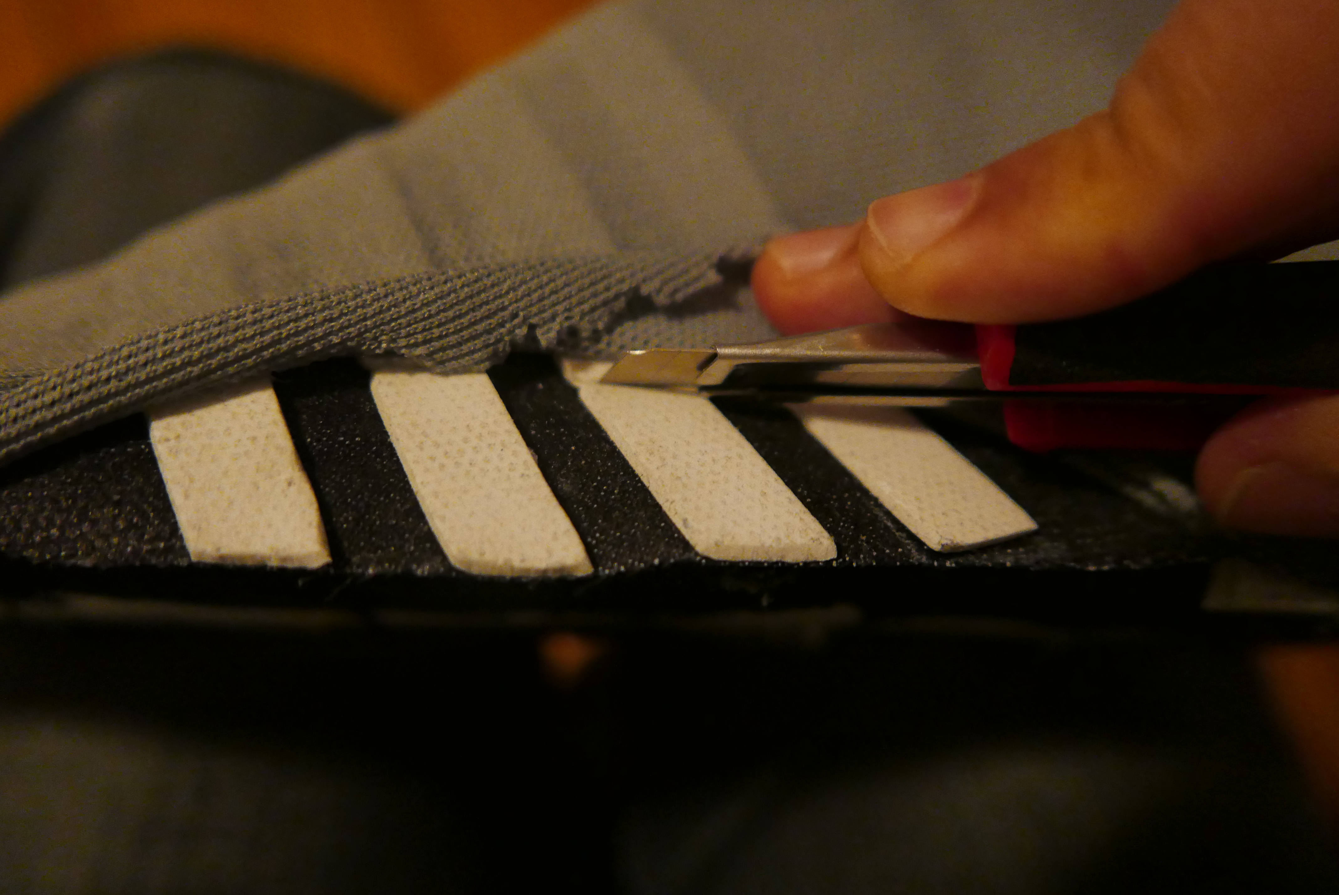

Then, I cut the excess fake laces on the side so it won't get too bumpy when I'll glue them to the edges of the sole :

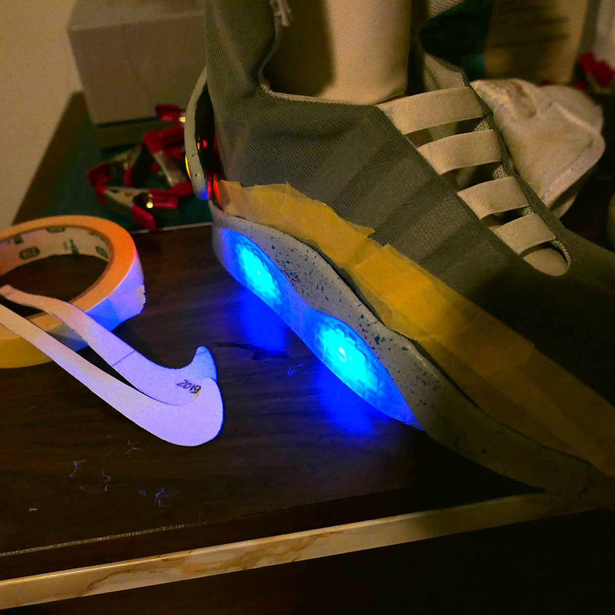

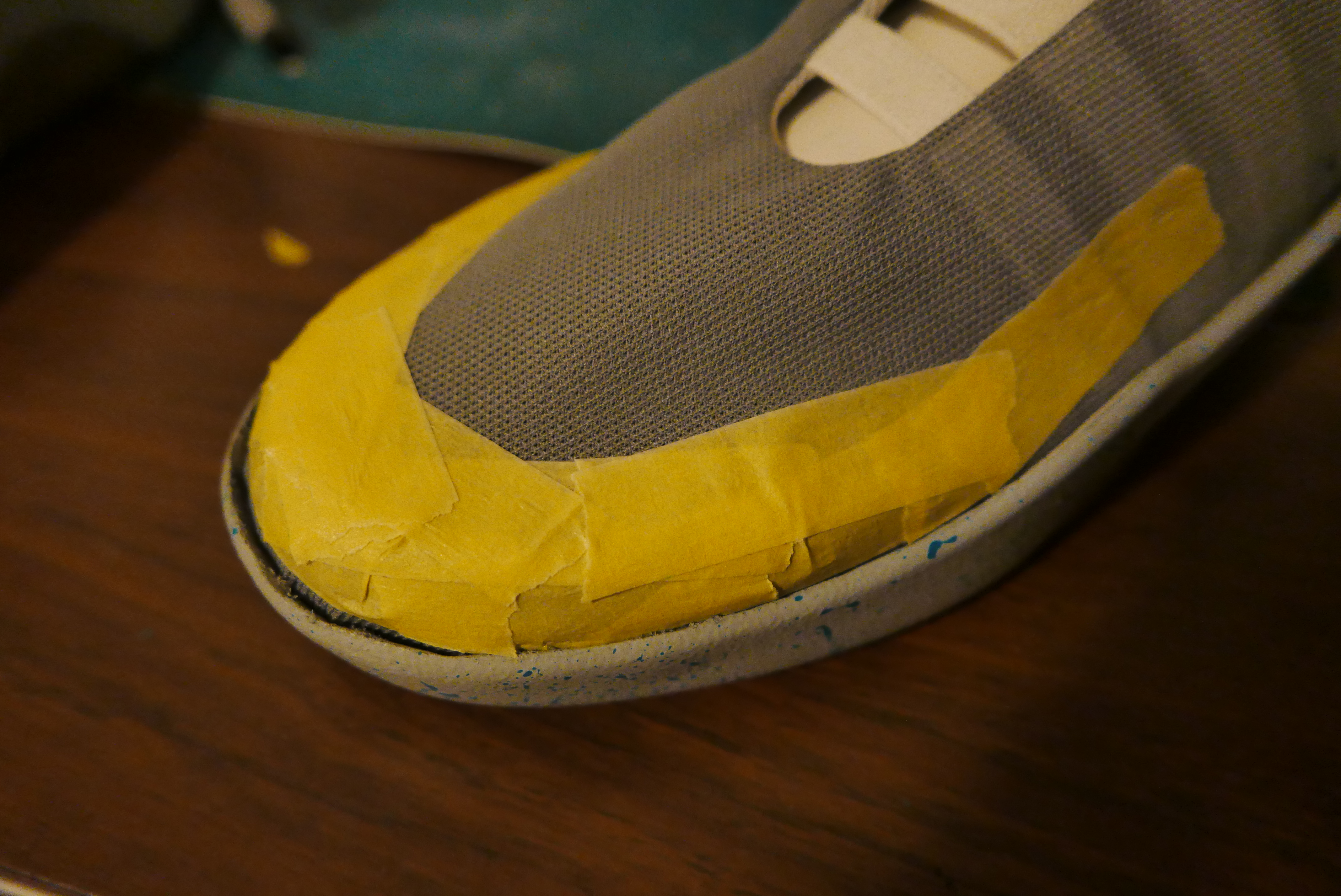

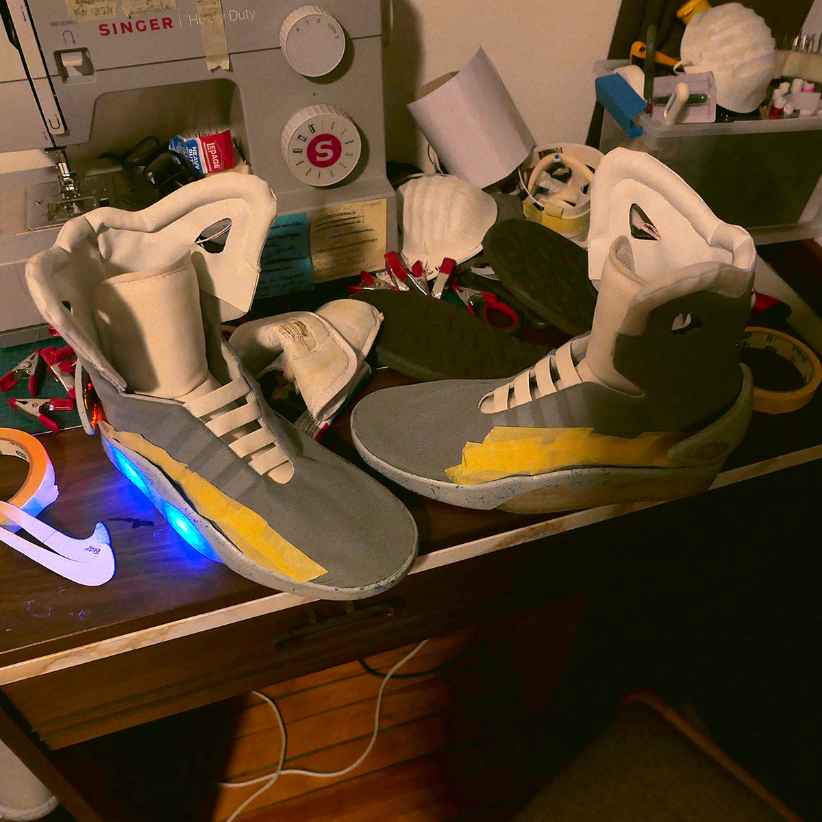

And to finish, I use masking tape to make sure the upper edges are protected from some excess glue :
At this stage, I only glue the rubber sole onto the whole edges and all the bottom of the upper and only the marked edges on the upper fabric :
Next is let the glue dry for few minutes and get the upper attached to the soles
»»» Little tips : apply some hot air (from an air dryer for example) to the glue just before attaching everything together. This should reactivate the glue and you should get a better bond in less time ;)
If everything is fine, tomorrow i'll get to finalize the edges and this pair will be good to go on feet :D

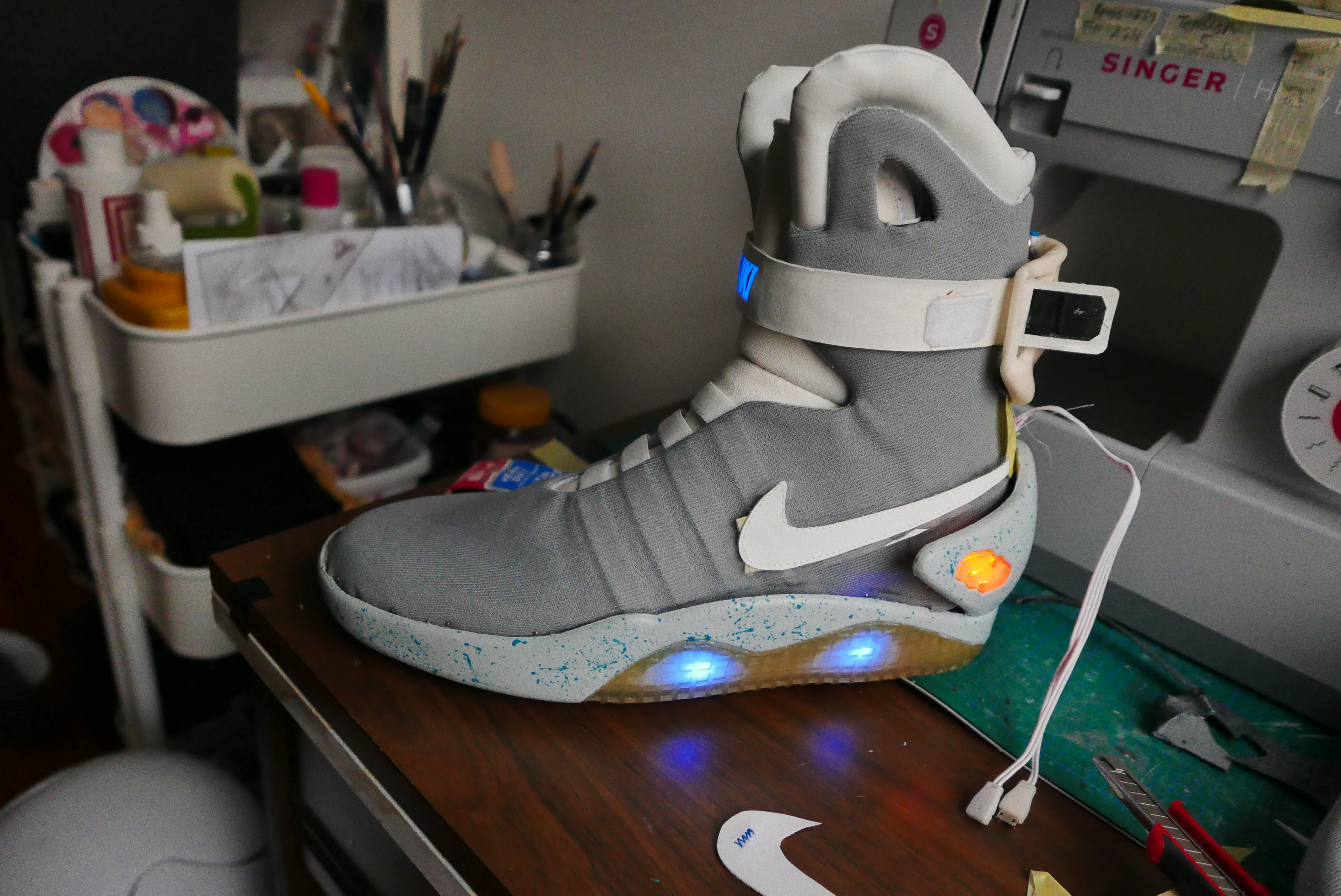

Here they are !
Upper attached to the sole
Toebox finished (sock toe style)
Now I need to finish to glue the sides and the back of the sole
The "poorman's shoelast" still in :

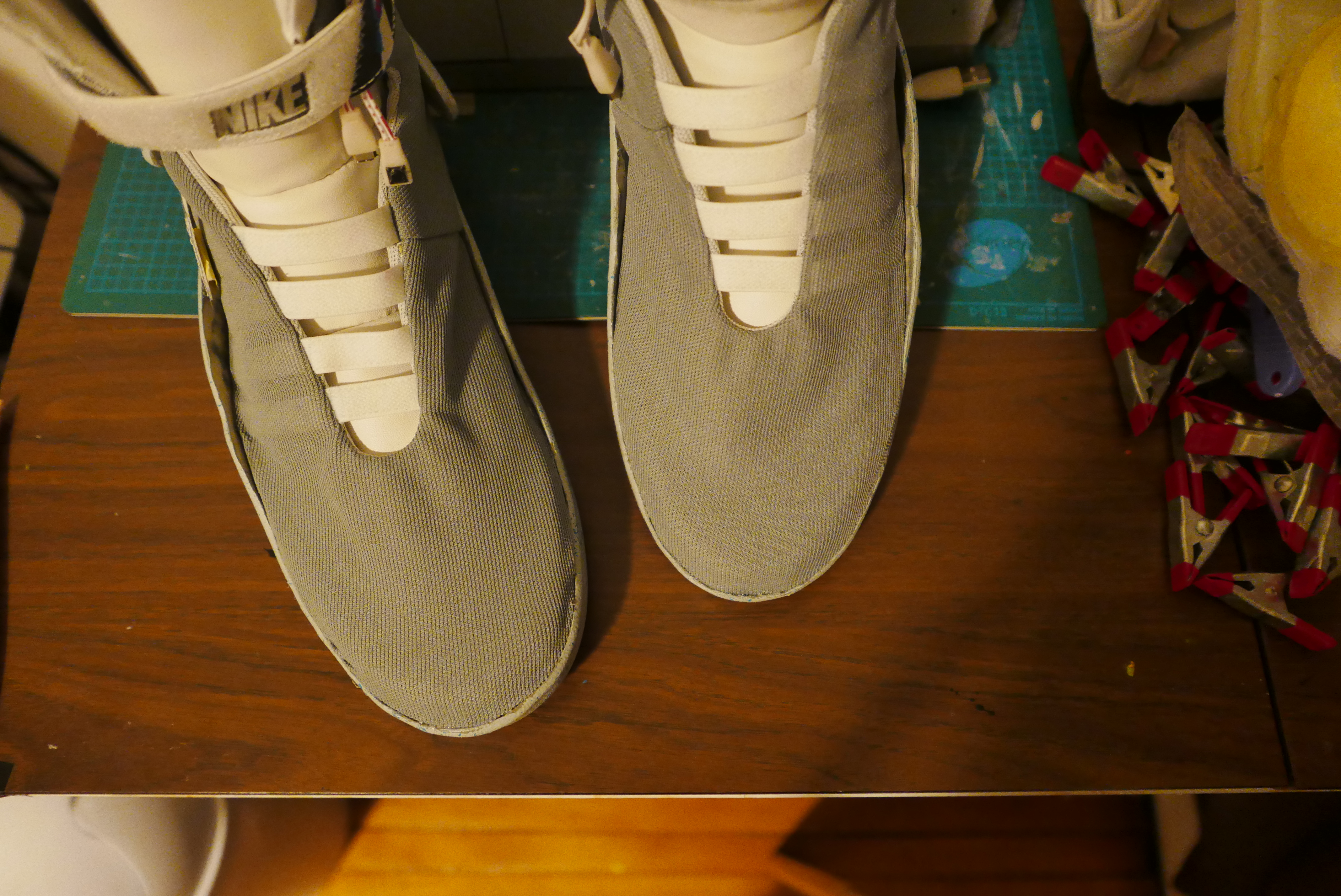

And without shoelast Topview :
The profile :
Global view :

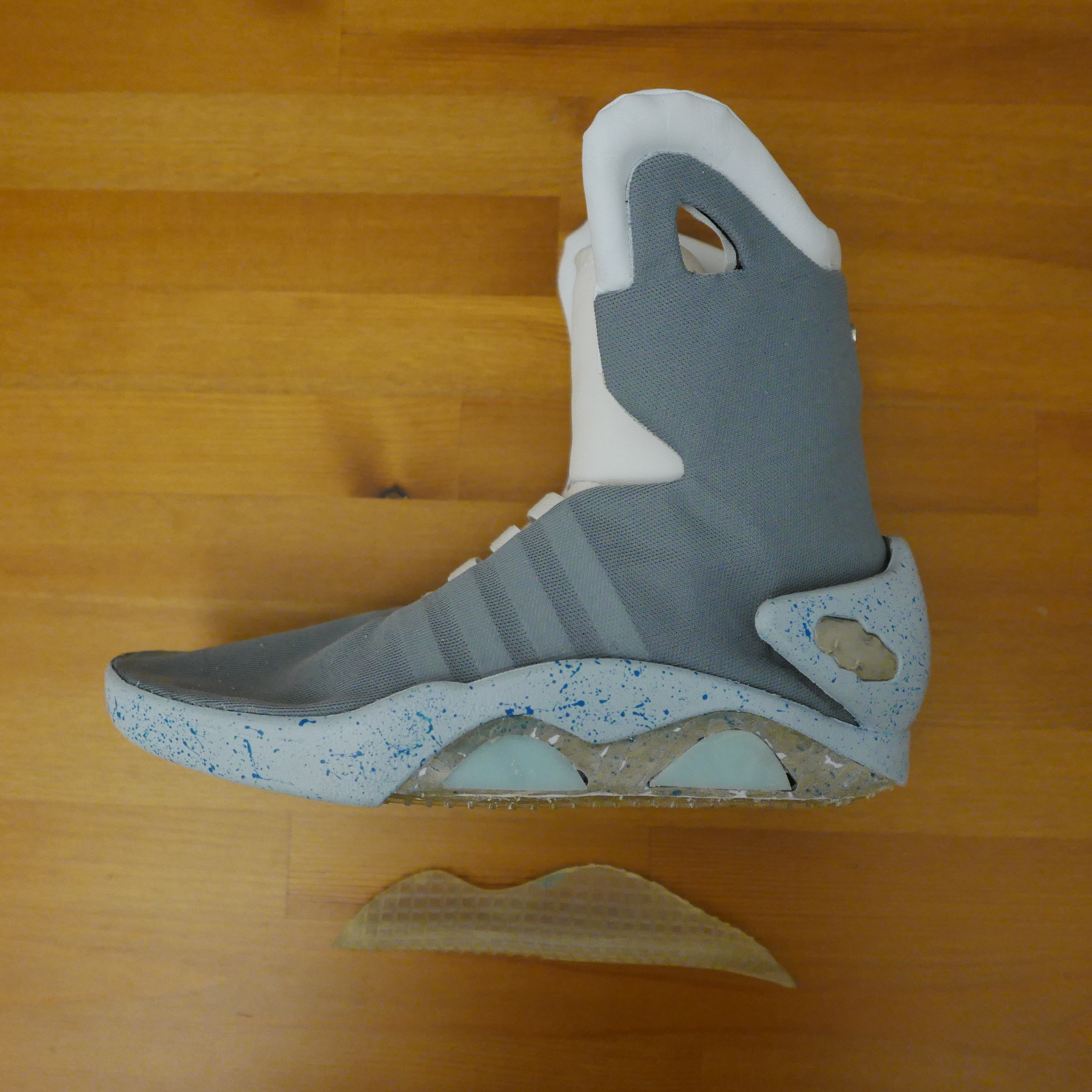

I'm close to the end...
"Destroy" the midsole...
I had some spare V3 midsoles so... i had to upgrade these HCs... :)
almost done...

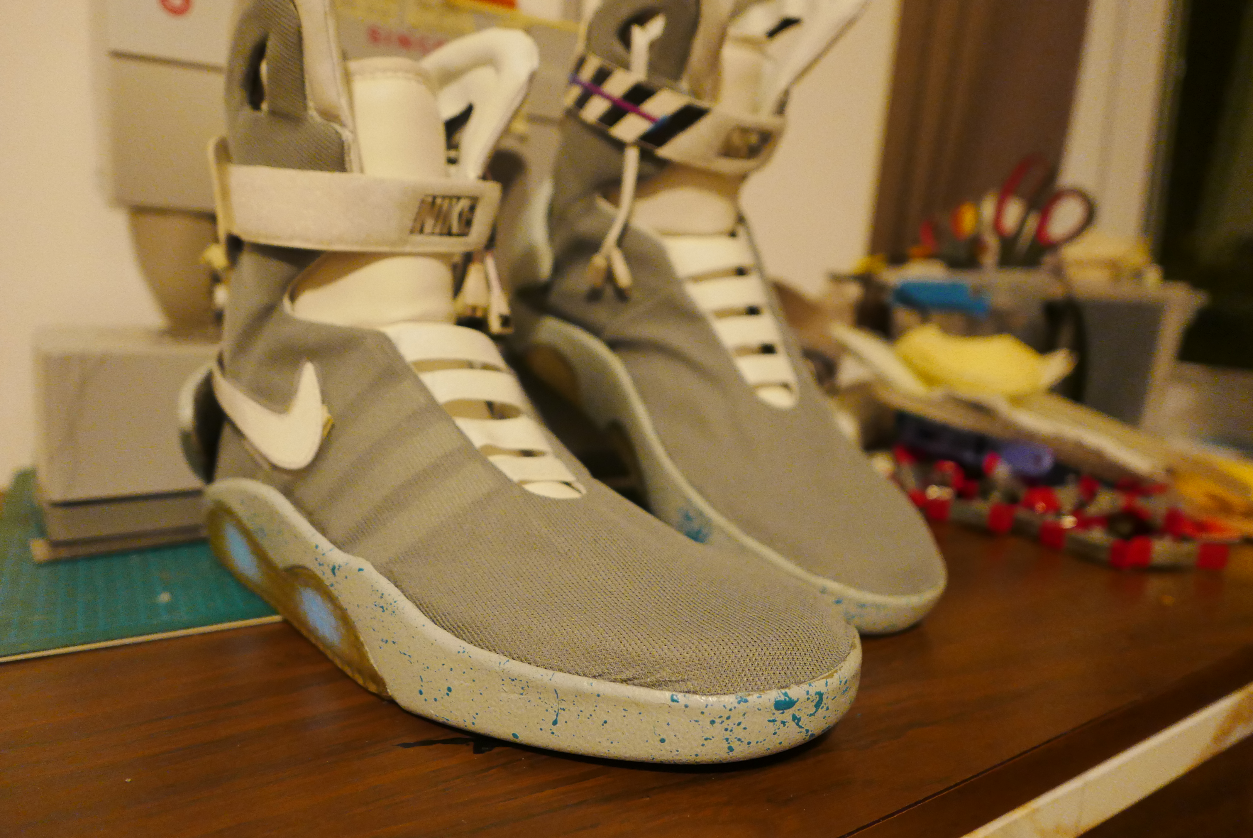

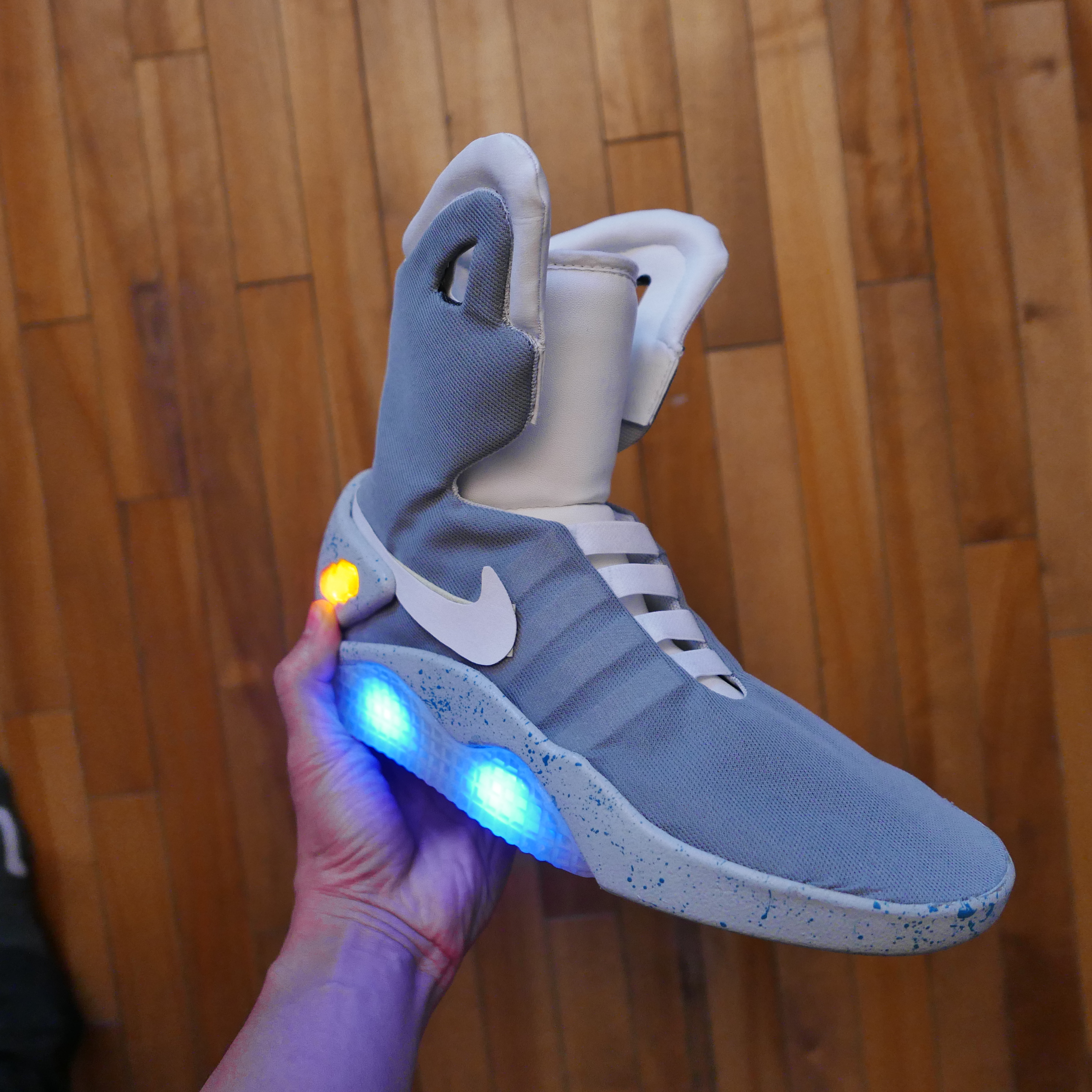

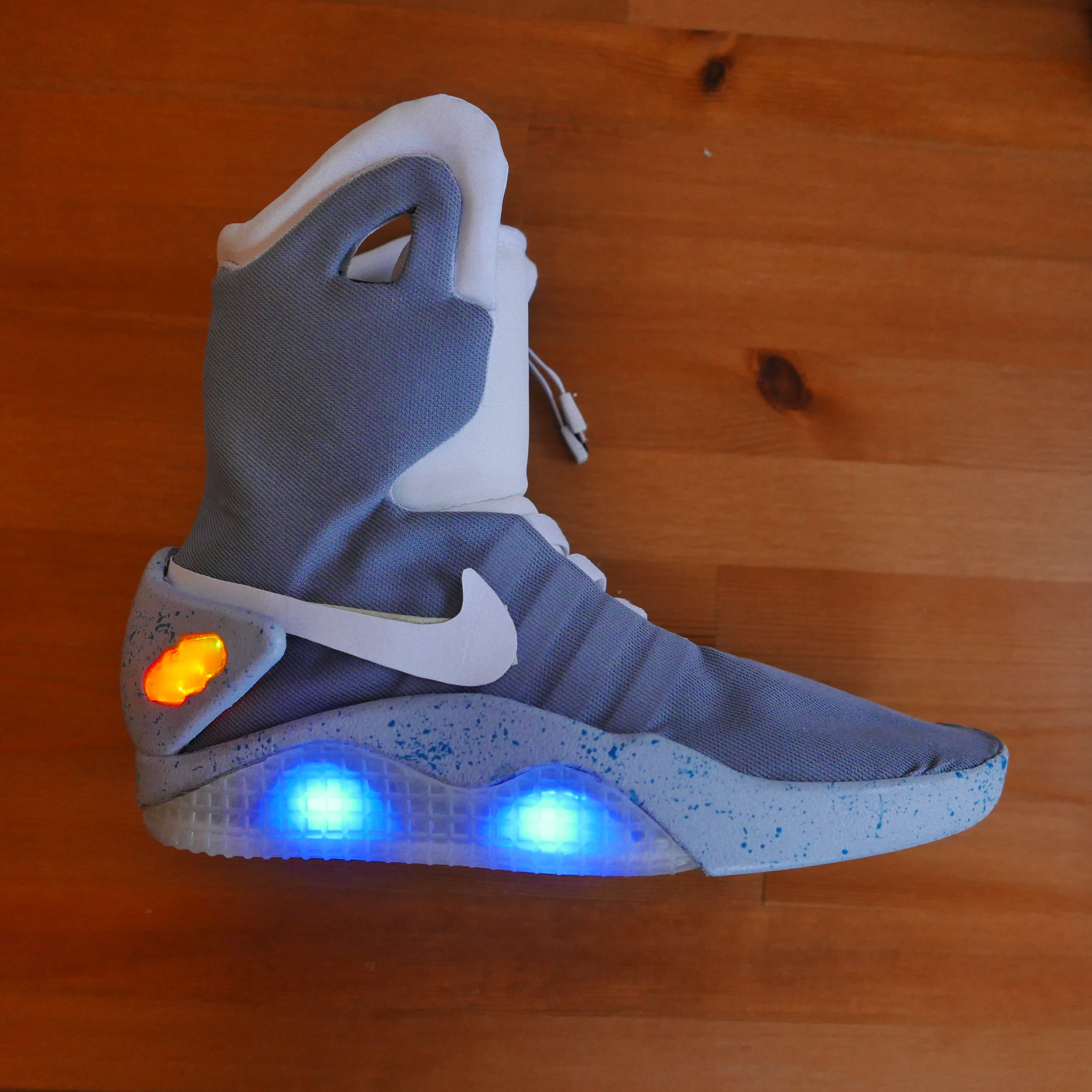

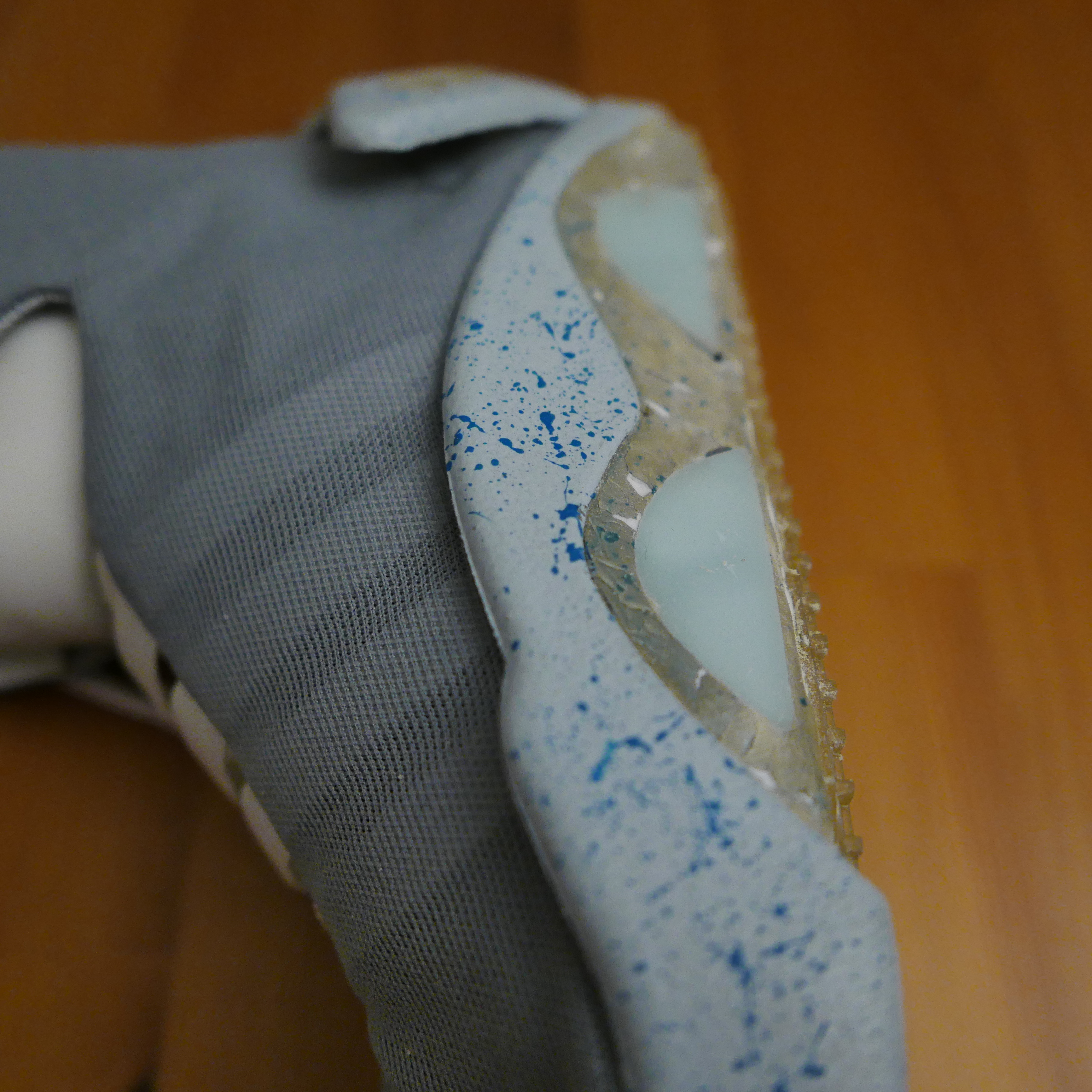

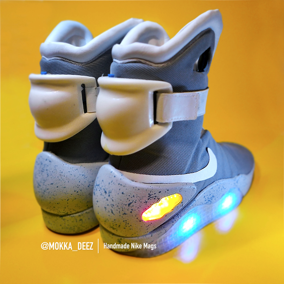

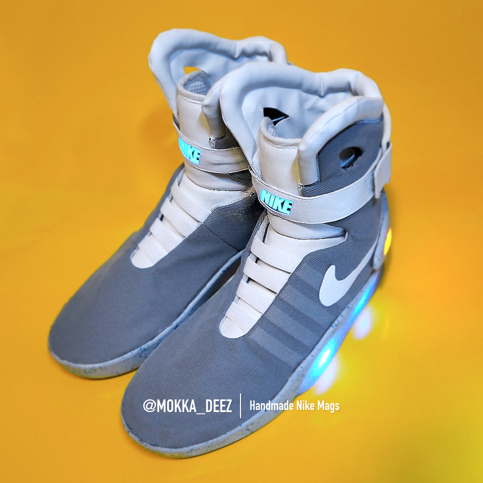

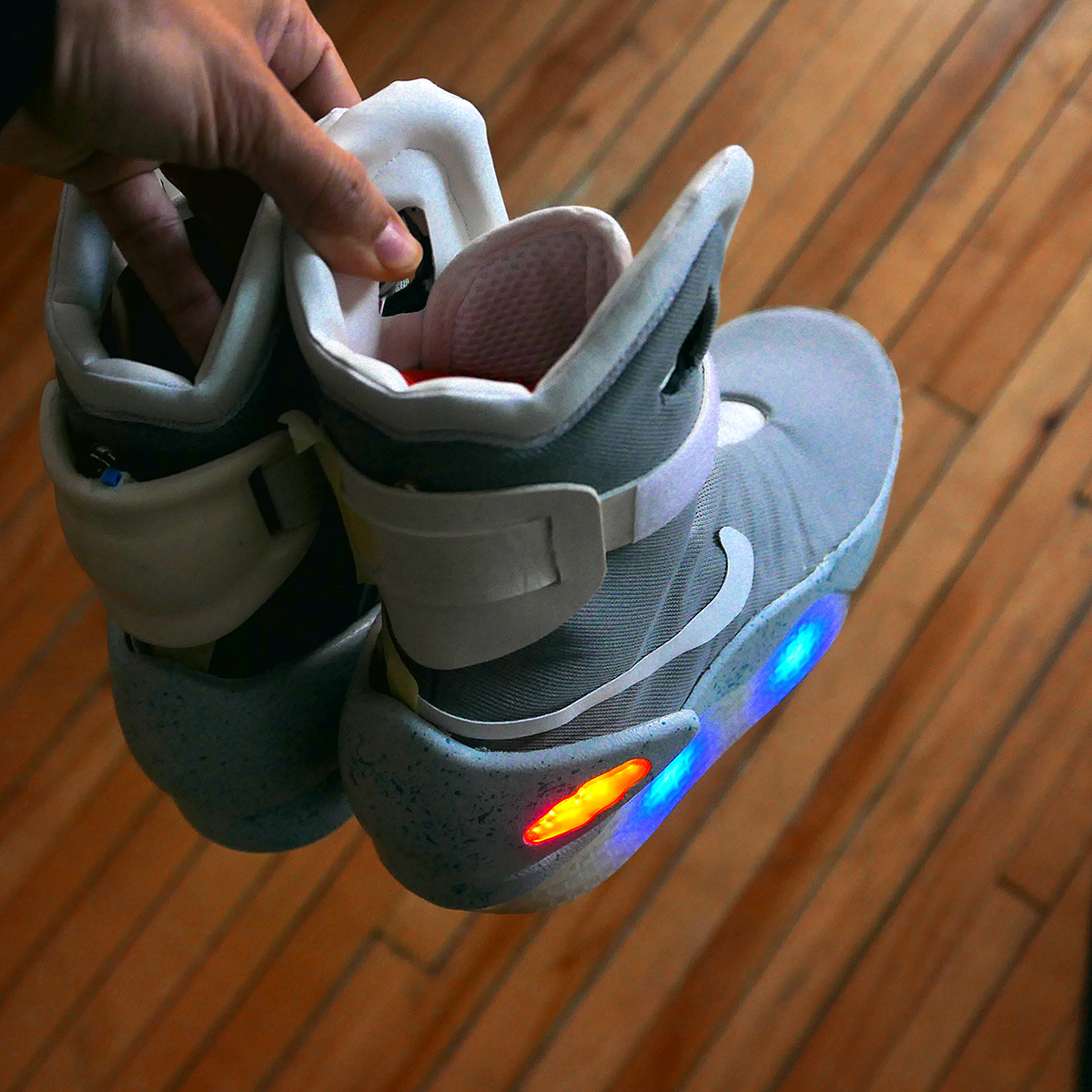

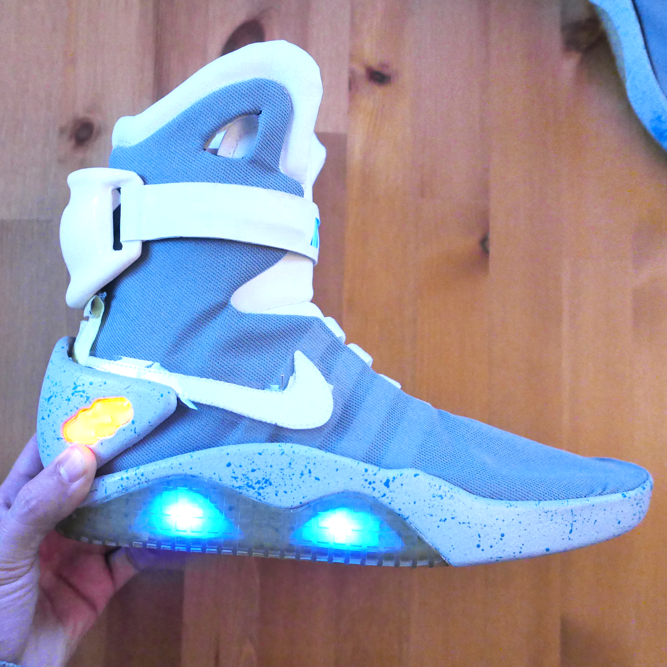

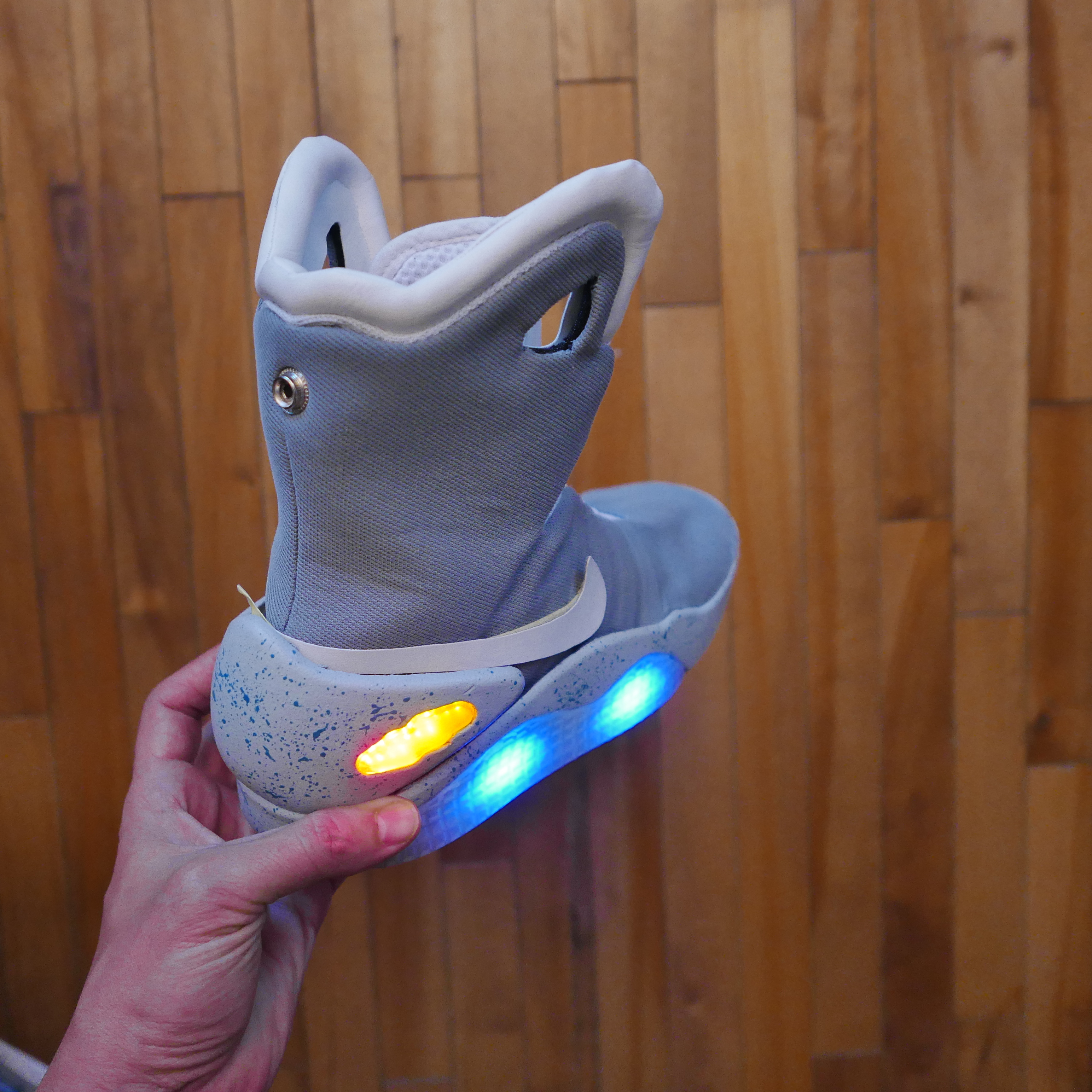

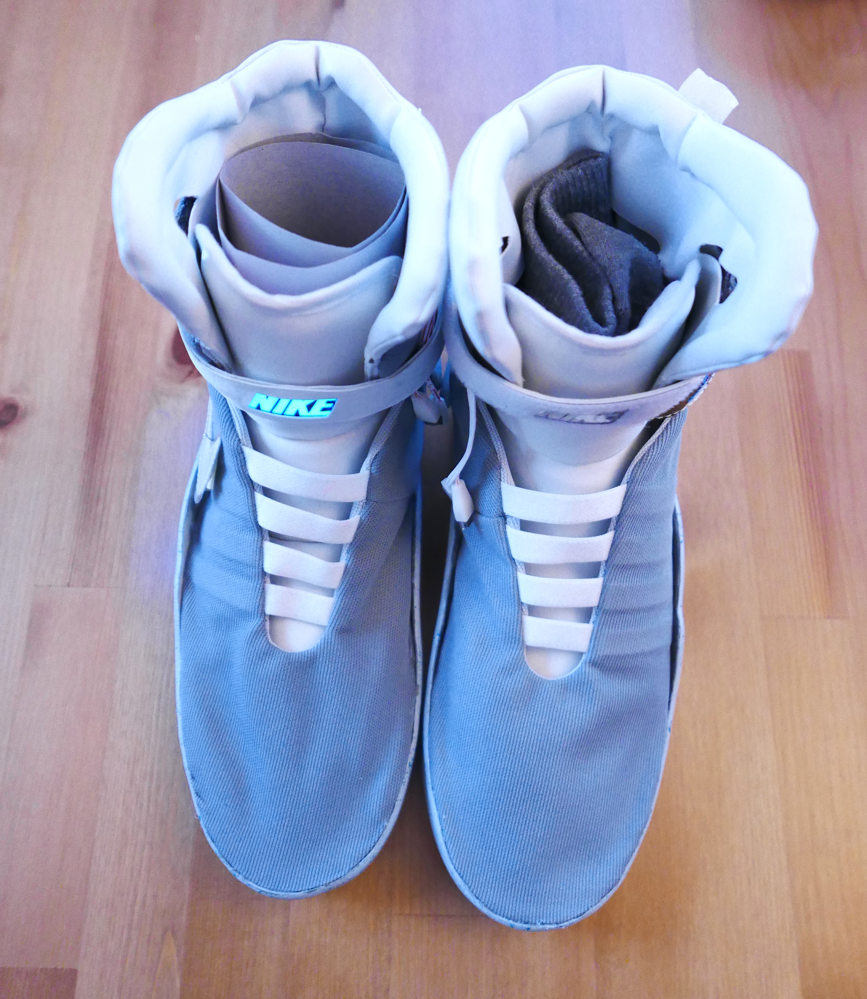

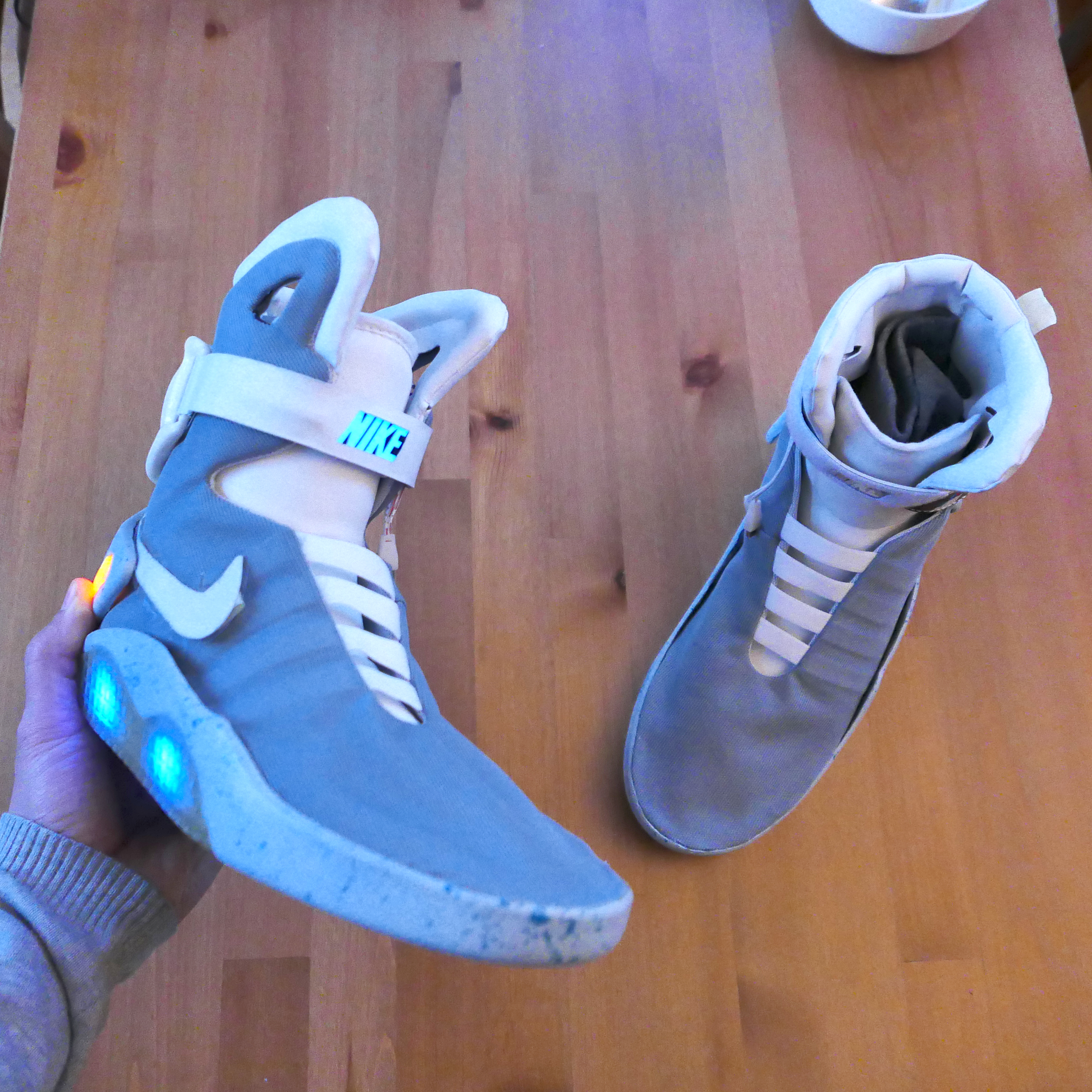

Here they are... My HC sole based Modified Nike MAGs :)

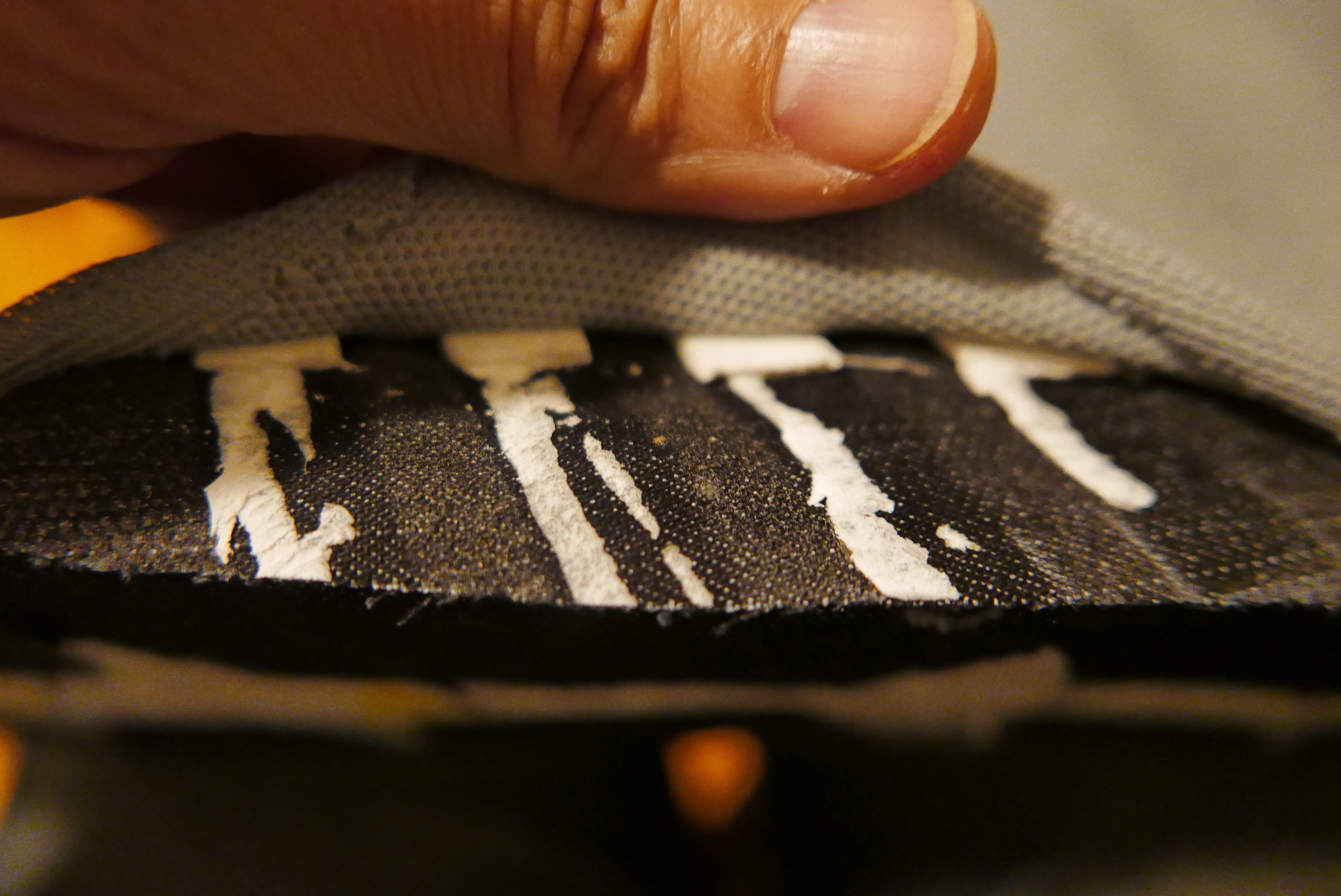

95% finished i'd say... Because the Decals on the heel cups aren't made and I need to attach the light switch properly...
I also had to sew the straps cause after 2 years, the glue didn't handle so well the heat and time...
The "ear holes" aren't my bests but this upper is one of my first good shots so the next one might be better
