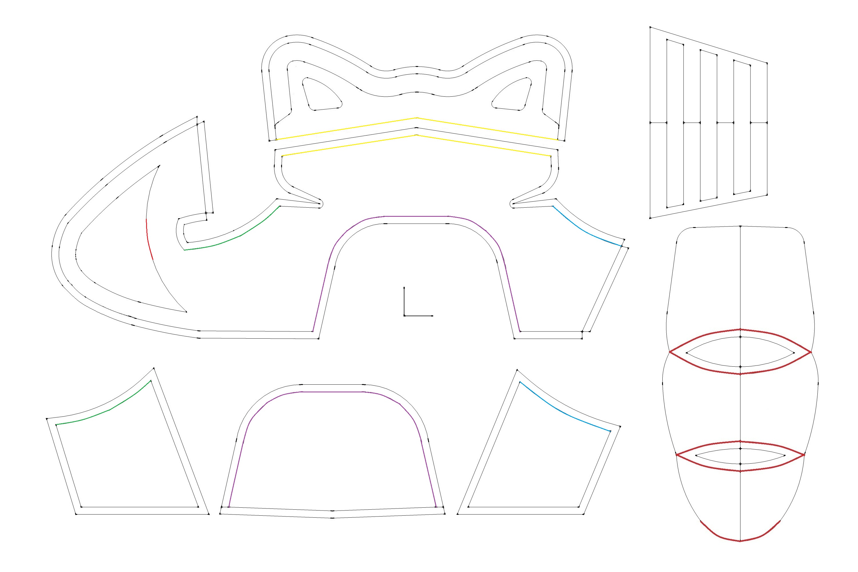

OK. Would you not have a liner to separate the laces from the outer shell?
As far as I can tell, that is what these parts on each side of the heel piece are for.
attachment.php
http://www.therpf.com/attachment.php?attachmentid=577288&d=1452729591
I guess this is the purpose of the 2 parts on the side of this pattern : a material that is soft and that slides better... ?

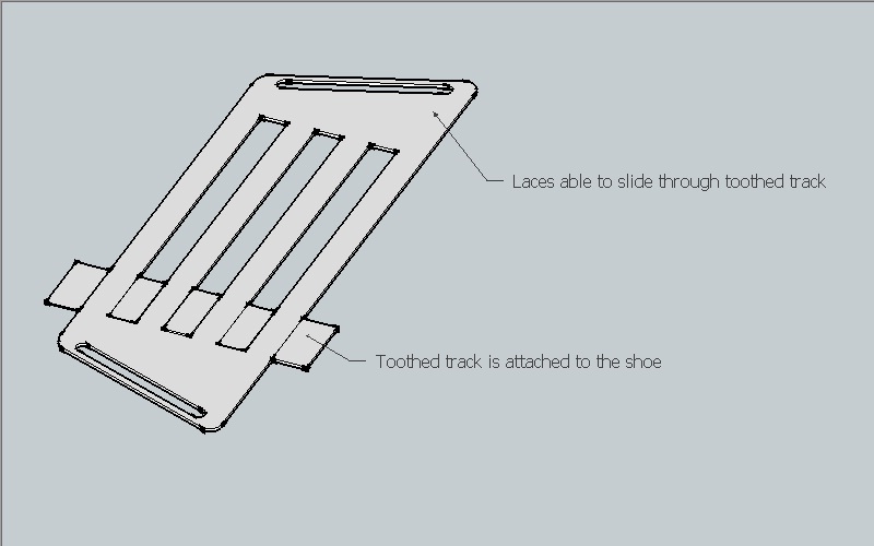

Not sure if this is how you plan on doing the laces, but a while ago I was playing around with the idea and hand cut (why it was not the best prototype) a lace system made from 1.6mm PolyProp. This was a single part that ran on a track, also made from 1.6mm Poly. This material is fairly cheap and slides well with not much friction.

Hopefully this will make sense.
attachment.php
I think the track would be best attached to the arc side of the shoe. Stop points for "rest" (open) and wear (closed) could also be added.

yes, i understand with pictures :)
How does it look like ? (the PolyProp) Where can I shop for this ?
Basically, my design is almost the same. I just worrying about the hardness (is this word correct/exists ?) of the material and I don't want the shoe to lose its shape in putting something too rigid inside.
Out of all the plastics on the market, Polyprop is probably the best and why it used for everything that has to last. From car bumpers to speaker cones, it is used because it is strong, light and can handle heat. It can be be glued or even plastic welded. It does not break down like PVC or PET.
I buy sheets of 900mm x 600mm x 1.6mm for $12.00, so also affordable. It comes in white too :)
