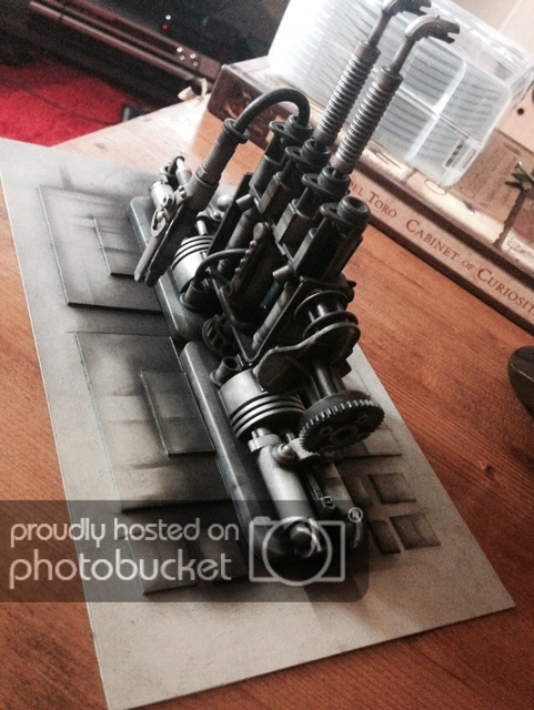

Next shipment just arrived but inbetween waiting I've done some more of the weathering to the SPACEPORT PUMP..
next it needs oil & rusts then more pipes leading to the Falcon...
