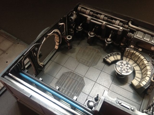

Main hold lighting....nice and dark feel and lve sanded the pipes to take off that gloss look they had like the 1st picture here.. The top pipes are just small black bar straws & drink stirs. I drilled out a hole each side of the top blue/black pipes so they slide in and stay firm. The floor has minimum weathering till l decide on a grid floor or not!!!
Nice work but my advice is to exchange that electrician tape for something more durable. In time it will release itself and turn the plastic into a greasy mess.
Cheers RKS, will look into it, I've only blocked the under LED wires on the removable cockpit cone part... The rest of the model tube thats behind the chairs etc is painted matt enamel black. And I'm making a canopy to cover the Dagostini light section.
Been working on a 2nd main hold floor using Rub'nBuff pewter finish & Winsor & Newton fast dry Lamp BLack as an experriement. Everything on my first main floor is only stuck to the sides for future change if it looks good or l want to make a grid floor...
