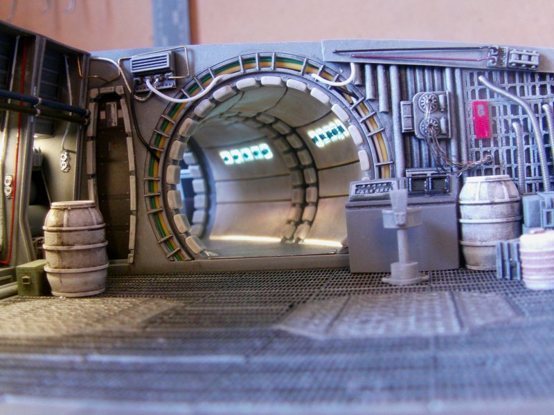

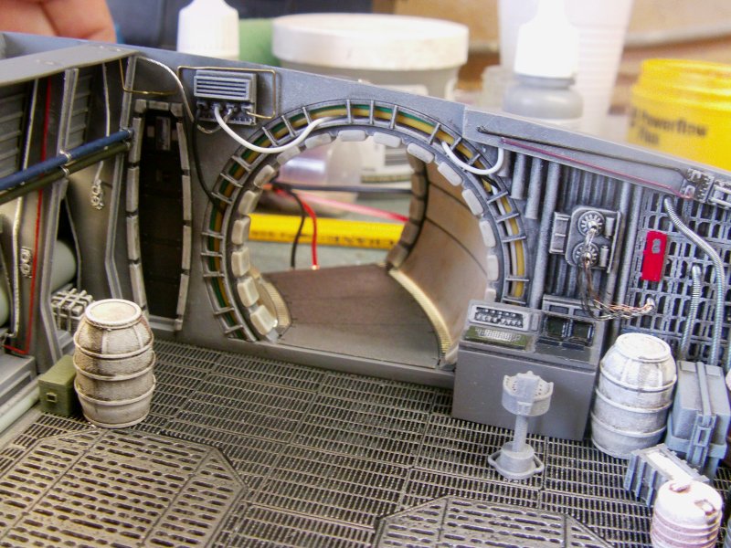

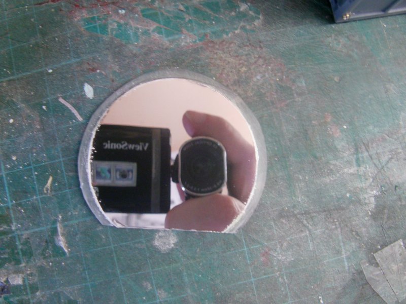

Here's a neat little trick from Page 16 of ianlawrencemodels.com
With the use of a mirror he is able to extend the tunnel on the other side of the cargo hold.
I've gotta steal this idea.

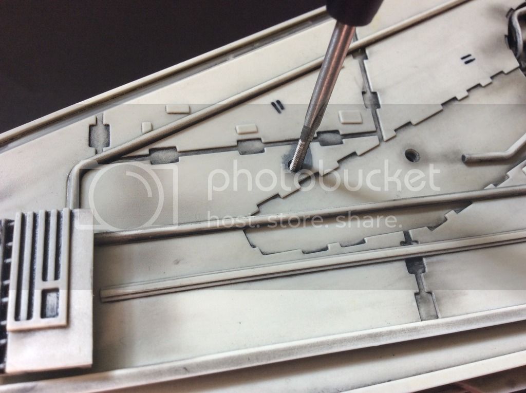

My TIP: Remember that Thread-cutting tap from issue 42, well you can use it if you like to create the threads like in the studio model on the left & right top mandibles..
The 2nd hole you can see here will have a tiny Grub Screw inserted when a get them!. They are on their way on a very slow boat from China!. ;-)
NOTE: l used a Dremel drill to punch through the cage very, very carefully, if you don't have experience in dremeling don't.
Search your findings... you know it to be true... leased l hope it's that issue, bloody looked loads for its references ... ;-).

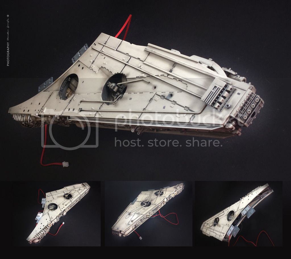

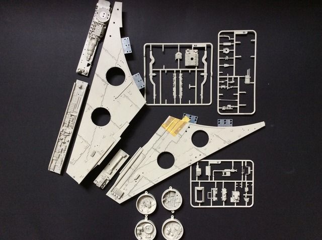

PORT (UPPER,LOWER) MANDIBLE

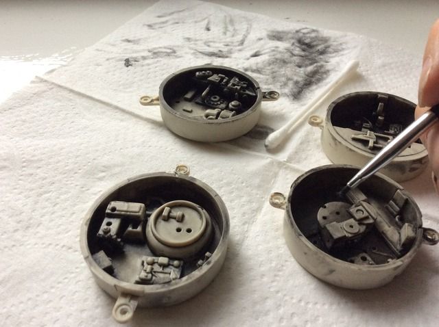

(Issue 83 onwards)With this port mandible I decided to cut & glue certain parts before the black oil weathering as an experiment,
Unlike the STARBOARD I did all parts on the runners first.

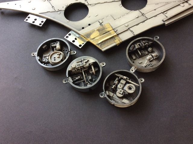

Below: the resses rubbed from the black oil, l found that a brush, plain & dry helped get into awkward areas & helped remove the black,
also cotton buds.
G'day Jordan, it isn't clear on the first post titled ' Port Mandible ', re;the oil base coat. The #2 ( post ) clearly seems to show base coating/weathering , but in both you've got a masked off area. Have you changed your method of application, or found a better way re;' how-to?'. Thanks as always ✌️Ged
